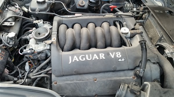

I had a fiddle with a few bits tonight, the throttle body is now clean so it should pick up better on light throttle. I was surprised how smoll the TB was for this size engine, the TB on my old XJ40 3.2 must have been nearly twice the diameter!

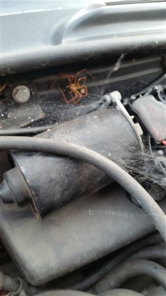

I discovered this chap guarding the wiper motor, so left him to it. The wiper motor hasn't been stolen so he's doing a good job right?
