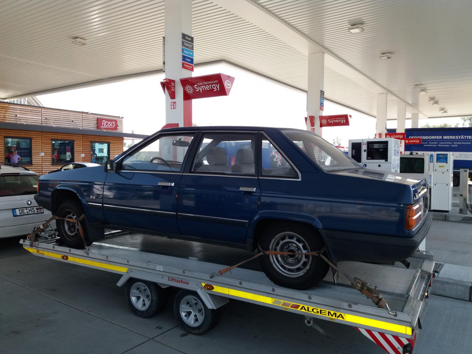

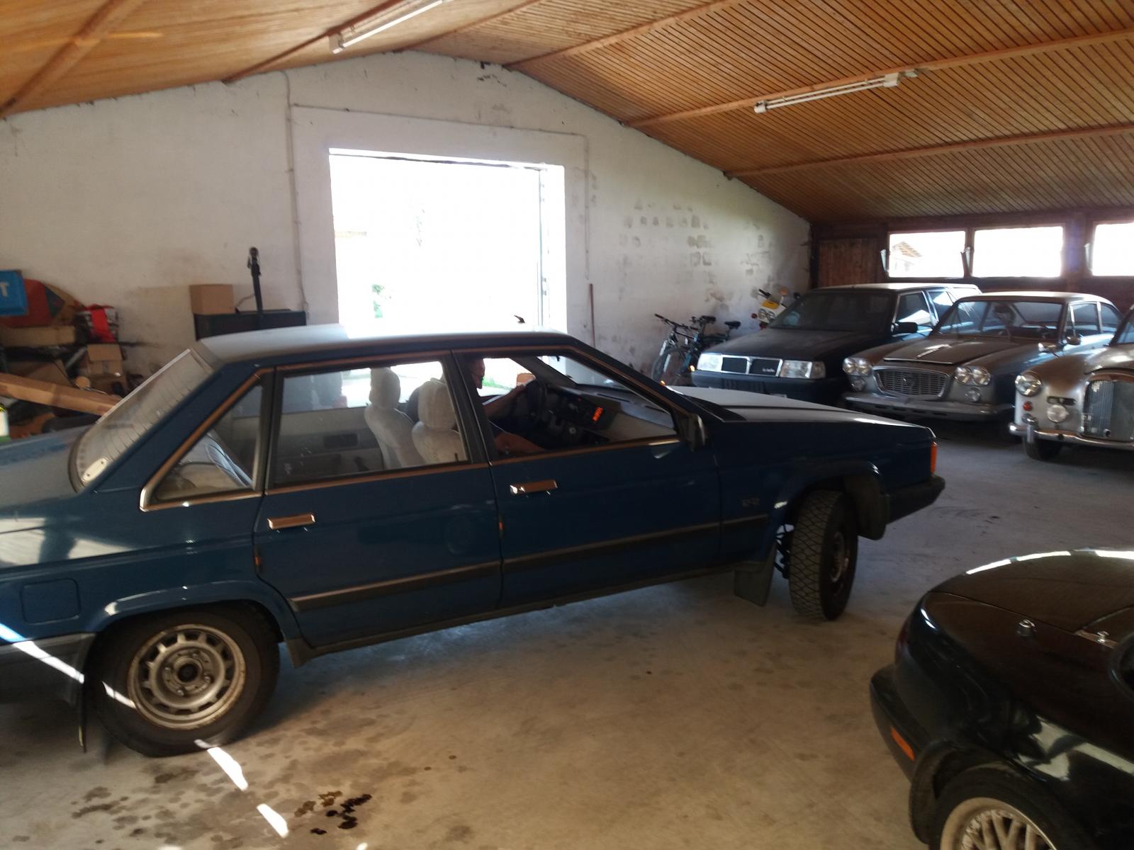

Back home.
Temporary parking achieved,
amazingly it starts on 10 year old fuel, drives and brakes.  Will a car start on fuel you take today in 10 years? I doubt that, tells you what shit fuel they sell these days at the pump.
Time to check it out, it was collected unseen because cheap, very cheap, so cheap you don't look and just go there with a trailer. Actually, it was free.
We knew about the struts and were ready for some surprises, so lets check.

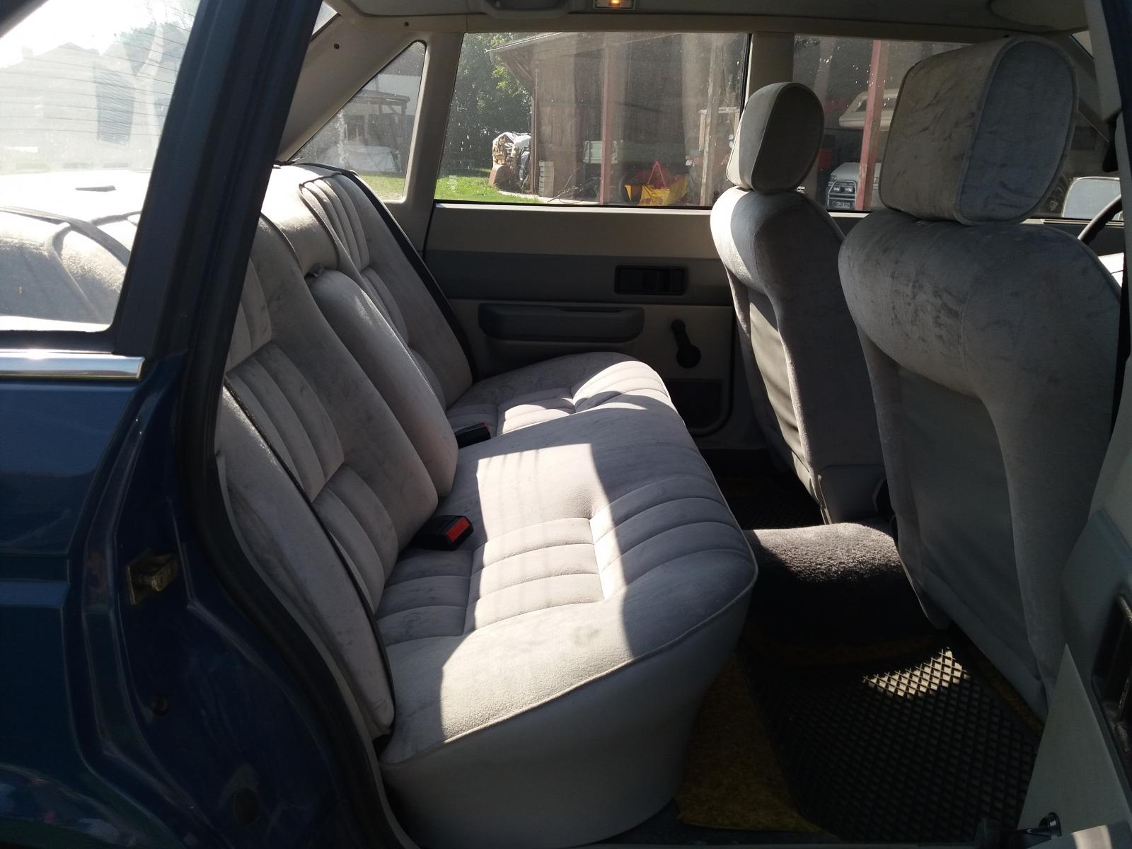

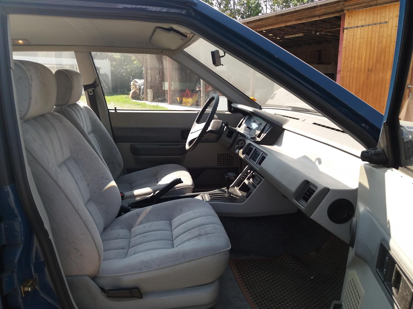

The interior is...
mint!
The ceiling stays in place

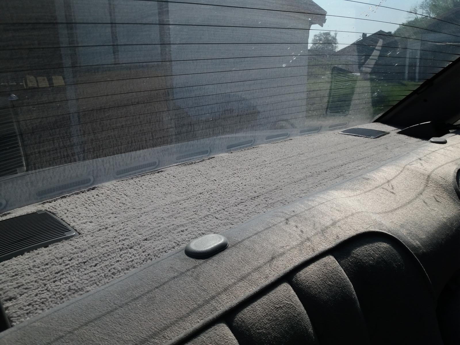

the shelf is fine
even the vents are Ok.

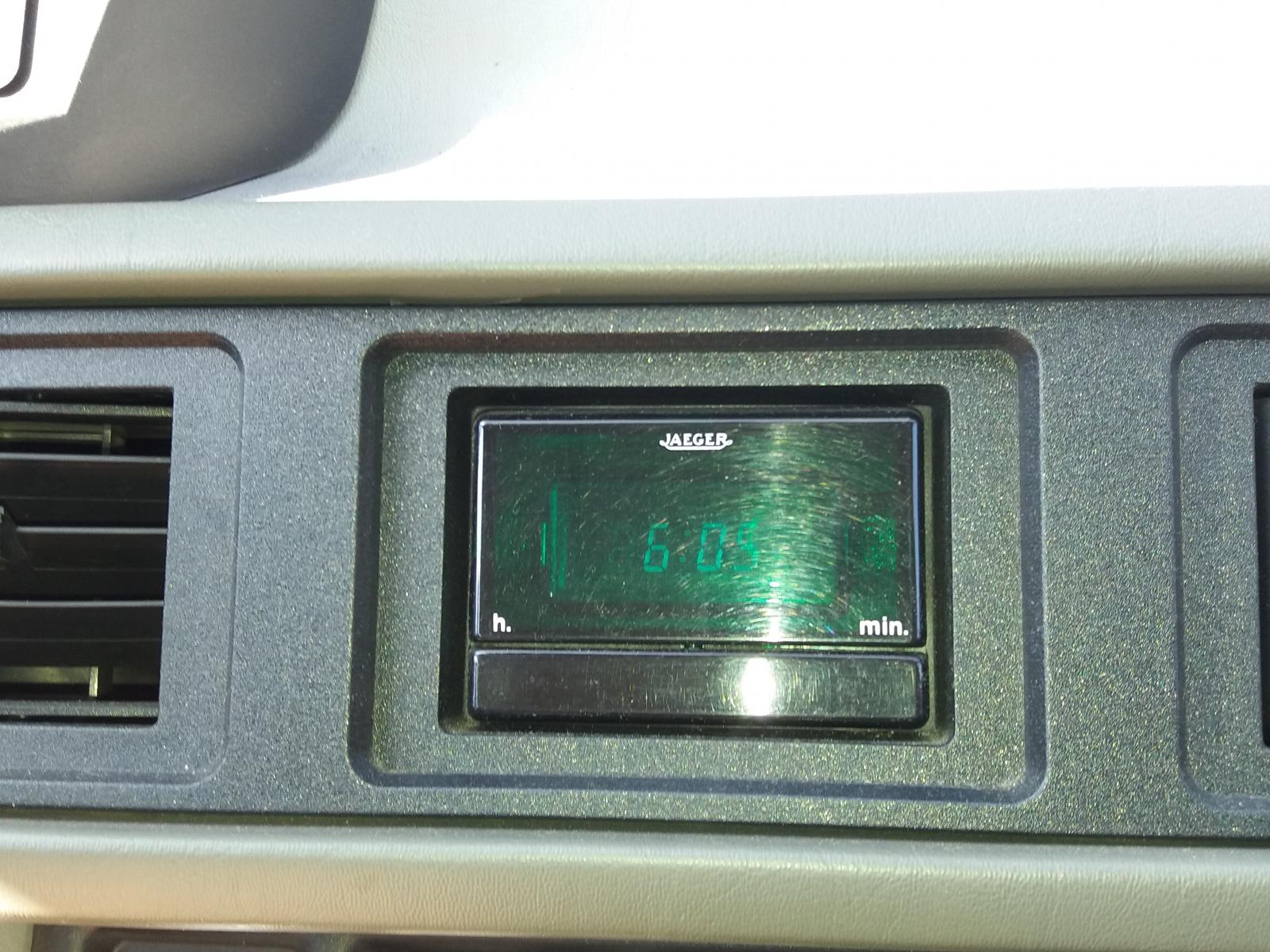

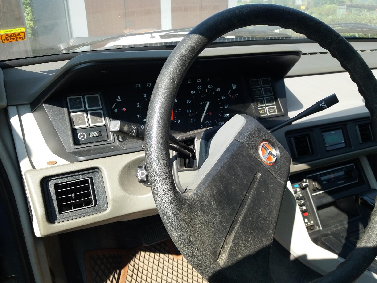

The clock works...
so does the radio
and the labels didn't fall off from the switches
Comfort zone,
that velour, loveley.
Wow!
Rarely seen an interiour that good and i have seen many a Tagora.

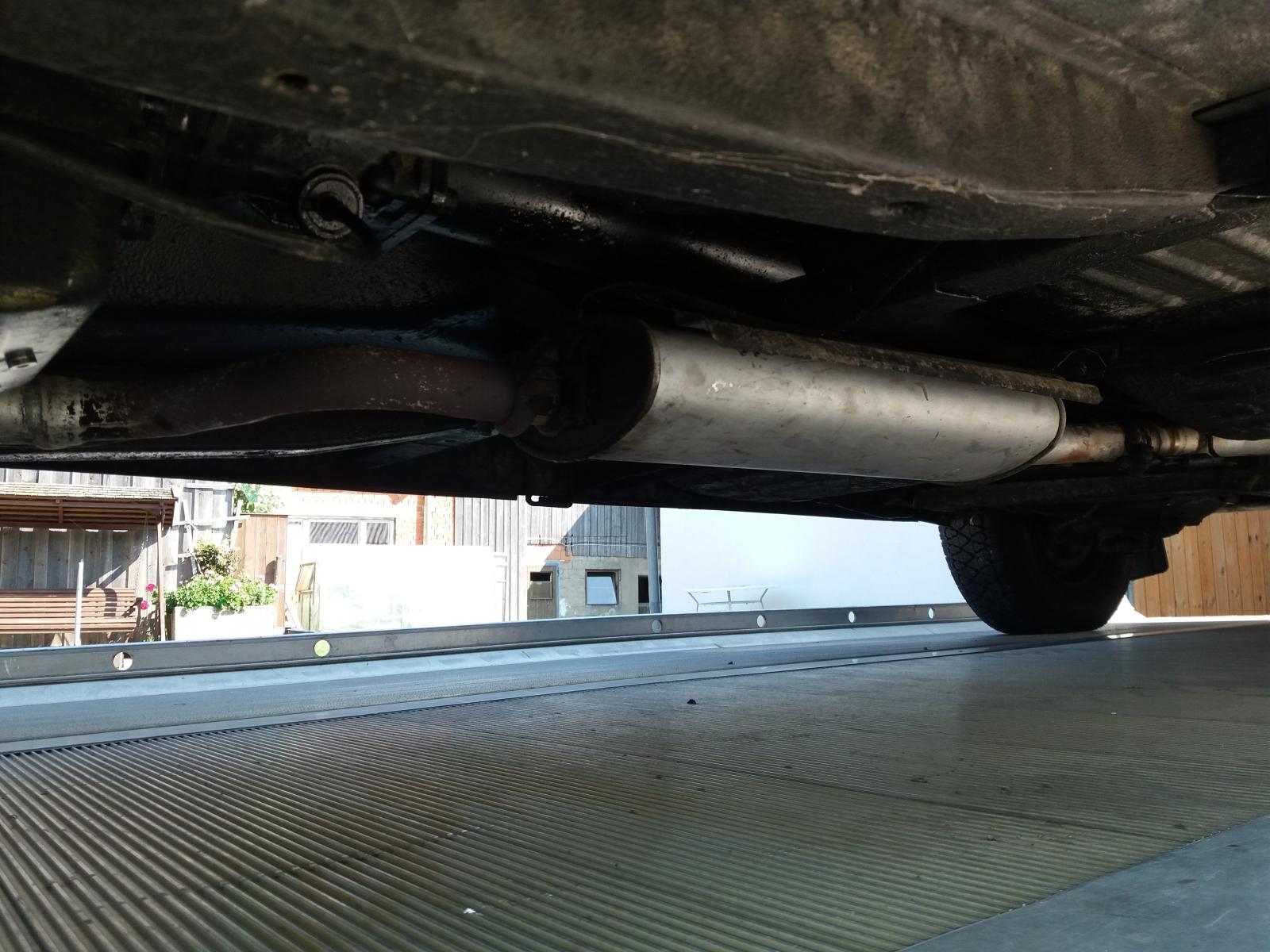

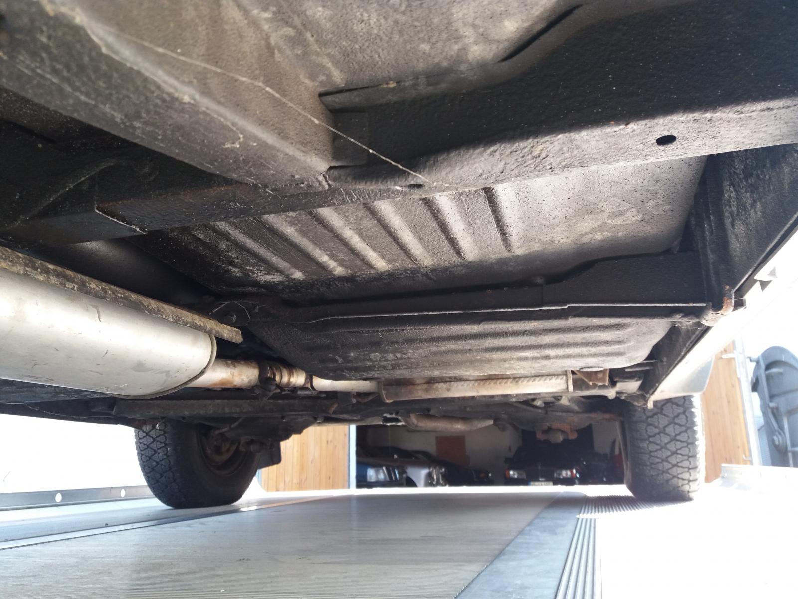

Next stop, rusty or trusty?

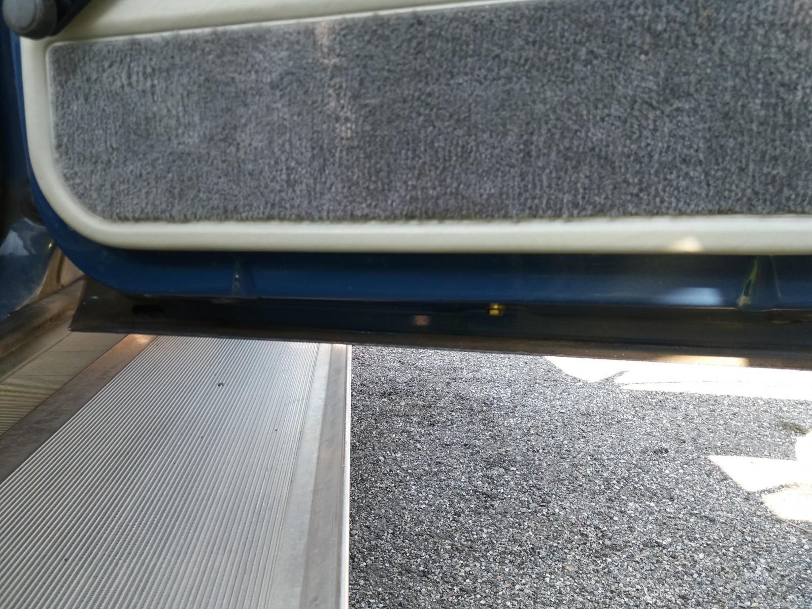

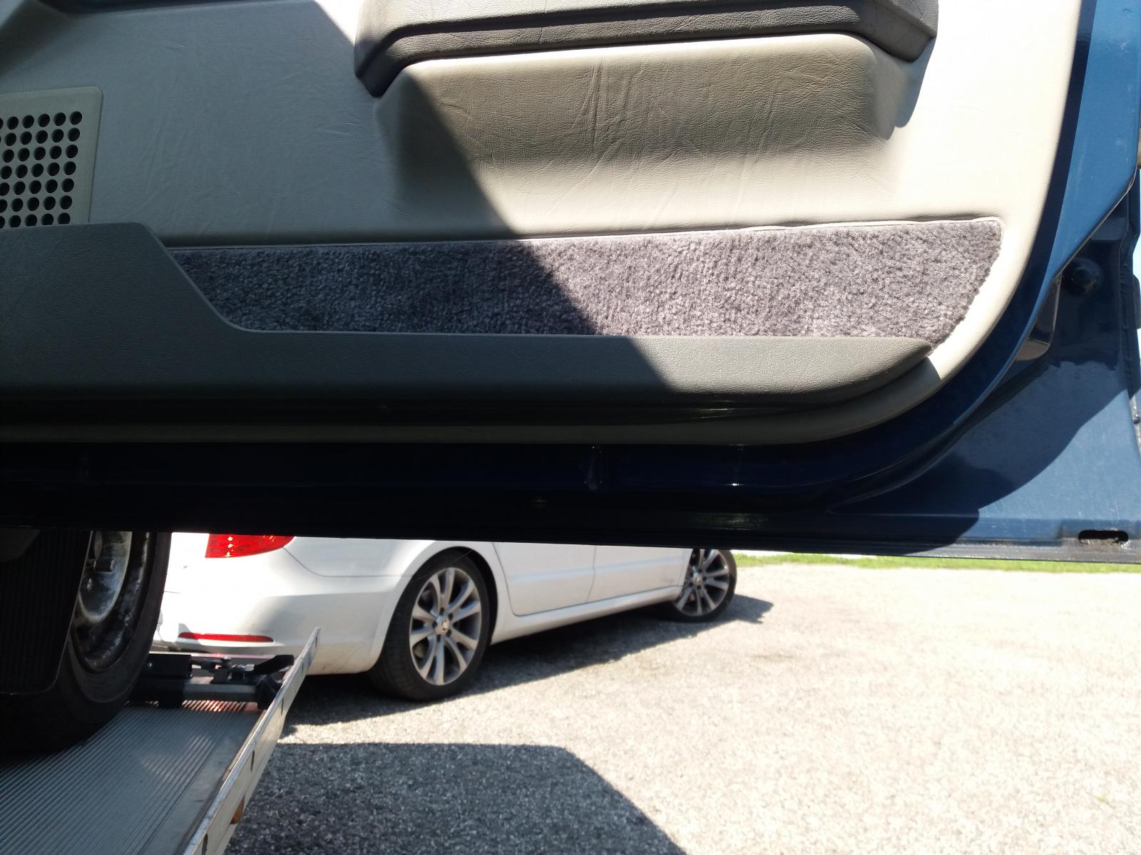

Doors... no rust
sills and underneath: fine.
Exhaust good.

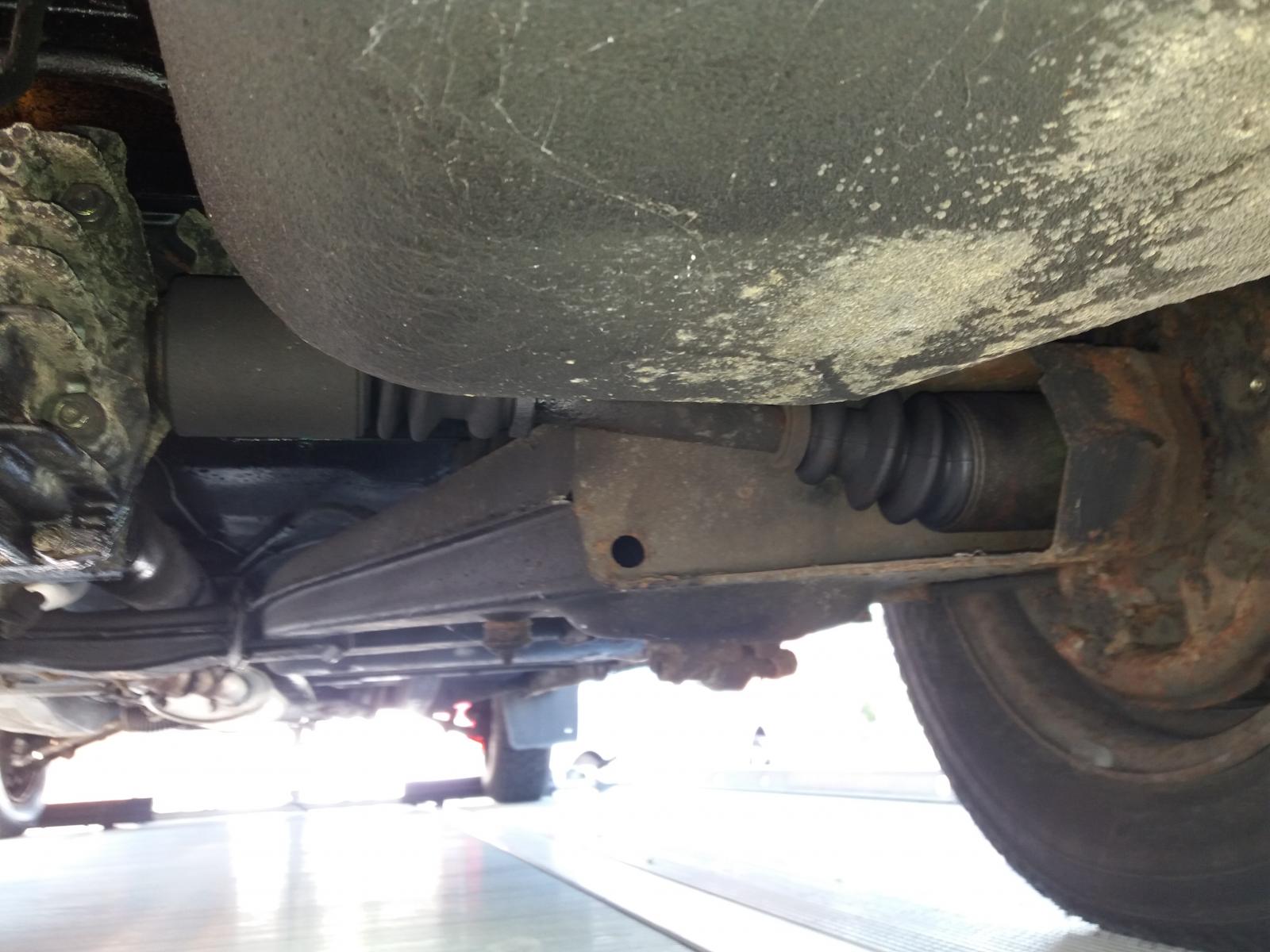

Rear arms, weak spot on all rear drive pugs, perfectly allright.

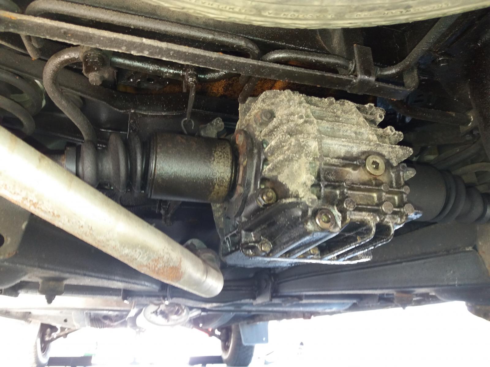

Diff a bit oily, who cares.

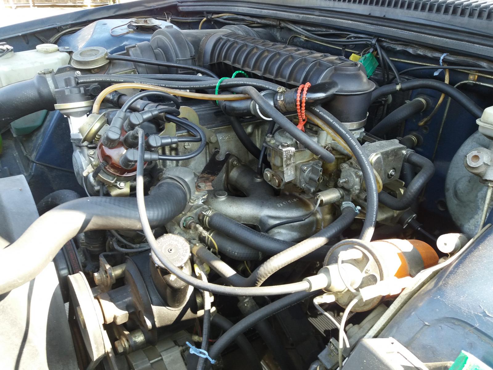

Last not least, under the hood check,
looks good. It runs, no surprises to be exepcted here.

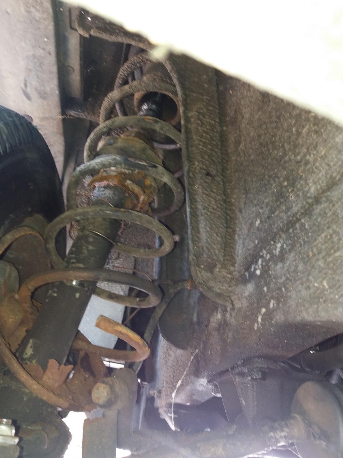

We just discuss a strange thing here, i am sure a shiter knows, we can't figure.
With both springs just hanging loosely around the strut, i would excpect the car front to come way down, why is it higher up than normal?
...but he had an excellent dry garage to keep it in.
Unfortunately nobody told him that the 504 struts have a design flaw and collect dirt and moisture under the rubber stop at the lower spring plate.

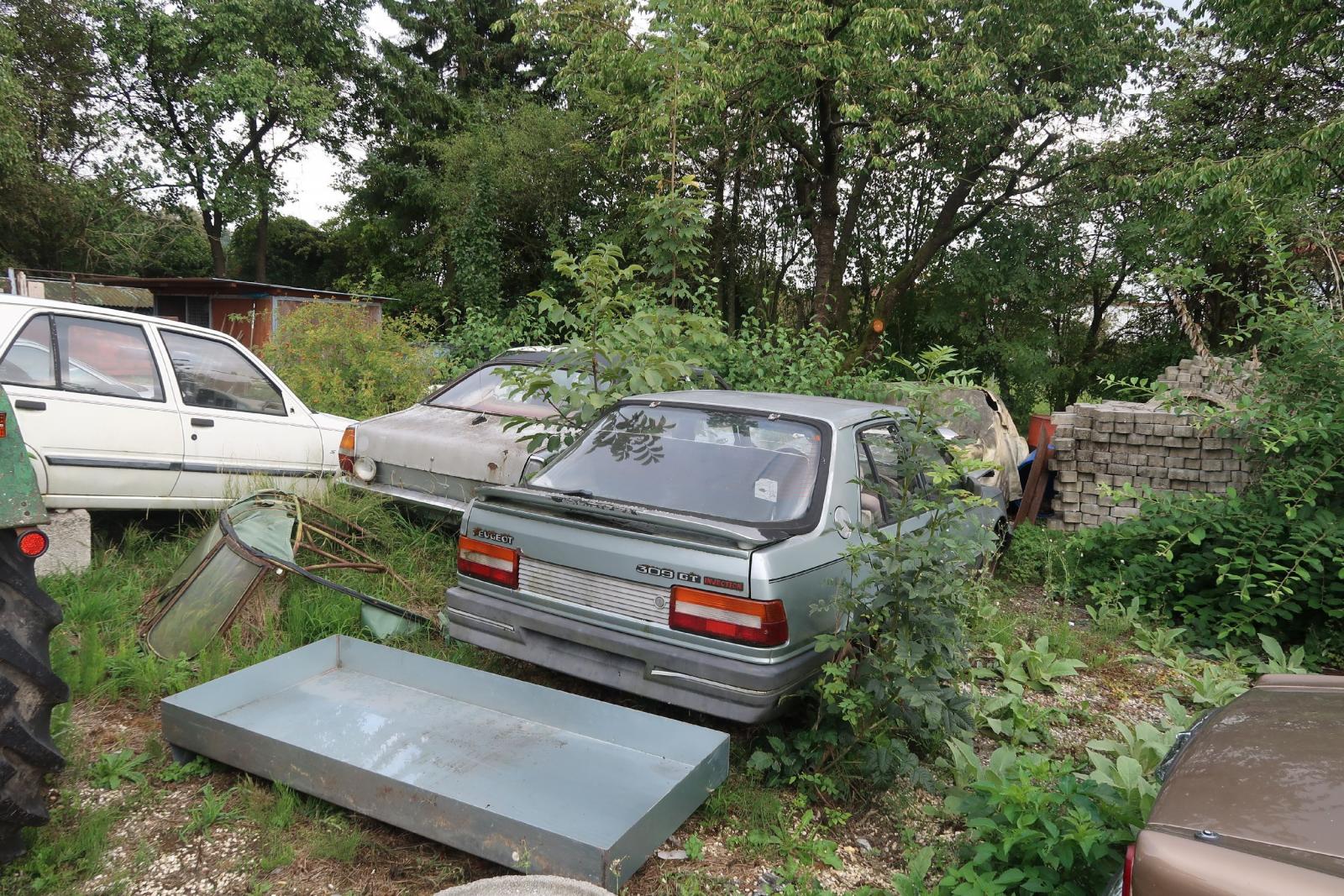

The unobtainium is well hidden from the public, but once you pass the magic gates, it is found in abundance and multiple styles and colors.
Most of it is of the well hung french variety that only true connoisseurs can really appreciate.
Lets have a closer look.
This is good quality unobtainium, however some has impurities of the american sort.

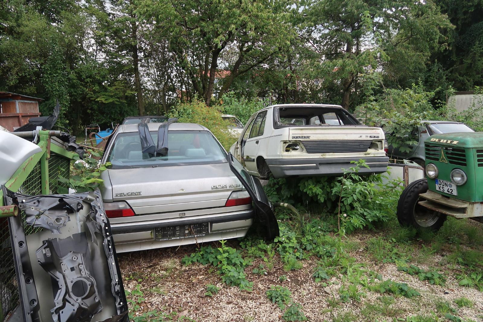

This is not bad, it may actually be used, the 505 struts can be made fit, however we prefer the real stuff.
There maybe some good unobtainium under these piles, but we didn't dare searching through it afraid to wake up some old evil ghosts that may haunt us forever.

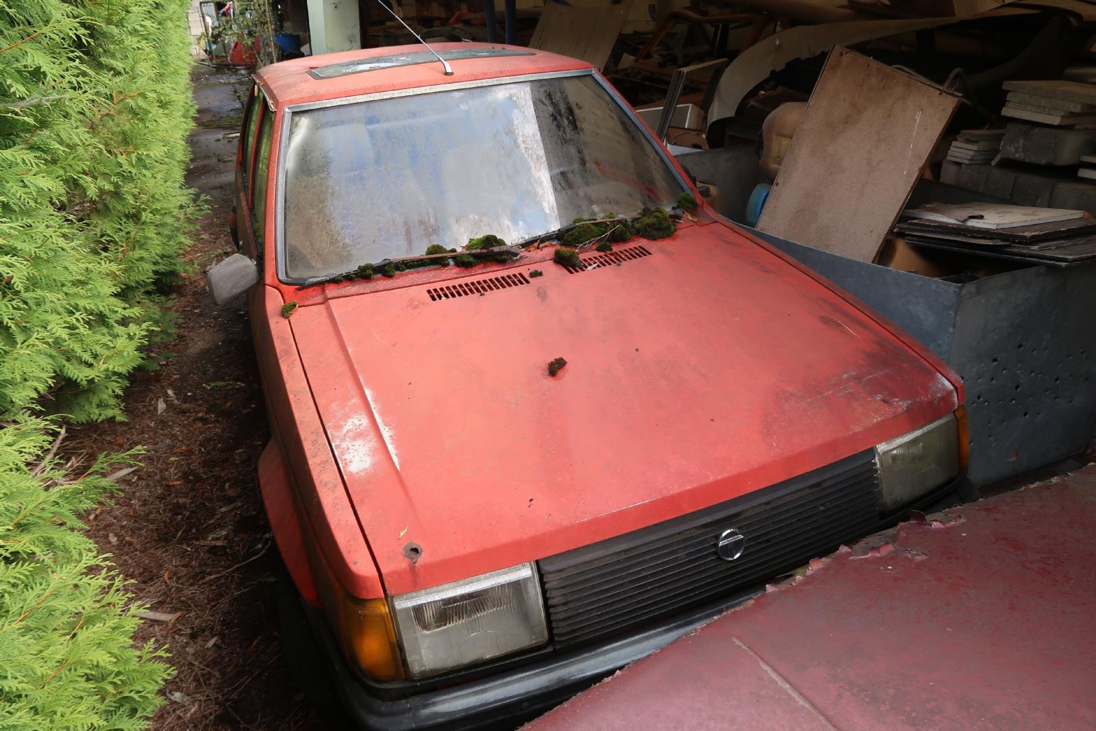

There is a smell of the Poissy variant of unobtainium in the air.

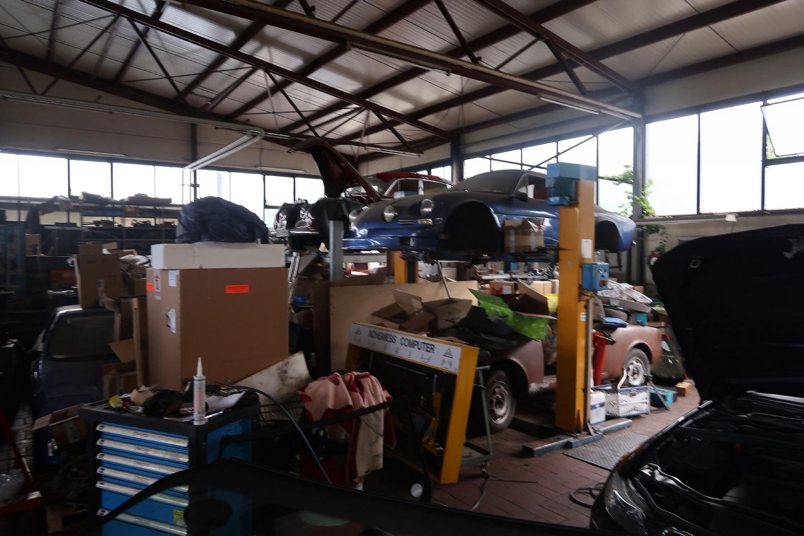

This is another source of likely compatible front wheel maintaining bits.
Excellent stuff, but none of the elusive materials that we look for.

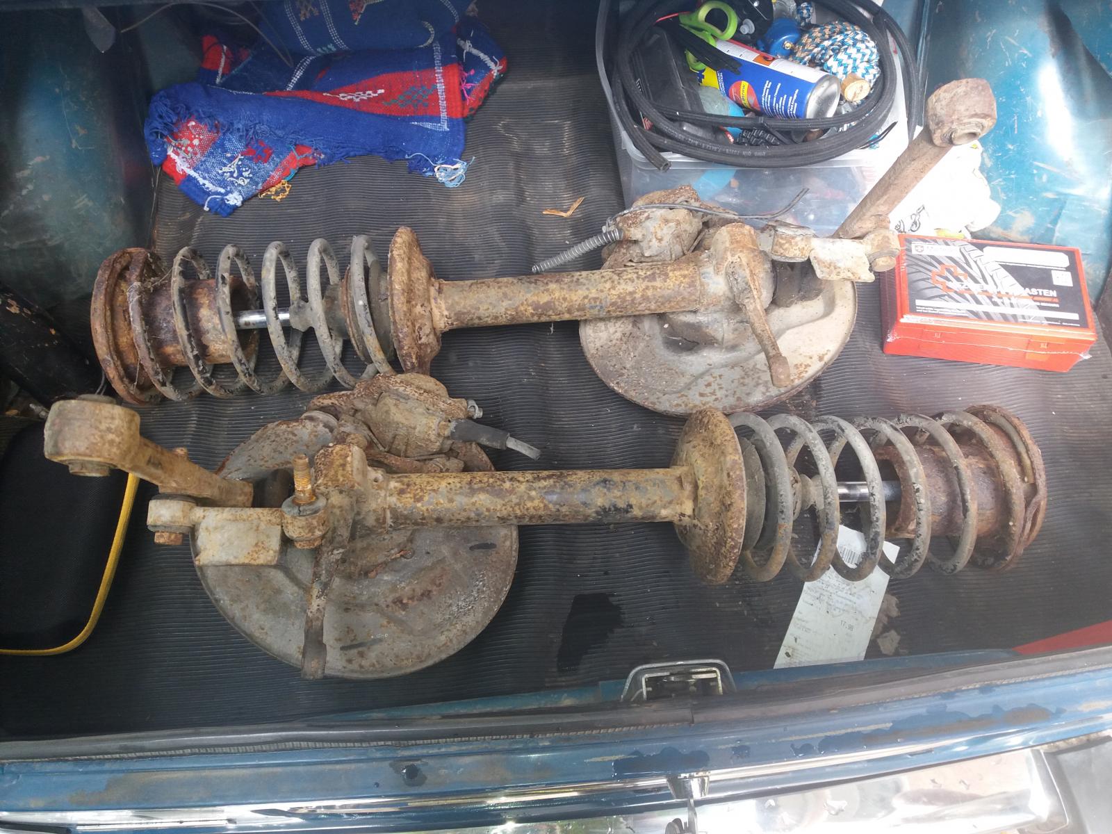

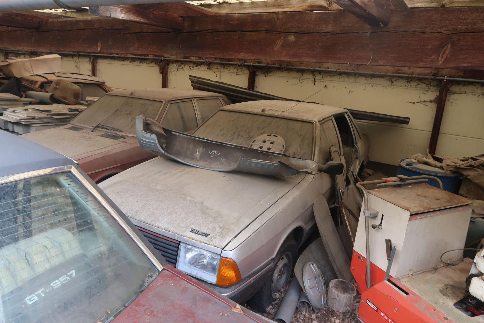

We went deeper into the secret forest of steel. We can smell it now, true 100% pure unobtainium in both red and silver variants.
Struts are good enough, a bit of blasting and some paint and they will be perfectly fine.
Costs? Free as long as we remove them ourselves. We will be back with the toolbox soon.

There is no longer controlled height at the front set by the compressed springs on the leg. Therefore the shocks have extended fully raising the car to whatever height they extend to. That's my theory.... Wait...

Cor, you can see that there is not much material on them spring seats for the tin worm to eat! Well played.
All it takes is drilling a little hole at lowest point so the water can get out. Then remount without the stop rubber (you won't ever hit it anyway, trust me) and they wont ever rust anymore.

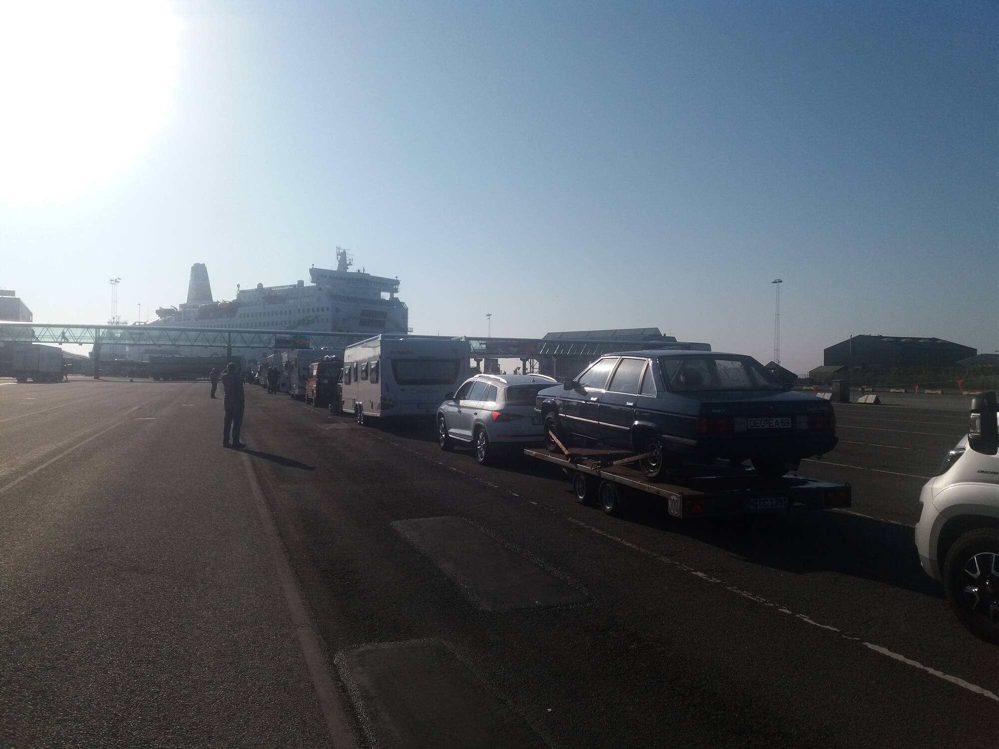

We never found the time to fix it. So there the Tagora goes. On the way to meet his brothers in Norway. Good struts, bits and pieces in the trunk. Will be a quick fix for the new owner.
