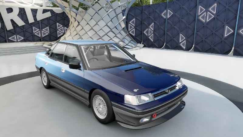

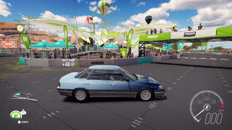

With this done, only the paint needs sorting.
Better or worse than the bomb disposal aesthetic?
The car model is actually an early Legacy, but the styling is close enough that it makes a great test bed for aesthetic messing for the 400.
Ignore the stance etc.
