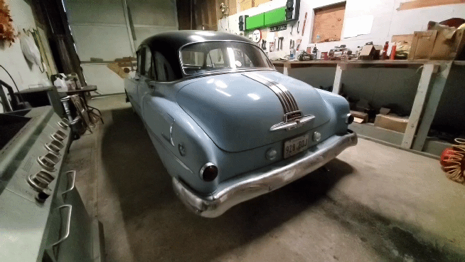

PhilA Posted February 4, 2021 Author Posted February 4, 2021 A real world test today; the Cold Morning. Left to idle on choke (can you tell?) and the screen defrost heater on, it cleared the glass quite effectively. Picture when In that picture I had arrived back from getting McMuffin and coffee, driver's window was down for the whole way so didn't defrost. Lights are evidently bright enough because cars behind backed off when I put my indicators on, even with the sun to the back of me. Phil Crackers, Tickman, loserone and 5 others 7 1

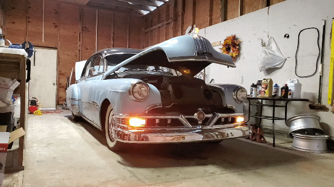

PhilA Posted February 4, 2021 Author Posted February 4, 2021 Sunlight test. Nicely visible. mk2_craig, LightBulbFun, Saabnut and 2 others 5

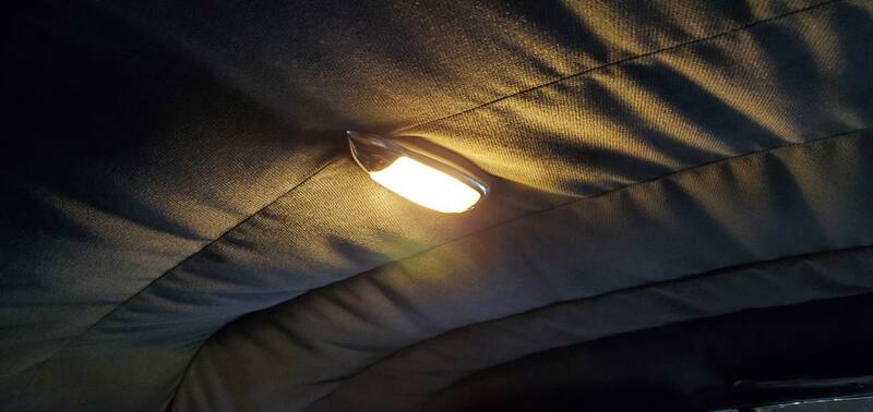

PhilA Posted February 11, 2021 Author Posted February 11, 2021 My new LED bulbs arrived in the mail. Interior light with the original 14W filament bulb in. Fitted the new LED unit, which is made from clear silicone potting compound. A bit brighter and the gamut isn't strange enough you'd day it was an LED, especially not behind the old ivory color lens. Fitted the other one under the hood, which is a bit brighter than the regular bulb. Phil Dan_ZTT, mat_the_cat and somewhatfoolish 3
