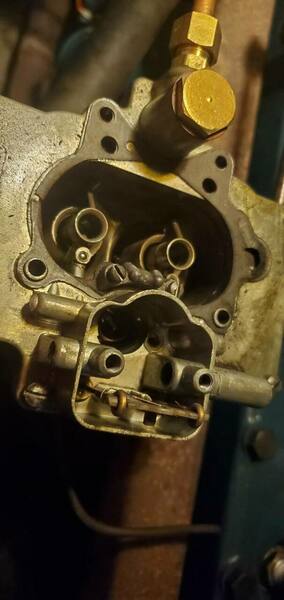

PhilA Posted October 9, 2020 Author Posted October 9, 2020 Found out why the throttle pump wasn't working; the leather seal on the pump shaft had dried out and wasn't making contact with the bore. Now it is and has been pulled into flexibility again, held out by the spring. Mechanical monkey approves mercedade, RayMK, LabRat and 1 other 4

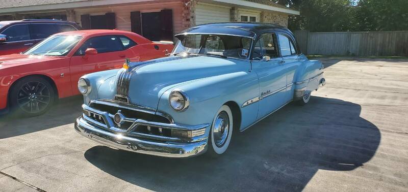

PhilA Posted October 10, 2020 Author Posted October 10, 2020 As far as we got. New Orleans, this was a stop on the way back by the Huey P. Long bridge. Gonna pull the governor out and check why it's sticky. A few things to note: Suspension is too low for the streets around here. Engine comes on cam at 2200 RPM and is a lot more rev-happy than I thought. Fuel economy isn't its forte, did 9.3 mpg over 117 miles. Floor needs sealing better, there's a few holes that shouldn't be and as the engine compartment is hotter than Hades, the air coming through is like having a hair dryer pointed up your trouser leg. It would really benefit from aircon Other than that it was okay Got home under my own steam (with no steam additional). Phil Dan_ZTT, egg, puddlethumper and 1 other 4

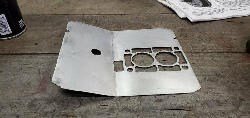

PhilA Posted October 11, 2020 Author Posted October 11, 2020 That's not a bad lineup. It's hardly using any oil (in about 140 miles it's used maybe 1/4 a pint) and some of that was short runs. It's not using any coolant at all. Engine appears to be in fine fettle. It just doesn't like getting hot. I think the carburetor needs a heat shield to protect it from the exhaust manifold. Phil LightBulbFun and loserone 2

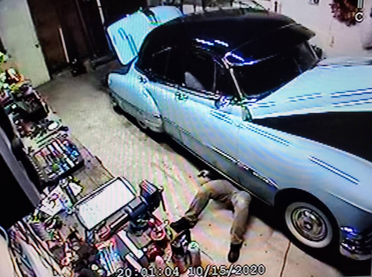

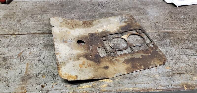

PhilA Posted October 16, 2020 Author Posted October 16, 2020 Just ordered a governor and a new side pan gasket. CCTV from last night. Nothing from under the car because oily and awkward. Should be able to get on with that midway through next week. Fuel economy is improved a bit with timing adjustment. Carburetor heat shield is on the way. Phil Dan_ZTT, puddlethumper, hairnet and 2 others 5

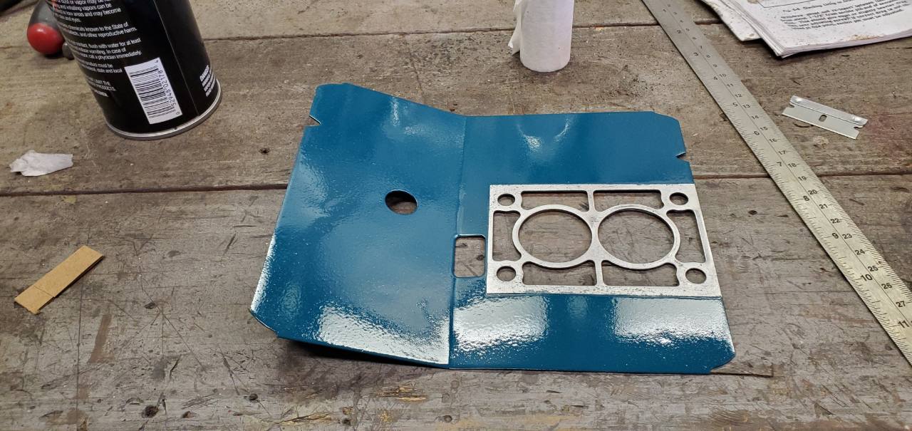

PhilA Posted October 17, 2020 Author Posted October 17, 2020 Carburetor heat shield arrived. Cleaned it up. Painted it down. That's drying now. I'll make a new gasket and fit it once the car's off jacks. Phil somewhatfoolish, mercedade, scdan4 and 2 others 5
