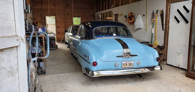

PhilA Posted August 21, 2020 Author Posted August 21, 2020 Loaded both cars into the garage, gonna board that up over the weekend. Window assembly piece arrived today though which was good. Phil paulplom and RayMK 2

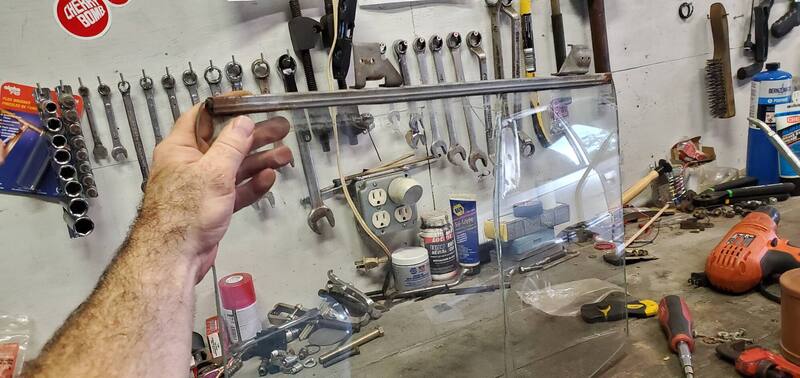

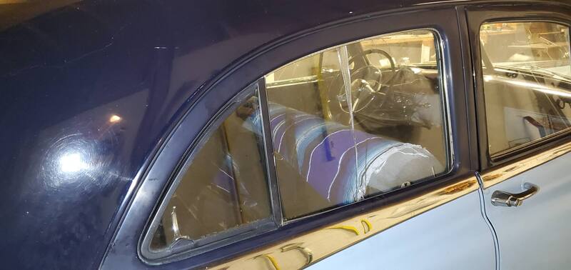

PhilA Posted August 24, 2020 Author Posted August 24, 2020 Got creative tonight. Put the sash channel back on the glass by stripping a length of rubber wire insulation and putting that I over the end of the glass and pushing the sash channel up into that. Now the glass goes up and down with care. That'll do until I can get the correct rubber strip, window felt channel and glass. Phil LightBulbFun and paulplom 2

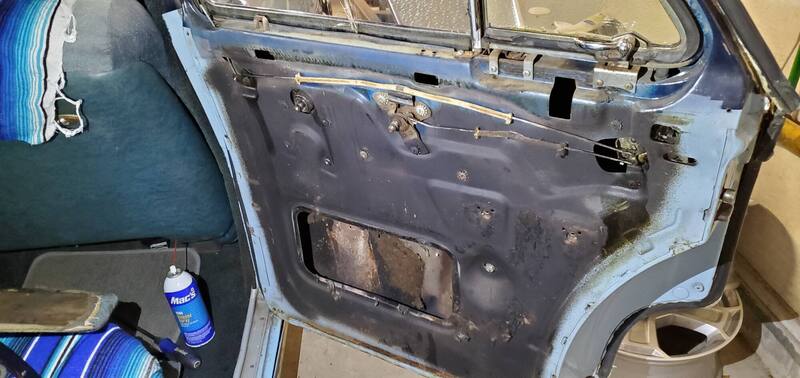

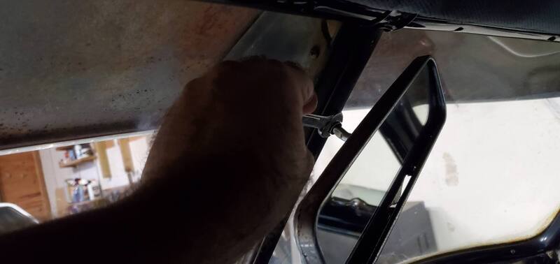

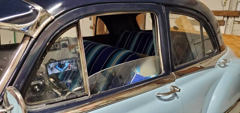

PhilA Posted August 25, 2020 Author Posted August 25, 2020 Pulled the glass out of the back door tonight and carefully eased the dash channel onto the edge, which now holds the pane flat. Got the mechanism freed up, all the moving parts back in their appropriate slots and the glass back in the door, going up and down. Fixed the rear channel back onto the upright and lined it all up. It goes up and down now, and the glue should be set by tomorrow. All windows operational now, which is good. Phil LightBulbFun, Asimo, scdan4 and 2 others 5
PhilA Posted August 25, 2020 Author Posted August 25, 2020 4 hours ago, somewhatfoolish said: Is door glass unobtanium? No, GM did a British Leyland and shared the doors between models, so the glass is available. Failing that, it is flat laminated glass so I could always get some cut to shape if all else fails. The guy I got the window mechanism parts from checked the glass and said the ones on the spares car had all started to go green and bubbly about 4" in from the edges, delamination sucks. New cut glass is available though, $50 a pop but now at least I can just slot in a new pane when I get it. Phil somewhatfoolish 1
PhilA Posted August 26, 2020 Author Posted August 26, 2020 Found out why the mechanism falls off the runners at the bottom of its travel. The panel that's been conveniently removed and discarded on this door has the stop on it. Great. So, because I can't fix that properly right now, I gave the glass a deep clean instead. Comes up all nice, at least. Phil scdan4 and LightBulbFun 2

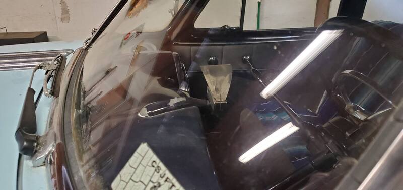

PhilA Posted August 26, 2020 Author Posted August 26, 2020 After work today, I decided to carry on with the glass as a short task because in the lull of the storm it gets all hot and airless. Significant improvement, without fancy polishes and stuff. From inside, it's clear (get it?) that made an improvement. I since removed the Joint Auxiliary sticker because I'm not part of that, it expired in 2011 and my inspection sticker has to go there. I also need to find out why the interior mirror doesn't stay where it's put, it should lock in both day and night positions but it's currently stuck in the night one. Phil paulplom, scdan4 and LightBulbFun 3
