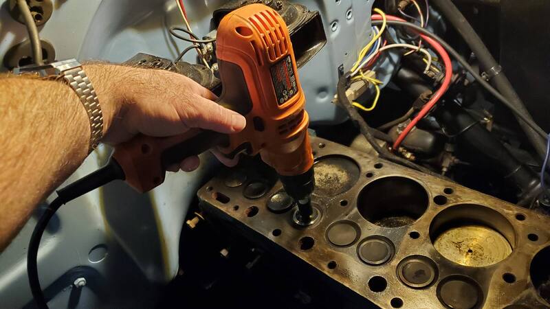

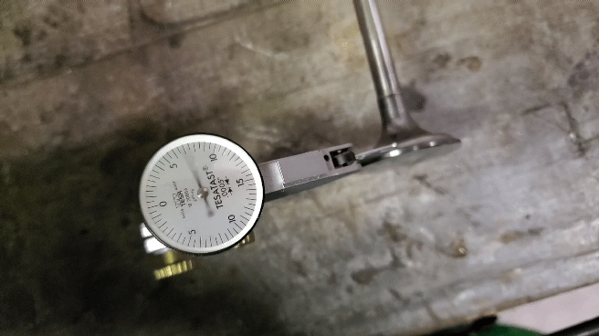

PhilA Posted December 19, 2019 Author Posted December 19, 2019 I bought a new valve tool because the lapping of the second exhaust valve was taking a little long by hand. Pulled one suction cup off. Made an adapter out of a screwdriver tool. Gently wizzed it down with the drill. Not the correct way but it is a quick way to remove deep scoring of the seat, finishing up with light pressure by hand. I pulled the valve out to inspect- it's worn a deep groove in one side and has hardly touched the other. That's no good. Out with the dial gauge. Aw, crap. Hadn't noticed before that there head was bent. Even without the dial gauge you can see the head has a wobble in that animation. There's no signs of mechanical trauma so either it was manufactured bent or wasn't heat treated correctly and has gone bad in use. Either way it's junk and needs a replacement. I'm going to pull all the valves out and check them, then see if any others are unserviceable. Phil Skizzer, purplebargeken, GrumpiusMaximus and 5 others 7 1

PhilA Posted December 21, 2019 Author Posted December 21, 2019 Started pulling out and cleaning up valves. They're all good apart from just that one. Need to rotate the crank round to get the last 4 out. Tomorrow for that. Phil LightBulbFun, DeeJay, paulplom and 3 others 6
PhilA Posted December 22, 2019 Author Posted December 22, 2019 Block looks bare now. Seats all look pretty good. All valves cleaned up. Collets, springs, spring houses, hats and bases all need cleaning- I did 2 sets then got fed up having my fingers in gasoline. I'm thinking about getting an ultrasound bath. But, only one valve is bad. I'm guessing manufacturing fault. Phil Skizzer, Broadsword, somewhatfoolish and 1 other 4
