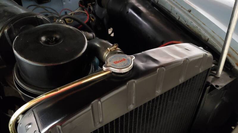

PhilA Posted November 17, 2019 Author Posted November 17, 2019 On the car the redone light does look better. I need some more lacquer to do the other side. Refitted the radiator barf tube after giving it a clean. Need to flux and solder that in place. Strobe light shows cylinder 8 and 1 firing at the same time. Cap is certainly bad then. Phil paulplom, Sudsprint, Tickman and 2 others 5
