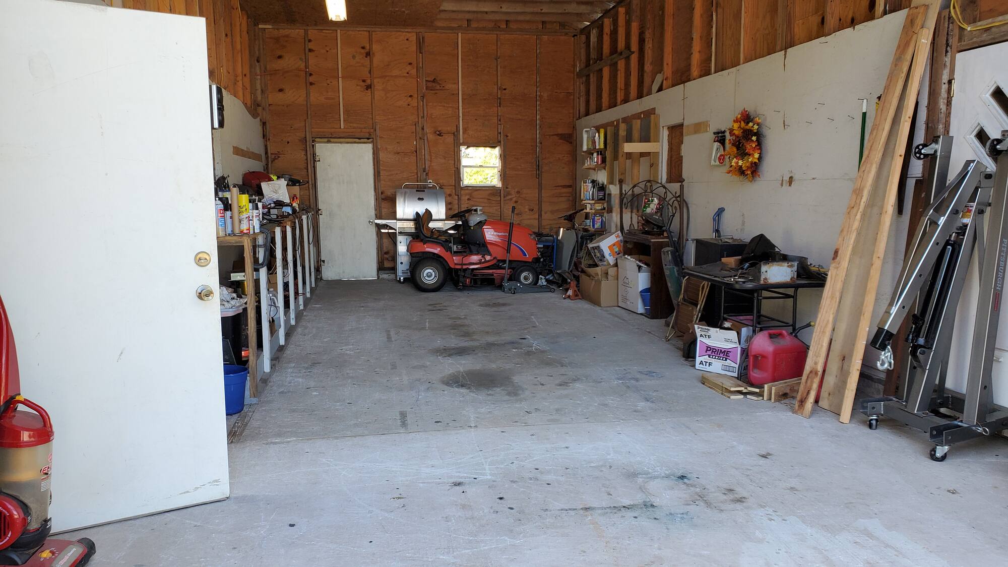

PhilA Posted October 13, 2019 Author Posted October 13, 2019 Cleaned the garage out, needed doing thoroughly. Much nicer place to be in now, it was all dusty and horrible. Took the opportunity to rinse the dust off the car also. Added another couple quarts of oil to bring the gearbox up to full (idle, warm, shifter in Dr). Need to top up the engine oil but it's right halfway between low and full so that's not a huge rush. It's getting better. I think I may need to slightly adjust the bands but it's changing gear quite nicely now. Phil MorrisItalSLX, vulgalour, mercedade and 8 others 11

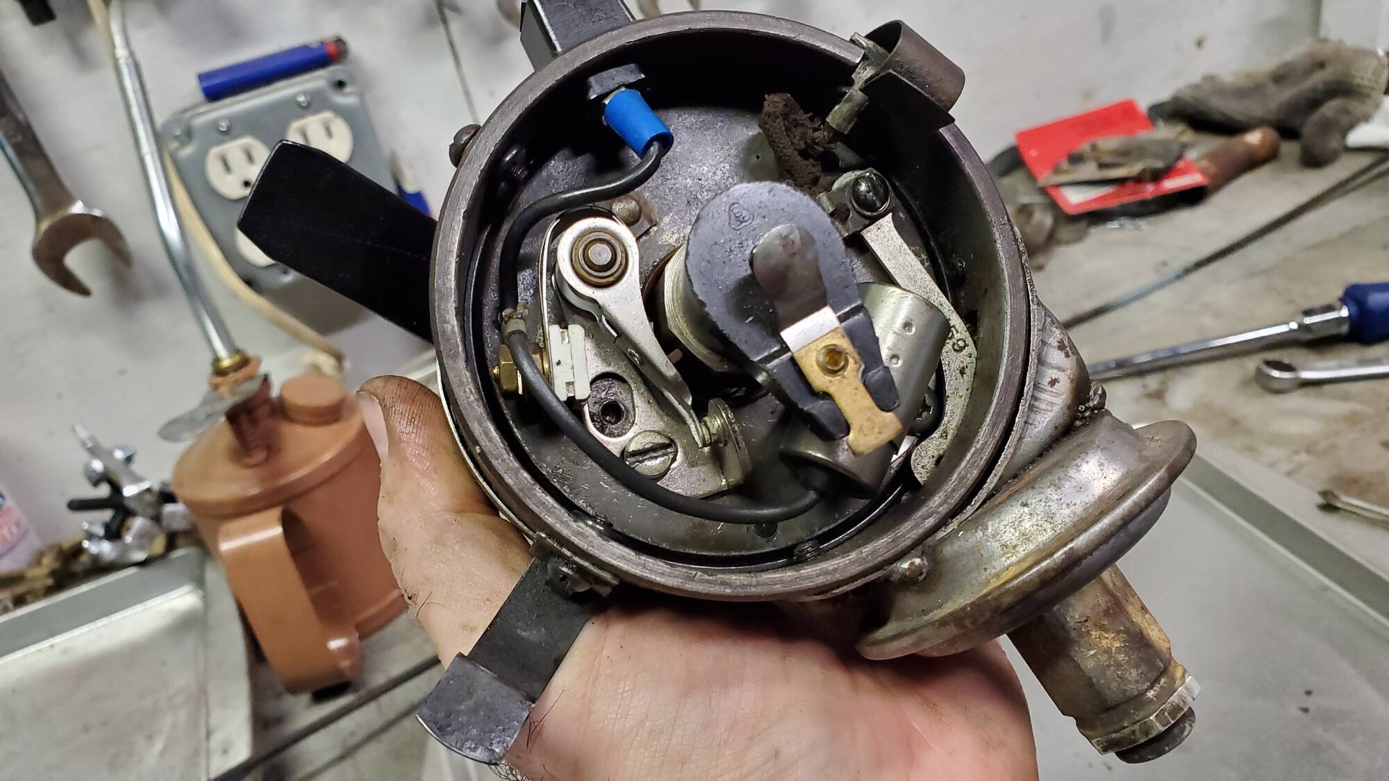

PhilA Posted October 14, 2019 Author Posted October 14, 2019 Nope, dizzy is all loose and falling to bits. Cowboy been in there! (Before me) Waiting for it to cool off enough to pull the dizzy out, gonna take it to bits and service it. Phil paulplom, LightBulbFun and somewhatfoolish 3

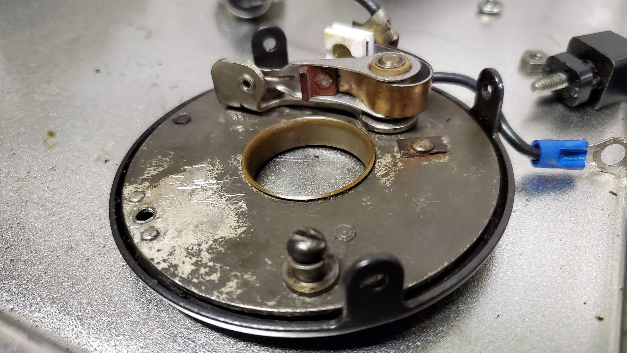

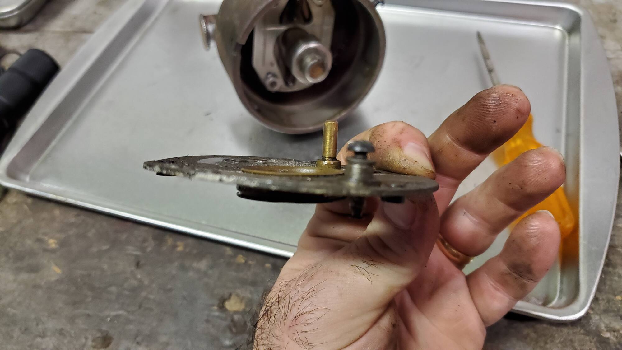

PhilA Posted October 15, 2019 Author Posted October 15, 2019 5 hours ago, beko1987 said: In terms of this project that probably means as much to you as me fitting a new wiper blade because now winters here it became very quickly apparent my old one was fucked... Good to see it driving though, I guess with a car like this 1/4 of the work is setting it up once its moving. Bet the first proper big boy drive you do has every tool needed for almost anything that could go wrong in the boot. .. Pulled the distributor out. Took the thing to bits. This is the plate that moves under vacuum. It's not meant to be all bent up. I beat it a bit with a hammer Reassembled a lot more flat. All put back together and running. Redid the timing. Still getting to be a problem, ran out of time to troubleshoot the fuel. Phil paulplom, vulgalour, Skizzer and 2 others 5
PhilA Posted October 15, 2019 Author Posted October 15, 2019 Odd misfire that clears itself. Gears change nicely though. Phil Skizzer, somewhatfoolish and Crackers 3
