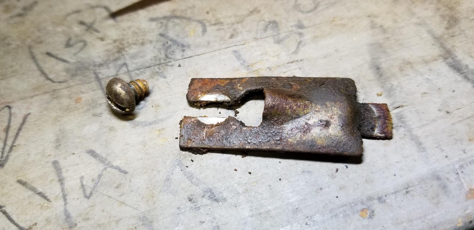

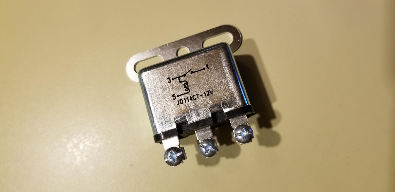

PhilA Posted October 19, 2018 Author Posted October 19, 2018 Relay was delivered about 20 minutes after I went home for lunch. Go figure. Really need to get that screw out now. Also need to get some bullet connectors. Phil

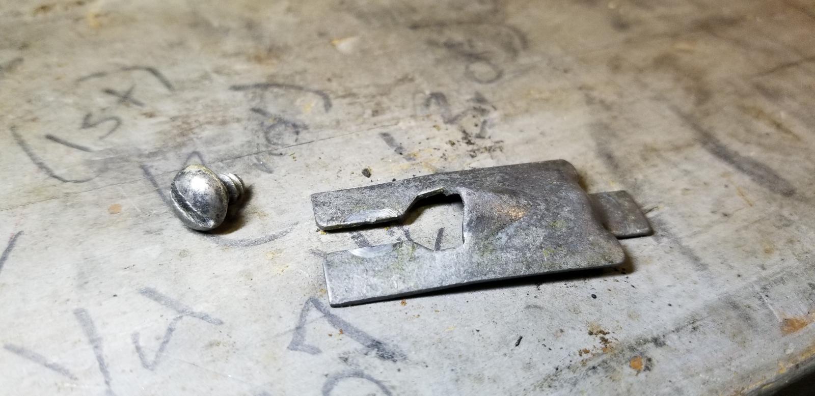

PhilA Posted October 19, 2018 Author Posted October 19, 2018 Relay arrive. Judicious quantity of torque applicator. By the feel of it, probably close to 40lb/ft to undo it. Huzzah. Can't do anything else with it tonight but it's ready to poke the wire up through now. Phil Skizzer, Scruffy Bodger, Squire_Dawson and 1 other 4

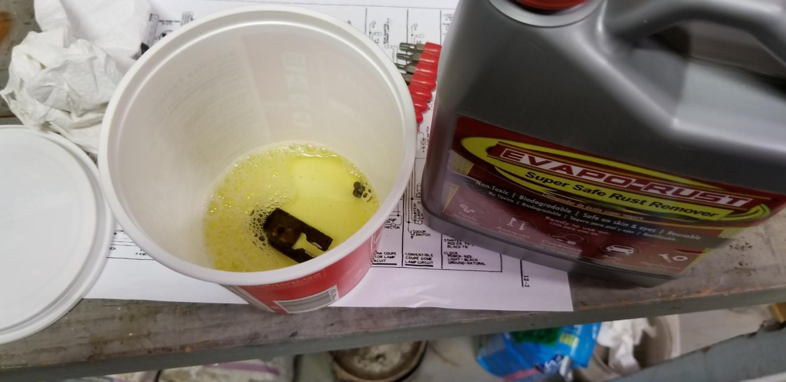

PhilA Posted October 19, 2018 Author Posted October 19, 2018 Now quite true. I put them in some derusting solution to sit and clean up. Phil eddyramrod and LightBulbFun 3

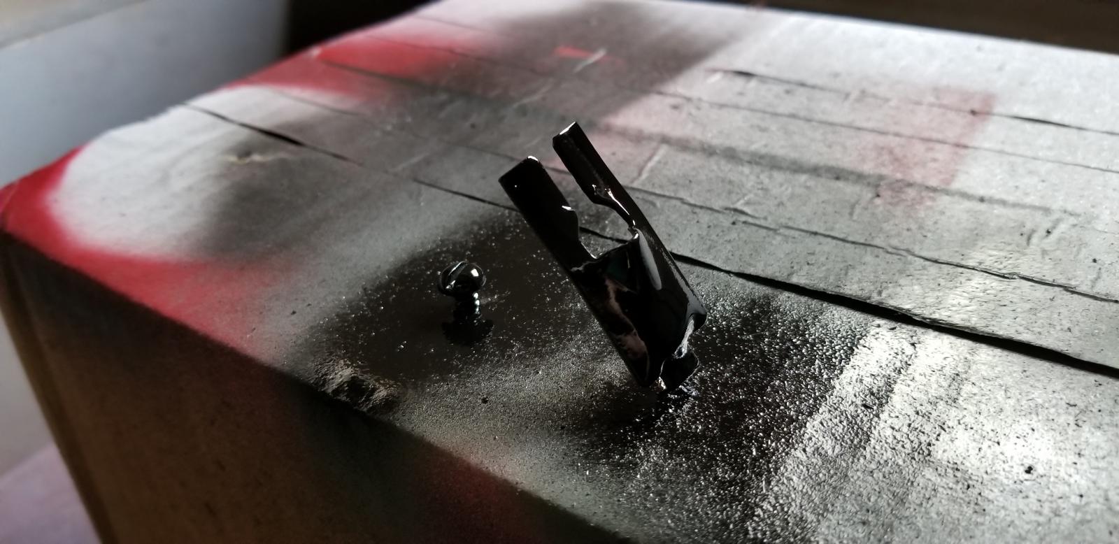

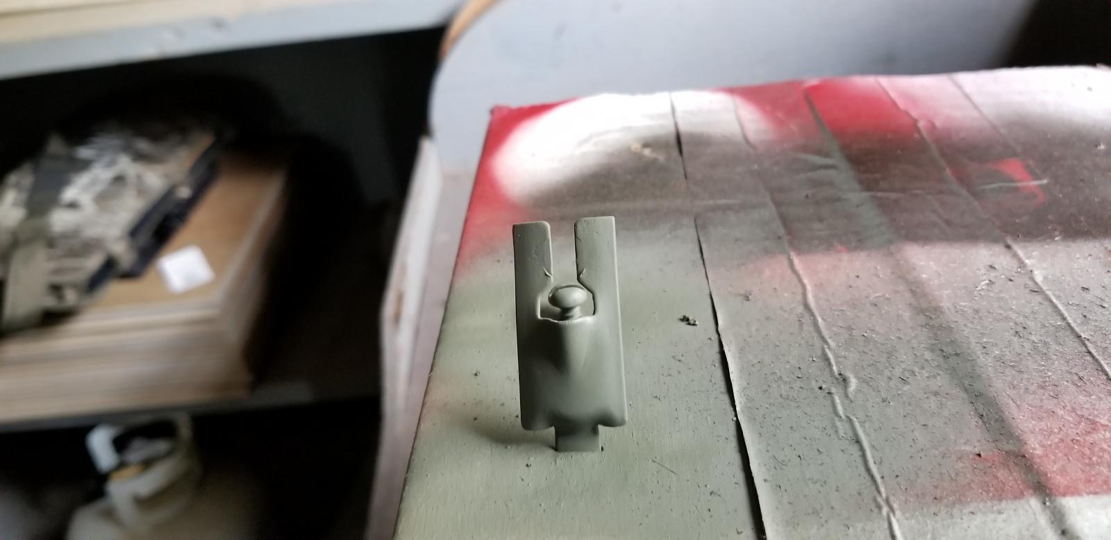

PhilA Posted October 20, 2018 Author Posted October 20, 2018 I have to say this elixir works. Primed. And painted. Looks like it's fixin' to rain. Phil Squire_Dawson, xtriple and Skizzer 3

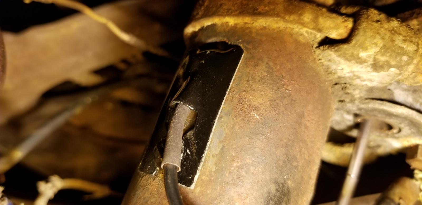

PhilA Posted October 20, 2018 Author Posted October 20, 2018 Employed a little help and got the horn wire pulled down through the column (first pushed a stout wire up, crimped to it then pulled the new one down). Gently tapped the bearing in place. Shall put a heat shrink over the wire where it comes out then clamp it down. Bullet connectors next. Phil LightBulbFun 1

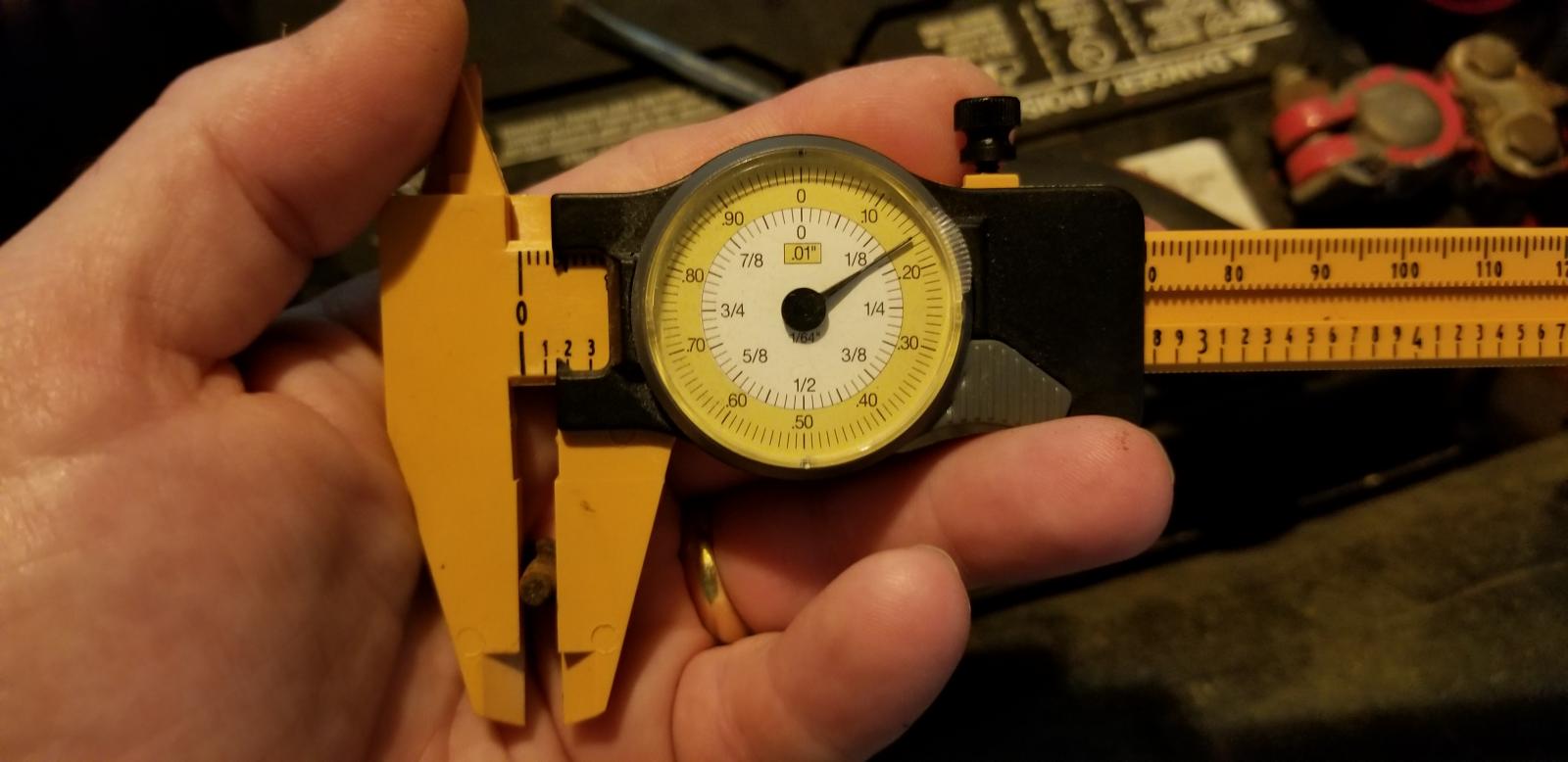

PhilA Posted October 21, 2018 Author Posted October 21, 2018 Digression there; back to the car. Measured up for new fork terminals. They're #8 stud (0.16"). Checked the fuse box and they're the same. Found some right angle fork terminals for the fuse box, too. I think I'll need a funky crimp tool for them also. Regular fork terminals will have it looking weird and majorly untidy. Phil

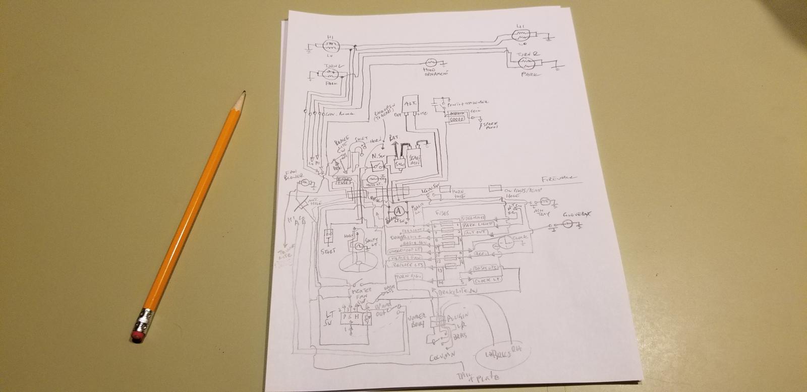

PhilA Posted October 21, 2018 Author Posted October 21, 2018 Starting on wiring layout, what goes where. Needs redoing bigger but it's a start. Phil Microwave, SiC, mrbenn and 8 others 11
SiC Posted October 21, 2018 Posted October 21, 2018 That's far more readable than many BMC/BL wiring diagrams! Not tempted to rip it all out and wire it in your own way? Can't be many circuits on it.
tooSavvy Posted October 21, 2018 Posted October 21, 2018 Photograph it, with yrr phone.... Use a projector to image it onto the inside of the garage door then line out with a felt tip = Big Enough ? LightBulbFun 1
LightBulbFun Posted October 21, 2018 Posted October 21, 2018 Photograph it, with yrr phone.... Use a projector to image it onto the inside of the garage door then line out with a felt tip = Big Enough ? a high DPI scanner would be best its literally a vector drawing after all
PhilA Posted October 21, 2018 Author Posted October 21, 2018 That's far more readable than many BMC/BL wiring diagrams!Not tempted to rip it all out and wire it in your own way? Can't be many circuits on it.Trouble with that is while you are correct and there's about a much wiring in it as there is your MGB, there's only a few paths for things to take though the firewall. This is mostly so I can get into my head what's going to be loomed together where, in what gauge and color. From the engine bay there are, uh, 4 legs of loom. Engine loom, lights loom, rear of car loom and heater loom. Inside most things go to one of these, some go in and out of the firewall in a rather pointless fashion to external fuses. All of it has been ripped at and is horribly messy right now. So, I'll be keeping mostly to the original paths because they make sense but using modern wire, and stuff in multiple colors to try aid future troubleshooting. Phil somewhatfoolish and tooSavvy 2
PhilA Posted October 21, 2018 Author Posted October 21, 2018 Photograph it, with yrr phone....Use a projector to image it onto the inside of the garage door then line out with a felt tip = Big Enough ? I was just thinking two sheets of paper, taped together. Phil Momentary Lapse Of Reason and tooSavvy 2

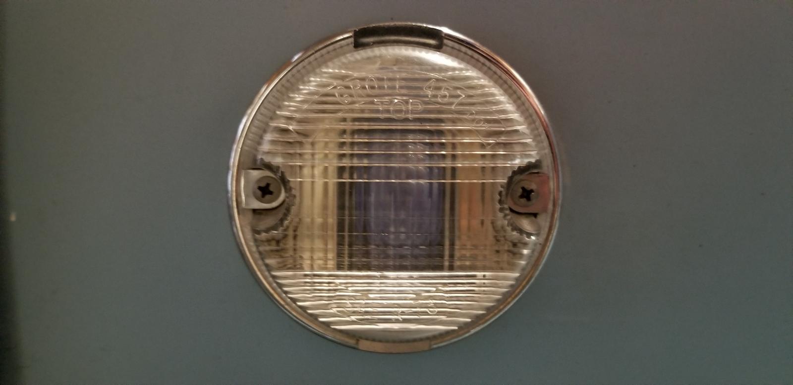

PhilA Posted October 21, 2018 Author Posted October 21, 2018 Bought the correct bulbs for the reverse lights (30W) and fitted them.Silverstars so they've got that funny pale blue covering. They didn't have the regular ones. Also got a replacement for the license plate lamp that I accidently smashed. Bought some soap and a brush to clean up the upholstery. Phil dome, mercedade, LightBulbFun and 9 others 12
PhilA Posted October 21, 2018 Author Posted October 21, 2018 All protected and clamped down. Connectors going to be on order soon. Little by little. Phil Skizzer, tooSavvy, Rocket88 and 1 other 4
