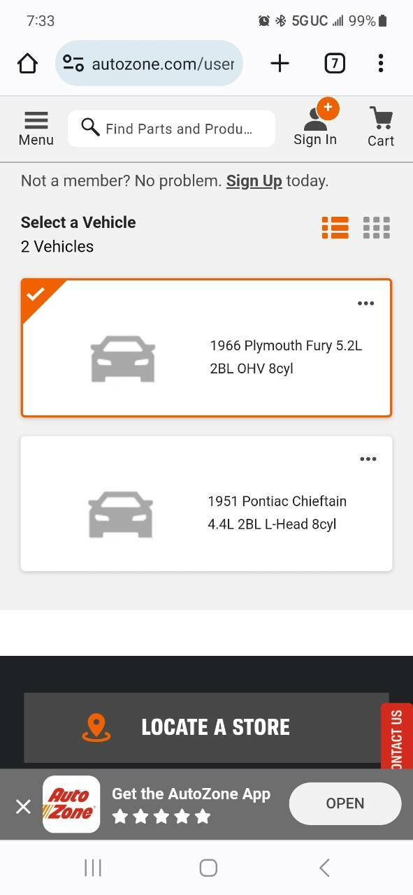

PhilA Posted September 20, 2023 Author Posted September 20, 2023 1 hour ago, 2flags said: I love the fact that you can still get the parts for a 70+ year old car. There are lots of cars only 15yrs old that you are told, "Sorry sir, we don't do those anymore." What's more amusing is even the big box stores have the cars listed, and a large volume of parts- often with the more common bits in stock. Try the same "locate parts for my cars" on Halfords or ECP and see what comes up. A-Z have cars listed back to 1930. Phil lesapandre and GrumpiusMaximus 2

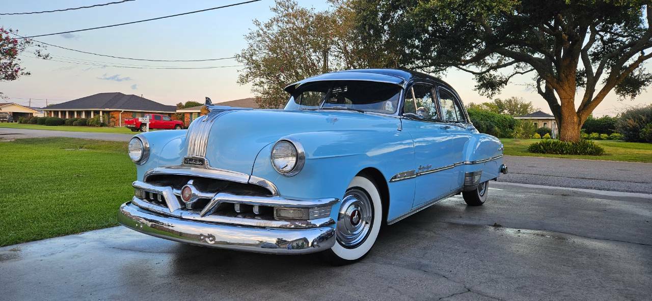

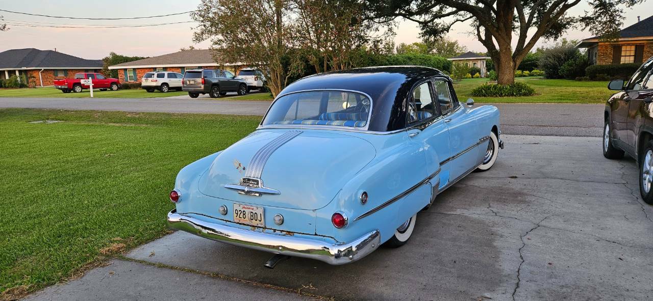

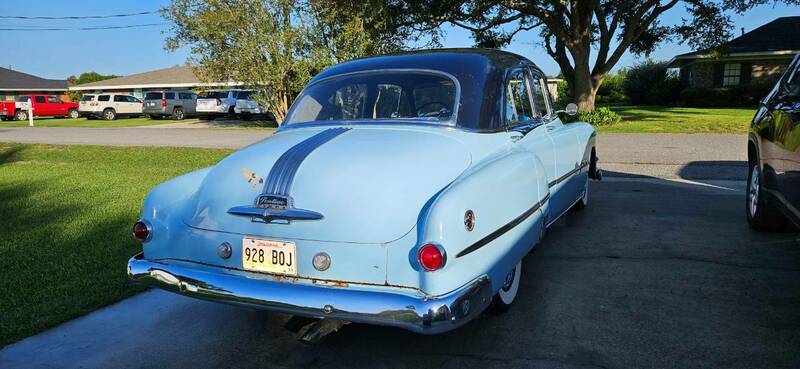

PhilA Posted September 22, 2023 Author Posted September 22, 2023 Had a little time after work free, so broke out the polish. Got the roof and back end done before running out of time. Need to finish the rest tomorrow. Phil somewhatfoolish, Rocket88, LightBulbFun and 10 others 13
PhilA Posted September 23, 2023 Author Posted September 23, 2023 Looks a little more cared for now. Phil lesapandre, danthecapriman, LightBulbFun and 9 others 12

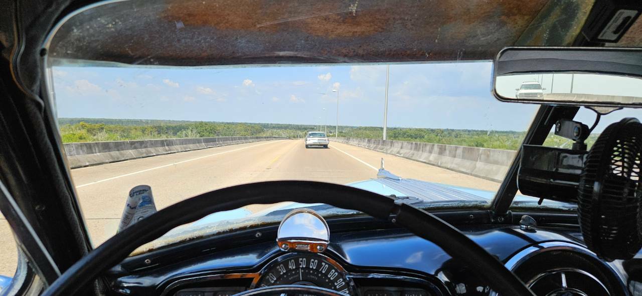

PhilA Posted September 24, 2023 Author Posted September 24, 2023 Bunch of travel today. Went had lunch in Jean Lafitte with friends. Restaurant was nice, this the view from the table. Look closely, there's an alligator. After lunch went out for a bit more of a drive, plenty more scenery. Split off from the group and went into the city to grab some shopping. Quickest way home made today a hallmark day- first time on the Interstate. Car did good, surprised that the other drivers were so well behaved. I was doing the speed limit which helps (though that means the rest of the traffic is doing 5-35mph faster). 12mpg average which isn't bad considering how fast I was going. Phil djim, Lankytim, mk2_craig and 13 others 16

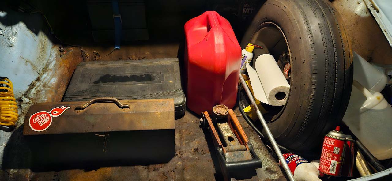

PhilA Posted October 1, 2023 Author Posted October 1, 2023 Trunk packed. Also, new green light arrived for gearshift indicator. Works nicely. Happy with that. Phil lesapandre, Saabnut, Zelandeth and 11 others 14

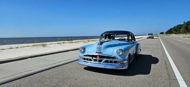

PhilA Posted October 1, 2023 Author Posted October 1, 2023 Cruise: achieved. lesapandre, loserone, mercedade and 17 others 20

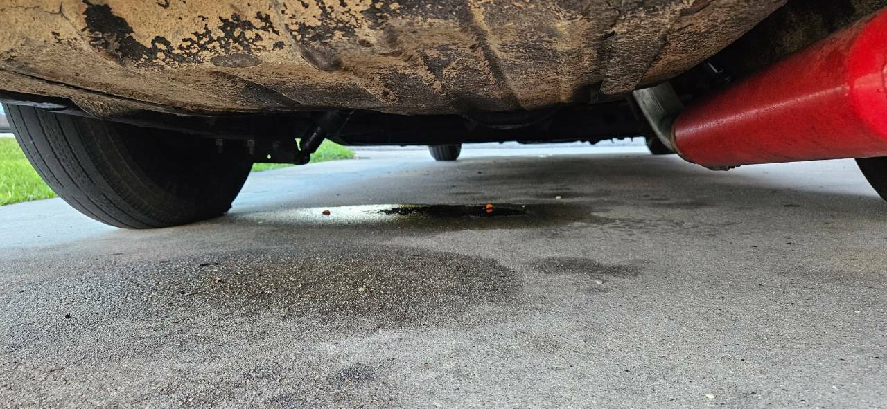

PhilA Posted October 4, 2023 Author Posted October 4, 2023 I pulled the plugs to check see after that run back. Not bad, a little pale perhaps. I tweaked the mixture slightly and will check them again, but at 60 the majority of the mix is coming from the main jets anyway. Turns out the pinion seal is unserviceable after this trip. Hardly surprising. I'll see about ordering a replacement. Pulled the dash out, which is a horrible job at the best of times. Lubricated the speedometer cable, pulled the speedometer mechanism apart, found a little felt pad under a tiny freeze plug looking piece and oiled it up. The speedometer is a lot more smooth to turn now so that's good. Adjusted the hair spring tension to try and correct the speed reading. That's now 60 by my GPS. Close enough that I have no immediate urge to remove it all again. A couple of the lights in the dash had failed segments so I replaced them. With the leftover good pieces, I took the bulb out of it's base and created an LED version of it. After a bit of calculation of the resistor value, it works nicely. Means all the gauges now light up the same color, something that had been bugging me since I changed the tachometer. Phil lesapandre, DSdriver, Dan_ZTT and 16 others 19
PhilA Posted October 5, 2023 Author Posted October 5, 2023 Just ordered some spares for the car. Mostly rubber components. Typically the most needed part is on back order (pinion seal). Phil lesapandre 1

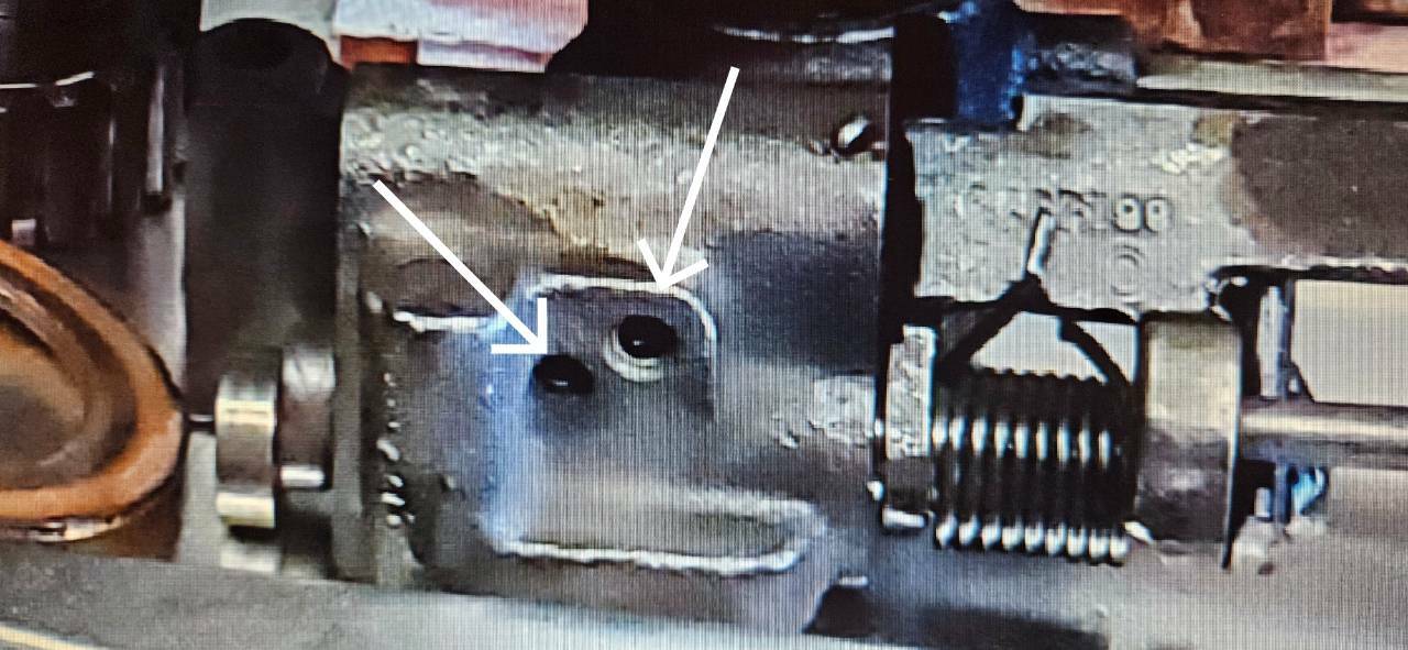

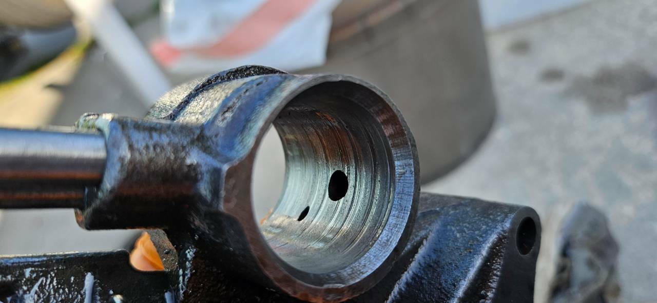

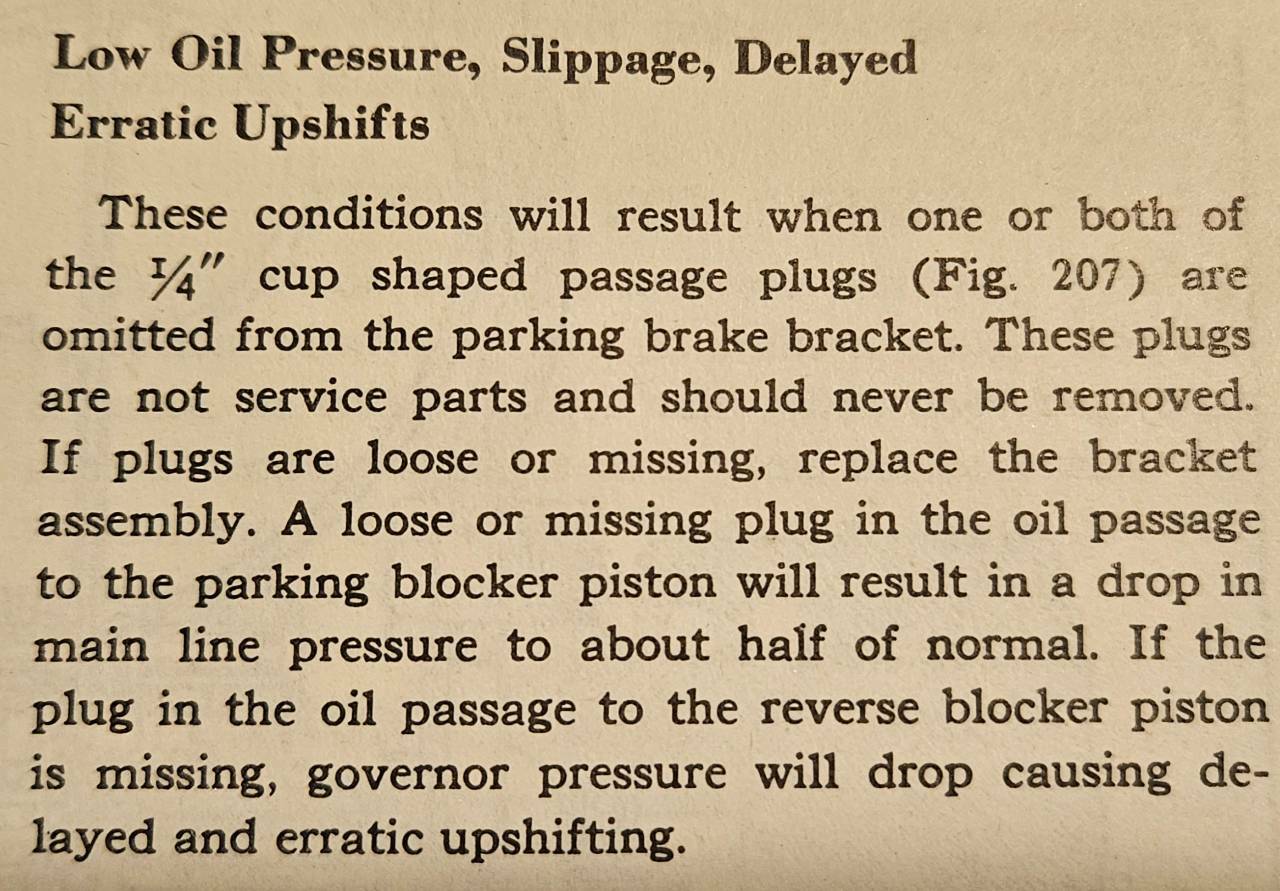

PhilA Posted October 6, 2023 Author Posted October 6, 2023 I decided to dick about with the transmission tonight to see if I could improve the hot upshifts. No joy upon adjusting things so it didn't hit a complete stop. So I returned to the book and reread the diagnosis guide. I read a passage I had skipped over many times because it starts "low oil pressure", which I don't have. ...I never checked those two plugs. There's a good possibility the governor side one is leaking. I'll check it when I can (gearbox apart again, fun). Phil Rust Collector, mercedade and RayMK 3
PhilA Posted October 6, 2023 Author Posted October 6, 2023 Went dog through old photos and this is the best I have. Inconclusive. Need to pull it apart and check those two plugs. lesapandre and Rust Collector 2

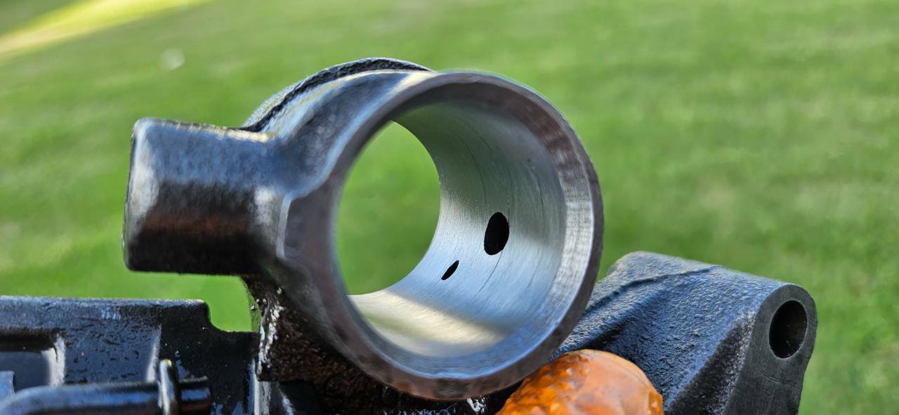

PhilA Posted October 7, 2023 Author Posted October 7, 2023 The plugs are good. The sleeve bore - I had forgotten how bad that was. So it was made less bad. It still doesn't work right, but it's a bit better. The reverse lockout doesn't work though. That might be all of the issue. I can't get it out because it's got a double crimped pin. I might be getting a replacement, so if I do first I'll try that, second I'm going to pull this one to bits, especially if that fixes it. Phil RayMK, Rust Collector, Garythesnail and 4 others 7

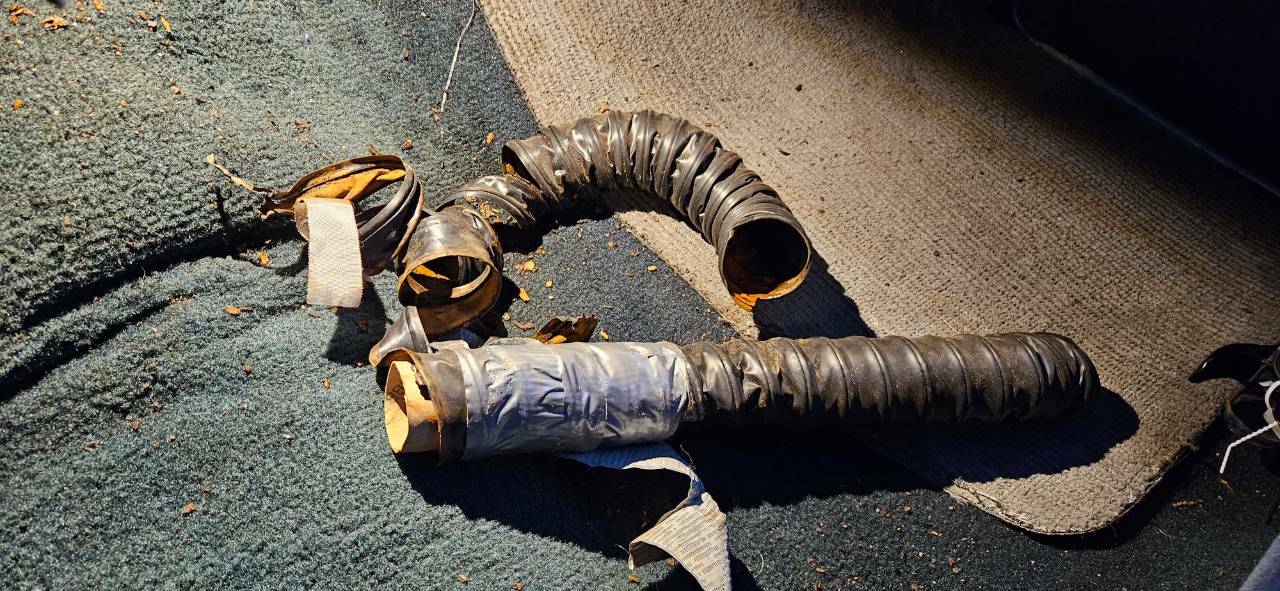

PhilA Posted October 12, 2023 Author Posted October 12, 2023 Cold weather here, briefly. Transmission is working beautifully. Spare part on the way; if that doesn't fix it I'll stick some heavier oil in it and call it a day. Replaced the passenger side screen defrost tube. It wasn't working any more. Phil Dan_ZTT, RayMK, LightBulbFun and 5 others 8
