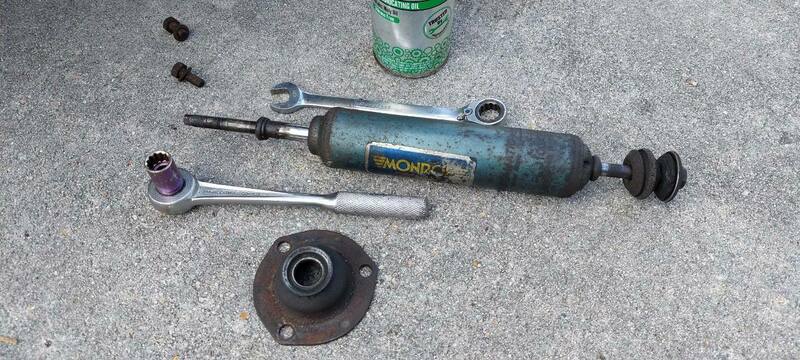

PhilA Posted May 5, 2022 Author Posted May 5, 2022 I don't mean to put a damper on things, but this is shocking. Noel Tidybeard, Crackers, LightBulbFun and 2 others 1 3 1
hairnet Posted May 5, 2022 Posted May 5, 2022 didnt know they did boing thought only electrical the pic when you went for a malt................ and the chief is a big car ffs PhilA 1
PhilA Posted May 5, 2022 Author Posted May 5, 2022 2 hours ago, hairnet said: didnt know they did boing thought only electrical the pic when you went for a malt................ and the chief is a big car ffs Nope, they do allsorts of car bits. The original dampers would have been Delco. The old ones were very very very knackered Monroe Manumatics. As you can see, they fully extended under their internal pressure... Nope. Driving the car now- major difference. Like seriously major difference. It's highlighted the rear shocks are also completely shot... Phil Tickman, mk2_craig, somewhatfoolish and 1 other 4

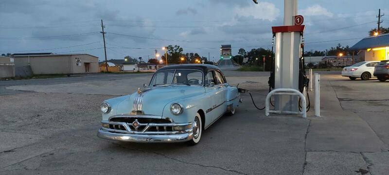

PhilA Posted May 6, 2022 Author Posted May 6, 2022 Went fuel up tonight. 8.7mpg, but the radio has fixed itself and it doesn't like this fuel much, need to tweak the timing and mixture again. Phil LightBulbFun, Dan_ZTT and somewhatfoolish 3

LightBulbFun Posted May 6, 2022 Posted May 6, 2022 im curious, you use this lovely car pretty regularly which is really awesome to see how many have you clocked up in it? I really do love how its being used, as it would of been 71 (bloody hell) years ago, not too many modern upgrades much, still its glorious flat head straight 8 driveline, its just been expertly fettled back into good health just wonderful to see because you just dont see this anymore, I love how its not even a weekend only toy I love how its just used as a "alright i need to get something from the shops" and you look at the driveway and go yeah ill take the Chieftain, type car still Matty 1
PhilA Posted May 6, 2022 Author Posted May 6, 2022 11 minutes ago, LightBulbFun said: im curious, you use this lovely car pretty regularly which is really awesome to see how many have you clocked up in it? I really do love how its being used, as it would of been 71 (bloody hell) years ago, not too many modern upgrades much, still its glorious flat head streight 8 driveline, its just been expertly fettled back into good health just wonderful to see because you just dont see this anymore, I love how its not even a weekend only toy I love how its just used as a "alright i need to get something from the shops" and you look at the driveway and go yeah ill take the Chieftain, type car still Yup, it performs as An Car quite well. I've done about 3500 miles in it so far, which isn't too bad, considering. Phil Jenson Velcro, Matty, Dan_ZTT and 3 others 6
