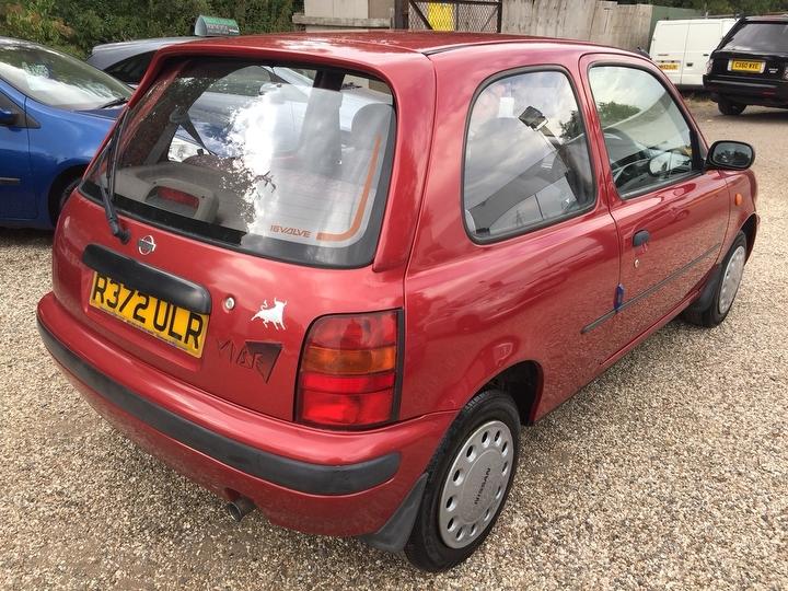

pandamonium Posted August 14, 2018 Posted August 14, 2018 I'm going to look at a Micra this week, 1998, 1.0. Looks good, but is there anything to watch out for? Are they as indestructible as people say? Is there enough legroom in the back for a 6 year old? oldcars 1
BorniteIdentity Posted August 14, 2018 Posted August 14, 2018 Isn’t there some kind of crossmember that rusts on these? Otherwise they’re robust little creatures; 1.3 is amusingly quick up to 40 but have had no experience of the 1 litre beater. oldcars 1

oldcars Posted August 14, 2018 Posted August 14, 2018 Front crossmember rusts. Sill ends go as i think if it has a sun roof they drain into the sills. Loved mine, K11's are great. Rear legroom was fine on mine.

JeeExEll Posted August 14, 2018 Posted August 14, 2018 There was a thread on here recently with useful info on the K11. Unfortunately 'K11 Micra' is not in the thread title and I can't find it. Anyone remember? My Mrs had a 1999 1.0 3-door basic one with wind-up windows and no power steering a few years ago and it was a great wee thing to drive. Not fast by any stretch of the imagination but then it wasn't meant to be. Front crossmembers can be fixed but our one had terminal crunchiness at the rear suspension mounts which would have taken a lot of time to deal with. Also, starting work on it would undoubtedly have revealed more and more problem areas. It was broken for spares with under 40k miles on it. We think the hard Scottish winters of 2009/10 then 2010/11 ruined it.(They are excellent in the snow with decent tyres BTW, just tiny 155s if I remember correctly). Good luck, hope it's a good one.Edit, just noticed it's a 1998 1.0, so maybe no power steering on that one either. Which is a bonus IMO, a bit more feel to the steering.You really must check it thoroughly underneath for rust, ours looked deceptively mint otherwise. Got a bit of a shock when MOT came round, Mrs was in tears.
sierraman Posted August 14, 2018 Posted August 14, 2018 Rust under the back end of the sills and the crossmember. Expect it to have seen a bit of welding action already, make sure it’s been done proper as opposed to plate over stuff
JeeExEll Posted August 14, 2018 Posted August 14, 2018 https://www.check-mot.service.gov.uk/ DVLA MOT history shows up some corrosion issues previously. To be expected on a car of this age. Maybe all properly fixed and treated, who knows? 10 months' MOT so could be a cheap tidy reliable winter car, then see what next summer's MOT brings. . . .
Psycho Charlie Knobcheese Posted August 14, 2018 Posted August 14, 2018 I'm on my second one, both 1999 1 Litres.Cannot recommend them enough. I doubt there's a cheaper car to run per mile.Crossmembers rust at the front but can be replaced. Part is about £30 but replacing it is a bit 'involved'.Engine is pretty much unburstable with regular oil changes. Apparently the 1.3 and later 1.4 go a lot better than the 1.0 but mine is an absolute hoot to drive. I flog the living daylights out of it- Including a fair bit of motorway driving (mostly spent in lane 3) and it uses no oil whatsoever between (6000 mile) changes.In 3 years and 25000 miles mine has needed a drop link, cv boot and a recon front caliper- parts cost about 70 quid.Get it! BorniteIdentity 1

purplebargeken Posted August 14, 2018 Posted August 14, 2018 Mrs PBK has had two from new and they are pretty unburstable. Engine-wise they will go on forever with regular oil and filter changes. Interiors are also pretty robust. As mentioned previously the sills tend to rust at the rear, more so with the 3 door versions. Crossmembers are also an issue. Door handles can be a bit less than robust with age. Lacquer peel happens on the chewit purple and the peridot green ones. No PAS on base models. Go for it.
purplebargeken Posted August 14, 2018 Posted August 14, 2018 5'11" PBK son fits in the back quite well.
