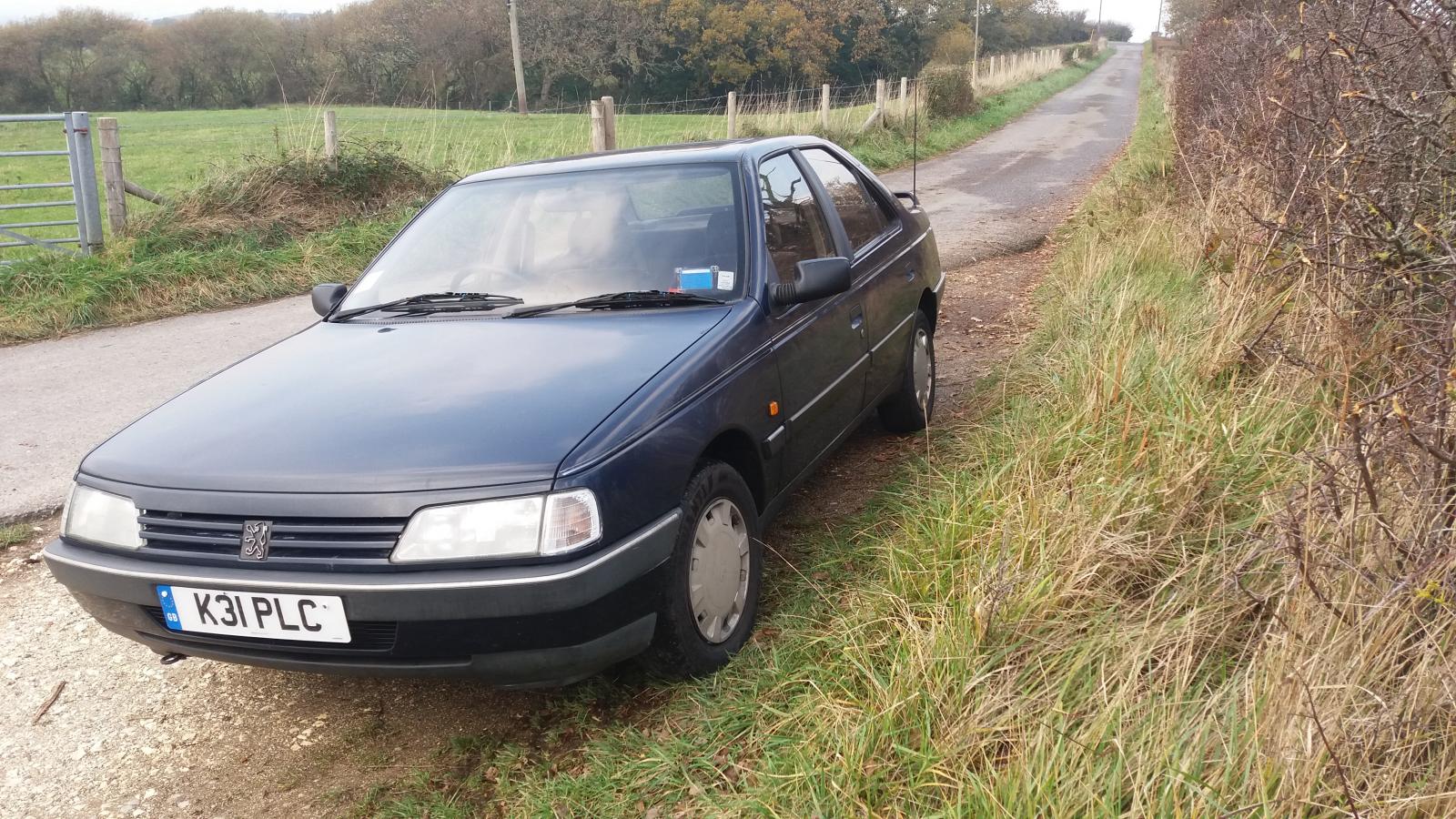

holbeck Posted October 18, 2018 Author Posted October 18, 2018 2000 miles in with the 405 now, and I reckon it's within a spit of 50 mpg, so quite happy with that. The first real rain we've had since I've owned it caused a lot of water to get in though the sunroof into the alarm sensor.Cue an amusing* episode where the alarm was going off at will until I got some new batteries for the factory alarm plip that came with the car but I had never touched for fear of causing a problem. Anyway, as the sunroof doesn't actually open, I went the easy route and sealed it. I'm off work for half term next week so the 405 will be stood down and the BX will come out to play as my daily. Stinkwheel, Lacquer Peel, davehedgehog31 and 1 other 4

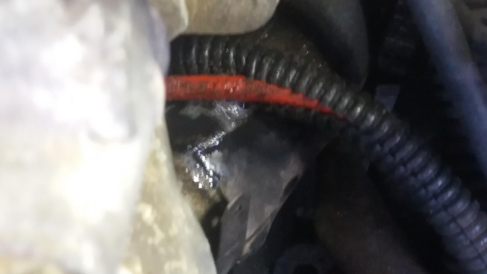

holbeck Posted October 20, 2018 Author Posted October 20, 2018 Yesterday, I did swop over to use the BX, the 405 got dumped in the garage until I realised that I needed to ferry my son around and that he needed to eat his tea on the move. My lad has to have ketchup on everything, and the BX interior is pristine. Cut a long story short, I fetched the 405 back and just as we were going out my lad noticed the pool of water under it. Investigations today reveal a split hose off the thermostat housing. Not the end of the world Lacquer Peel 1
holbeck Posted November 23, 2018 Author Posted November 23, 2018 The 405 was off the road for a couple of weeks whilst I found a replacement coolant pipe recently. I ended up getting one off ebay. I had the choice of £5 posted from Lithuania, or £12.95 posted from a UK supplier. I chose the latter as I wanted the car back on the road.It took several days for the parcel tracking number to be notified to me, but when it did my parcel was in Lithuania! Anyway, It's been doing the business as my daily but just as the colder weather starts kicking in a new problem has raised it's head. There seems to be something that feels like fuel starvation from cold. it'll start and run for a second then cut out then if it does run it's erratic at idle. I wonder if the fuel filter has had it. I've ordered a new one just in case. Angrydicky, Split_Pin, loserone and 3 others 6
