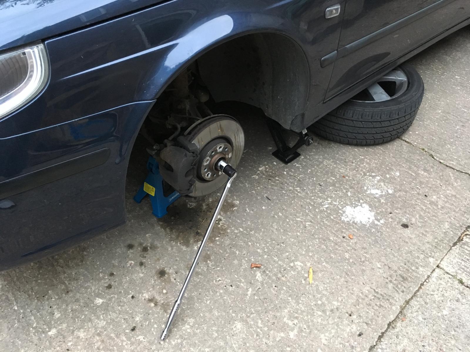

Ohdearme Posted September 15, 2018 Author Posted September 15, 2018 Oh, the bitter irony... So I thought it prudent to see if I could budge the hub but before unbolting every other bit of the car only to fall at the last hurdle and lo and behold... ...it moved! The long breaker bar shifted the nut and it came away easily enough. Excellent, thinks I, all I need do now is unbolt those torx on the calliper that has been stewing in penetrating fluid for two days and I’m in business. Oh yes! Says, I! Oh no! says SAAB. Can I move the torx nuts at all? Can I balls... I now need heat, which means more spending and I’m leaning towards giving it to a garage to sort out as I’ve got a kids party tomorrow so will get the sun total of nowt done on it. Hmmm...anyone near Castleford got an impact wrench I can borrow? Edit o add, my local motor factors came up trumps with the torx sockets, cheapest on Amazon )£12, got some for £7, keepbit local and keep ‘em alive folks!

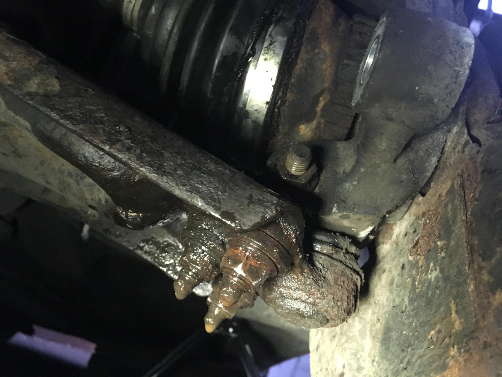

Ohdearme Posted September 17, 2018 Author Posted September 17, 2018 Had another crack at the thing tonight and moderate further progress was made by not enough to actually fix it. Pain in the arse is getting the bottom ball joint bolts out without an impact wrench, I managed o free them all up to move but couldn’t jiggle enough spanners and grips to keep the bolt still and spin the nut. Managed to free off the caliper carrier T20 with a 16mm socket and breaker bar, just to get it moving then used a proper torx to take it off but even with carrier and brake disc removed and out of my way, I couldn’t get my arms and head in there enough to get them off. Times like this I wish I had a third car again...I need to be driving tomorrow so had to reassemble it all and my lower arm bolts are not tight, luckily my local garage is literally a one minute drive round the corner, so I’ll pop in on way to work and ask them to tighten up on the promise of said vehicle returning for a horrifying list of mot required things to do before the 13th October. Other half will not be impressed at the impending spendtacular. Other jobs I did manage to do to cheer myself up. Checked the brake fluid with my testy pen - 1% moisture so no need to change just yet. Also gaffer taped up a crack in the arch liner, it’s totally pointless as the tape will be off in a week but I needed to achieve something this evening after swearing at rusty bolts all night. theshadow, scdan4 and Scruffy Bodger 3

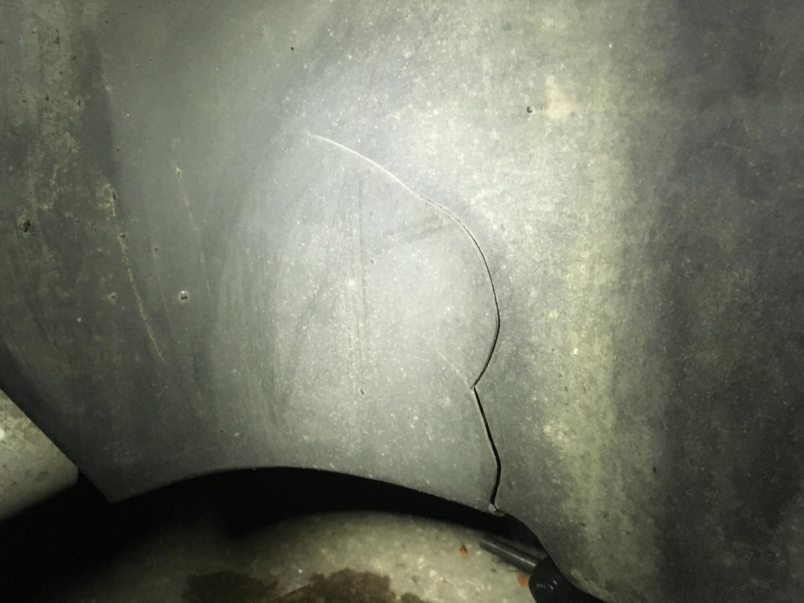

Ohdearme Posted September 18, 2018 Author Posted September 18, 2018 This is what diy defeat looks like... oldcars and theshadow 2

Ohdearme Posted September 18, 2018 Author Posted September 18, 2018 i haven’t quite given up! I got them to free off the bottom torx bolt holding the ball joint in so I can free that off and have one final crack myself when I get home.., They covered it in penetrating spray so it should spin off easily. Might need to chop out and replace the control arm bolts as they’re shot too, rusted and then rounded - lovely! Mot is due so it’s booked in for a couple of weeks, will see what I manage to do myself before then. DSdriver 1

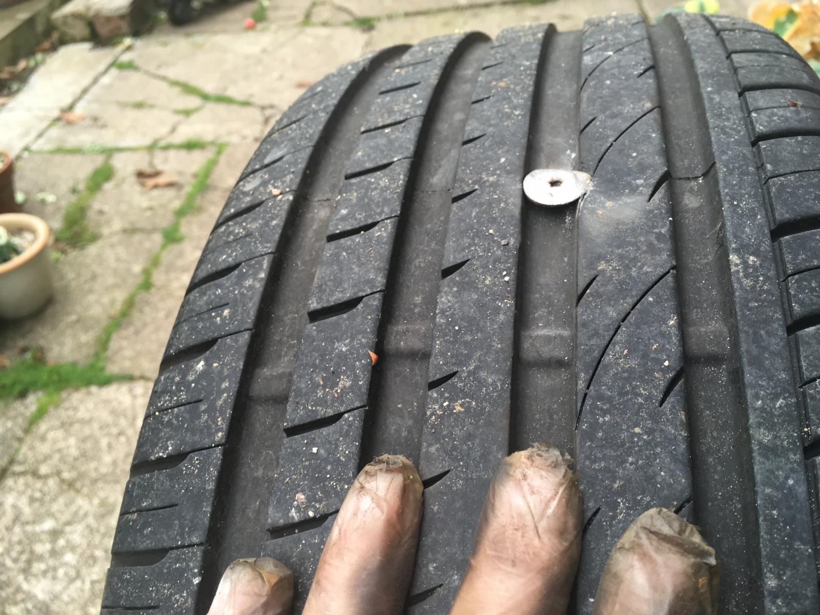

Ohdearme Posted September 22, 2018 Author Posted September 22, 2018 I think this car isn’t the best place I could have put my £950 into an Aero, I decided to at least swap front and rear wheels around as the fronts have the wrong profile and the idea of having a speedo telling me a more accurate view of my speed seems a good idea. Have a 250 mike drive on Monday and I was therefore pleased to find a honking great nail in the otherwise ok tyre. Annoyingly, it is in one of the tyres that is the correct profile for the car, so at some point I need to shell out for 4 new tyres so sort the profiles and nail. I bought a bottom ball joint so I could take out the old one and sort the cv boot but I don’t have time so it’s booked in for somewhere else to do it on 1st October. I also had a fiddle with the rear headlamp sensor, it is rusty so I unclipped and moved the arm to a new position as a test but the light still came on, although I’ve noticed a large rumble/grumbly noise at the front like the motor is trying to level and is stuck. Therefore probably another not cheap fix. I haven’t the heart to do all the bushes I bought as the general rustiness of everything has barked me at the minute. Truth be told, my mood isn’t great as I came in to wash my hands and have just spent ten minutes with my hand under the cold tap thanks to my missus randomly leaving a bowl of boiling hot water in the sink (she’d been melting honey apparently) into which I plunged my dirty hands assuming it was just tap water in the bowl.and then screamed in bloody agony. Stands at the front of the car listening for the headlights, it’s also clear the front exhaust is blowing like a trooper. Marvellous times I think the natural answer is to get a third car so I can spend the right time with the SAAB in bits. mrbenn and Scruffy Bodger 2

Ohdearme Posted October 1, 2018 Author Posted October 1, 2018 Subframe bushes may be a subframe out job ? Not a driveway task id say There's a workaround by leaving one bolt partially in and using a jack to press the sub frame up and force the bushes in, one by one. That's fine with a four post lift, less so with a couple of axle stands. Thing is, the car also needs a bunch of consumables like 4x tyres, the two rear are the wrong size, the two front, one is ruined thanks to dodgy suspension, one has a whopping nail in it. The trouble with it being a weekends work is not getting a weekend, got two kids at 2 and 3 that require significantly more maintenance than the Aero and I'm in the middle of renovating a kitchen, etc. so time is not my friend.
