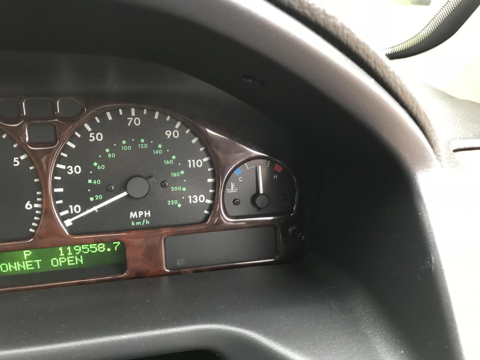

The ABS light thingy is normal. Wabco, you know.
I think mine is some sort of *special edition, probably an expensive extra, as the light stays on all the time to make the dashboard more *attractive :)
Ah bastard, I think it's broken, it does go off like everyone else's it seems, at least for today ;)

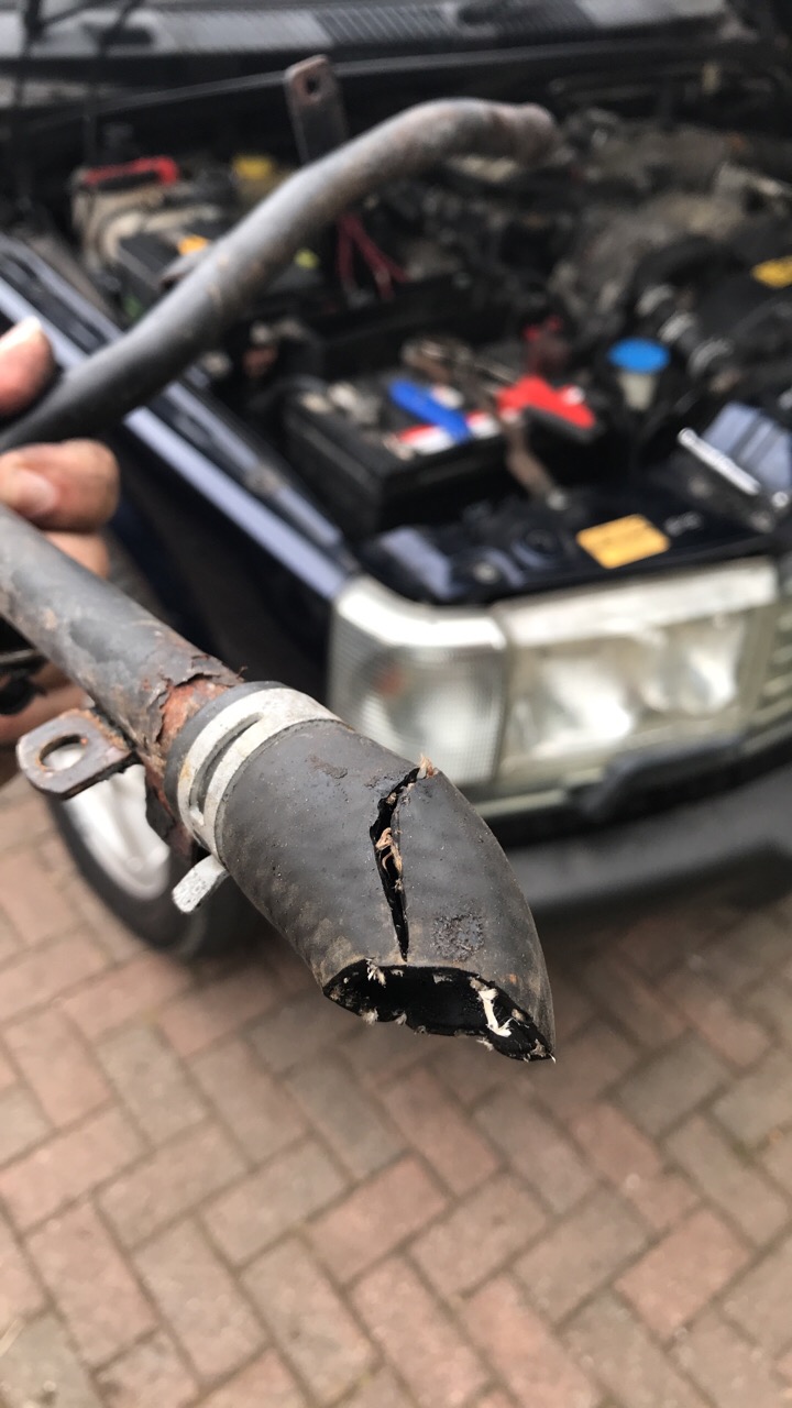

Woke up this afternoon and decided to attack the P38. Last night the engine got rather hot and I'd had a few worries over it being too hot and damaging something. Checked the oil, still nice and golden, no mayo, so I fired it up and the engine settled straight away to a nice steady burble  :-D
Next, tackling the lack of coolant.
Yeah, thats buggered.
Chopped the hose off to rejoin it but the clouds closed in, so I went to see a mate who used to run P38s instead, where I landed up dismantling a Yamaha outboard with him and driving his L322 Range Rover to try and pin down why the fuel consumption (Td6) is so poor.
Going to order a new hose set (bodging the old one back on is just to keep it mobile until I have a few hours to fit a whole new set), and replace the thermostats too - might as well while i'm in there.
