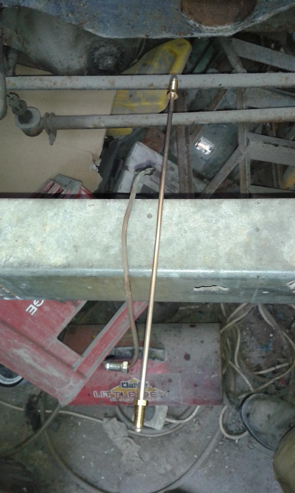

Shiny new kunifer pipe with brass ends made.
Total bastard to fit. Why they put everything in the same small space I don't know. More boring plumbing when I can be bothered to do it.

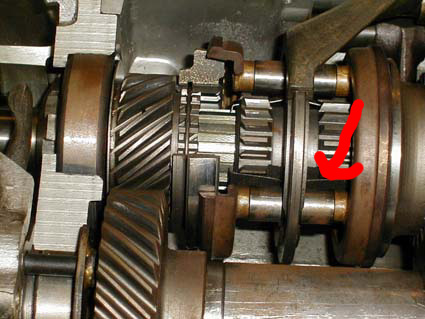

One thing I did spot is there is a spring missing from the synchro. One of these:
Don't know where it's gone, could be jamming / driving a shaft?

I'd definitely look for that missing spring. Even if it's not the current problem it might well become the next one.

Next plumbed the front end in shiny new kunifer. So all the front braking system is new

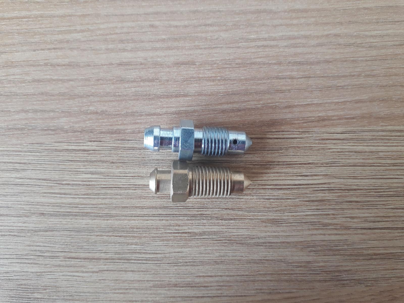

Oh joy, brilliant design land rover. Impossible to get a pipe on the bleed nipple
So I ordered some "short" bleed nipples from evilbay. Same bloody size as the land rover ones. Went on automec website, and they have "triumph specials" that are a bit shorter. Triumph must also be shit at designing things.
Much betterer. Hope of being able to get a pipe on.
