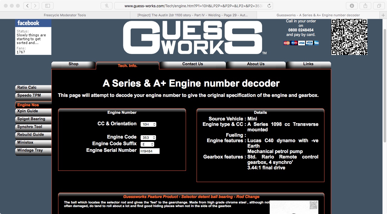

SiC Posted October 30, 2018 Author Posted October 30, 2018 Is the engine not original to the car then? (No surprise if it isn't!) Can the oil pump be inspected if removed? I know the MGB B-series one can but the A-Series is a different design and looks sealed up. Anyone fancy trying to decode it's engine tag? The best I can find is that it's a 1098cc engine from an ADO16...
sharley17194 Posted October 30, 2018 Posted October 30, 2018 TBH with you i fitted the engine back into it that came with the car so it could be original....check your logbook. The engine plate says 'hey im a bog standard 1098 from an Austin 1100' As i had it apart on the floor, for some reason i swapped the gearbox and i cant for the life of me remember why, i checked the shells and bores, they all looked good. If you have the pump off just fit a new one, you can check tolerances but i've always just binned them.
SiC Posted October 30, 2018 Author Posted October 30, 2018 Funnily enough I've been on that Guessworks website often and saw that decoder. But completely forgot about using it! Useful info that. Explains that it has had an alternator conversion - I knew the alternator is definitely not original anyway (it has Austin Rover printed on it). Can you get the heritage certificates from Gaydon for the ADO16s? Or were they the batch of archives that were burnt down.
sharley17194 Posted October 30, 2018 Posted October 30, 2018 The alternator was me.... Funnily enough I've been on that Guessworks website often and saw that decoder. But completely forgot about using it! Useful info that. Explains that it has had an alternator conversion - I knew the alternator is definitely not original anyway (it has Austin Rover printed on it).Can you get the heritage certificates from Gaydon for the ADO16s? Or were they the batch of archives that were burnt down. SiC 1
