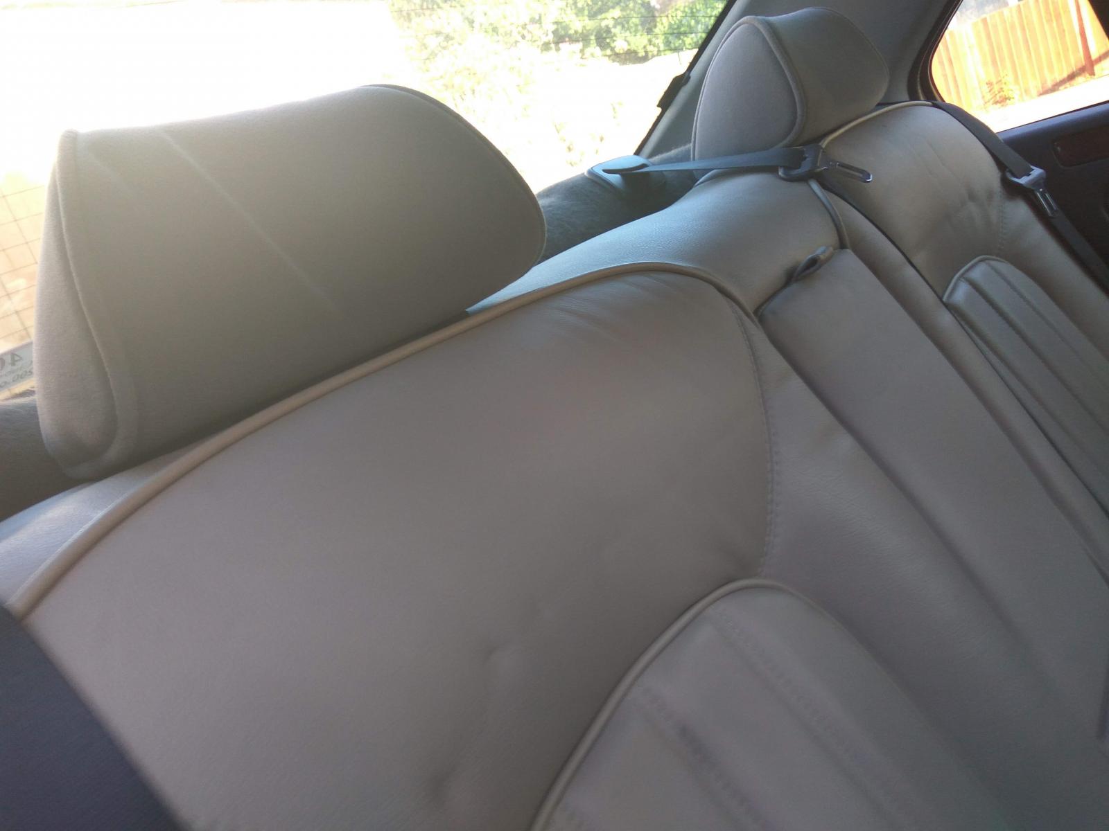

clayts450 Posted June 30, 2018 Author Posted June 30, 2018 Two seat non-coupe The PO admitted the rear seat bench was FUBARed by rodents unknown - he'd taken it out to allow his dog to sprawl out in the back and into the boot but some toothy mammals had wrecked it whilst it was laid up in a mate's outhouse. Elaborate hoax or the truth ? Who knows. 10/10 for creativity if the former. Chances of finding a sandstone beige leather rear seat bench ? Minute. Rimmers have the right size seat cover for the wrong price, and only one in stock. £50+VAT. Will keep an eye on the price and maybe haggle with them as recommended. One for the future. So for the first month it was used as a coupe. A bloke locally had been breaking an old HHR 400 saloon and he just happened to have the right size bench seat, so a trip to Sherwood midweek resulted in me grabbing this and the matching head rests. It'll do.... Blue cloth and beige leather FTW Blue cloth headrests and beige leather FTW2 No longer a coupe Aston Martin, R9UKE, Coprolalia and 2 others 5
clayts450 Posted June 30, 2018 Author Posted June 30, 2018 Seat belts minus 1 The dog adaptation also had a disappointing side result. PO had snipped the centre rear seat belt in two rendering the car road unlegal like. £15 to a breaker in Lancs and a leisurely* 150 minute stint in the car in oven heat this afternoon resulted in this: 150 minutes ? But why ? (1) Remove rear speakers(2) Remove D pillar upper trim(3) Remove parcel shelf(4) Remove lower mounting bolt(5) Remove upper mounting bolt Refitting is a reversal etc etc To be fair, the majority of the 150 minutes was me shuffling bent up double old man style to my AA truck (aka Streetshite boot) to pick up tools, due to my fucked back, not helped by endlessly lifting that mahoosive 30kg SGS 3 ton trolley jack in and out of boots and hatches (I'd also sorted out the Snoozer's brakes earlier in the week) Coprolalia and Lacquer Peel 2

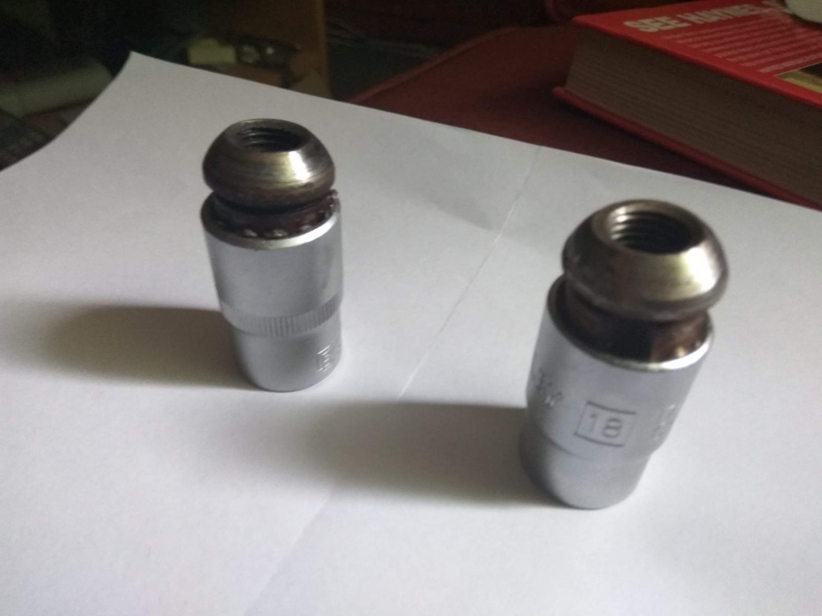

clayts450 Posted July 1, 2018 Author Posted July 1, 2018 Bathgate no more, Linwood no more, Methil no more, Loch Ingwheelnuts no more In true AS fashion off came the two remaining locking wheel nuts today (nsr/nsf) My sacrificial 18mm 12 point sockets, successfully pounded on with a club hammer and cracked off with a breaker bar - these are the old style MGR lockers, before they sensibly switched to McGards in around 2003 Tyres and tribulations Sadly the nsf lost 7psi overnight so deffo some puncture-shite therein. greengartside, oldcars and davehedgehog31 3

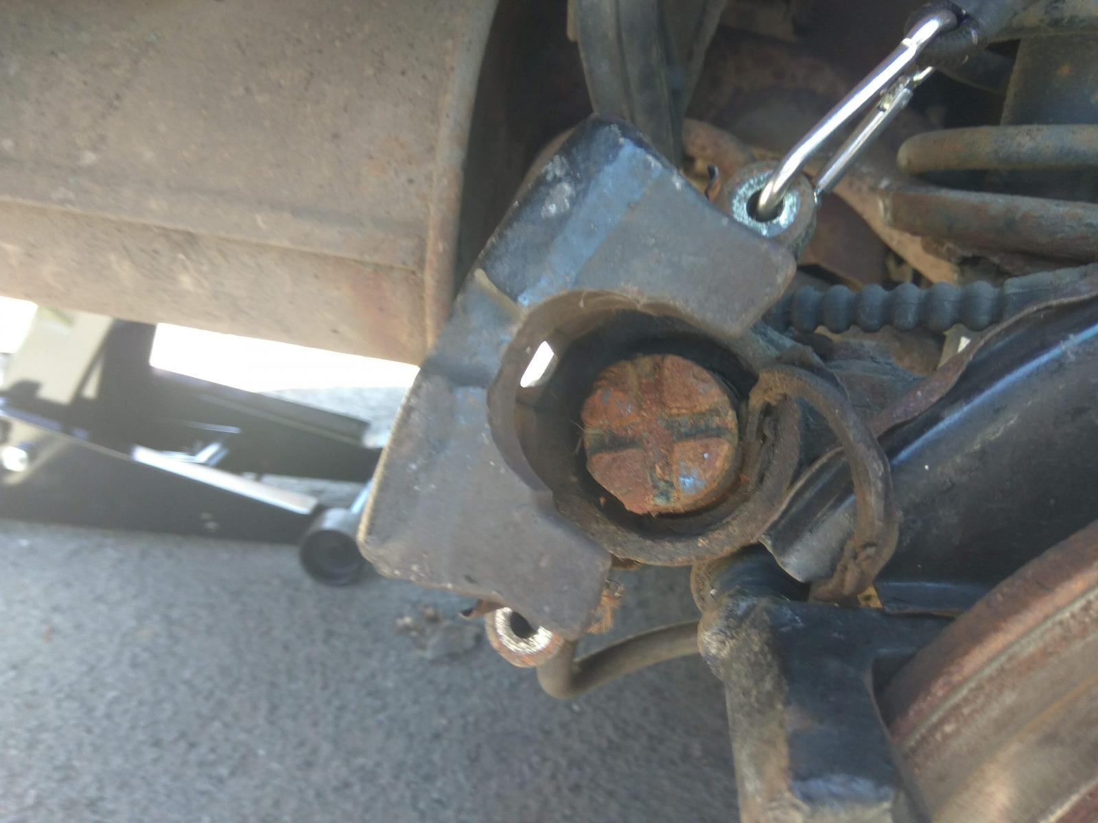

clayts450 Posted July 6, 2018 Author Posted July 6, 2018 Braking point Pleased to report that after a lot of faffology the back brakes are done. Nearside was a doozey, offside nearly broke me. Sorry no pics as I was tired, hot and very grumpy. Every single bolt I needed to get off was rusted to oblivion, requiring copious amounts of Plusgas. Those cute little bolt extractors I bought came into their own when I needed to undo the bleed nipple screws on both sides, and on the caliper guide pin bolt on the nearside, as naturally they were welded on. The piston in the offside caliper was well corroded - the replacement caliper which came was next to useless, so that was £29 well* spent, although I was able to salvage the dust seal and the piston from that one (could have saved meself some dosh by buying these separately). Trying to get the dust seal back on proved tricky but with a bit of judicious wiggling and lubing with both brake fluid and red rubber grease I was able to coax it all back in and wind it in successfully. The brake line clamp I got for £8 from Amazon came into its own, along with the Halfrauds solo bleeding kit. I replaced the caliper guide pins on that side and the seals and lubed everything nicely. I bled that side as the piston had popped out before I clamped the hose off (d'oh) No volcanic temperatures from the rear brakes now following a test drive and all seems good. So, the front nearside is now at melting point. Thought I'd have the wheel off yesterday to clean up the brakes therein, and to also see if I could locate the puncture in that wheel. No dice. MG Rover used these ridiculous wheel nuts which have an outer chrome/steel type decorative casing (they give the impression they should just unclip, but they don't). As long as they aren't overtorqued to oblivion, they usually hold firm and spin off nicely. Naturally two of the nuts' outer casings have swollen so neither a 19mm (too tight) nor a 21mm socket (too loose) will go over them. Having to wait for some better quality nuts off the Bay, but in the meantime am buying a 20mm socket special like, to see if I can coax them off that way. Otherwise, it's back to hammering a smaller socket etc etc, but I'm mindful these ones can be very easy to cock up (not the same as the locking nuts I was able to get off as these are made of cheese). Same issue on Land Roverz too http://www.disco3.co.uk/forum/swollen-nuts-99315-15.html Cue chorus of 'why can't anything be simples ?' purplebargeken and oldcars 2
Snipes Posted July 6, 2018 Posted July 6, 2018 Ford do that nowadays too. The little cap fooks off, making them 18mm and the factory wheel brace too large to fit the wheel nut. I can see no good reason why they put on an 18mm then "trim" it up to a 19? clayts450 1

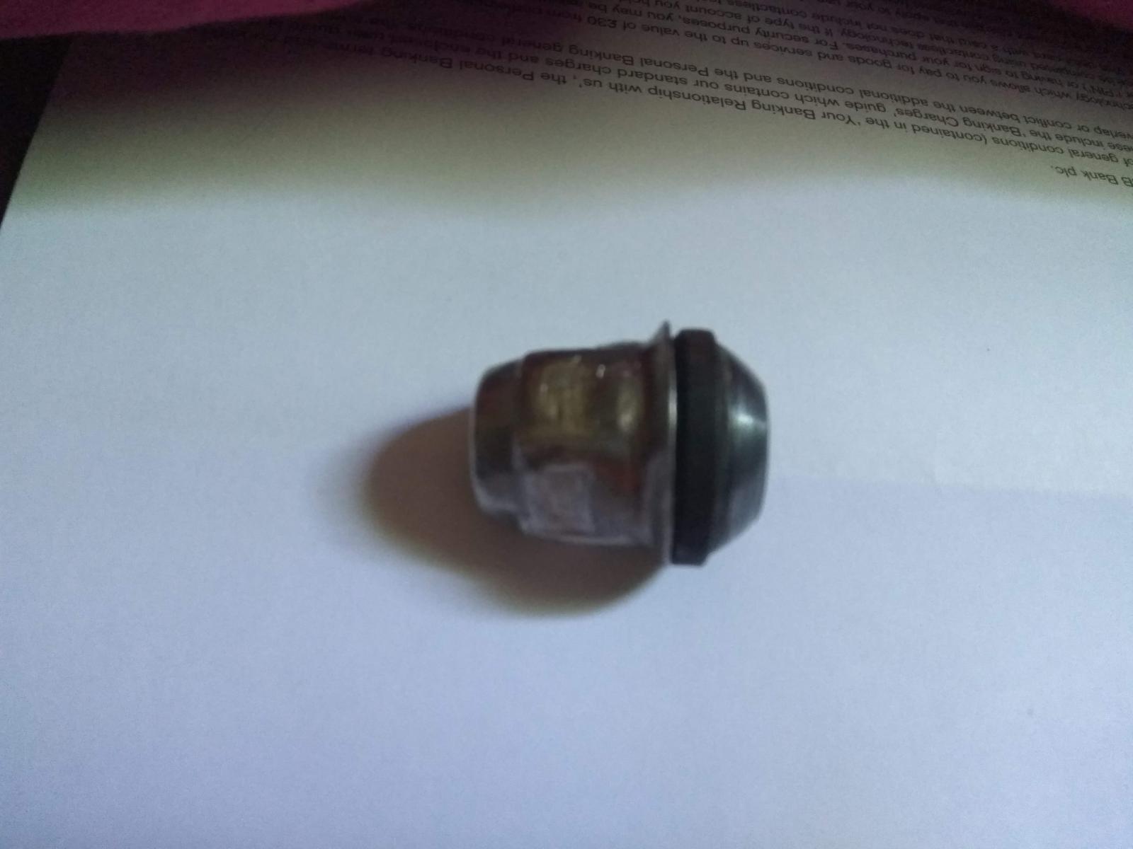

clayts450 Posted July 7, 2018 Author Posted July 7, 2018 Swollen nuts 20mm socket - fail 19mm impact socket and a club hammer - success The first attempt just gave me the crappy cap but exposed the wheel nut - luckily I had an 18mm socket to hand so that was sorted easy enough with a breaker (top right): Here's the crappy cap Naturally it got stock in the socket,. Whack with a hammer and a punch. Clearly made of cheese The second attempt (top left) was not so straightforward of course. Why would it be ? The cap kept spinning round and the socket dropped off with alarming regularity. I went psycho with the club hammer on the socket, and this time the whole thing came off in one after some gentle breaker barring: Essentially the 18mm nut gets exposed to road salt, rusts, pushes the cap out thus deforming it to a 19mm+ size. I'd hate to be on the side of the road with a flat and be faced with that bullshit. Some nice shiny all in one nuts eBayed and should be here early next week. (I'd already bought two to replace the locking wheel nut and they're good for £2 a pop). These'll go in the bin, but at least I can now get the wheel off and have a look at the melting brakes, and maybe figure out where the puncture is in the tyre. I'll mosey back to the car after the Eng v Sve game. Alloys were scratched to fuck, no doubt by one of the previous nine owners' attempts to get the wheel off.
155V6 Posted July 7, 2018 Posted July 7, 2018 My 25 (now sold) has those wheel nuts too.Horrible things

Skut Posted July 7, 2018 Posted July 7, 2018 The ZR has these wanky things and its my least favourite aspect of the car. All of the covers have dents in the top where a 19mm is hammered over the top and then the nut hammered out.

clayts450 Posted July 7, 2018 Author Posted July 7, 2018 Braking bad So a look at the front nearside brake. The usual old problem of a stuck guide pin bolt. This was child's play compared to the rear brakes. Bolt came off with a bit of effort and the caliper swings up, presenting the pads. Cleaned up all the metalwork and the springs and greased everywhere, filed down one of the pads which was sticking a little even after the clean out, shoved some red rubber grease between the dust seal and the piston. Generous squirts of brake cleaner all over. Pads had plenty of meat left and weren't wearing unevenly, but I did remove one of the shims which had rusted to nothing (non-essential frippery although there might be a new rattle as a consequence) so job (hopefully) is a good un. Won't know for sure until I have test driven, which I cannot do until I get the full complement of lug nuts back on the wheel. Air today gone tomorrow A fairly derisory exam of the tyre revealed no obvious puncture, but it had lost air again, so it's sneaking out somewhere. Put some soapy water on the valve, not that. Did a feeble water test, but I'll get the guys at F1 to give it the onceover, and then ask them to replace it with something deathly and Chinese. This is a £250 car remember, so I ain't spending the same again on no poncey rubber. For some odd reason the fronts on the car are 195/45/16, the rears 205/45/16. Stanced, yo. 195/45s don't even appear on the 45 spec list, so not sure what the thinking was there. Anyways, I'll go with two new 205/45s at the front to keep things simple. With any luck the car will be off the 'project' list soon and into daily service. Isaac Hunt 1
