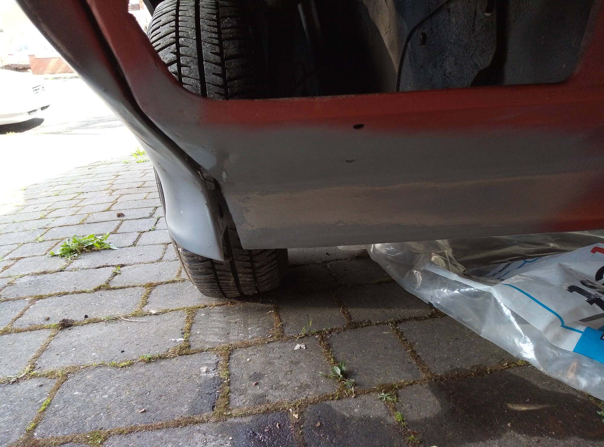

I finally got my arse into gear and did a bit of bodywork today. The rear arch/ sill area is looking much better for an hour or twos work.
Another few hours today and massive progress. Front valance panels for these cost about a kidney so mine was lovingly repaired at both frilly ends and was the single most complex bit of fabrication. I light skim of stopper and sand back and it’s looking ok, a little more work needed but not much. The rear arch was also given a little tickle and is getting close. Then I refitted the carpet and heater box and plumbed that all back in. All in all a very pleasing afternoon. This won’t be of the standard of Dan’s by a long way but will be a useable and solid fun car when it’s done.

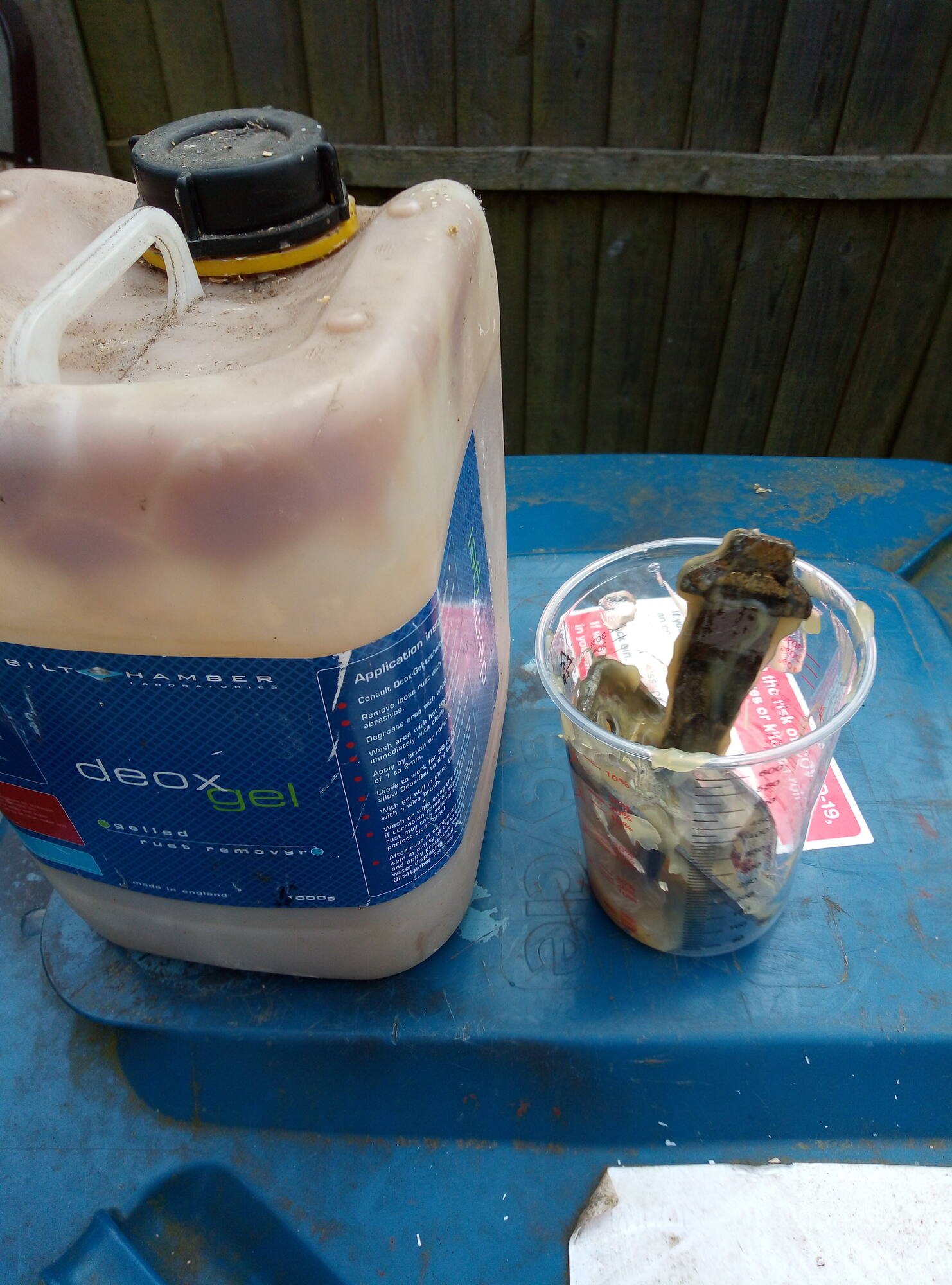

Weather is no good for painting so switched to some smaller bits, the door check strap is sat in deox C gel and the dash is covered in its third dose of cleaner.
