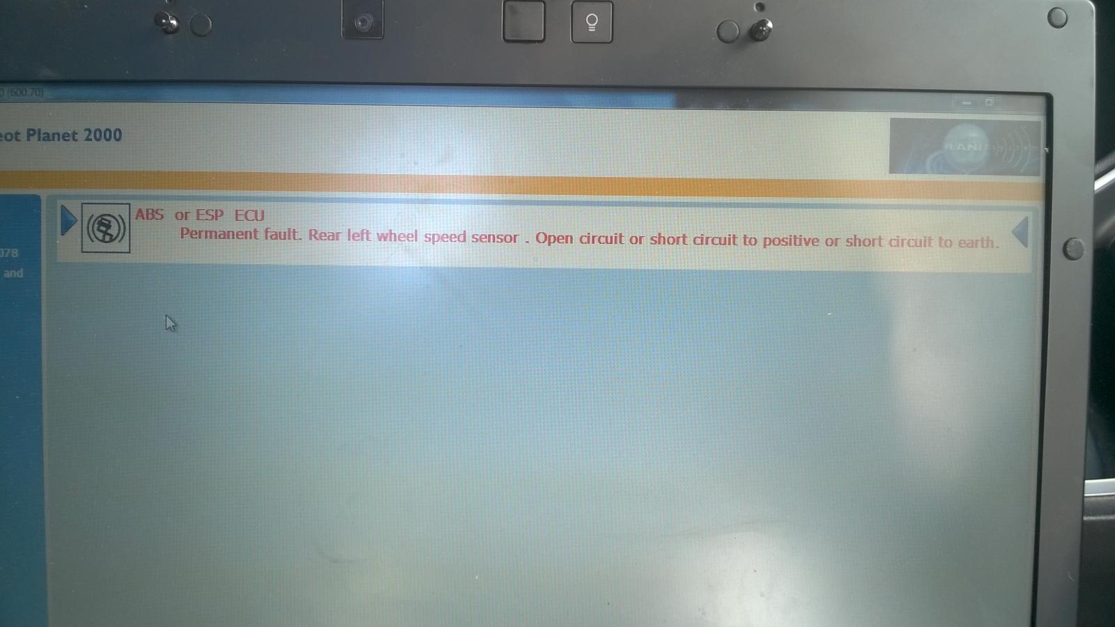

rainagain Posted March 21, 2018 Author Posted March 21, 2018 The first job I tackled was the ABS sensor, I didn't think there was much point addressing the other problems if I couldn't get this sorted. I purchased Peugeot Planet from AliExpress, the version I got is absolutely riddled with spyware, as I installed I had to keep clicking yes to allow stuff through the windows firewall, sadly there is no way of telling if it's part of the program you are saying yes to or the spyware. As soon as it was installed windows defender started detecting dodgy bits of SW and removing them. The Peugeot Planet part actually worked really well and I read this fault code

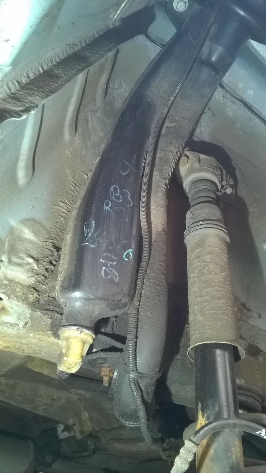

rainagain Posted March 21, 2018 Author Posted March 21, 2018 I looked under the car and found two faults with the wiring, firstly part of it had become un-clipped and had ended up melted onto the exhaust, secondly the wiring to the plug was damaged. SiC 1
rainagain Posted March 21, 2018 Author Posted March 21, 2018 I chopped the wiring back till I found good copper and left this dangling under the car
rainagain Posted March 21, 2018 Author Posted March 21, 2018 I then turned my attention to the plug, after cutting the rotten wiring back to good copper I was left with these tiny stubs, not much to solder to artdjones and SiC 2
rainagain Posted March 21, 2018 Author Posted March 21, 2018 However I still able to make a good join to a new piece of cable and added some heat shrink for protection, I then spliced this into the car's wiring and made sure it was properly clipped in place. A quick spin in the car put the ABS light off chodweaver, aldo135, Tickman and 13 others 16
SiC Posted March 21, 2018 Posted March 21, 2018 Looks like a nice easy fix and you've got a bargain. Much easier fixing that than trying to hammer on some reluctor ring or drilling out a rotten sensor. AMC Rebel 1
artdjones Posted March 21, 2018 Posted March 21, 2018 Well done, because it's those short stubs that always are the most difficult to solder to.

Dave_Q Posted March 22, 2018 Posted March 22, 2018 Peugeot planet / lexia is widely acknowledged to be one of the worst forms of computer aids, best thing is to install it in a virtual machine so you have some degree of separation from your normal browsing etc.
artdjones Posted March 22, 2018 Posted March 22, 2018 Peugeot planet / lexia is widely acknowledged to be one of the worst forms of computer aids, best thing is to install it in a virtual machine so you have some degree of separation from your normal browsing etc.Yes, quite difficult to use.I didn't get any malware but my copy always takes 10 minutes to switch off.The trouble is that what you can do through my Delphi clone is very limited so Planet is all I can use that's useful.
jonny69 Posted March 22, 2018 Posted March 22, 2018 Is Peugeot Planet what is used in industry in garages etc, or just what home enthusiasts use? I’ve seen it mentioned quite a lot on the Peugeot forums but never actually downloaded it. I couldn’t actually work out if it was free or if you were supposed to pay for it.
Kiltox Posted March 22, 2018 Posted March 22, 2018 Is Peugeot Planet what is used in industry in garages etc, or just what home enthusiasts use? I’ve seen it mentioned quite a lot on the Peugeot forums but never actually downloaded it. I couldn’t actually work out if it was free or if you were supposed to pay for it.It’s the proper dealer diagnostic kit. Needs a special interface. Any downloadable copy or £60 ebay special with the interface is pirate, usually virus ridden and an utter prick to install properly. jonny69 1
artdjones Posted March 22, 2018 Posted March 22, 2018 The software is a copy of the Peugeot factory software and is run through an interface which joins the car and a laptop.The Citroen version is called Lexia.Normally Planet and Lexia are combined in one programme called Diagbox,which acts as a portal in that you start Diagbox and then choose to use either Planet or Lexia.The interfaces for sale on eBay are Chinese clones of the PSA factory interfaces. jonny69 1
iainrcz Posted March 22, 2018 Posted March 22, 2018 I have planet if anyone local needs a plug in.And I don't charge £3.8bn like Peugeot do. I just ask for a bottle or two of a pleasant ale. Sent from my VFD 710 using Tapatalk jonny69 and Wingz123 2

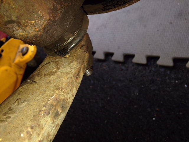

rainagain Posted March 23, 2018 Author Posted March 23, 2018 Next on the to do list was the knocking coming from the front when going over bumps, I had hoped it was the drag links but they were fine, turned out to be the lower ball joints on both sides. Also the front off side wheel bearing was knackered. I removed the hub and took it to my local friendly garage who for £10 changed the lower ball joint and the bearing which was a bargain. Whilst I had the hub off I noticed the steering rack gaiter was broken, I managed to find one at Eurocarparts that weekend and had it fitted. I used a tip online and used a jubilee clip to secure the larger end of the gaiter as access is a nightmare but your can just fit a socket in on a wobbly extension. artdjones, theshadow and privatewire 3
artdjones Posted March 23, 2018 Posted March 23, 2018 Well done on getting the garage to change the ball joints.It takes a lot of heaving.Yes that inner clip is difficult,so I did the same as you.I found out afterwards that you can get cheap clic pliers on eBay for the clips,I bought a pair as they are also on fuel lines and egr valves on a lot of PSA stuff.
rainagain Posted March 23, 2018 Author Posted March 23, 2018 I went to change the ball joint on the other side (near side) but when I tried to undo the hub nut it was so tight my 1/2" extension broke. It was then (probably after hearing the swearing) that my dad very kindly offered to pay for a local garage (not the same one that I mentioned previously) to carry out the change and he would pay for it. I don't normally like other people working on my cars but I was A knackered by this time and B had no way of getting the hub nut off so I agreed. The work was carried out for the cost of two hours labour. When I changed the off side ball joint I had also dismantled and cleaned the brake calipers and sliders, when I got the car back from the garage the following weekend I thought I would do that side as well, it was then that I found the garage had damaged the new ball joint as can clearly be seen by the grease coming out the hole they made in the boot. I know mistakes happen so I texted the mechanic to ask if he noticed it when he was changing it, but I got nothing back. I then went online and ordered two new boots and again texted the mechanic with the offer if I supply the boots and give him a hand could we swap it over next weekend on his ramp, again no reply. The boots arrived the following week and I decided to just do it myself, after a lot more hammering than I thought it would take to dissemble a recently disturbed joint I got the ball joint separated. It was then I discovered that the boots I had ordered despite saying they would fit, didn't. Luckily I had the boot off the other side that even though the ball joint was knackered the boot was ok so I fitted that.,This just reinforces to me why I don't like other people working on my cars. Wingz123 and theshadow 2
rainagain Posted March 23, 2018 Author Posted March 23, 2018 Well done on getting the garage to change the ball joints.It takes a lot of heaving.Yes that inner clip is difficult,so I did the same as you.I found out afterwards that you can get cheap clic pliers on eBay for the clips,I bought a pair as they are also on fuel lines and egr valves on a lot of PSA stuff. I did spend a few hours trying drift the old ball joint out whilst holding the hub in the vice, the guy in the garage ended up putting a torch on it followed by a massive impact gun.
artdjones Posted March 23, 2018 Posted March 23, 2018 I did spend a few hours trying drift the old ball joint out whilst holding the hub in the vice, the guy in the garage ended up putting a torch on it followed by a massive impact gun.Sure,I know the feeling.Last time I did one of these I used a 6ft scaffold pole over my 3/4" t bar, and once or twice I've cut across the ball joint with a big angle grinder as close to the hub as I dared.Whats left generally is loosened enough by the heat to drift out with a chisel.
