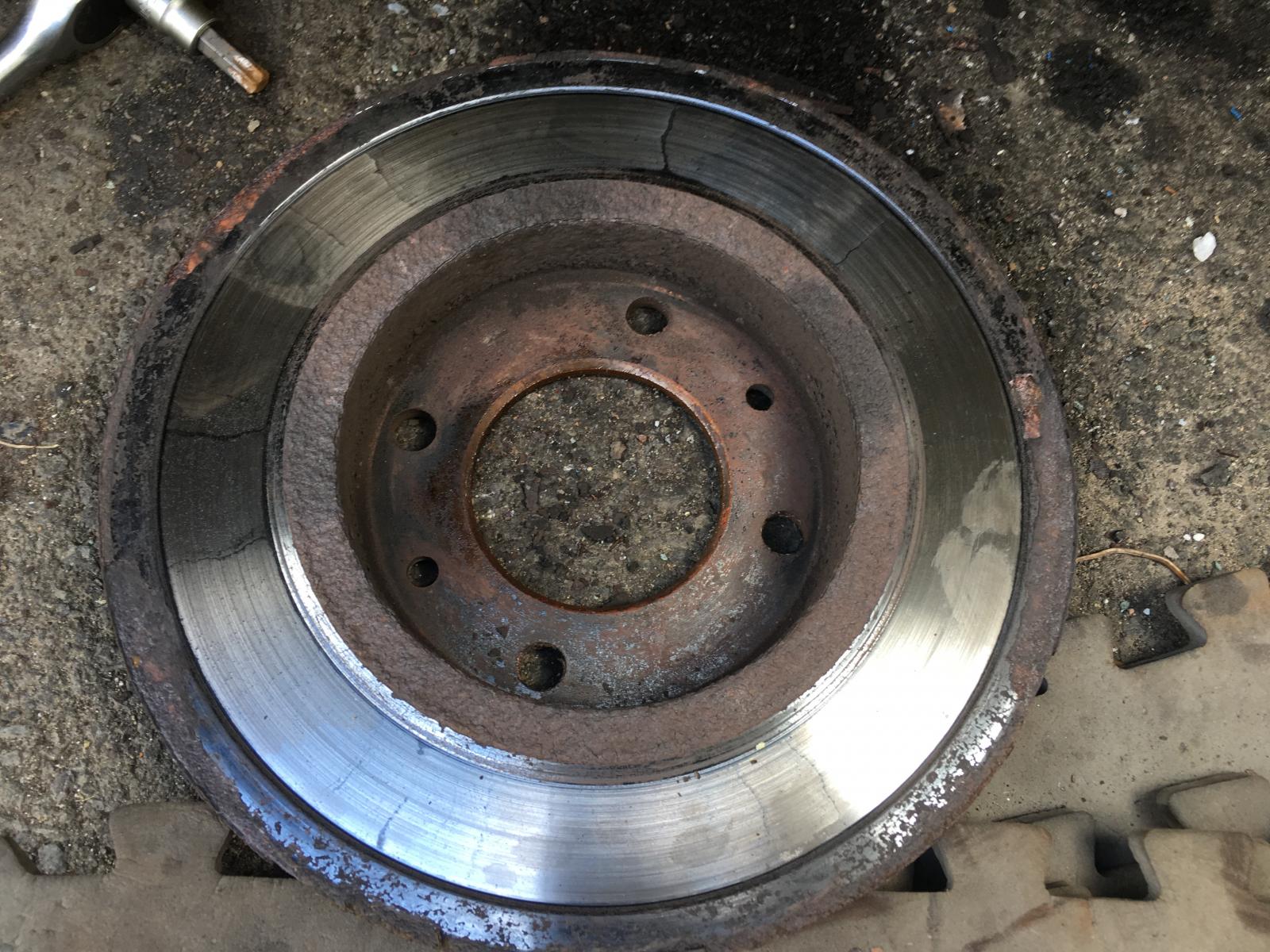

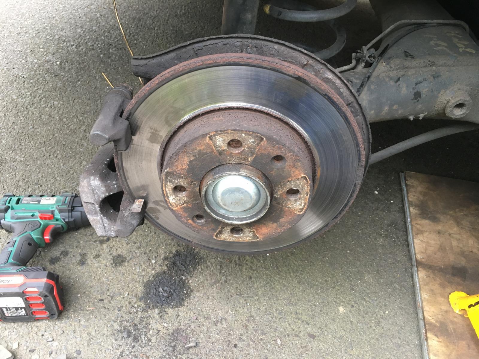

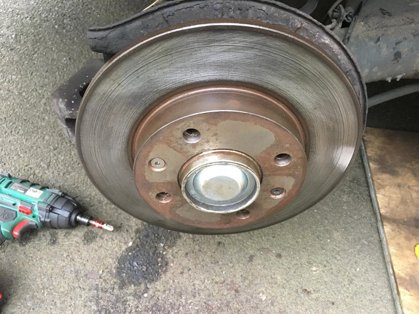

rainagain Posted October 31, 2018 Author Posted October 31, 2018 With my bangin' choonz sorted I turned my attention to lower priority fixing like the back brakes. The garage who did the MOT told me it had only scrapped through on the brakes all round. From the front the discs didn't look too bad Everything came apart without too much hammering/swearing The old discs were kackered Lacquer Peel, richardthestag and Aston Martin 3
rainagain Posted October 31, 2018 Author Posted October 31, 2018 I did well with my replacement discs as I saw someone on Gumtree selling a full set that had been recently fitted to a 307 with pads for £20. The front discs were no good being for the petrol model but the rear discs fitted perfectly and were like new.

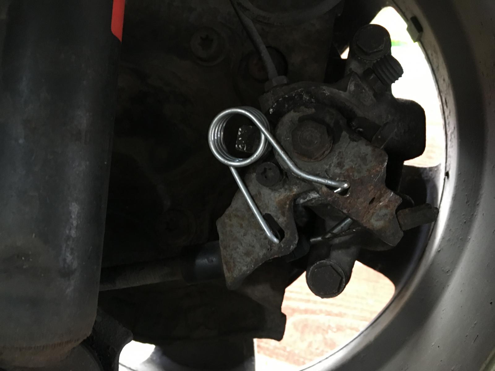

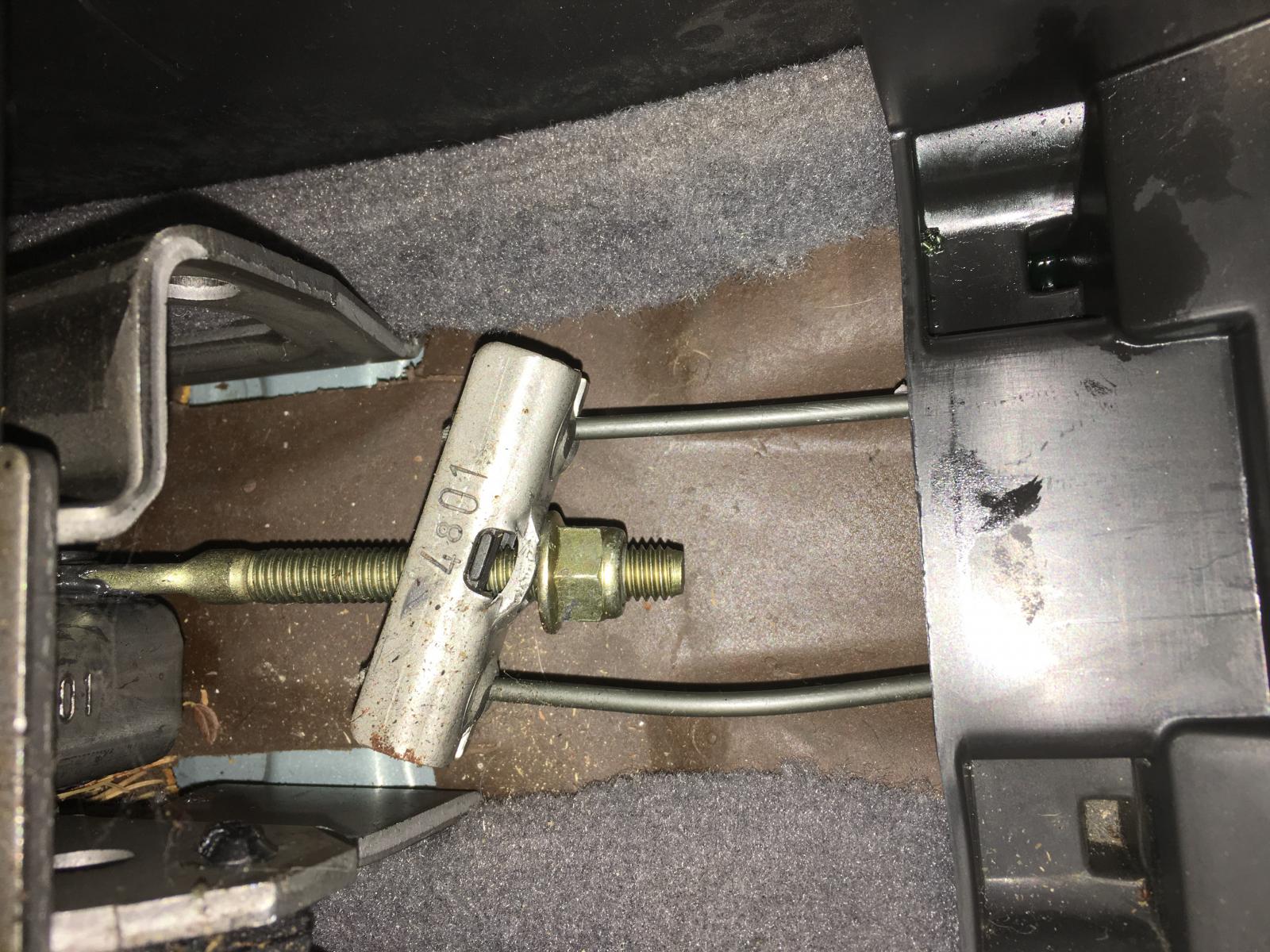

rainagain Posted October 31, 2018 Author Posted October 31, 2018 After changing the rear discs I was have having problems with them dragging. I first looked at the hand brake cable, it was too tight so the arms on the calipers couldn't return properly. Not sure if the left cable has stretched or the right cable is wrong????
rainagain Posted October 31, 2018 Author Posted October 31, 2018 However even with the cable loosened off the arms wouldn't return by themselves, I found these 'helper' springs on ebay and fitted them. I still think there is a problem with one of the cables but the hand brake works well and nothing drags Remspoor 1

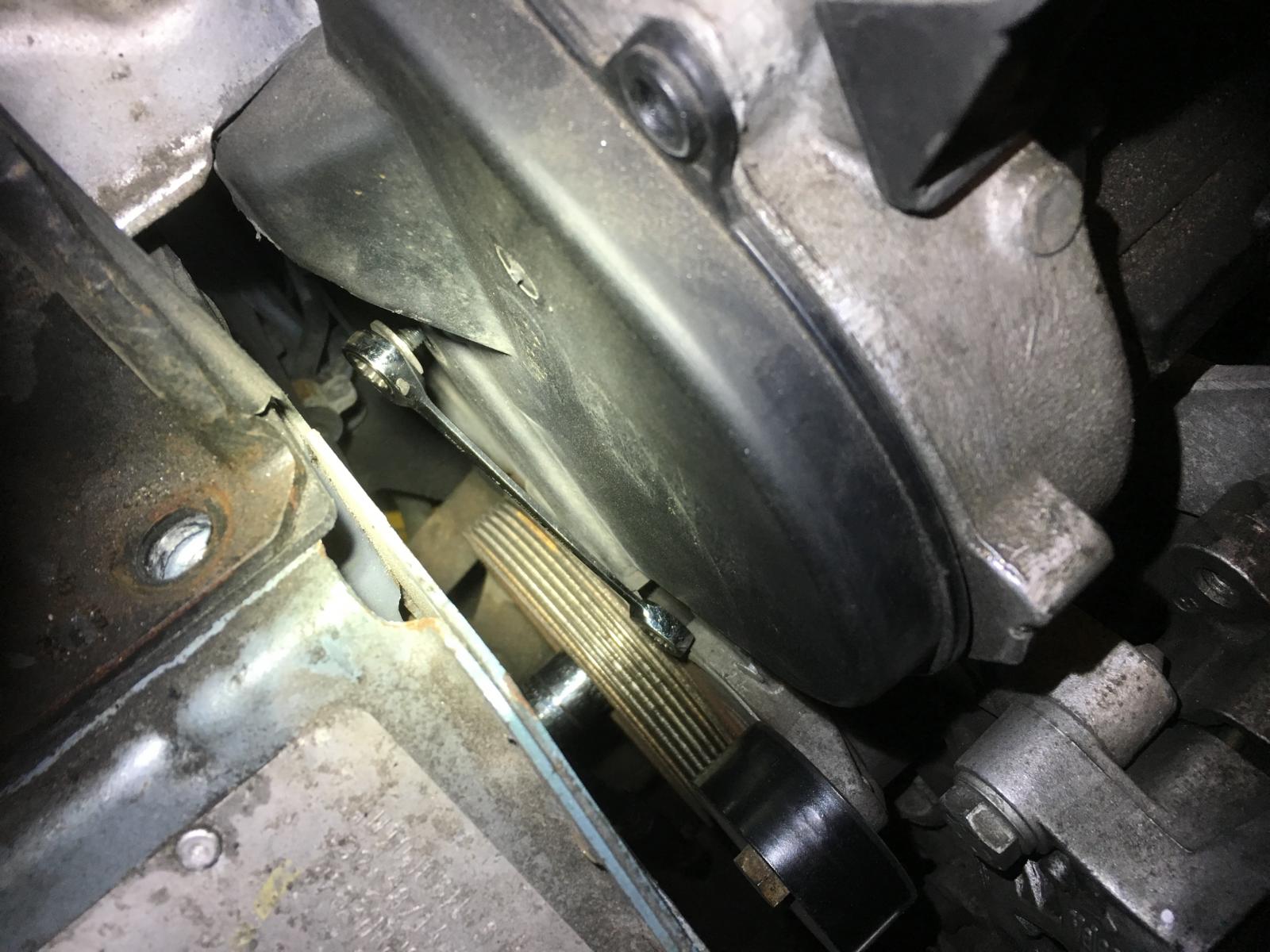

rainagain Posted December 1, 2018 Author Posted December 1, 2018 hi guys I'm really stuck, I'm in the middle of changing the timing belt, I managed to get the crank pulley loosened using the starter motor technique then my lidl air impact gun was slowly undoing it. However it has now stuck and the impact gun is doing nothing and neither is using the starter motor. Is there any one near Dunfermline that can lend me an electric impact gun?
Tamworthbay Posted December 1, 2018 Posted December 1, 2018 Shame you aren’t closer I have one here you would be welcome to borrow.
rainagain Posted December 1, 2018 Author Posted December 1, 2018 Thanks for the offer trying a heat gun right now as I think it’s thread lock
rainagain Posted December 1, 2018 Author Posted December 1, 2018 Heat gun has only gone and done it! Don't I feel pissed off having wasted over an hour trying to remove one bolt richardthestag, Lacquer Peel and Dirk Diggler 3

Richard Posted December 2, 2018 Posted December 2, 2018 However even with the cable loosened off the arms wouldn't return by themselves, I found these 'helper' springs on ebay and fitted them. I still think there is a problem with one of the cables but the hand brake works well and nothing drags When we had C5s we had an MOT fail for the handbrake binding. It soon became clear that there was just a little too much friction in the cable. Replacing the cable involved dropping the exhaust and then the undertray/heat shield that covered most of the underside of the car- as well as paying a king's ransom for the new cables of course. I got a spare return spring from the opposite side and fitted it with the standard spring. Then the other C5 had the same issue but my bodge wasn't quite enough this time, so I raided my box of small coil springs and fitted one around the end of the cable, in addition to the doubled up standard springs.

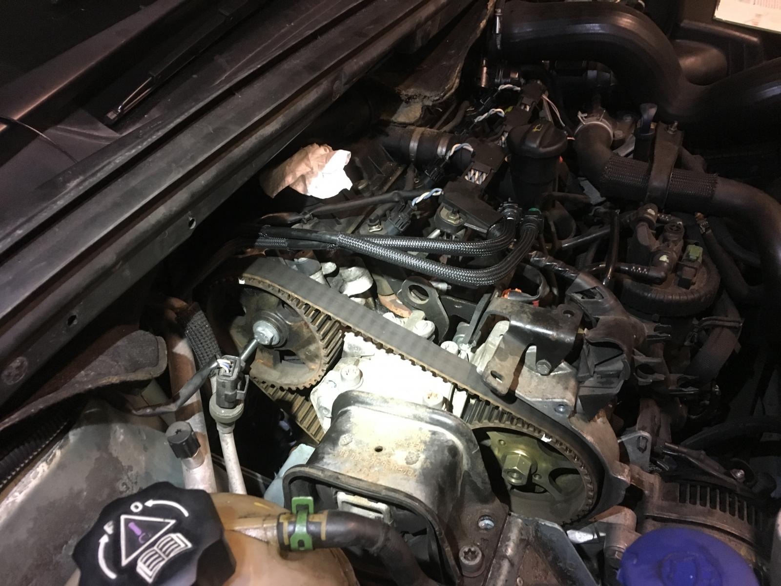

rainagain Posted February 1, 2019 Author Posted February 1, 2019 I thought I'd add some more pics of my timing belt change in case they are of use to anyone. Firstly access is a bit tight, so ratchet spanners are a godsend.
rainagain Posted February 1, 2019 Author Posted February 1, 2019 Once I'd removed the arch liner for access I found some grot which I treated

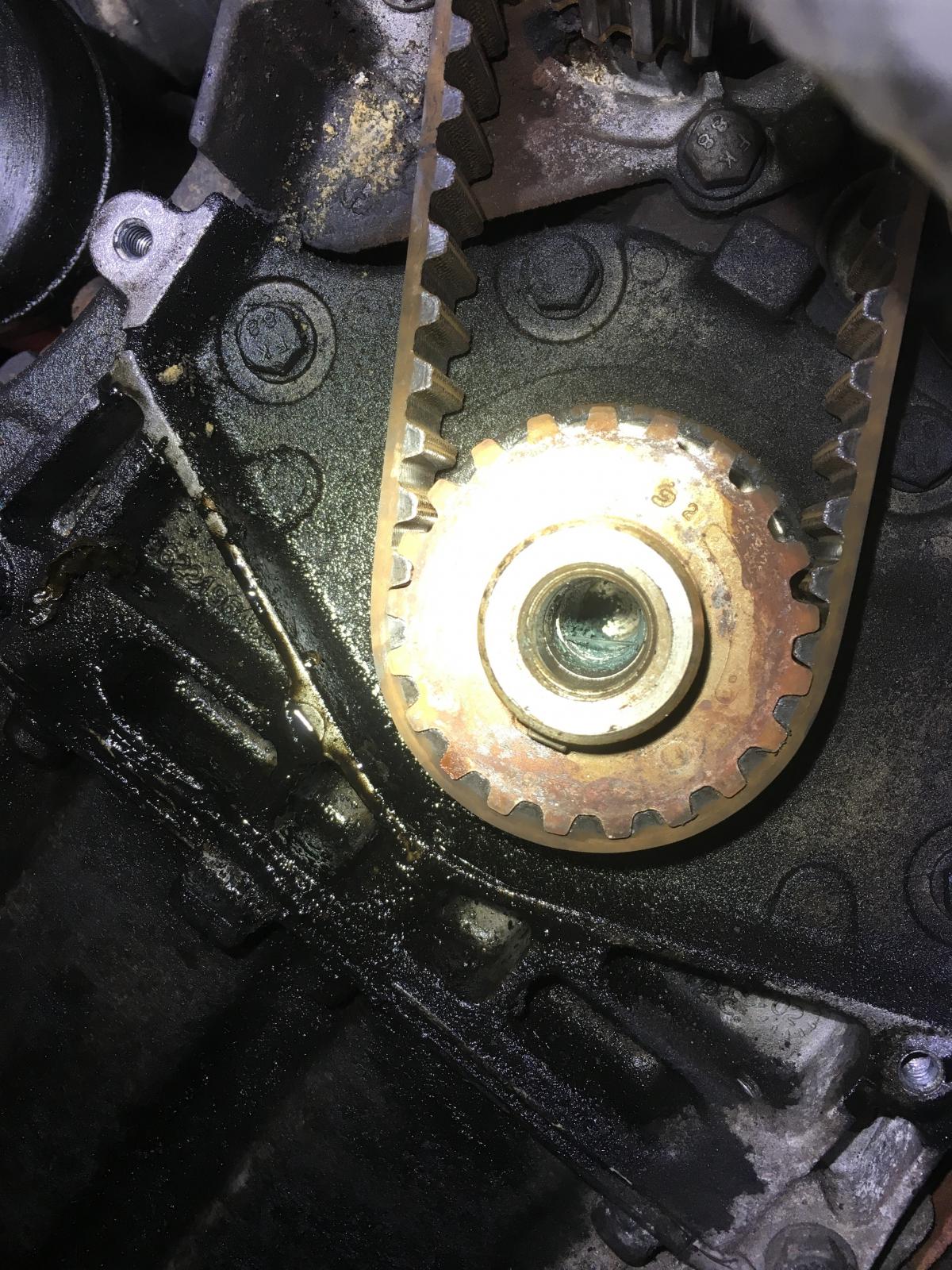

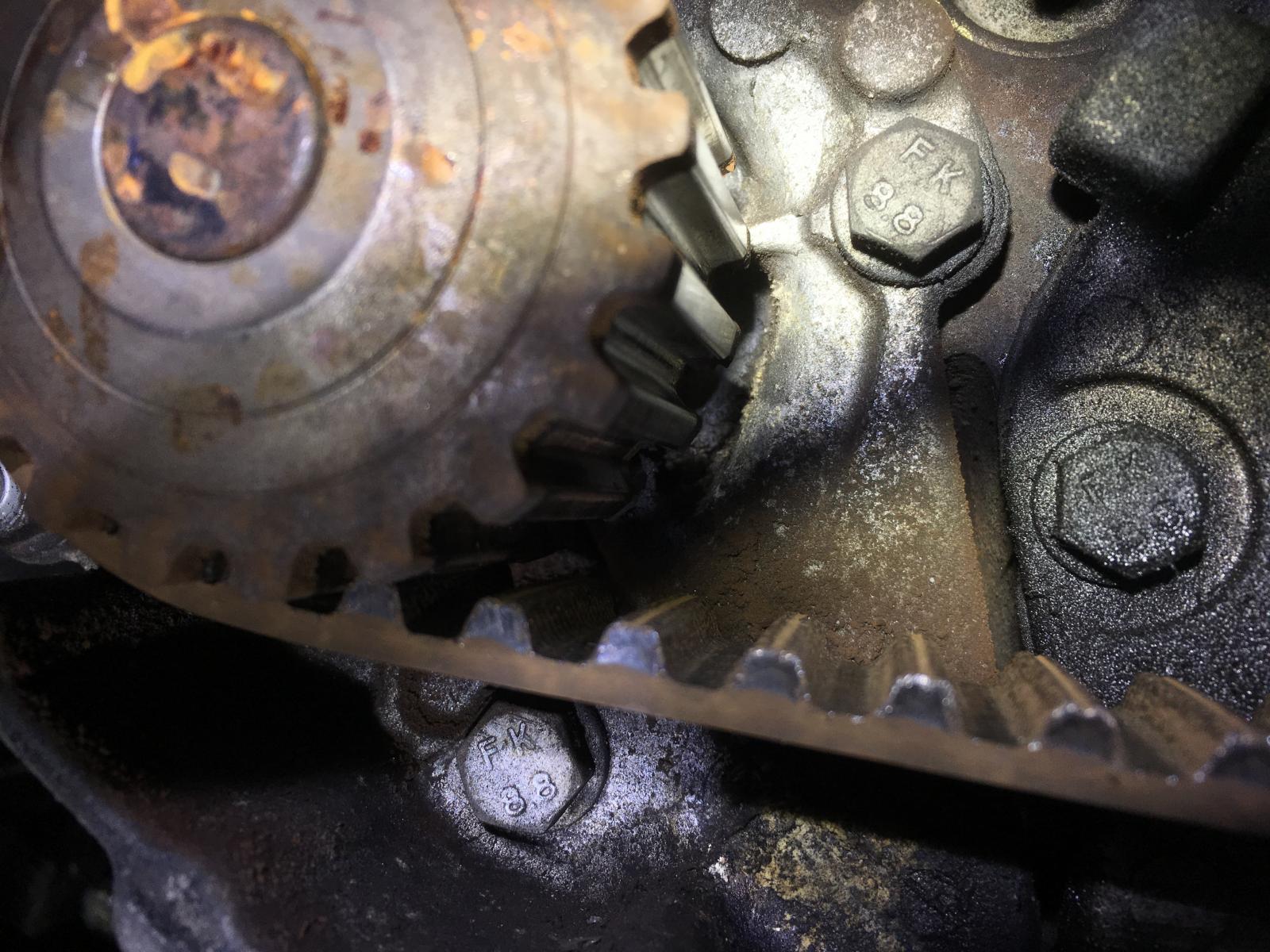

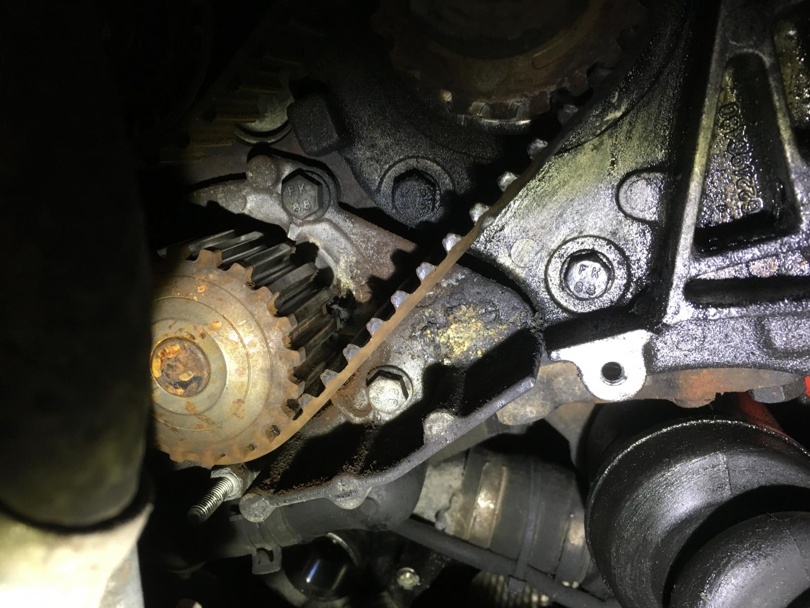

rainagain Posted February 1, 2019 Author Posted February 1, 2019 You can see where the oil has been leaking out the knackered oil seal. Lacquer Peel 1
rainagain Posted February 1, 2019 Author Posted February 1, 2019 After a bit of messing around and having to screw a self tapper into the seal, I managed to get the old one out. And the new one installed Lacquer Peel 1
rainagain Posted February 1, 2019 Author Posted February 1, 2019 I used the method I always use of marking the old belt and the pulleys and then transferring the marks over to the new belt. Setting the tension was a bit hit or miss as there's no tension indicator you just have to go for about half a twist on the top run, this took a little bit of messing around to achieve. Getting the timing belt covers on and off was a nightmare, I ended up removing the brake fluid reservoir and the scuttle trim at the bottom of the windscreen. When this is off you have to be careful as it's easy to crack the windscreen. Looks like the last person who changed the timing belt lost their rag with the covers as one of them was cracked and had mounting lugs at the rear snapped off. Lacquer Peel 1

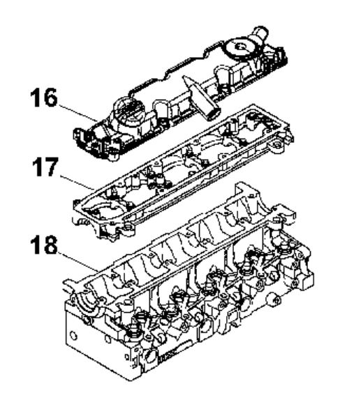

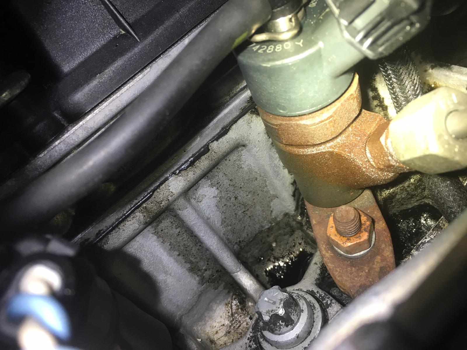

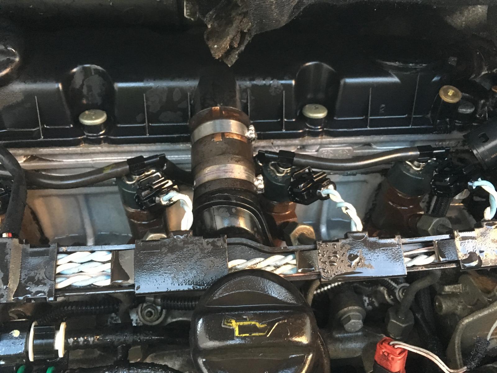

rainagain Posted February 1, 2019 Author Posted February 1, 2019 The top of the engine was always a bit of an oily mess so I gave it good clean I can now see where the oil is leaking from, does anyone know if I can remove and rejoin this without disturbing the camshaft?
rainagain Posted February 1, 2019 Author Posted February 1, 2019 I've just found this, looks like my leak is between 17 and 18, as it's just seeping I think I'll leave it. Lacquer Peel 1

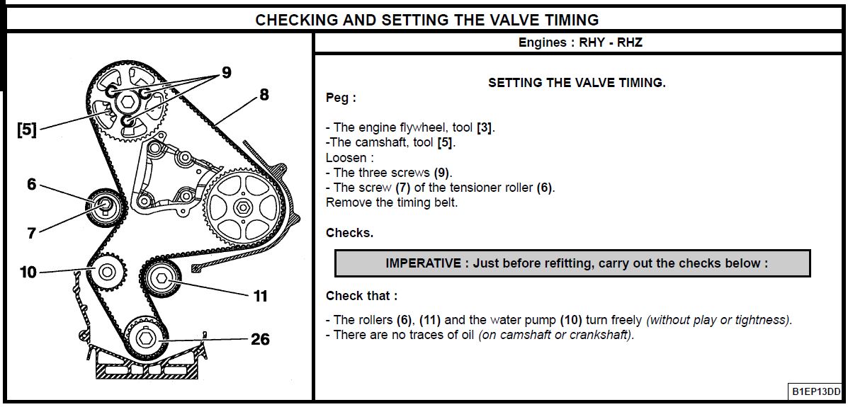

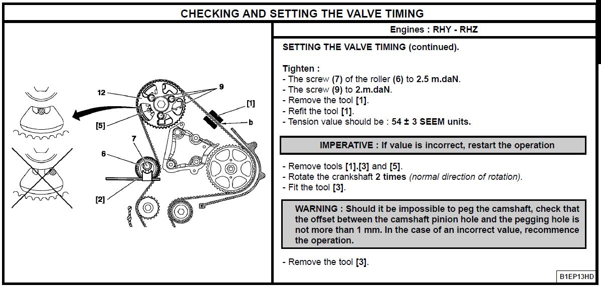

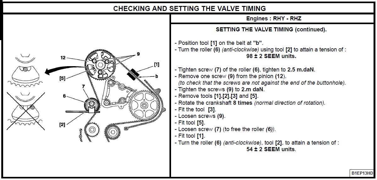

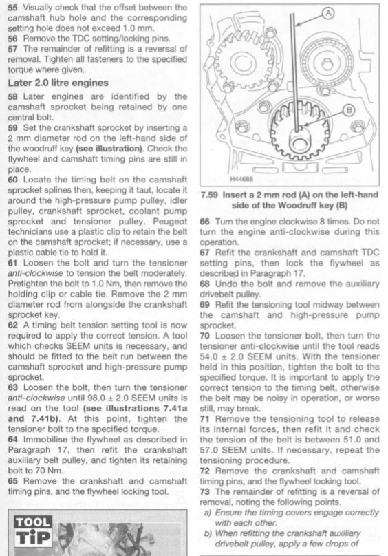

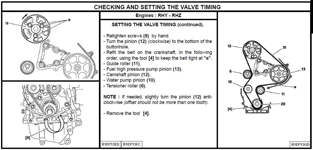

tommotech Posted February 1, 2019 Posted February 1, 2019 Be careful, I don't think you've got enough tension on the belt. PSA have a special tool for setting the belt tension, see the process below; Hope this helps.
rainagain Posted February 1, 2019 Author Posted February 1, 2019 in an ideal world I would have used a SEEM tool but I don't have one and I didn't think it was worth forking out for something I'd use only a couple of times. Looking on the Peugeot forums it seems half a turn on the top run is about right, which is what I went for. I surprised it doesn't have a tension indicator like all the other timing belts I've changed over the years, it makes life so much easier. The actual proper process is quite lengthy with multiple adjustments of the tension then rotating the engine then adjusting the tension again.
tommotech Posted February 1, 2019 Posted February 1, 2019 Be thankful you don't have the later engine, where the adjustment is made on the crank pulley. The woodruff key slot is elongated so they could reduce costs and have a solid cam sprocket, that really is a lengthy procedure.
rainagain Posted February 1, 2019 Author Posted February 1, 2019 Be thankful you don't have the later engine, where the adjustment is made on the crank pulley. The woodruff key slot is elongated so they could reduce costs and have a solid cam sprocket, that really is a lengthy procedure.Yep that's what I had, I stuck a drill bit in the slot to set it up
Remspoor Posted February 2, 2019 Posted February 2, 2019 Be careful, I don't think you've got enough tension on the belt. PSA have a special tool for setting the belt tension, see the process below; HDI_Belt1.JPGHDI_Belt2.JPGHDI_Belt3.JPGHDI_Belt4.JPGHDI_Belt5.JPG Hope this helps.Image1: If pegging is impossible......

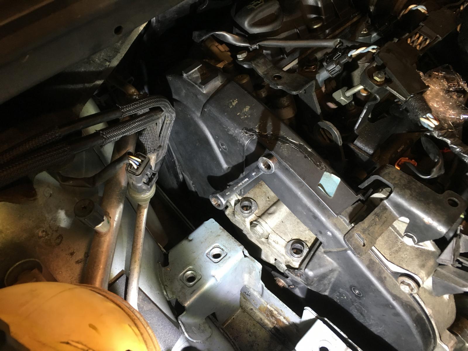

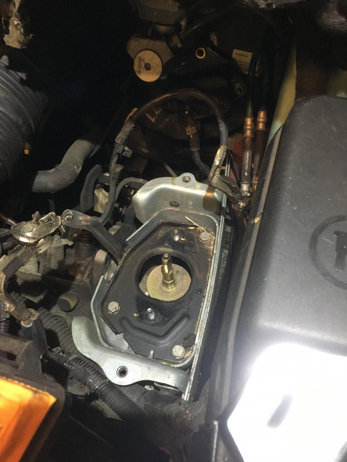

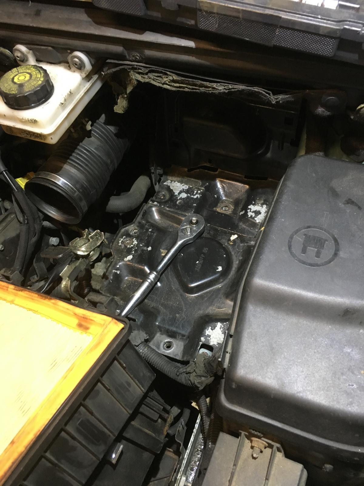

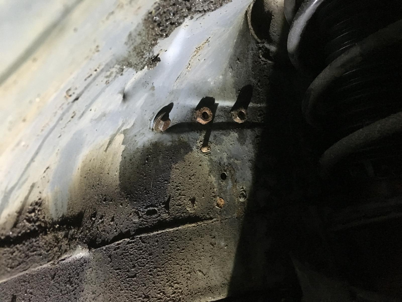

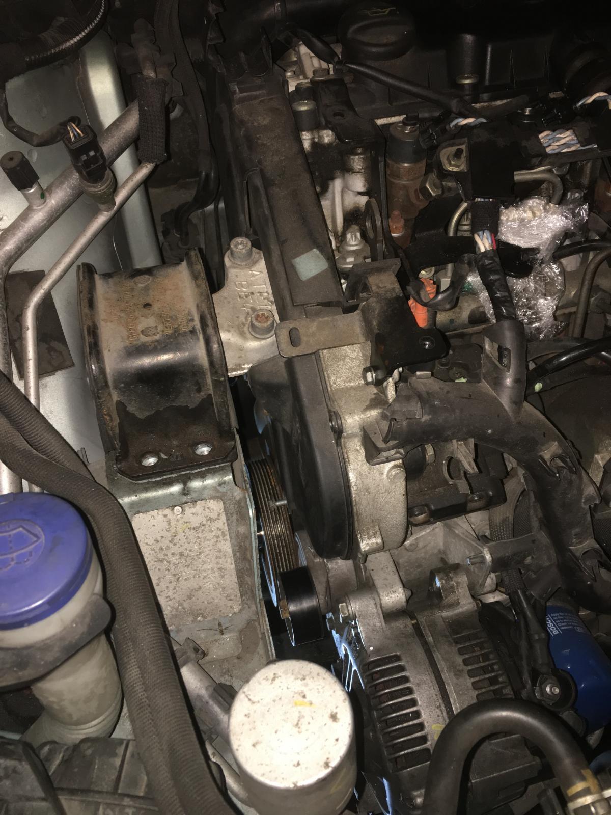

rainagain Posted February 15, 2019 Author Posted February 15, 2019 I'd noticed I was getting vibration in the car when idling and and the engine was rocking when you blipped the throttle. The top mount looked ok and I have only recently changed the bottom mount which suggested the gearbox mount was knackered. Changing this involved removing the air filter box The battery And the battery tray which has one annoying bolt inside the wheel arch which means you have to take the wheel arch liner out to get to it
rainagain Posted February 15, 2019 Author Posted February 15, 2019 Then it was case of the old one out And the new one in Lacquer Peel and stephen01 2

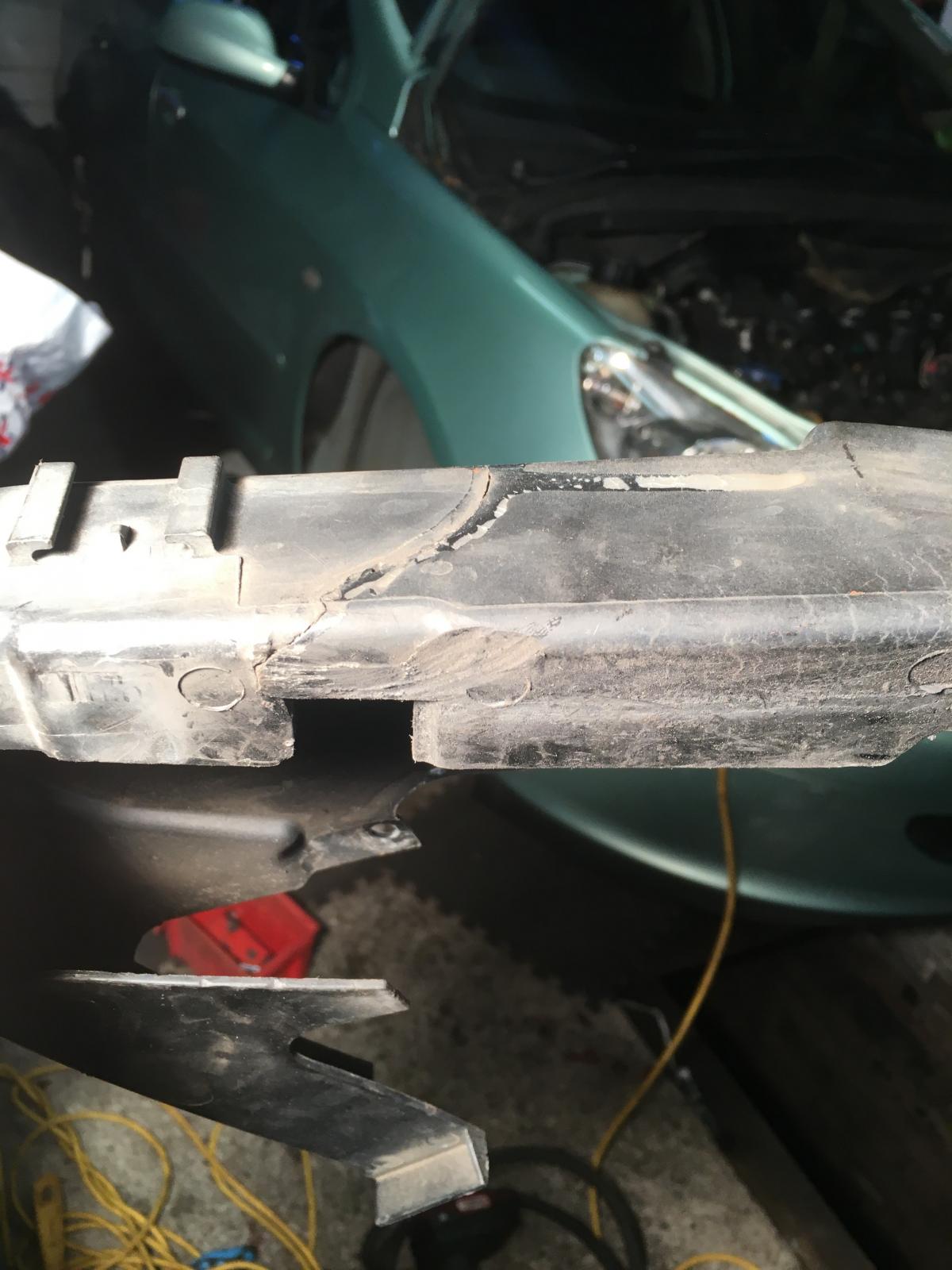

rainagain Posted February 22, 2019 Author Posted February 22, 2019 However changing the gearbox mount did nothing to help with the vibration, I had a look under the car and found this Yep my new bush had failed rather catastrophically
