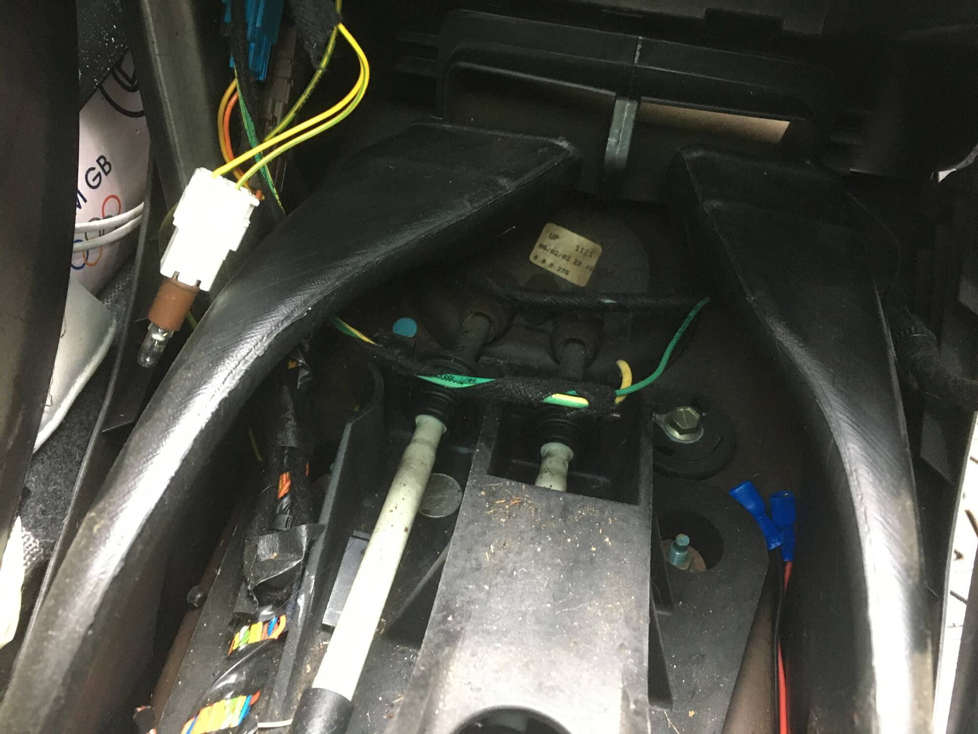

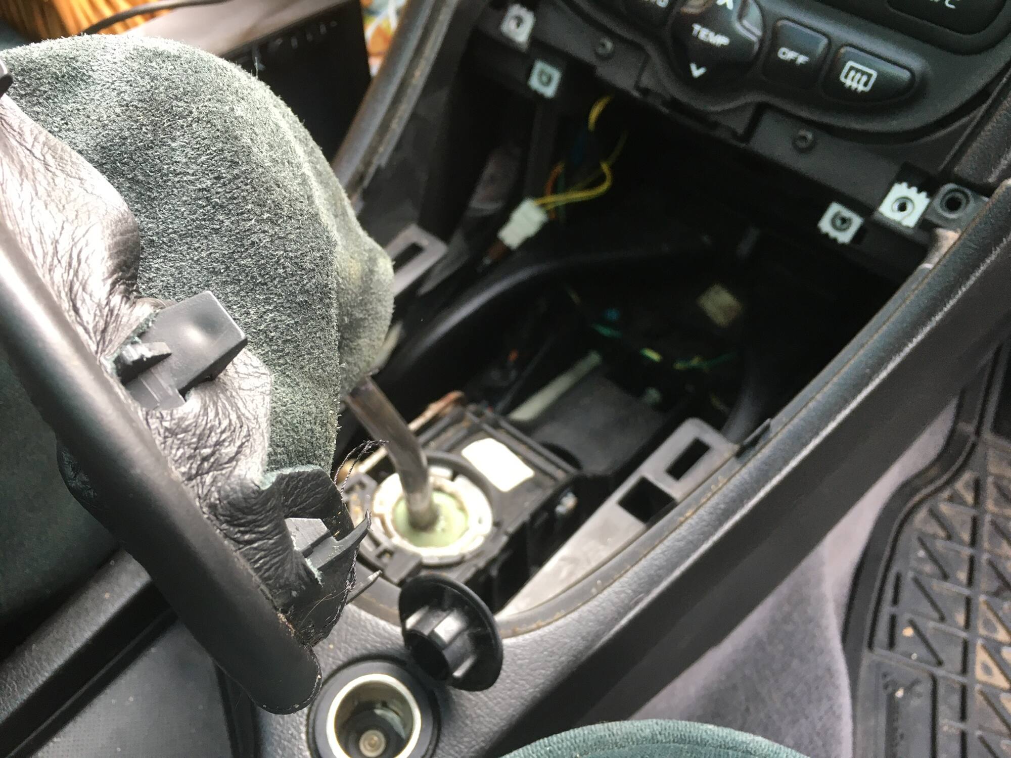

rainagain Posted August 16, 2020 Author Posted August 16, 2020 I managed to get a set of cables off eBay for £30 delivered so with fingers crossed I started to strip down the interior. first off remove the gaitor round the gear level, then the ash tray. This allows you to get to the torq screws to remove the lower piece of silver trim. Then you need to remove the heating ducts either side of the cables as shown below. I also removed the earth bolt to the right of the cables. I popped out the air bag switch and tried to do the same with the roof blind switch but this fell apart instead. Then I remove the torq bolt under the piece of rubber trim next to these buttons. You’re then suppose to be able to remove the centre console by sliding it over the handbrake. Mine wouldn’t do this as I couldn’t get it over the handbrake so I just worked around it. If I was doing this again I wouldn’t bother disconnecting the two buttons as you don’t need to, you can just lift the console enough for access Cord Fourteener 1

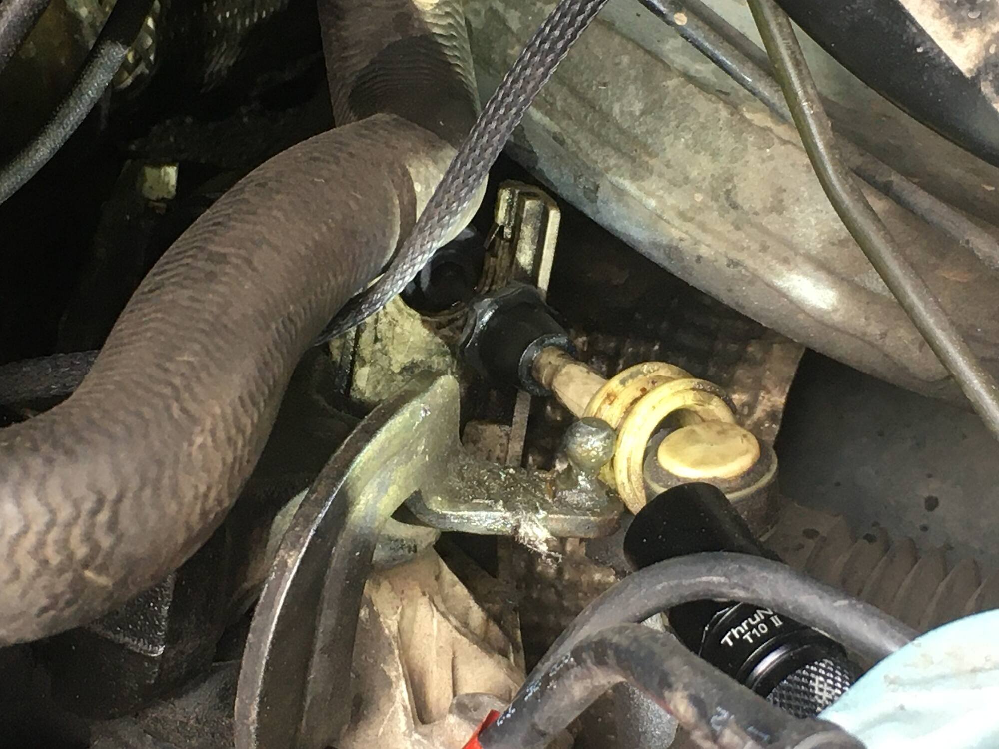

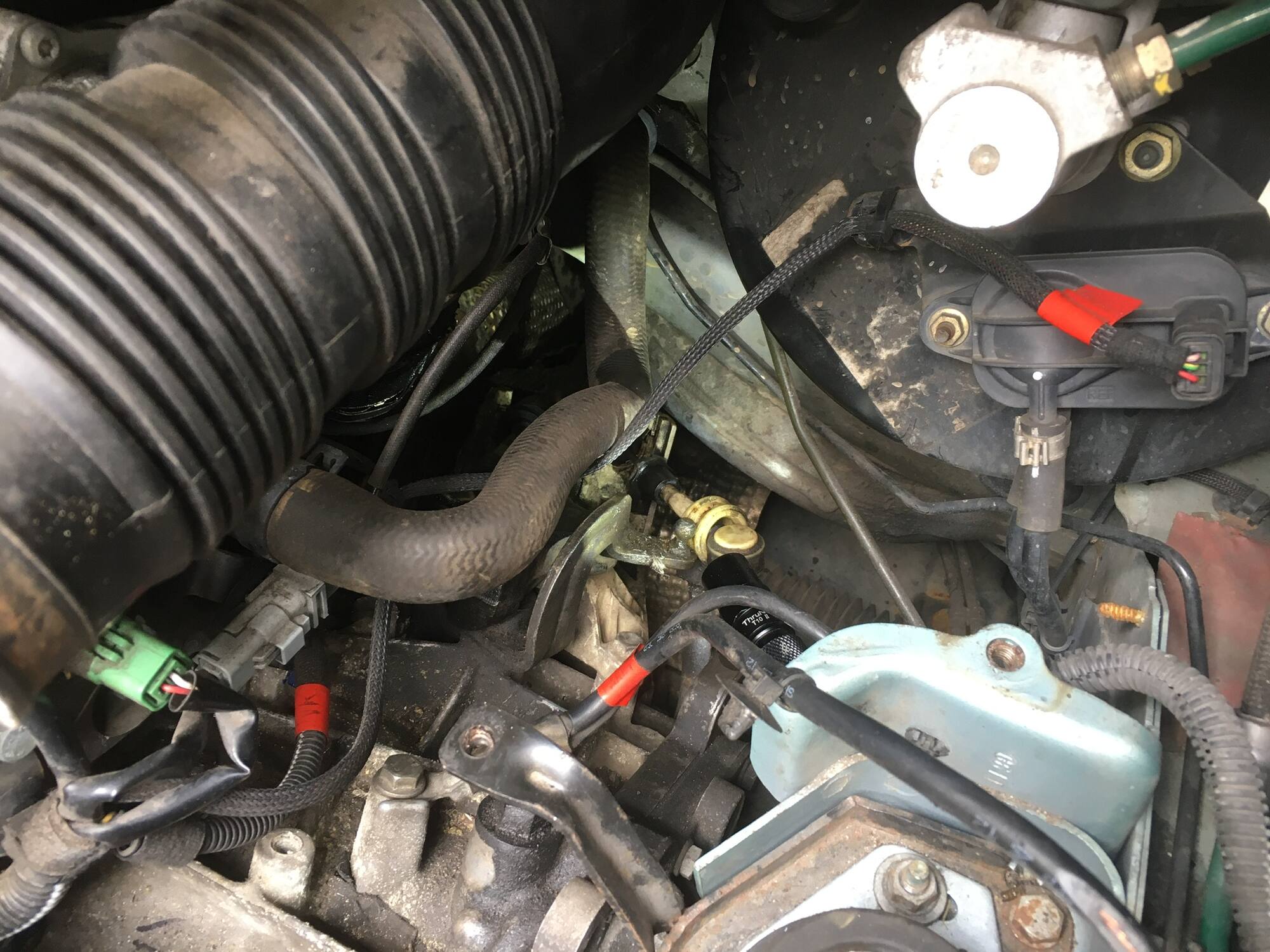

rainagain Posted August 16, 2020 Author Posted August 16, 2020 Then from the engine bay you need to remove the top of the air filter box and associated trunking, the battery and the battery box. Remembering to allow the car to go to sleep before doing this. There’s one sneaky bolt on the battery box that you have to remove the inner wheel arch to get to. Next pop off the two ball joints and then use a small screwdriver to push down one of the clips holding each cable in a then rotate them out. I found the best way is to push down the clip on one side then turn the cable away from the clip and they pop out. Access is usual Peugeot excellence A bit closer scdan4 and Cord Fourteener 2

rainagain Posted August 16, 2020 Author Posted August 16, 2020 As I couldn’t remove the heat shield I instead unbolted the gear level from inside the car (four bolts) and just yanked the cables really hard. This worked and the original plastic clip broke allowing me to remove the whole lot. I removed the original cables from the gear level and compared them to the ebay ones, they ‘looked’ identical apart from the ebay had an adjuster for the left/right cable. I wrapped a plastic bag round the new cables with the washing line cord to make it easier to pull them through. scdan4 1
rainagain Posted August 16, 2020 Author Posted August 16, 2020 Going back and forth from inside the car to the engine bay (this would have been easier with a helper) I managed to feed the new cables through by pulling on the washing line. I had already covered the new grommet and plastic clip in rubber grease to make it easier to pop it in. I connected up the cables in the engine bay and then reinstalled all the trim inside the car. It all looked good, and the great news was the gearbox was fine. Remspoor and Tickman 2
rainagain Posted August 16, 2020 Author Posted August 16, 2020 Then I noticed a problem, the ebay cables outer must be slightly too long and excess length was pushing the heat shield into contact with the exhaust. I knew if I left this the cables wouldn’t last long. I went back under the car and tried see if I could somehow tie the cables out of the way. I found a bracket and tired to use a piece of wire to hold the cables away from the shield but it didn’t work. I then had the idea of putting a twist into the cables. So I had the fun job of removing them, again, from the gearbox and the stupid cable clips. Luckily the twist worked. I noticed the new gear change is much better than my old cables as there’s much less play but it’s a bit stiffer. I don’t know is this is due to the twist or the fact the cables don’t seem to have any lubricant on them. Would could I put on them if anything? scdan4, Remspoor and Jimbob McGregor 3

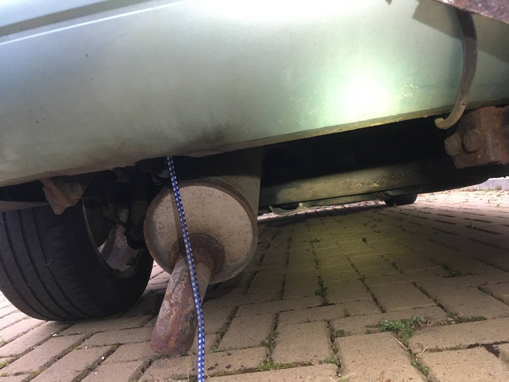

rainagain Posted August 16, 2020 Author Posted August 16, 2020 I had not long sorted the gear change cables when this happened my OH has spent too long round shite cars as when it fell it, I said “what was that” and she correctly guessed the back box had fallen off. Luckily I had the blue bungee cord shown above in the car so I was able to tie it up to get me home.

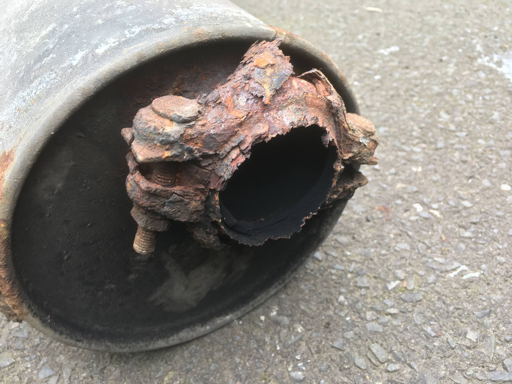

rainagain Posted August 16, 2020 Author Posted August 16, 2020 It had broken where the centre section joins the back box. Luckily I managed to get a whole new centre section from amazon for £12.50 delivered, but unluckily i can’t use the pit at my dad’s to fit it as I’m using his garage for storage for an upcoming house move.

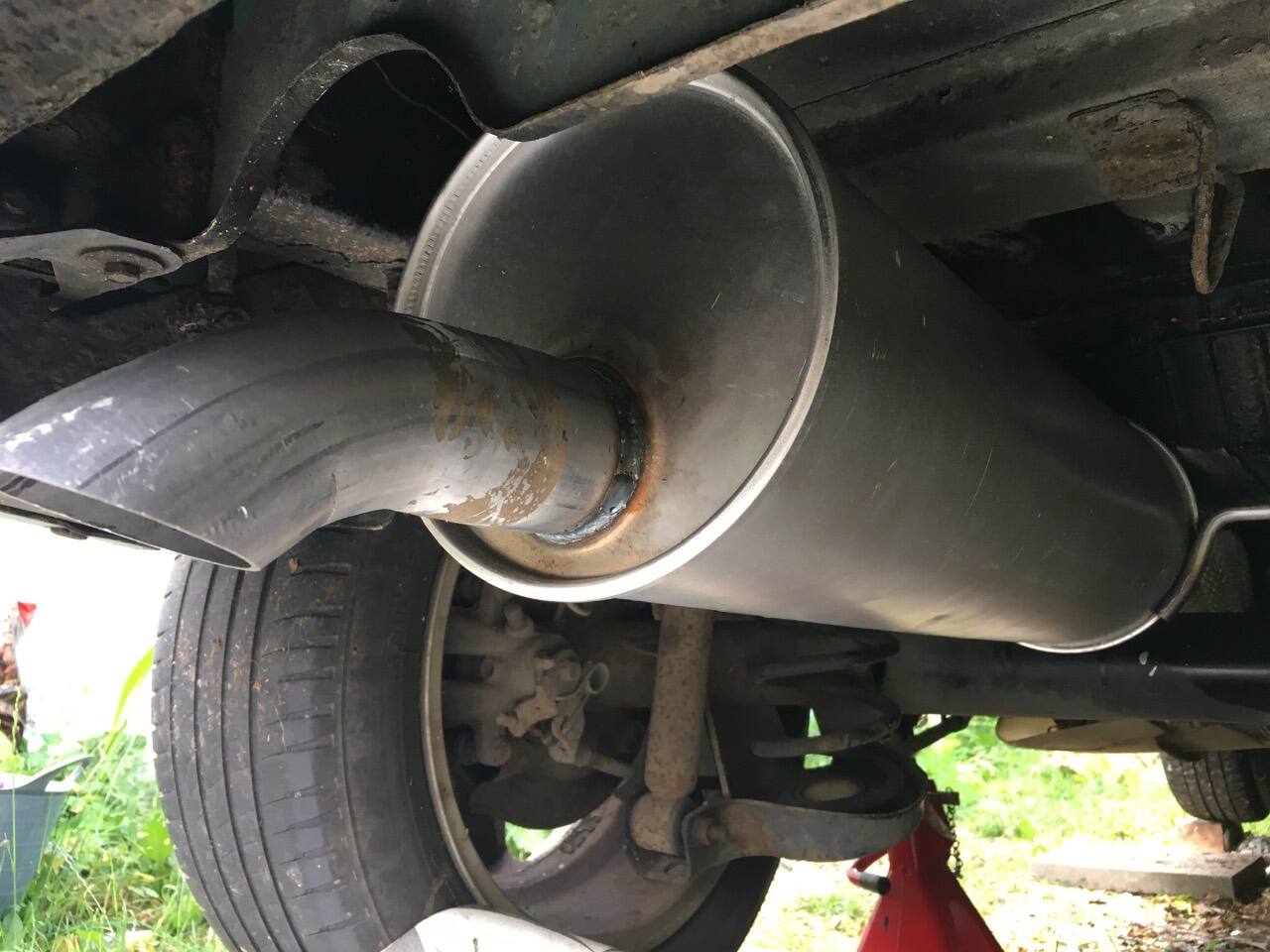

rainagain Posted August 16, 2020 Author Posted August 16, 2020 I’d rescued a lovely piece of stainless steel from work, what it was meant for I’ve no idea. But it was the perfect fit for the remains of the centre section. I had no gum gum so I used high temp silicon. I can’t see any problem with this as the gases are pretty cool by the time they get to the tail pipe. I also didn’t have the right type of exhaust clamp, so I had to use this flange one. I found two rusty studs nearby and used a die to remake the thread on them. Then I stuck on some repair washers and used some twisted wire to act as a support. Yes this truly is a lash up job! Good news is it’s actually quite quiet so it can stay until the mot is due and I get a chance to sort it properly. CreepingJesus, Tickman, Tepper and 2 others 5
Remspoor Posted August 18, 2020 Posted August 18, 2020 I do like to save money when I can. However in this case I do have ask why the bother of doing this work when a new box is little money. Installing a box in the first place would save getting under the car twice plus all the hassle of making those temp odd an sods.
rainagain Posted August 18, 2020 Author Posted August 18, 2020 Quite possibly because if you read my posts and look at the pics you can see the centre section needs replaced as well. As I said I have both parts it’s just I can’t get under the car easily right now as I don’t have access to my pit. Also the inner teenager in me was curious how it would sound with no back box and also if it would feel any quicker. Turbos cars are more affected by exhausts than non turbo cars. I had already planned to open up the replacement back box I have and gut it. Then fit a resonator pipe in place of the normal baffles and weld it back up. Then fit this with my new centre section. But I’m a bit busy right now trying to move house. The car of course had other ideas and decided to remove the back box itself. outlaw118 and Tickman 2

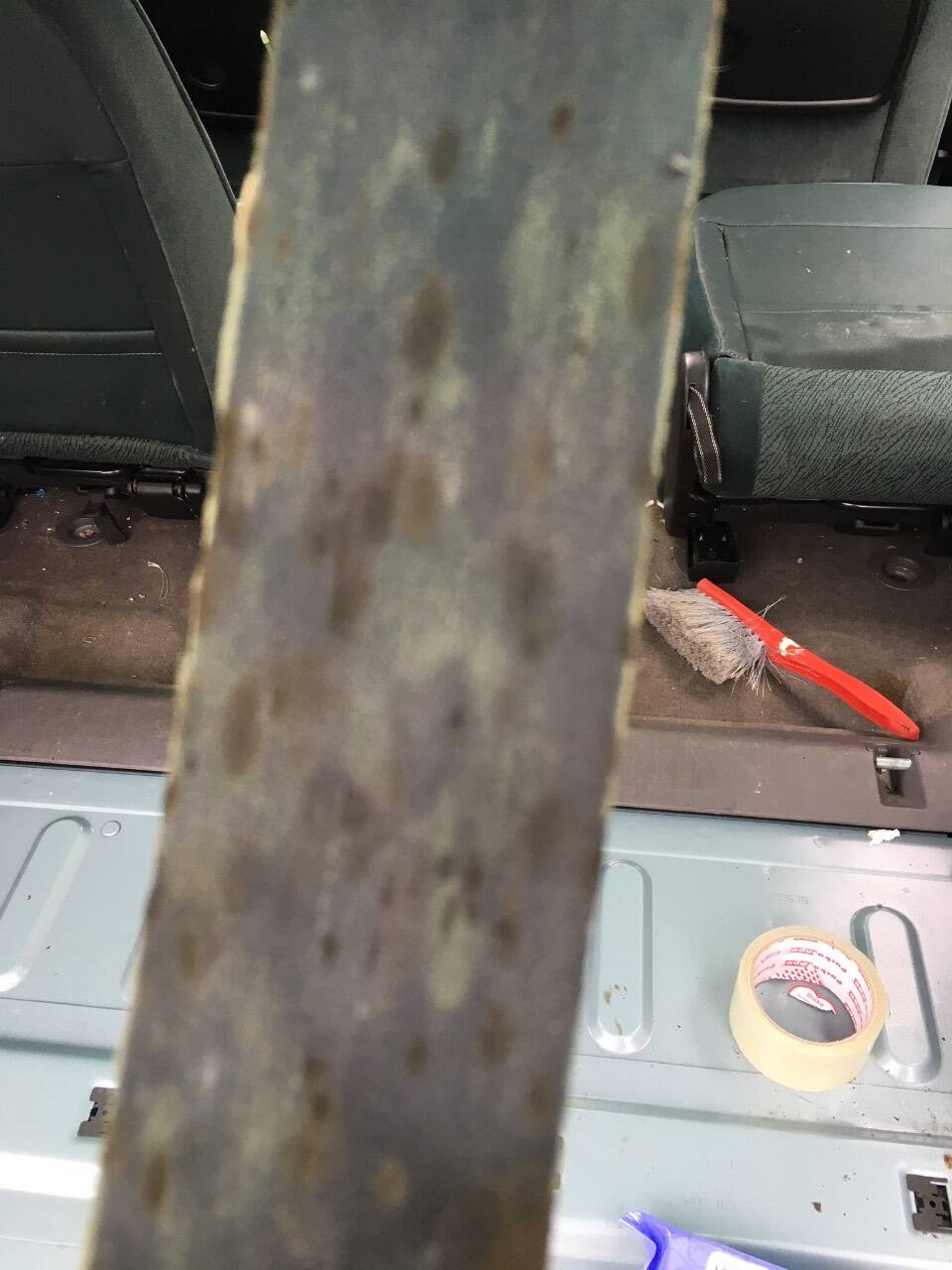

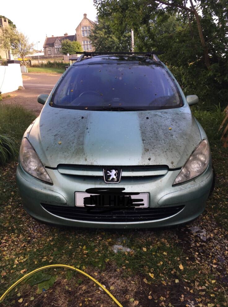

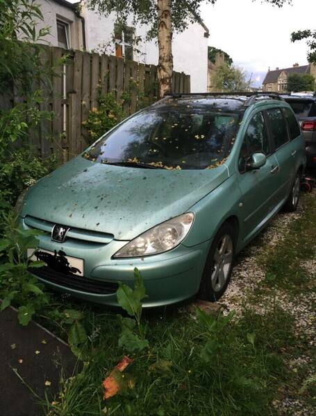

rainagain Posted July 17, 2021 Author Posted July 17, 2021 Thanks to working at home and having a ton of work to do on my new house the mot on this expired and it got left on the driveway under a tree. As I’m now having to go into site at least three days a week sharing a car with my OH hasn’t really been working out so it’s time to get this thing sorted out and mot’d. Some things had been growing on the seat belts Luckily I used a tip I’d read on here and wiped them over with white vinegar. Remspoor 1
Remspoor Posted July 18, 2021 Posted July 18, 2021 On 7/17/2021 at 6:13 PM, rainagain said: Thanks to working at home and having a ton of work to do on my new house the mot on this expired and it got left on the driveway under a tree. As I’m now having to go into site at least three days a week sharing a car with my OH hasn’t really been working out so it’s time to get this thing sorted out and mot’d. Some things had been growing on the seat belts Luckily I used a tip I’d read on here and wiped them over with white vinegar. Then lucubrate with silicone spray. rainagain 1
rainagain Posted July 18, 2021 Author Posted July 18, 2021 Being left under a tree hasn’t done the paintwork any wonders either Remspoor and stephen01 1 1

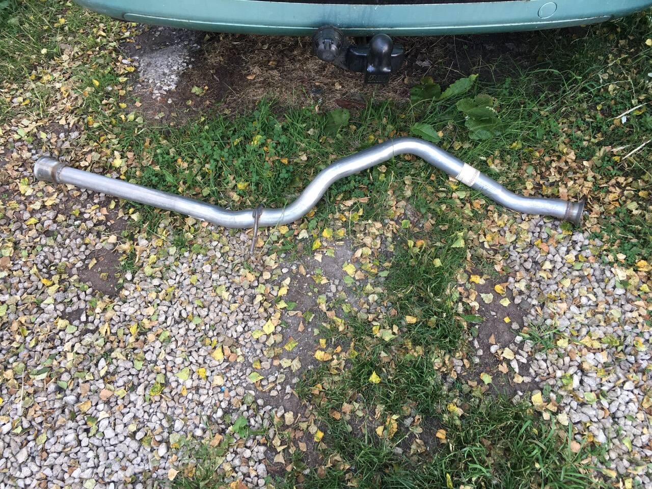

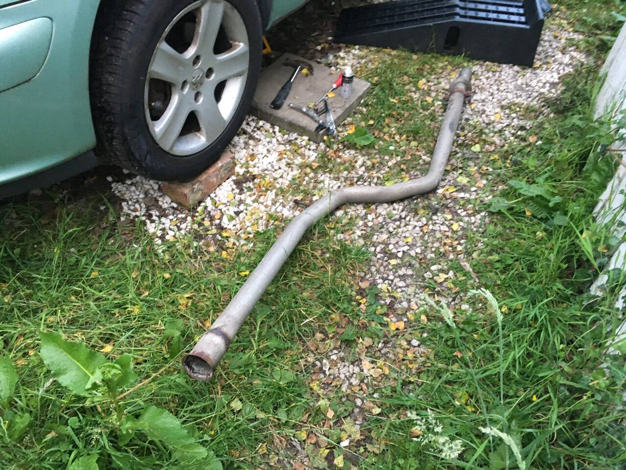

rainagain Posted July 18, 2021 Author Posted July 18, 2021 First job was to remove the rusted through middle exhaust section, no need to remove the back box that had self removed itself. RayMK, Remspoor and Dick Cheeseburger 3

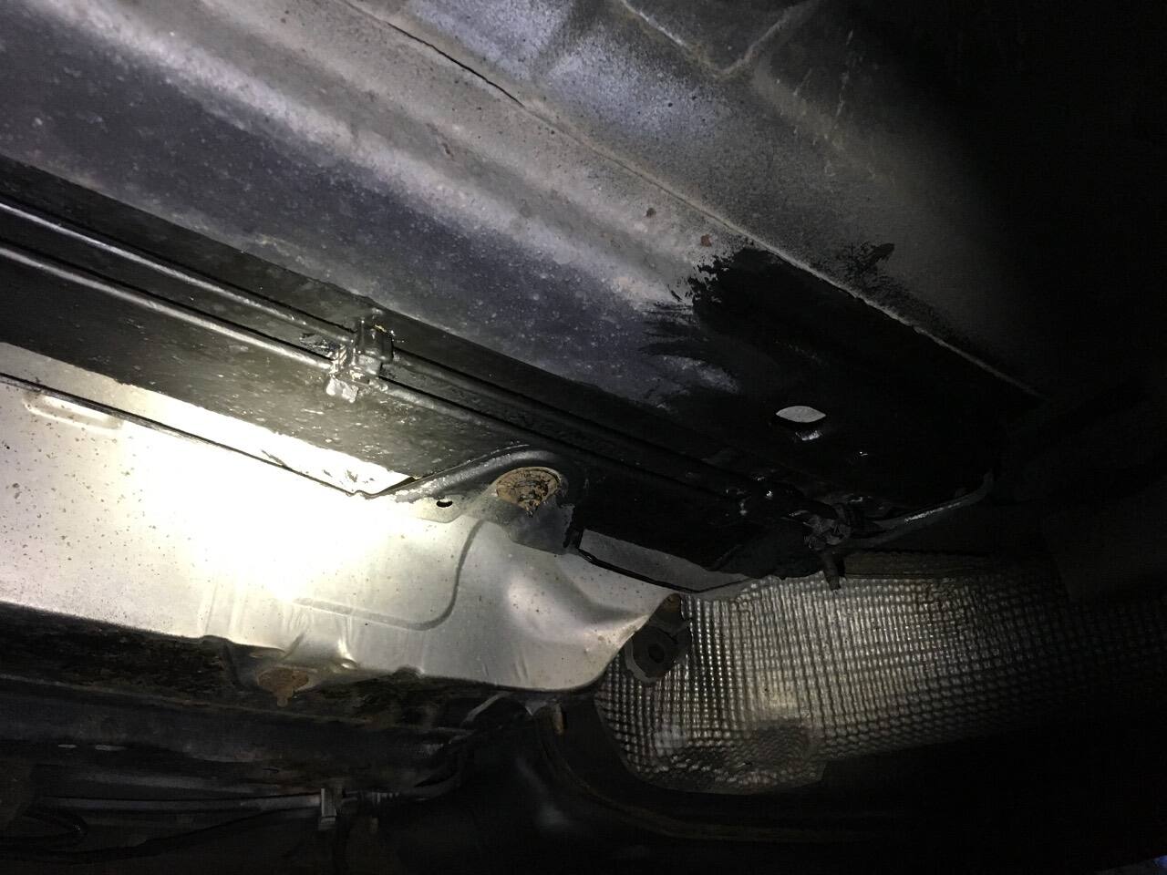

rainagain Posted July 24, 2021 Author Posted July 24, 2021 Whilst the exhaust was off I took the opportunity to vactan and paint some of the worst bits under the car. i RayMK 1

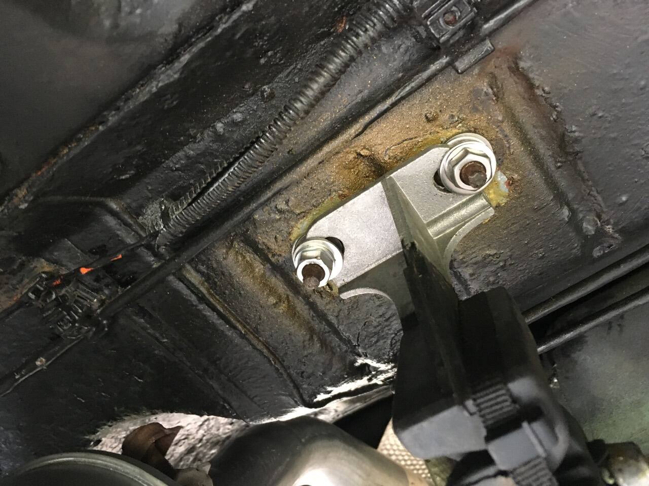

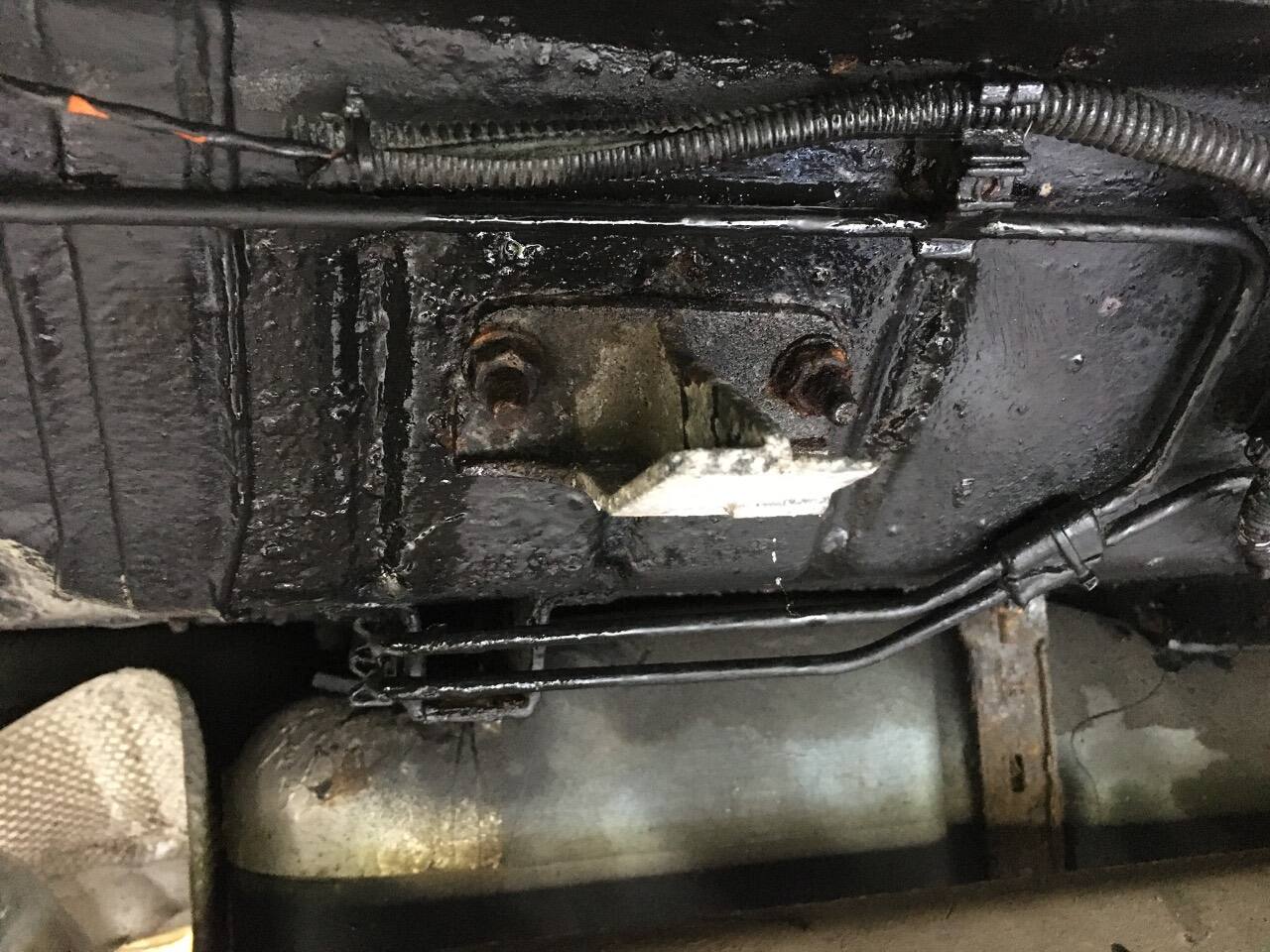

rainagain Posted July 24, 2021 Author Posted July 24, 2021 The rubber part of the bracket that supports the back box fell off when the back box decided it wanted to pursue a solo career. The nuts wouldn’t budge and I didn’t want to risk shearing the studs so they were cut off with a grinder. I bought a new bracket but sadly it looks far too small, I had to use some washers to both space it from the chassis and allow the nuts to hold it not ideal RayMK 1

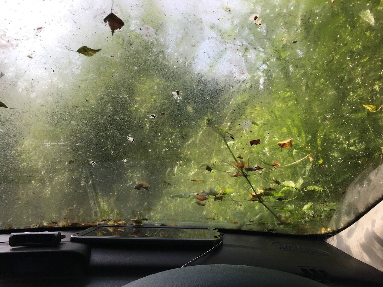

rainagain Posted July 24, 2021 Author Posted July 24, 2021 It was then time to lower to the ground and extract it from the bush that was growing round it. Here’s the view from the driver’s seat. Thanks to my solar panel plugged in the OBD it started no problem. And I was pleased so see no warning lights. RayMK and Dick Cheeseburger 2

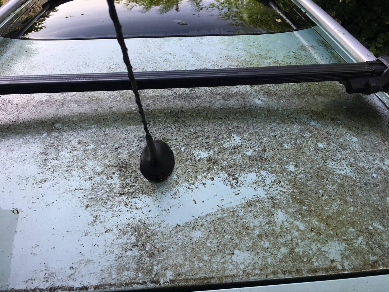

rainagain Posted July 24, 2021 Author Posted July 24, 2021 This was very satisfying sadly I couldn’t do much about the roof. It’s been suggested to soak this in dilute bleach. Anyone else tried this before? RayMK, Isopon, Dick Cheeseburger and 1 other 4
Sham Posted July 24, 2021 Posted July 24, 2021 I wouldn't use bleach, myself. Some kind of bug or tar spot remover might do it? Or even just a pressure washer? RayMK 1

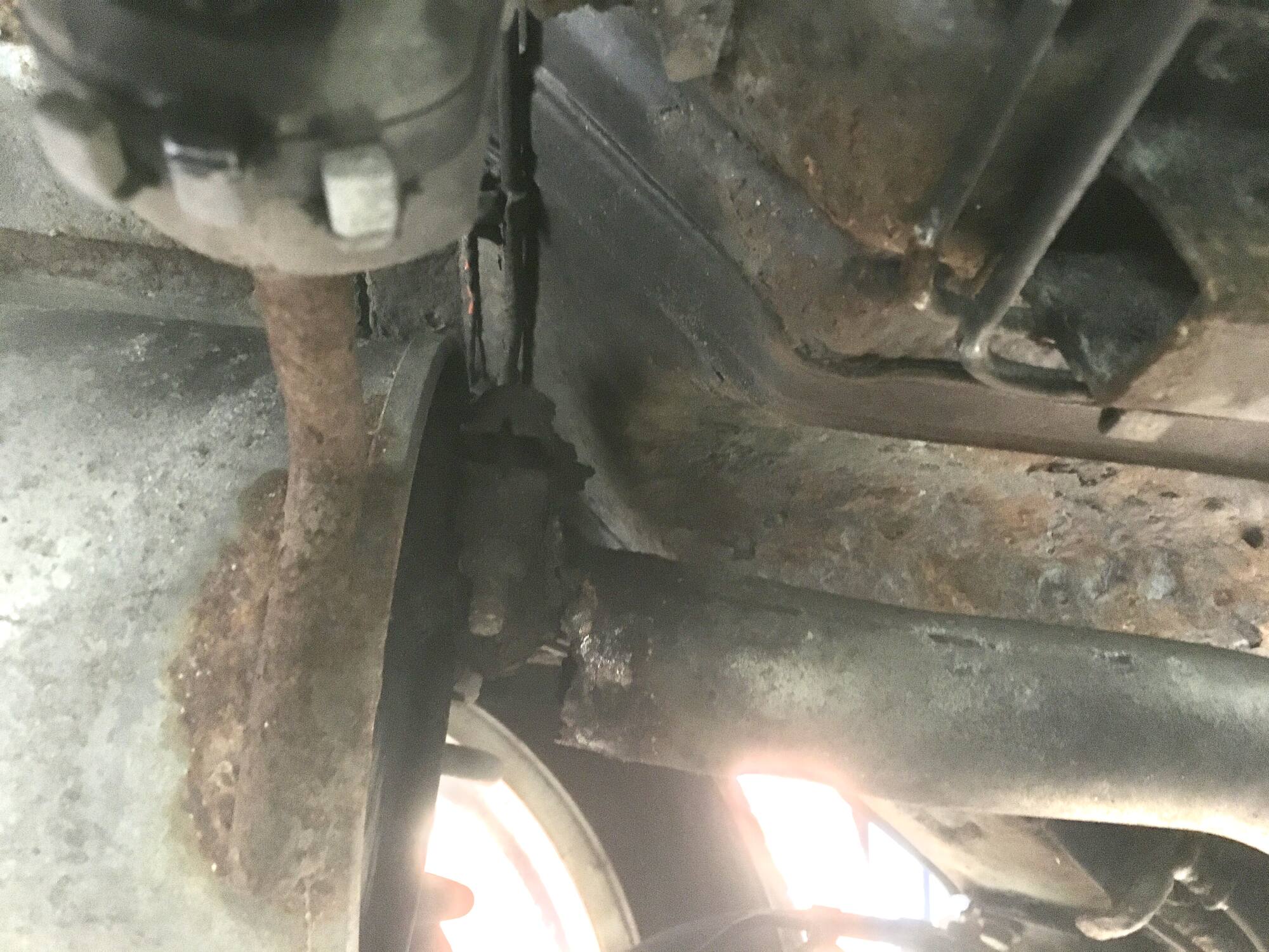

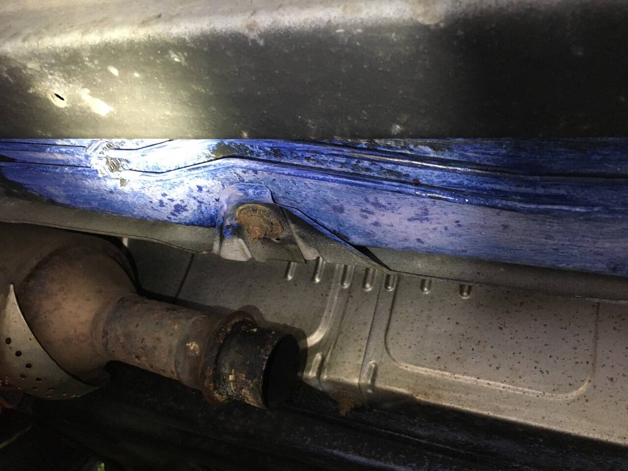

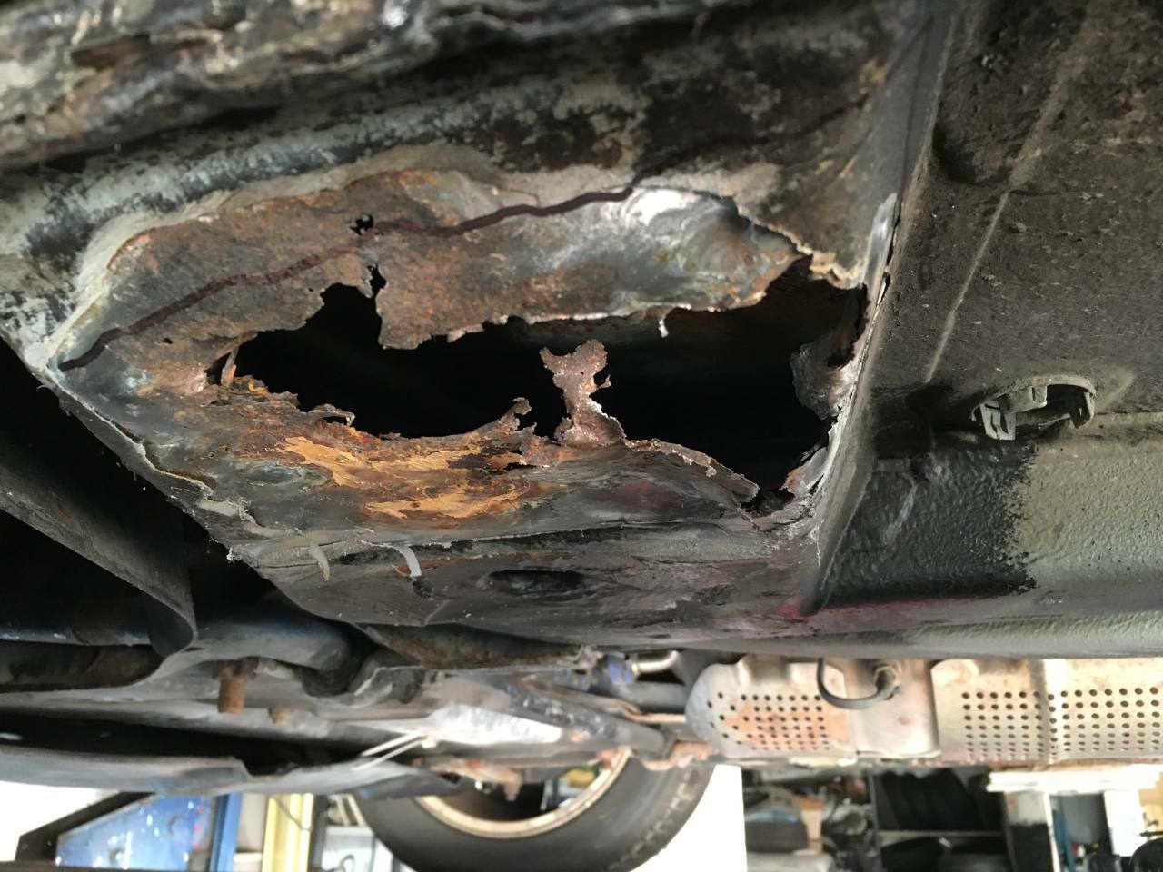

rainagain Posted August 10, 2021 Author Posted August 10, 2021 I got my MOT booked but it was so far away I thought it would be worthwhile looking at little tiny crunchy bit on one of the chassis outriggers. Massive thanks to @DodgyBastard for the use of his ramp and gear. Lets have a little poke at the rusty bit: Nasty, I did all this with just my hand and screw driver What's strange is the other side is completely solid.
