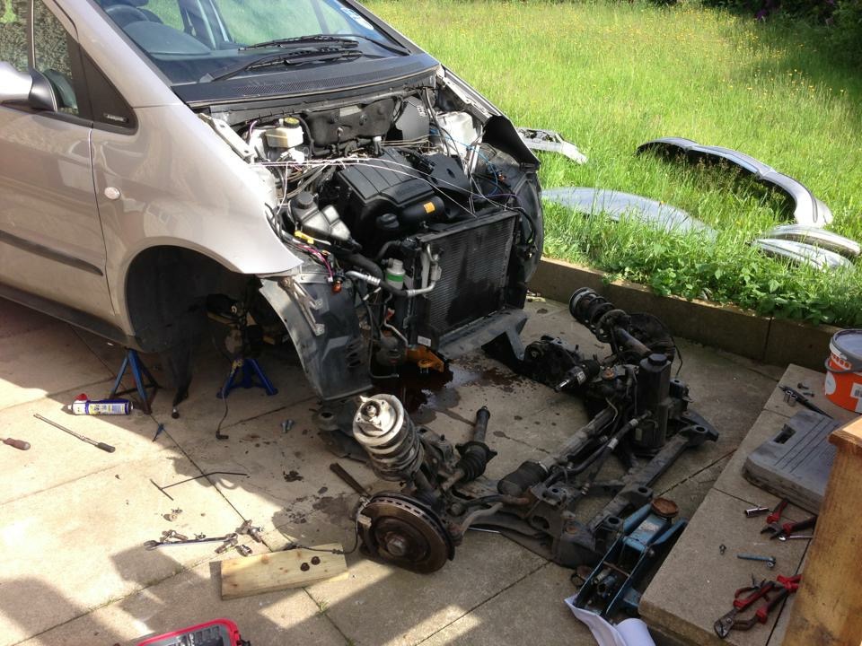

how come the clutch is such a big deal on them then, is it an engine out job or summert?
I've known people do it on the driveway, but they're all safely tucked up in their padded cell now.
Not difficult as such just very labour intensive. The official ford way was to drop the engine and box out with the subframe and split it, people generally drop the subframe down just enough and pull the box out that way though. Pain in the arse whichever way you go about it.

Depends what you class as leisure. Crouching down inside the arch taking the weight of a gearbox doesn't sound like the sort of leisure I fancy doing at the moment.
If you'd got access to a lift and a proper transmission Jack its a slightly different story. Anyway could have had a new clutch put in recently, stranger things have happened. Could be a real pearl or it could be a nail. Chances are if you turned up with £250 in your hands you'd take it away.
I've never done one on a Mk1, but I can confirm its a monumental bollock ache on a Mk3.  There is nothing specifically difficult about them (other than having a subframe which needs dropping) it was  basically just that everything that could be a bastard was being a bastard.  Exhaust bolts seized solid, balljoints wouldn't separate, intermediate driveshaft pulling out of the cup and the CV joint falling to pieces inside the rubber boot, shitty access (although it was a V6 which didn't help our cause) I wouldn't volunteer for another.
I have changed an Autobox in an A Class merc before and even that was less hassle than the Mondeo.
never done a mondo clutch but ^ puts some perspective on the effort
are mk1 dmf?
are mk1 dmf?
Yeah the A class was a fun weekend - actually two weekends because it was remove, send to be rebuilt and then refit. After that I erroneously believed any job from that point forward would be easier and therefore no problem.
