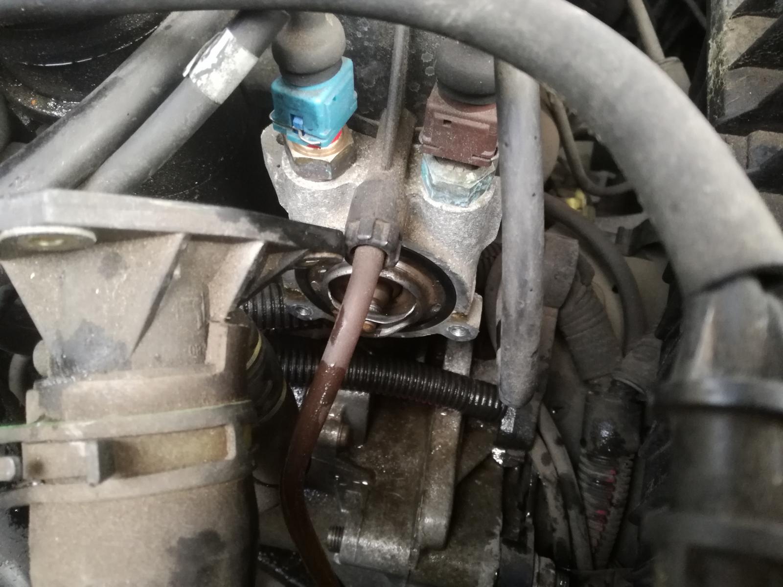

Talbot Posted March 5, 2018 Author Posted March 5, 2018 So. Now that Mrs. Talbot's Blingo has decided to eat it's own head gasket, I need something to keep her and the small T's mobile while I fight with a DW10 engine, so the Xantia is being pressed into service. Here it is in all it's snowy goodness. First things first. To be useable as a daily, it kinda needs some heating, as driving about with no heater is just miserable. So. It needs a thermostat. Christ, what a rat's nest of pipes that underbonnet is! I remember a time when you could actually get to the front of an XUD and work on it without having to remove a thousand stupidly-routed pipes and hoses. Ah well. French. At least the thermostat is still reasonably easy to get to. Quite why the top hose goes all the way to the wrong side of the radiator is beyond me, but at least it means there's plenty of movement to get the 'stat out without undoing those arsehole hose clips. The coolant that came out was remarkably clear and looking like water, so that'll need to be addressed at some point. I just hope I've gotten away with that in the recent cold snap. Old thermostat has a date stamp of 04 96, (just about visible) so that's clearly never been changed in the life of the car. The new 'stat is actually an old second-hand one from my big stash-o-xud-parts. It should be a good one, as I always change dead thermostats in any car I have. However, I know XUD's can suffer from not being able to be bled properly, so the nasty little fix to help this is a bleed hole in the thermostat. I'm sure I've seen XUD stats with a jiggle-pin before, but this one was plain, so a 1.5mm hole was duly drilled. Just got to remember to install it with the hole at the top. Topped back up with neat glycol to try and get some ice and corrosion resistance in there. Now attention turns to the inoperative fan. This had been suffering from the well-known Xantia "runs flat out all the time" problem. Unfortunately now, the motor may run flat out, but it doesn't do a lot: Bollocks. I'll be needing a new one of those then. Jim Bell, Lacquer Peel, Coprolalia and 2 others 5

Scruffy Bodger Posted March 5, 2018 Posted March 5, 2018 I've been under the impression for years that with many XUD's it's the fact the expansion tank is too low that doesn't help with bleeding. The fix is to get a pop bottle, cut the bottom out, bit of tape on threads and then fill the tank with that, thus pushing more fluid round the system and out the bleed points. Talbot and The Moog 2
Talbot Posted March 6, 2018 Author Posted March 6, 2018 I've been under the impression for years that with many XUD's it's the fact the expansion tank is too low that doesn't help with bleeding. This is absolutely true. The 405 in particular was terrible for it.. having the expansion bottle moulded in as part of the radiator with the working water level about 200mm lower than the water jacket in the cylinder head is just barmy. The best vehicle ever for an XUD installation that made sense from a cooling system point of view was the Talbot Horizon XUD. It's expansion tank was right up at the bulkhead, with the filler at the very highest point possible, with several pipes leading from local high-spots (like the thermostat housing) up to the tank. It filled perfectly every time without the need for bleeding. Like this: Even with a failed head gasket, you could just run the tank with the pressure cap off and all the combustion products would just bubble out and you barely lost any coolant. It was a brilliant installation. No McPherson strut tops to get in the way of cambelts, plenty of space to work.. etc.etc. Every other installation has local high-spots. The 309 installation got close to OK.. the tank was in the right place, but there wasn't enough bleed lines from high-spots to the tank. BX wasn't bad either. Damnit. I now have a hankering for another Diesel Horizon. Quite why I have no idea.. they were terrible. Jim Bell and Scruffy Bodger 2

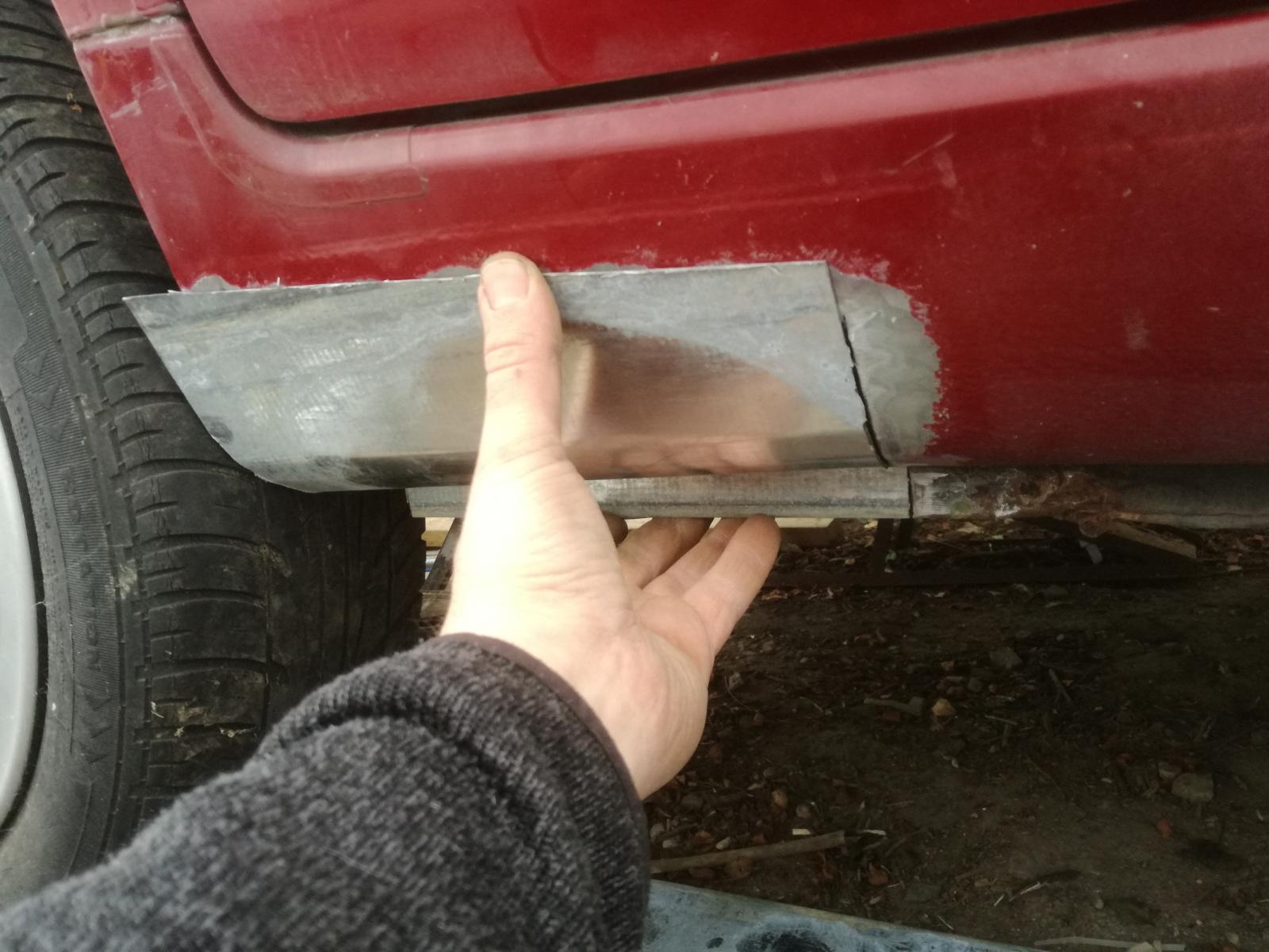

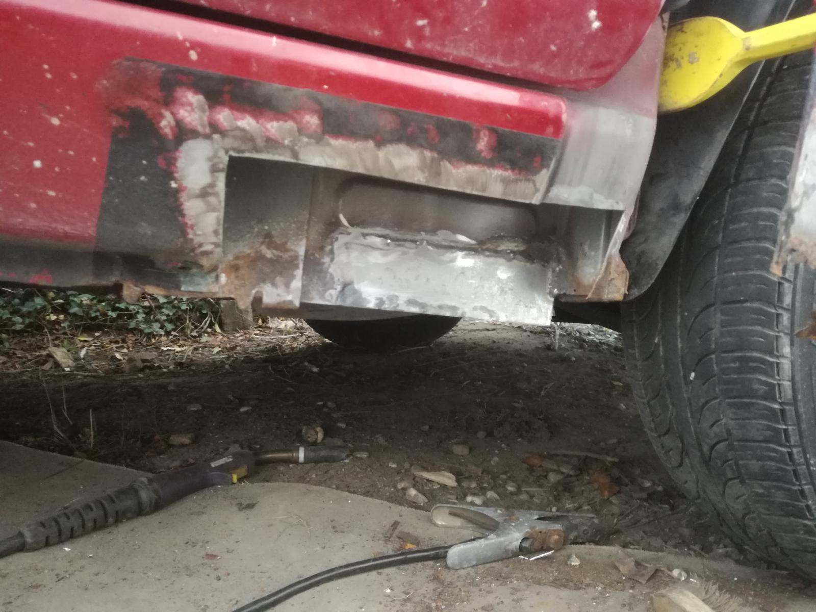

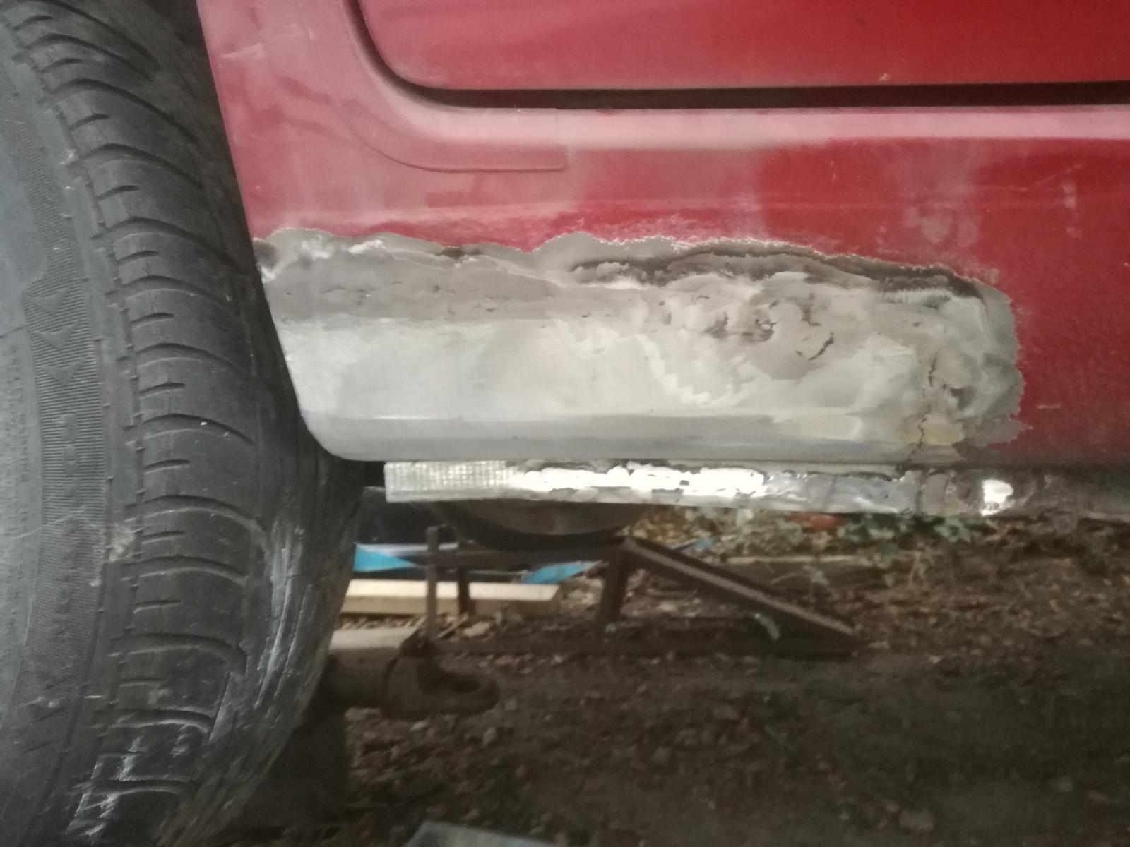

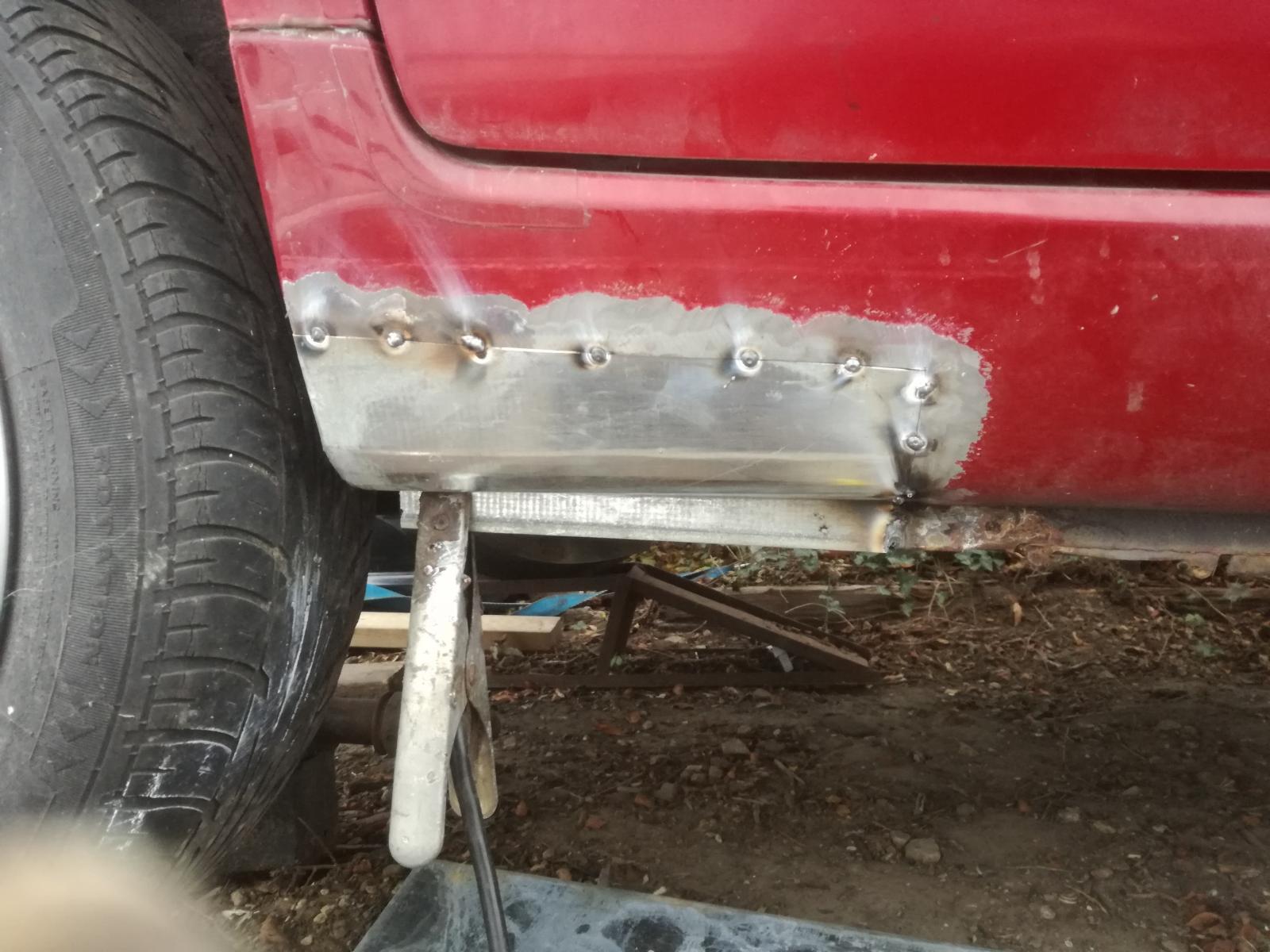

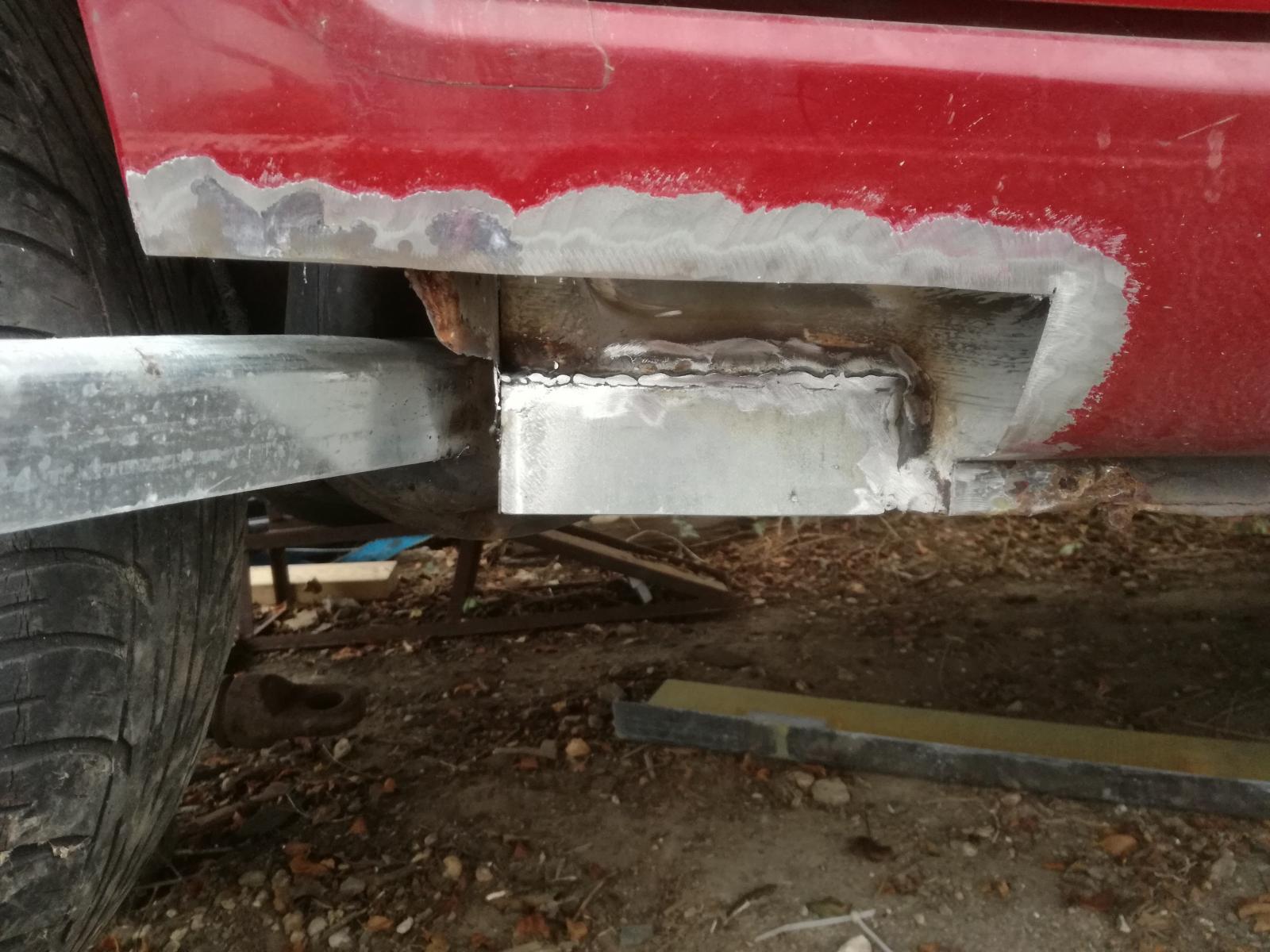

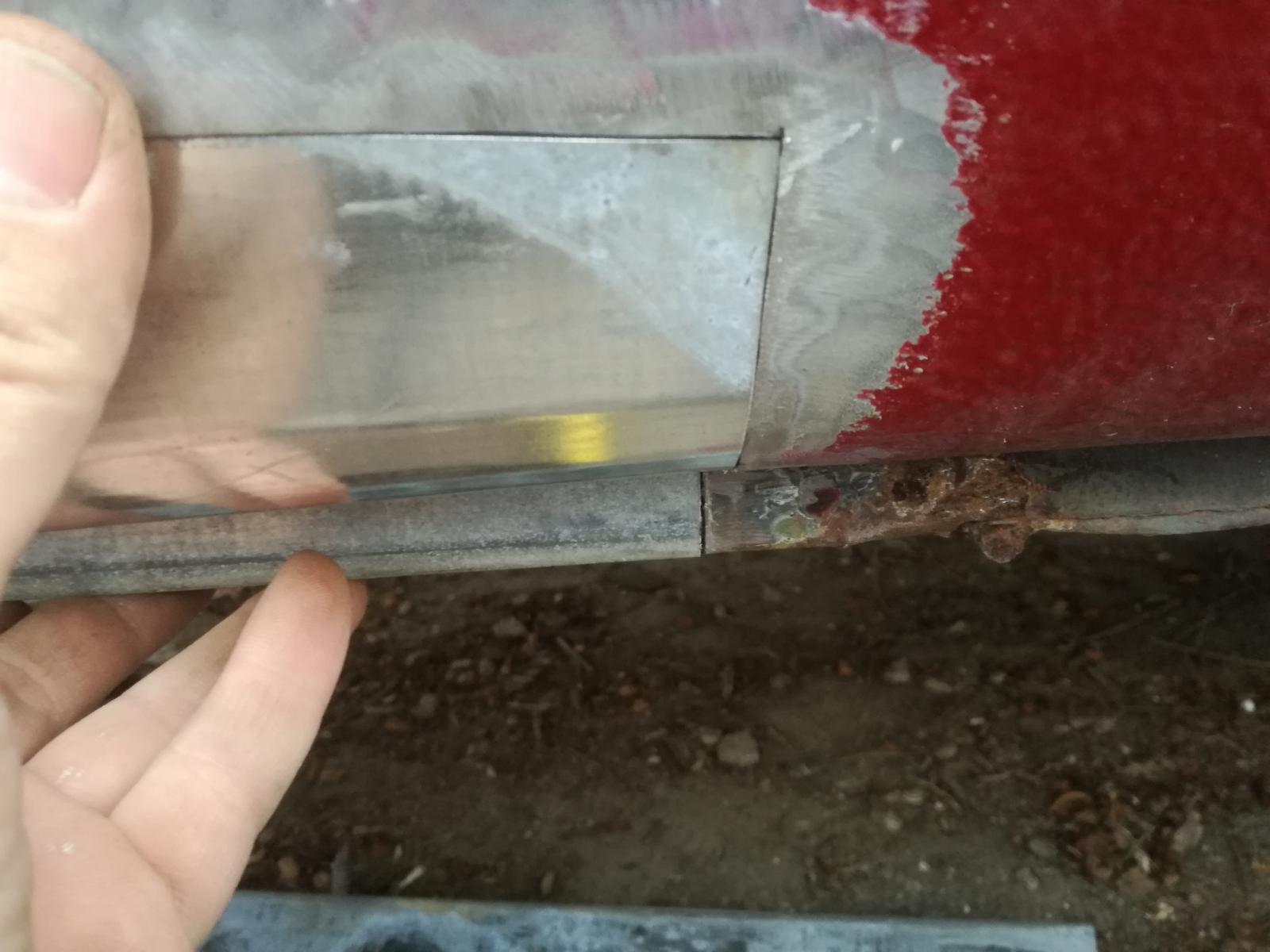

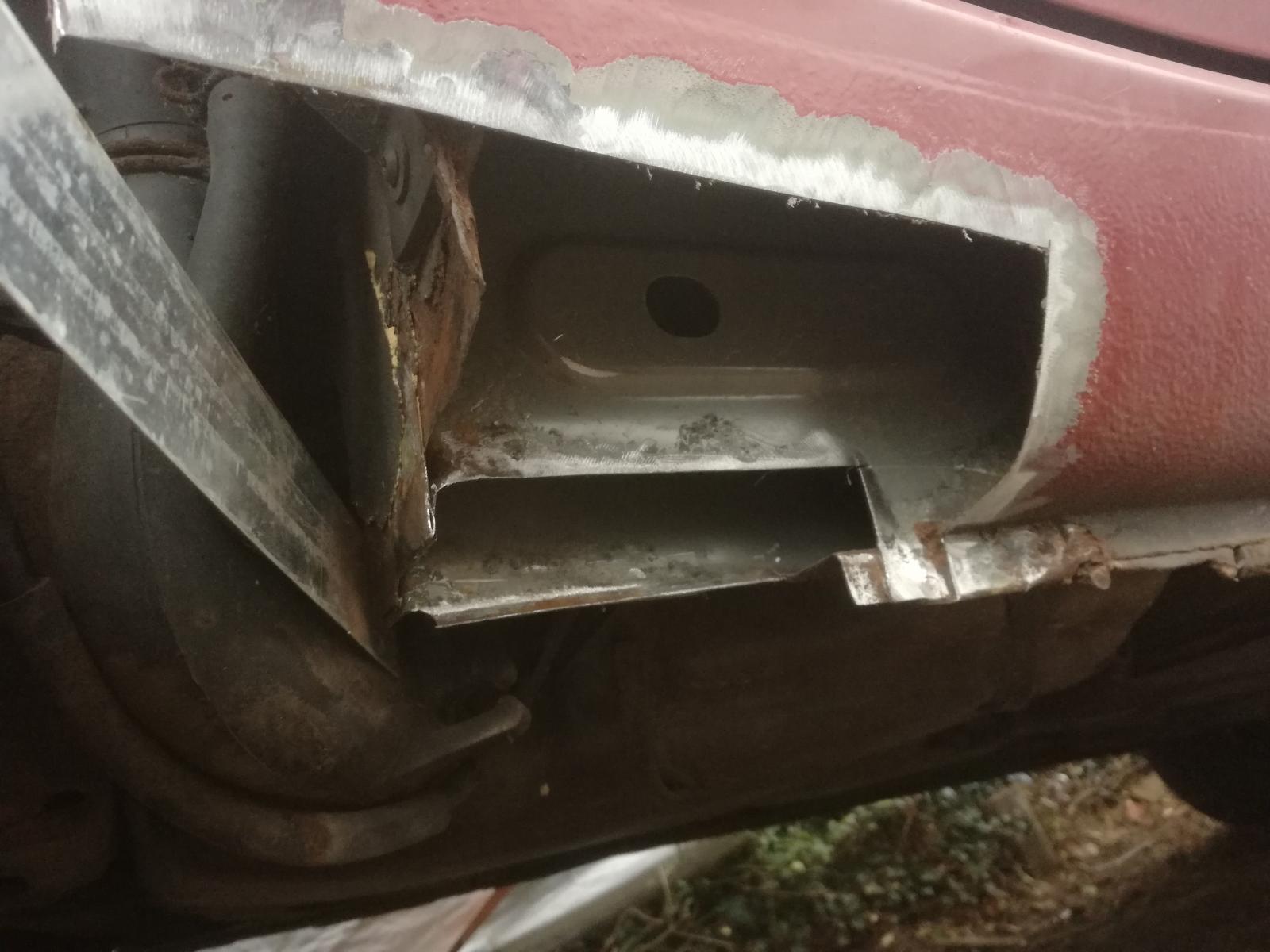

Talbot Posted January 13, 2019 Author Posted January 13, 2019 So. More Metal, more Grinding and more Welding: (my prediction was accurate.. I should do the weather forecast) Continuing from where I left off.. The sill needed an end closing panel, so one was made by mercilessly hammering until flat was no longer flat. And welded in. Thereafter, the outer skin of the sill could be trimmed to size and checked for fit. Not bad Also had to form the return that folds back into the wheelarch. This was less good, as I had to make several cuts to allow for the lip to be bent around the shape of the sill. It's untidy, but again, I' not worried. Now comes the bit that I am still somewhat out of practice on.. Tack the panel in place, and check for alignment. If I'm honest, I should have cut this off and tried again, as although each end is fairly well aligned, there's too much metal in the centre of the repair, so it doesn't sit level with the body. It's out by about 0.25 of a mm. Did I cut the tacks out, trim the repair and have another go at it? Of course not. Weld the bastard repair section in and be done with it!! That's the rear mostly finished now. I still need to remove the wheel so that I can weld the cuts in the return, and then it needs paint, but for the moment it will do. I now need to turn my attention to the front again, as the bottom 4" of the wing was rotted off, and I need to make a bit up to finish it. The ratchet strap is holding the rest of the wing in place (it's unbolted) so that I can just make up a bottom bit and buzz it on. Again, Function over Form here. I just need it to not flap about in the breeze. You can see in this last picture, the light has just about gone, so time to give up and drink tea. Next time, on the thrilling* adventures* of the Xantia. Wings and paint. And possibly the other side, as the other front wing bottom has rotted out and taken the sill with it. Tits. Six-cylinder, N Dentressangle, tobyd and 11 others 14
beko1987 Posted January 13, 2019 Posted January 13, 2019 Nice repairs, get the car running again, don't fanny about! Talbot 1
Talbot Posted January 13, 2019 Author Posted January 13, 2019 get the car running again, don't fanny about! This is currently my motto! I thought long and hard (OK, for about 5 mins) about what course of action I should take on this car, everything ranging from buying £eleventybillions worth of genuine panels (wings, sills etc.) and doing a "proper job" on it, to heaving the engine out and bridging the rest on the basis of it needing too much work/welding/panels. The deciding factor was the repair that a friend and I once did on a breadvan polo nearly 20 years ago. He had just discovered that the OSR inner wheelarch was utterly rotten, and once the inner trim was removed you could put your arm through the hole and touch the tyre. He arrived at my house in a bit of a panic as it was up for MOT the next day. Between us, two grinders, a welder, a lump hammer and bit of old bonnet we "fashioned" a repair. It was based entirely on "fuck it, that's near enough", and we formed the shape of the arch by welding a bit, then twatting the panel, welding a bit more, twatting it a bit more until it sortof fitted. Slapped some bitument paint all over it, job done. From arriving to job complete was under an hour. That repair outlasted the rest of the car (which lasted many more years thereafter) and MOT man didn't bat an eyelid. If that worked, I can do the same on this car and have it work. I suspect I've only spent about 5-6 hours on it so far, but could quite easily have spent double that time for a barely-any-better job. So yes. It's not a bodge. It's just not fannying about! Also. Some of the (inevitable) welding burns from a few days ago where I was trying to do a full seam weld on the lower seam, and several largeish blobs of molten metal fell out, burning straight through my old fleece: Y tho?
