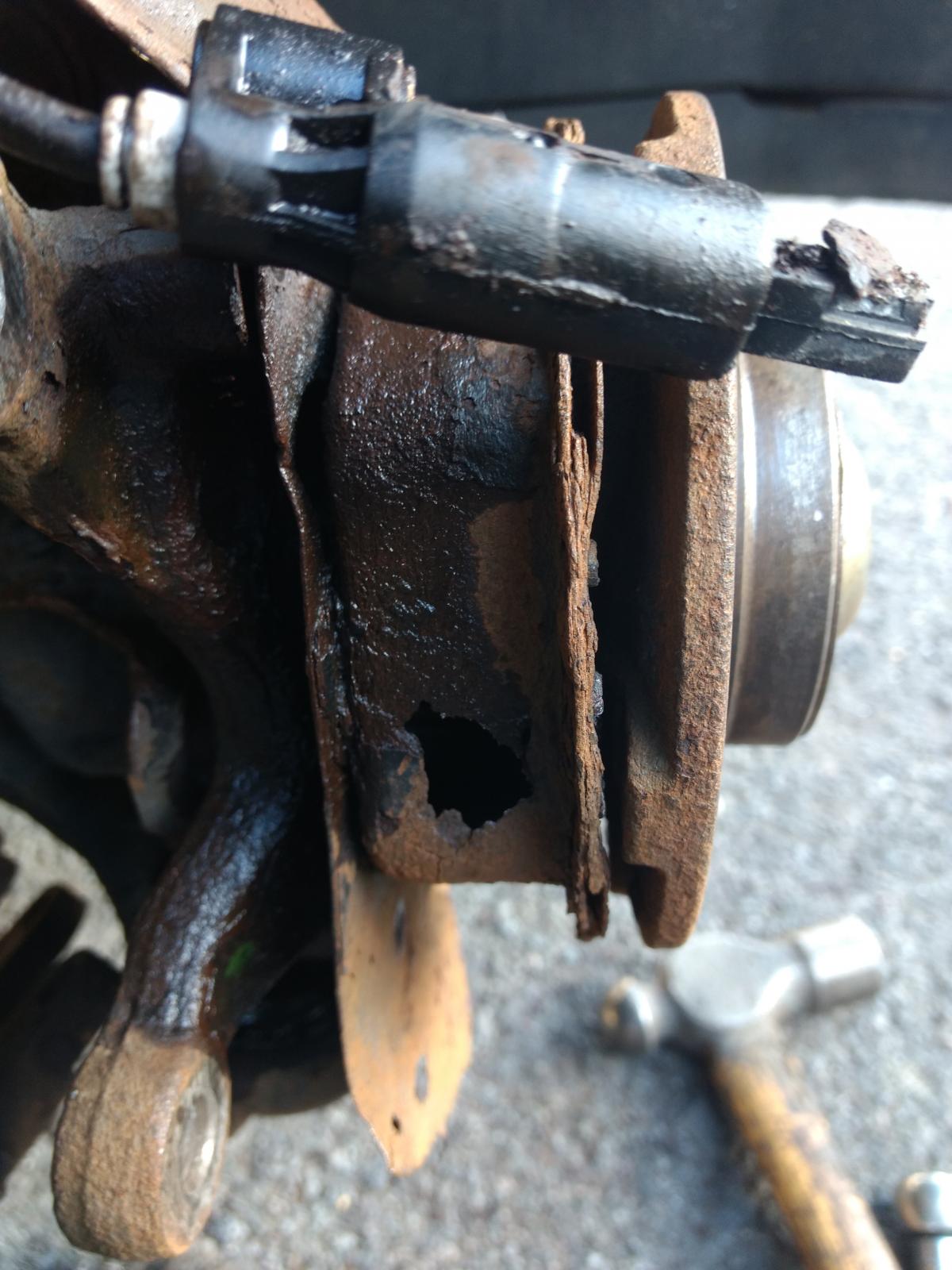

Crispian_J_Hotson Posted February 19, 2018 Author Posted February 19, 2018 Well it done it once again shortly after the last post and hasn't done it since, even starting in -2 degrees. I looked at 5w oil and that is fully synthetic and I have ordered some to try it out. When that finally gets delivered, it'll be going in. On another subject, sensors... the DSC light came on ages ago and eventually knocked out the ABS, conveniently just before winter too but I don't rely on these systems anyway, they are still novel features however, I would like to get it sorted. I need to cobble together some kind of get up to plug into the car and read the parameters if anyone has some recommendations. It doesn't have the regular 'diagnostic plug', just the round connection under the bonnet. Until then, I set about replacing all the sensors as they are pretty cheap and if they come out in one lump I'll have some spares. Ultimately, they can be a pig of a job on the roadside so it would be nice to assemble it all so that in future I've half a chance of getting them out without having to resort to THE HAMMER OF THOR.So armed with a set of sensors I thought that this Saturday I'd swap the lot... yeah... right! The N/s wheel sensor wouldn't move for toffee so a fight ensued and it got a clump from larry lump hammer and sidney screwdriver which meant it came out in several pieces. Now, these BM's have a shield surrounding the sensor and sensor ring and short of removing the hub, can't be got at inside as they are attached to the backplate by a thousand rivits. Visually, there was nothing untoward this side but an excessive build up of brake dust on the sensor ring which cleaned off lurverly by means of a handy old toothbrush and some WD40. The new sensor fit like a square thing in a round hole so was tailored* in a bespoke* fashion to fit, which it did quite well. The O/s however was a different beast. The backplate was flippin well rotturn. This 'shield' was falling to bits and once the sensor was extracted in one piece surprisingly without any major surgery it was noted that the magnetic parts of the sensor were covered in rotten metal debris. See exciting pic below: I had no option but to cut off this shield and bin it before it fell off. The backplate looked alright for another few years but was showing signs of giving out. My question now is this: Can it run without this shield in place or will it keep fouling up and buggering the DSC/ ABS system?For the record, and as no-one seems to know, the warning lights have not gone out but I have the rears to do yet which I can't wait to do* (yes I can) and I suspect I'll need access into the mind of an ECU to read/ erase the faults as the battery disconnect does nothing, contrary to some belief out there. In other news, Spark plugs came out looking nice and even coloured across all cylinders at 171,000 miles, a little worn so needed fresh things anyway.New tailgate struts which actually lift the tailgate!I like the Dunlop blue response tyre but as I have found with the sport series on my 635, the rubber starts cracking after 6 months along the tread which is a bit of a downer as they suit the cars well. I've tried formula one's Cooper specials on the back of the 635 because it doesn't do many miles but they are shite in the damp making a trip around a roundabout because drift king* so I don't fancy running these as a daily, time to go uber premium?Pads are down too on the slider side of the o/s caliper... darn it, I chucked a second hand unit on there because when I got the car again the caliper was seized solid but the sliders were 'sticky' and binding the disc on the replacement. I thought after extensive cleaning and lubricating that it was job done but although it's not binding, something is sticking on it as that one pad is worn low... time for a new caliper or 2!Rot. Front o/s wing has all of a sudden blossomed some rot in spectacular Mercedes style above the arch, time for an arch liner removal and jet wash session when and if the weather ever cheers up. New wing to add to the new sills shopping list, although I am holding out on those until the handful of issues get resolved elsewhere on the car first.Rear luggage interior light has started to work when you switch it on! It's never worked since I bought the car the first time around, still doesn't switch from opening the tailgate though. Combined borked wire and dodgy switch I reckon, no big deal though.Emergency coil pack on it's way to live in the boot with various other 'get you home' bodgery, it misfired on start up a couple of damp days ago but nothing since and runs ok.Replacement cam cover coming too, the existing has been coated in Arthur Daley's engine shine lacquer and now it's old, looks shit. That's a shame because the engine in this cleans up a treat.
The Reverend Bluejeans Posted February 19, 2018 Posted February 19, 2018 All sounding familiar. The ABS light pinged on with mine 2 weeks ago. Had it scanned, passenger front sensor. New VEMO sensor was 15 quid and I changed it in about an hour. I undo the big nut and remove the hub, beat the old sensor out, clean up the hole with a file and pop the new one in. It's actually quicker. My backplates are also pretty rotten, 20 years old I guess. Unlike the nasty E46, the E36 ABS system recognises a new sensor and self clears the fault code with the ABS light. Mine always elicits a slight tappet tango on cold starts. 181'000, due an oil change about now. Rust is getting a grip of it now, needs some quality* repairs this summer if the fucking rain/cold ever stops. The radio is as useless as ever - the inbuilt arial is as much use as tits on a bull. Fucking good car though, wouldn't be without it. Vince70 and Crispian_J_Hotson 2
Crispian_J_Hotson Posted February 19, 2018 Author Posted February 19, 2018 Cheers, some tips right there. I get on with the radio alright- that business unit it is. Because I drive between north and south quite frequently I have stored stations on fm1 for home and retunes on fm2 for the south.Thought about binning it though in favour of some Bluetooth thing but still want the autochanger to function. Needs research. I want to look at new backplates but I'd also change the bearings as a matter of course which means I need two spare legs for decent rebuilding. Agreed, it's a very capable old boat. Has yours ever had a clutch? I have a metric tonne of paperwork for mine but no receipt for a clutch...?
