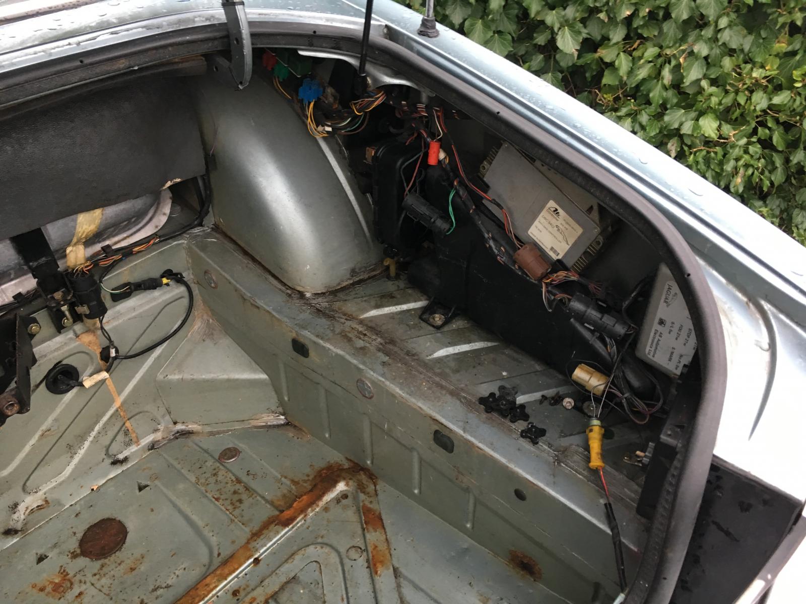

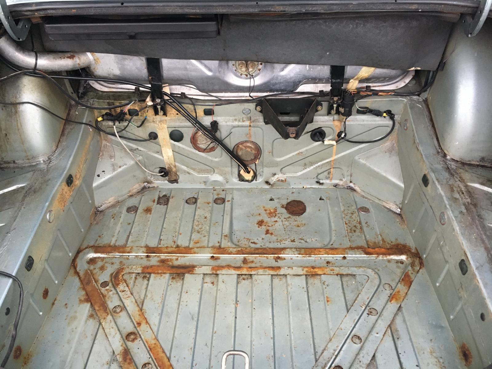

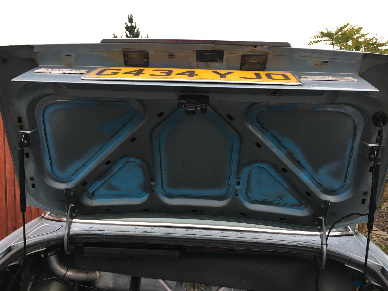

Today saw some good progress despite the poor weather. I started with the boot as it was very damp. Pulling out all the crap showed the true state of affairs, there is surface rust all over the floor, but everything is solid. No holes. The aerial mast rubber grommet had been letting water in freely. I used a bit of bathroom seal as a temporary measure just to stop the torrent of water getting in. The nice spare wheel turned out to be not so nice when I saw a massive bulge on the back. I've left it out in the shed for now. It has the original jack, ratchet thingy and wheel nut wrench, and what seem to be the jack kit from an X300 as a spare set.
Four rubber grommets from the back of the boot were out. Three retrieved and reinserted, one has a plastic bag for now. Hopefully the boot wont leak now, but I've cleaned everything up to a certain extent and removed all the mouldy and needs a good seeing too. The right hand side carpet is missing along with the carpet for the bootlid. The boot needs rust treatment and painting. I had a good prod in all the nooks and crannies, looks pretty solid for its age.

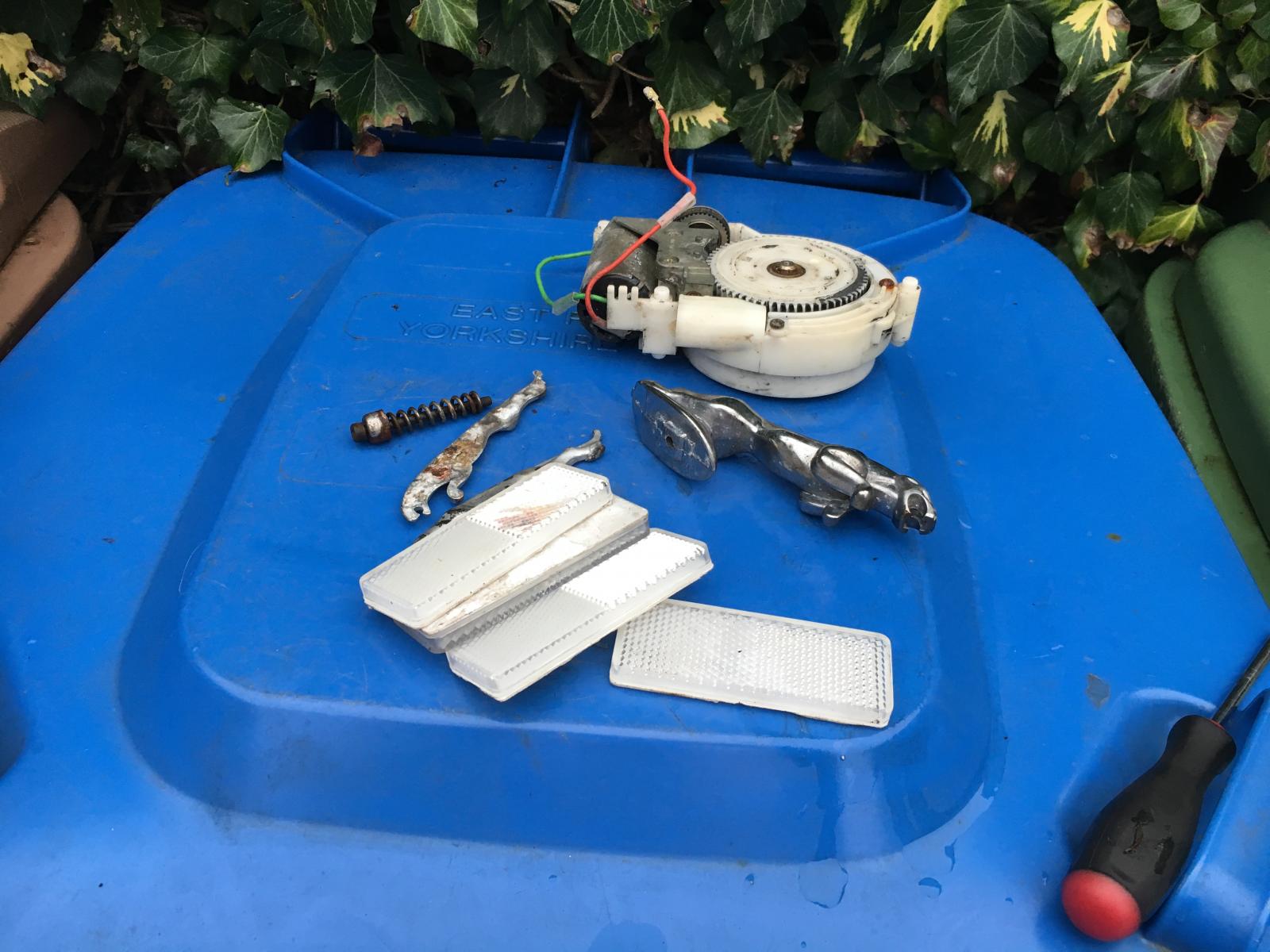

Next to remove as much as the giffer tat as possible. All the interior stuff was easy enough. Things were just stuck on with adhesive strip. Soon it was in the bin. On the outside I found the stupid reflectors on top of the originals would twist off (they were just stuck on). The glued on badges on the wingmirros popped off leaving some epoxy residue which I will fix tomorrow. The leaper is now gone, but it's base will have to stay for now as I fear there is a nasty hole(s) underneath. The thing in front of the leaper popped off but took a small amount of paint with it. It will touch up ok.

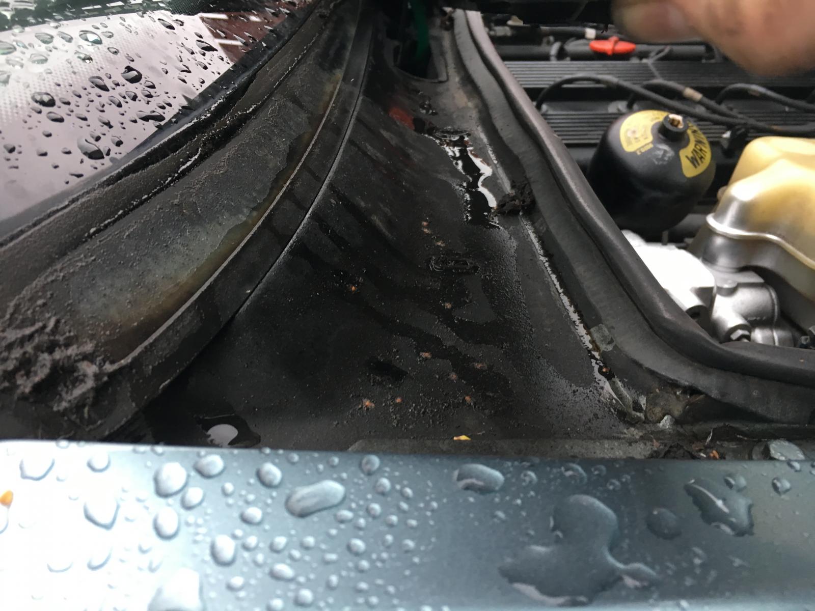

As a bonus I took a deep breath and had a peek under the driver's side scuttle panel. Have a look at the photo.

There was enough junk to fill a wheelie bin in there. There kind of is a wheelie bin in the boot anyway. A large black plastic boot tray which appears to be a genuine Jaguar part. Not much info on it, but there is a mention of it on the XJ40 forum. It seems to be quite rare and gets XJ40 people quite excited by the looks of it. I still think the boot layout is just mad. Look! Another video.

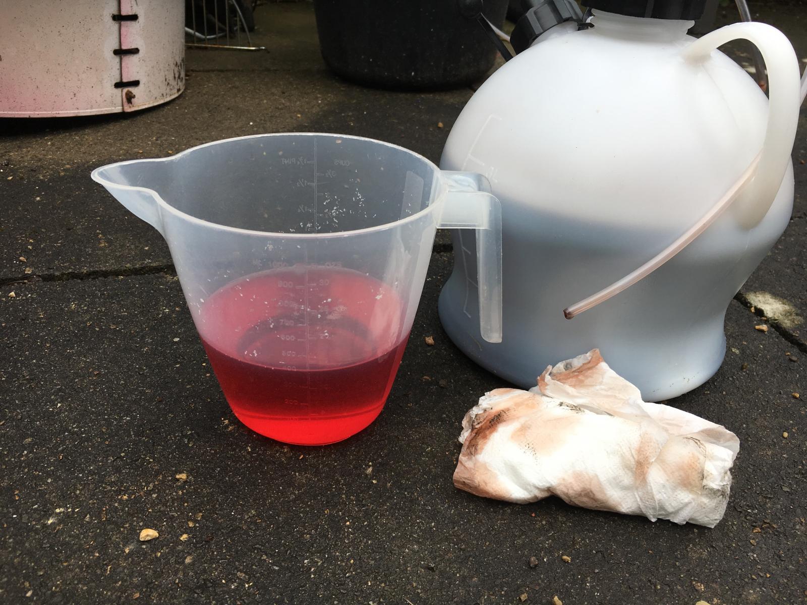

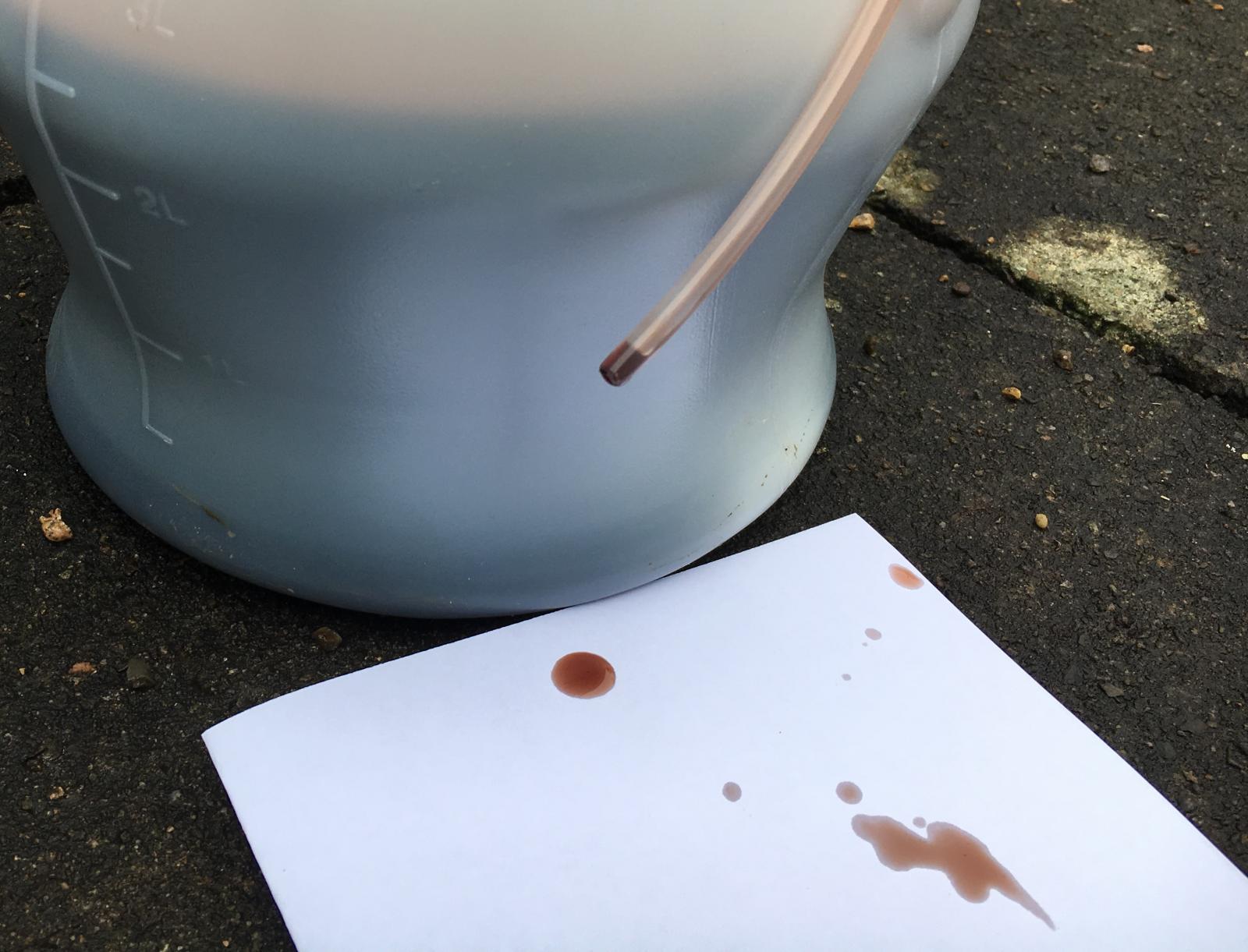

Today I used my new fluid extractor setup to empty as much transmission fluid as possible. This is now my favourite tool. 2.75 litres of ATF extracted without any mess or lifting up the car. What I learnt was that inspecting the condition of the fluid on the dipstick is deceptive. What was in there still looked fairly red (on the dipstick). When I got a load of it out, it was quite a dark red. The Dextron 2 is clear cherry red.
This made things a bit smoother, but not massively so. I still have plenty of Dextron 2 left so the next time it will be off with the filter.

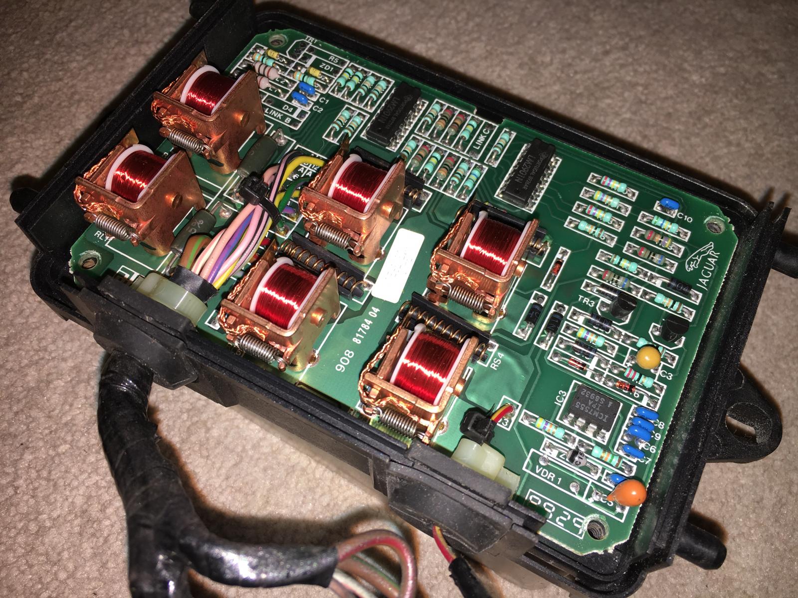

For reference. My first attempt to solve the phantom failed bulb light started with checking bulbs and connections, which all seemed adequate. Indicator blinking double speed on the dash on the right hand side (not outside) suggests bulb failure module problems. Tonight I took out the rear right BFM, because access is good. Inside it is remarkably clean considering how damp the boot has been. The crusty orange residue is presumably old solder flux and not the cause of a problem. No dried out solder joints I can see. Next up will be the front module. Access inside the BFM is very simple. Just unbend the metal tabs on the edges.

In other news. Jaguar Enthusiast Magazine is quite nice. The post about the bulb failure module was in fact that that module I photographed is faulty. I've tried cleaning that brown crud up without results. A good pair of replacement exhaust manifolds has been acquired. Also I'm quite keen about a LPG X300 3.2 in Scotland, but can't get to it till Thursday. Considering another blind purchase. Worked well with the Xantia.

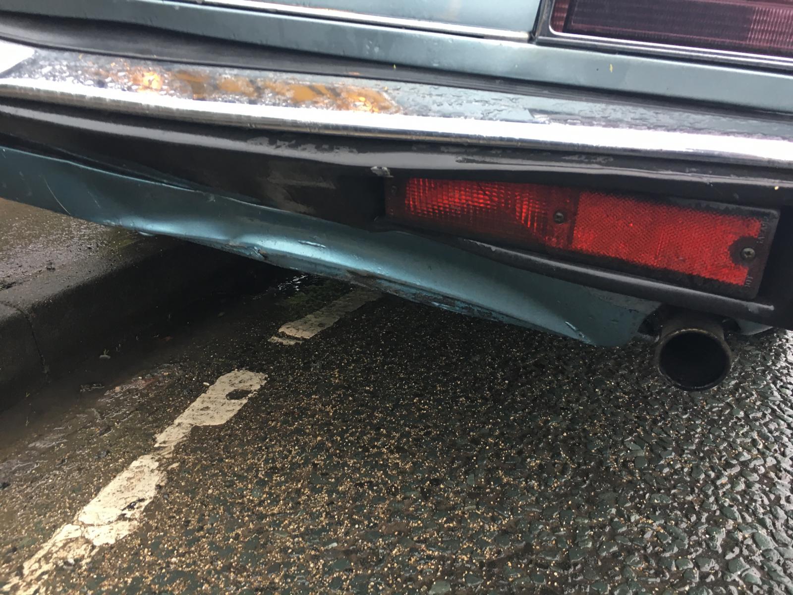

About a week ago I was merrily driving along, basking in the magnificence of the Jag. Then I needed to stop at a zebra crossing to let a pedestrian cross. A couple of seconds later, BANG. An Alfa Romeo Mito drove straight into the back seemingly for no reason at all. The driver of the Alfa took full responsibility, the car was taken away as undrivable on the Friday and I have just agreed on compensation today. Long story short this is the end the XJ40. Obviously I'm gutted, but you just have to be pragmatic with these things, realize the car cannot be fixed, and just move on.
Now I do have the option of buying the car back for £160. I can't store it so it only makes sense if there is a buyer ready for it. I'm looking to make a £100 profit in the event that I don't have to deliver, otherwise I won't bother. Let me know if interested. Still taxed, MOT'd drivable (although not recommended) and insured, just in case someone is interested.

Well the good thing is that no-one was hurt in any way, and that there were no arguments afterwards. The big cat clearly took the brunt of the impact, I was on the brakes quite hard in a bid to stop it moving onto incoming people, but it still moved forward a few feet. The Alfa seemed to come out of it relatively lightly. Front bumper cracked and one headlight cracked. Shows the progress in vehicle safety I guess when a 1200 kg car takes out a 1800 kg stately home. The XJ40 should have had adjustable headrests for the front seats, my head went over the top of it.

I think it would attract too much attention with the back end caved in like that. Also it's old enough for there to be some unexpected collateral damage which may creep in. Body shop only seemed interested in the caved in bit, did not comment on suspension or anything. Basically I won't take the risk keeping it on the road. Yes my neck moved back a bit more than one would like, but I've had zero problems at the time or since. If I get a twinge, then straight to the doctors obviously.
You'll probably find that there's a *lot* more that's moved under the skin on the Alfa than you can see externally. It would probably have looked a lot worse if the bumper was off.
Jag will probably be fine provided the shut lines of the rear doors haven't moved. If much has been shoved forward it should be visible there I'd think. They're pretty solidly built old tanks so long as the rust hasn't got to them...
