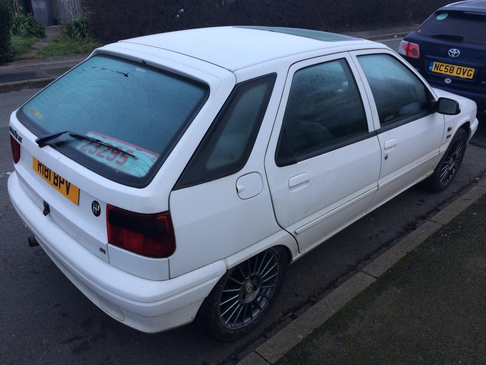

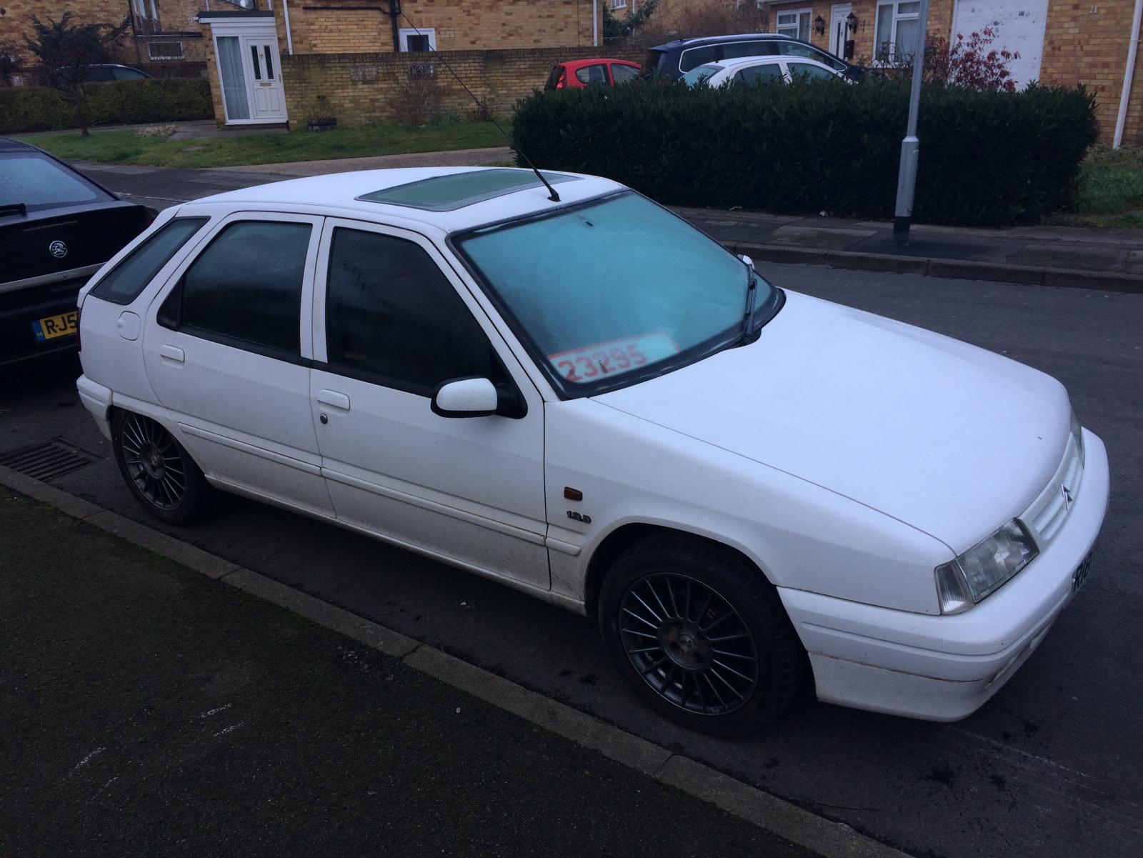

Well....fitted two of the wheels on the drivers side only to have a problem as there is some scrubbing on the rear wheel - tyre size is 205/50/16
Will these work these wheels? Or am I just wasting my time...

Clearly too wide on the rear. You might want to try a 195-width tyre and see if you can get away with that.
If you're set on keeping this wheel style on, I think it would show better if they were the same colour as the body, i.e. white.

I think your right re width of tyre ill go out in a bit and see whats going on. Re changing the colour of the wheels.....steady on I’ve got enough of my other cars sapping money - this is just meant to be a cheap hack - these wheels I have had sitting in the garden for the past two years when I scrapped a Xsara Picasso a while back
?...Re changing the colour of the wheels.....steady on I’ve got enough of my other cars sapping money - this is just meant to be a cheap hack - these wheels I have had sitting in the garden for the past two years when I scrapped a Xsara Picasso a while back
Just get a rattle can and some masking tape. Nothing fancy.
One of the previous owners of my Citroën was clearly not one to be messing with polished or brushed alloys so he sprayed them gloss off-white - I kid you not - and that's exactly how they are today. It gives a 1950s look to a 1980s car.
I see what your saying - I’ll have a think about this - at current its trying to get the bloody wheels to fit without scrubbing! As I say, i fitted these in the pitch darkness last night and havent been out to investigate yet but my guess is they are scrubbing the outside of the tyre on the arch - so I could pull the arch out or do we reckon they are rubbing on the inside?
....my guess is they are scrubbing the outside of the tyre on the arch - so I could pull the arch out or do we reckon they are rubbing on the inside?
I wouldn't mess about with bodywork as that's already in good condition and you don't want to be making future problems by distorting it. Reduce the tyre width. Have you got a 195-tyre handy?

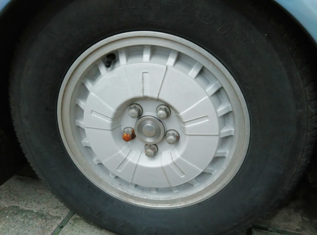

You should be able to see my gloss white wheel here!
I'll get a clearer photo when the weather's a bit brighter.....

Here, try this:
Note the tasteful areas of overspray onto the rims....
