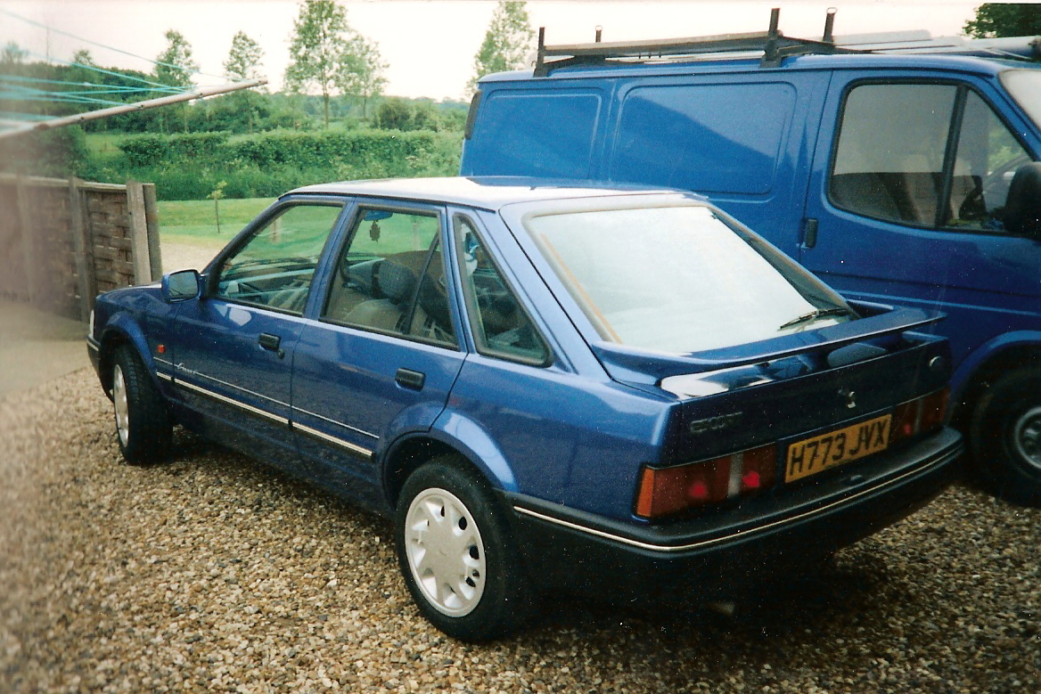

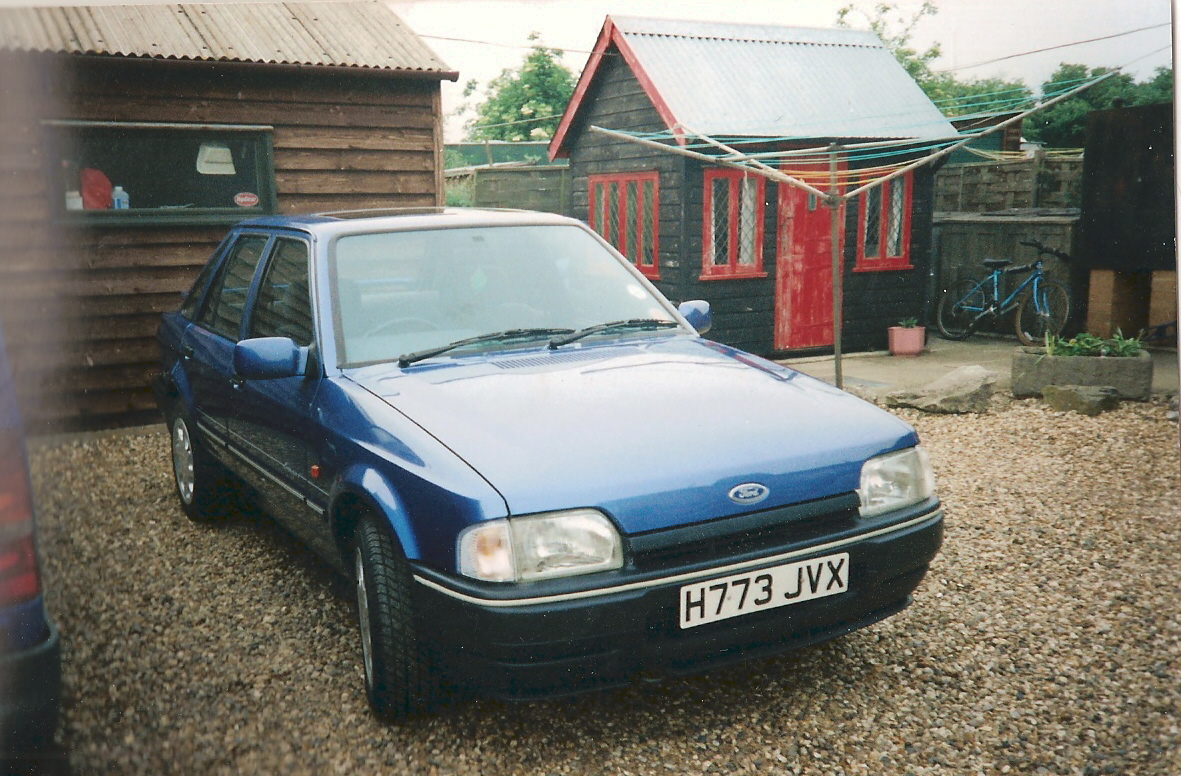

Pipped at the post today for an H reg Escort Eclipse, dirty cheap but with no mot. I guess it just wasn't to be.
Winners own H reg Eclipses.  8)
This was 1998 mind and i did pay £2000 for it.
