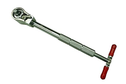

bezzabsa Posted August 10, 2018 Posted August 10, 2018 On 10/08/2018 at 09:28, Joloke said: Mini Update Swearing Alert! Fuck Fuck Fuckety Fuckety Fuck Fuck Fuck!!!!!!! Thats feels better.............................................. Grrrrrrrrrrrrrrrrrrrrrrrrrrrrrrrrrr!!!!! So yesterday removeage of the windscreen vents happened Finally we can see the passenger side linkage bracket You can see two of the bolts the third is hidden under the linkage arm,once thats disconnected from the motor you can get access to that one Just not the right hand bolt.......................... Here's another couple of views,note the bracket just to the right No wait its not over yet! So you see that bracket is in two parts................ The bolt sticking out of the rear is in the way of getting a socket in there So you can remove the bolted bit but not until you remove or at least move the bar crossing the bolt (center dash support) So you remove the Bracket and Yah So thats it! Err No!!!! You see the other part of the bracket still fouls your access to the right hand linkage bolt by a few mm You need to angle the ratchet and socket because of the rake of the scuttle and you cant do it because of that sodding bracket! You cant unbolt it there as its rivited to the heater box! So just to get out one bolt the sodding heater box has to be removed !!!!!!!!!!!!!!!!!!!!!!!!!!!!!!! Aresoles,Drink,Feck!!!!!!!!!!!!!!!!!!!!!!!!!!!!!!! put the socket in from right hand side....?????? or am I missing summat??
PhilA Posted August 10, 2018 Posted August 10, 2018 Or a shite tool Church tombola style. Phil Joloke 1
richardthestag Posted August 10, 2018 Posted August 10, 2018 or a brick chisel and big hammer seriously though looks like one of those bendy ratchet spanners might fit where the socket is heading. or a normal spanner and lots of swearing and time Joloke 1
PhilA Posted August 10, 2018 Posted August 10, 2018 On 10/08/2018 at 17:04, Joloke said: What on Earth ?It's a Sidewinder. You can rotate the ratchet head by twisting the red handle. Imparts as much torque on the bolt/nut as grasping it through a wet bath sponge with your fingers. Phil Joloke 1

Guest Hooli Posted August 27, 2018 Posted August 27, 2018 On 10/08/2018 at 16:18, PhilA said: Or a shite tool Church tombola style. Phil That looks amazingly useless! From your description it does nothing you can't do with your fingers. PhilA 1
