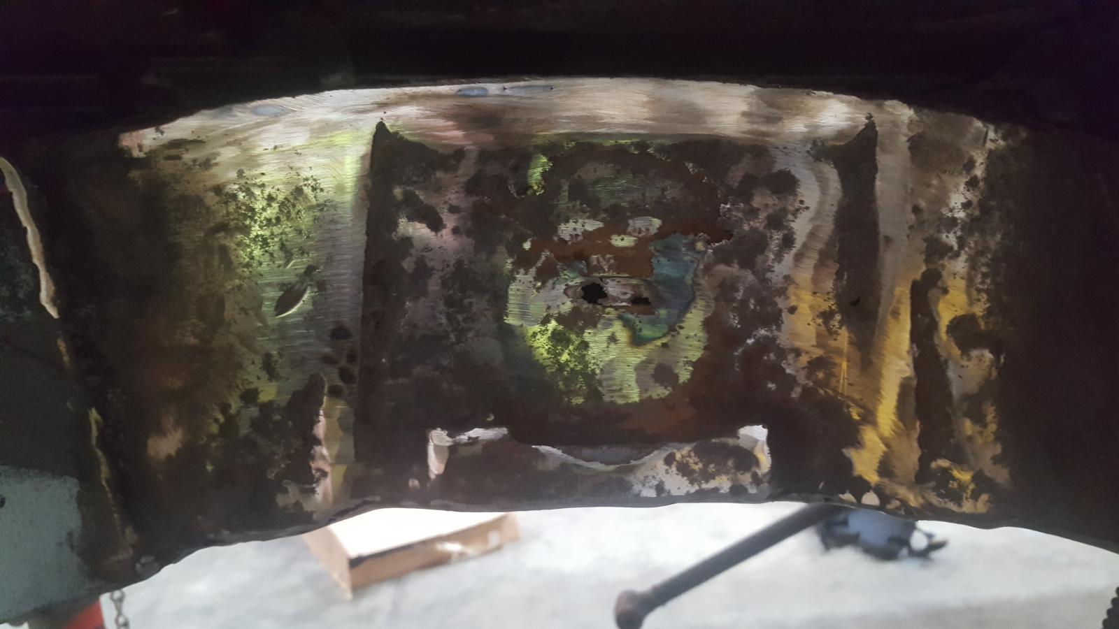

A bit of an update on how things have been progressing with my 90.
Whilst I was languishing with the in-laws weekend before last my buddy removed the roof ready for prep for re-spraying.
The bulkhead had a bit more welding done and the off-side engine mount had it's somewhat dubious welding strengthened.
I was able to get back at it on Monday after a romantic weekend away with the missus in Beccles.
The rear axle was removed. We discovered that as a drum brake axle we can't convert it to disc brakes so I hope to get a Discovery axle in the new year. I have spoken to a man who has one he is willing to let me have.
The rear spring upper mounts had more patches than a boy scouts jumper so I cut them off and I now have 2 brand new replacements. Whilst they are off I am going to tidy up some of the previous welding which although solid is not too attractive.
We are now going through the laborious task of rubbing down the paintwork. Today I have done the side panels, rear door and one driver's door which is a solid replacement from a later model.
It's a time consuming process which isn't helped by the fact that I have to look after the dog this week and he hasn't taken to the racket of the angle grinder or any loud noises.

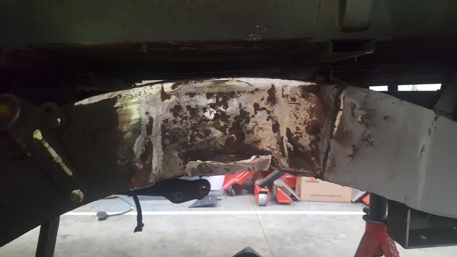

Progress on the 90 has been fairly glacial lately but I thought I would bore you all with an update. I have attacked what was left of the rusty spring brackets with an angle grinder and found a couple of spots on the chassis that require a tickle. My mate who is helping me with this has drafted his brother in to do the welding as he is more proficient than we are. Only problem is that he is dragging his heels to get it done. He has promised to do it Monday, so fingers crossed.
The guy who promised me an axle after Christmas has gone off grid and won't respond to messages or phone calls so I guess he's a bit of an arse. I scoured a popular internet auction site and bought one for £180 with free delivery. I receive a call on the following Monday informing me that that they have 'lost' the axle during a move of premises and refunded my money. Mk1 Discovery rear axles aren't in abundance so after a bit more searching I find one nearby for 20 pence less than a ton. I took a trip to Dereham on Thursday and collected it. It's not too bad, I have cleaned it a bit with a wire brush and stripped it down. The diff is sound so I will replace wheel bearings, seals and brake discs and give it a lick of paint.
My mate has pulled in a favour with a painter and we are getting ready to get some panels over to him. He finished the roof this week and has done a splendid job. The only concern we have is that Dr Who might want to steal it. I am going to order the 2K Coniston Green paint this week which will be about £145 delivered.
I have managed to source a reconditioned steering box pretty cheap as we are going to convert it to power steering. I will update again soon and hopefully show you some green panels.
