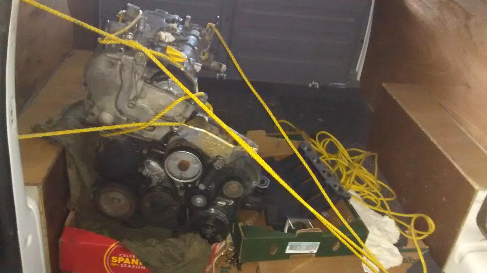

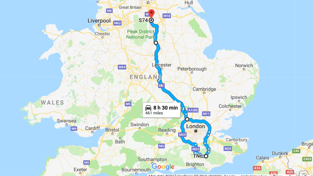

Had a day out doing some shopping for the Clio, only 470 miles and 11 hours of driving in one session ffs. Thoroughly amazing considering travelling 40 miles to look at a car is right on the cusp of my cba scale.
I have to admit that doing that mileage in one day nearly broke me and a big thanks to the bell end that nearly run me off the road on the M23, respect for anyone who does this day in, day out for a living. Never guess what i have in the back of my van now!!
Ooh, is it an engine? Running by the weekend?
I'll not ask what weekend...
If i had that twat in the back of my van i would have disposed of him in the Dartford tunnel. Anyway with my van been Lez compliant i was hoping this was in the back. Coronation Street fans will get the picture.
But back to reality, this is what was in the back. Hope it was worth the journey and not lemon like Wacks engine. Can't see it running this weekend Dome, maybe a weekend in 2019 though.

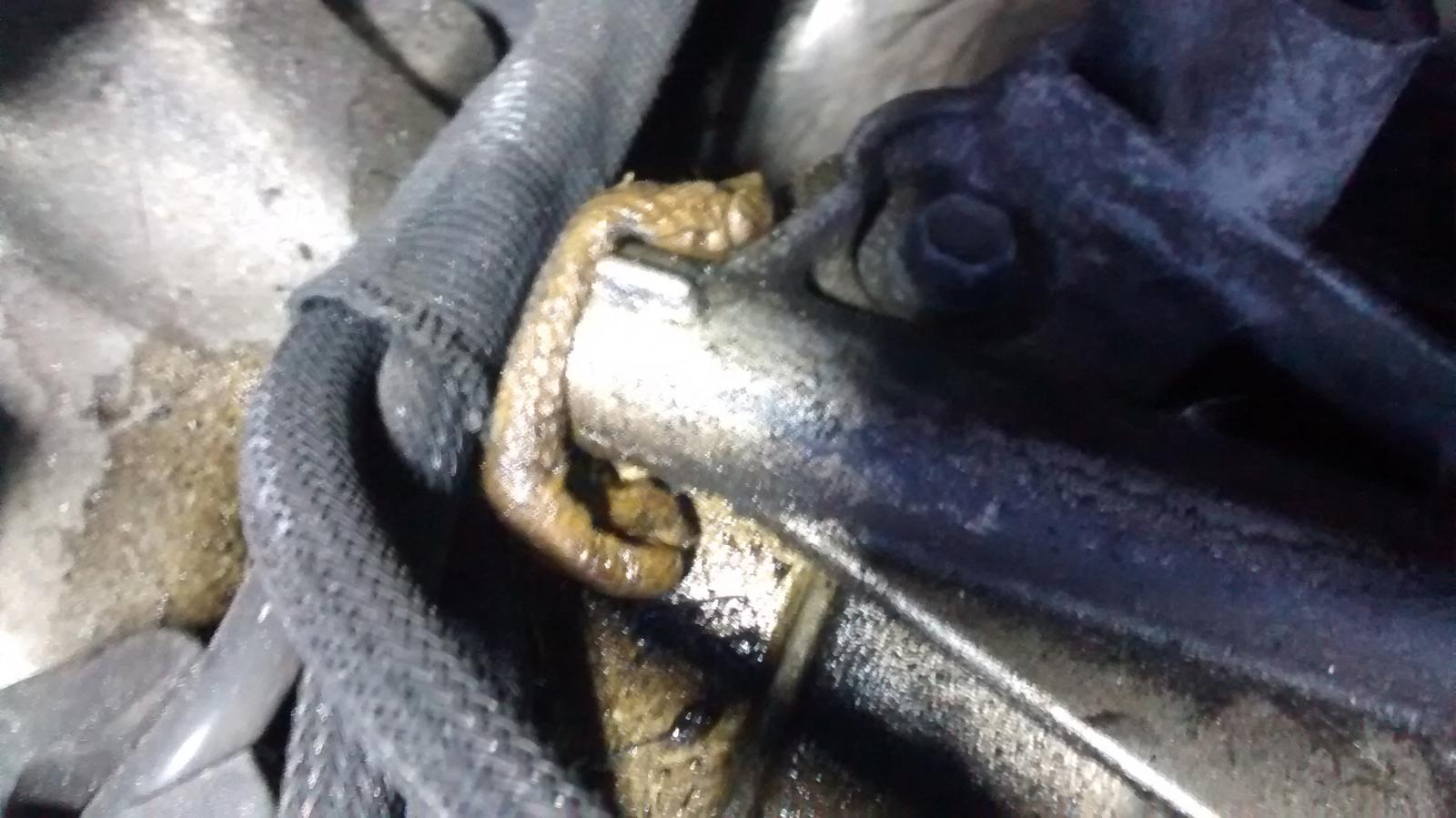

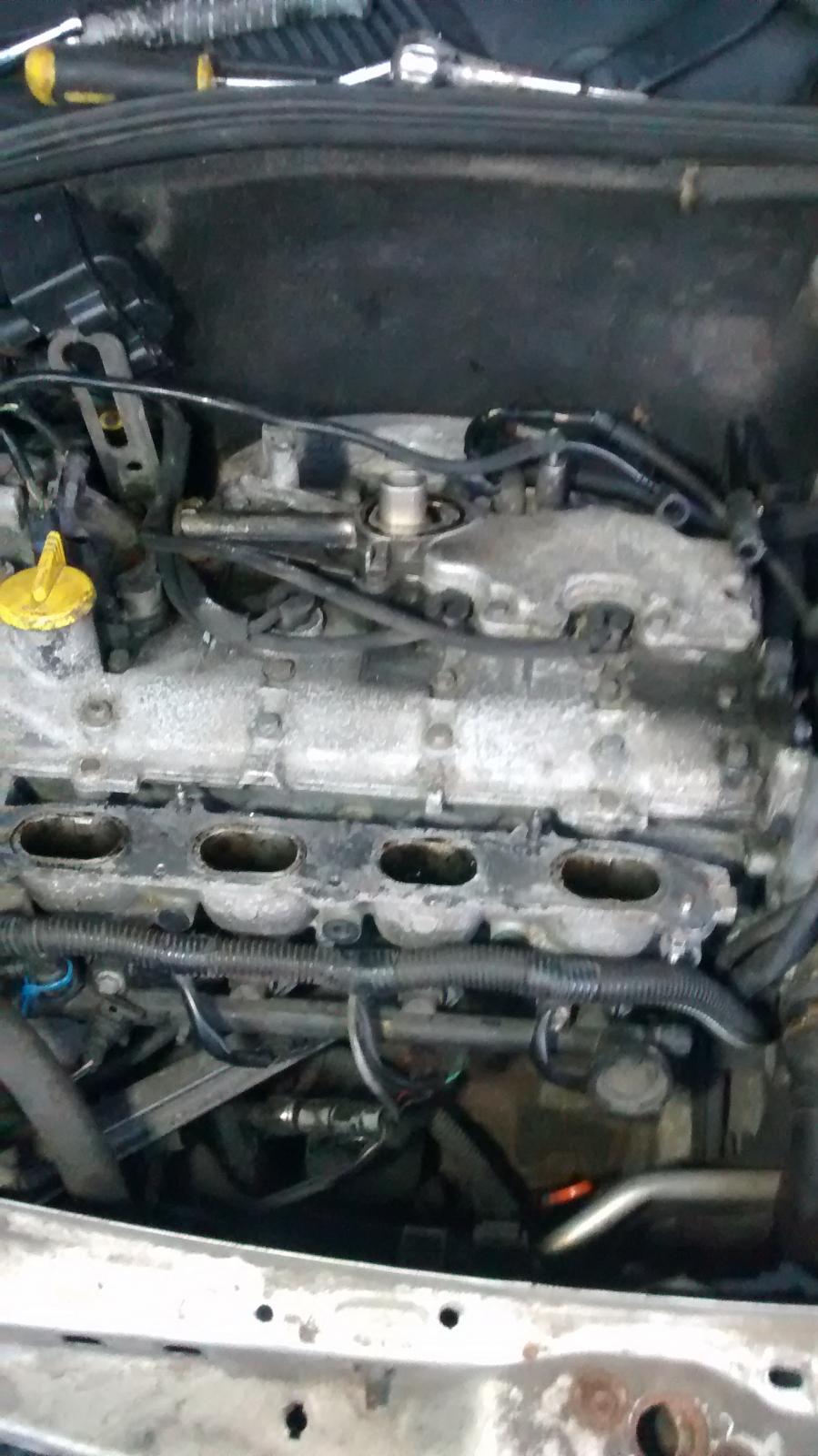

Done a little bit more on the Clio, but not had much time to spend on it due to doing christmas stuff, pub trips etc and due to the fact i have no electric in my garage yet, so i can only work when its light with the door open, and its blood freezing, so only working on it for an hour at a time, so progress is slow.
Seems to come apart easy enough, anyway start taking plenum off and inlet off.
If your not into your Clio's everything looks fine and dandy, but this is a 182 and that's not a 182 engine, but a 172 engine (slightly different but fundamentally same), all the breather system on top is different and alledgedly not interchangeable. So this bad boy will be on its third engine when i fit my 'new' one. Anyway the 172 breathes in a couple of places so the pipe on top can be blanked off or directed to a catch can. But the mechanic who changed the motor obviously thought chewing gum, putty or whatever the hell it was stuck to the breather would be adequate. Quality bodging.
Not had the cambelt cover off to see what caused the initial failure, as its part of the engine mount, and run out of light.
You're doing well, it took me 3 hours to get my front bumper off.
The first time anyway.
