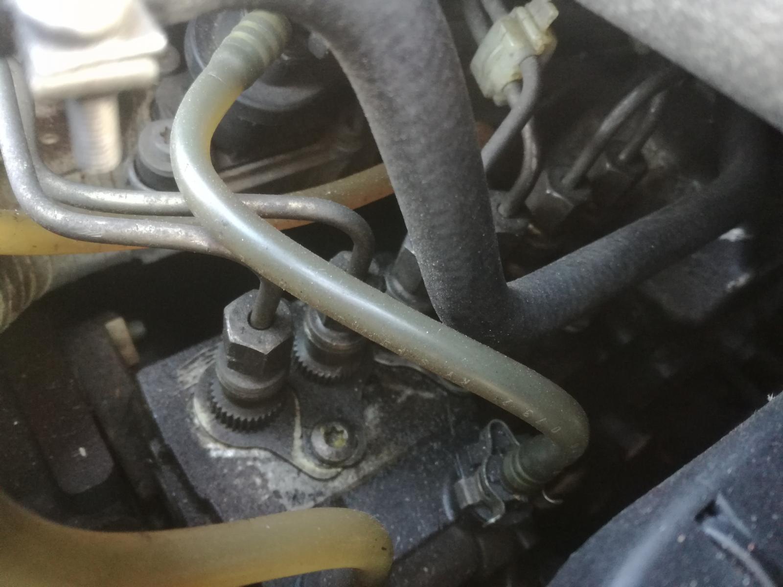

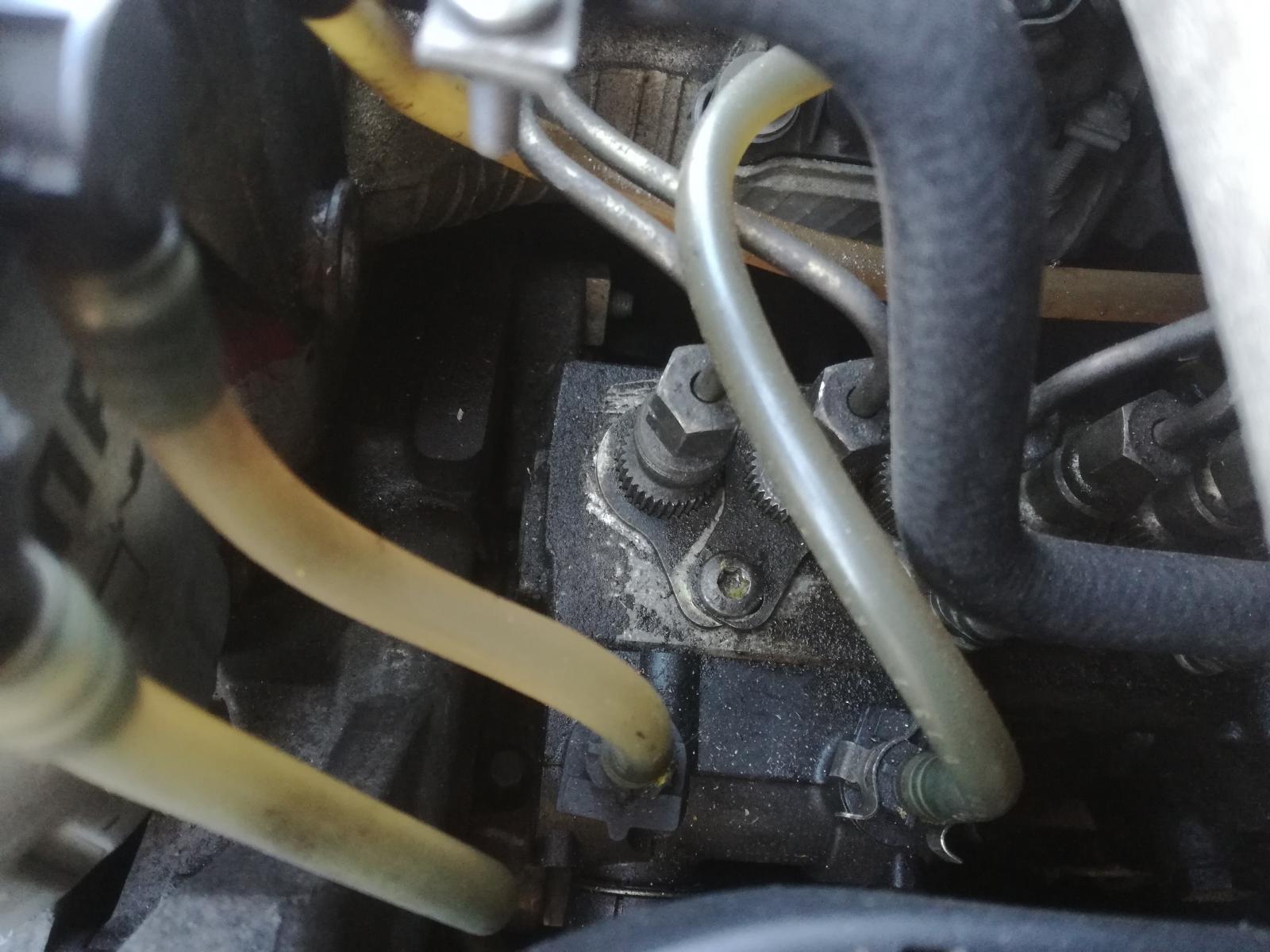

J-T Posted February 3, 2018 Author Posted February 3, 2018 Ok, managed to get a couple of hours on this today. After reading advice on t'internet and on here, the recommended thing seems to be replacing the 6 clear plastic fuel lines and associated O rings running from the pump & filter, if this doesn't cure it, remove the shut off valve and replace its O ring and if it's still sucking in air, replace the delivery valve seals & washers on the pump. It's recommended that you use viton seals rather than the standard rubber ones. I ordered up the clear fuel lines, manifold gaskets and 2 rubber lines from Merc which relieved me of £100 and ordered some viton 8mmx2mm O rings. However when I compared them to the seals on the clear lines from Merc, 2mm thickness seemed too thin so I just left the standard ones on for now. I didn't take many pics as it was all a bit messy with diesel but the pic below shows why the inlet needs to come off - the filter is bottom right and the pipes go underneath. The manifold came off fine and as expected is fairly gummed up. Any suggestions on how to clean that out (it's plastic)? This revealed the rats nest of fuel lines (just realsied the inlet is still on there but you get the idea) The clear plastic lines are a push fit into their recess and most were a right bastard to get out as they were mega brittle by now. To remove them, you push in the white plastic hoop (shown below) and pull, however most needed some severe leverage to get them out which resulted in them crumbling. I was really struggling to get a couple of them to push into location, I must have spent half an hour at them until I put the old line next to the new and realised that the lower part of the fitting had snapped off inside the recess on the pump. Thankfully I managed to get it out with a small screwdriver. So, I managed to swap all 6 clear lines for new, both black rubber lines (feed & return), replace the main fuel filter and the small prefilter which you can see in the 1st pic with a fuel line coming out of the top just next to the main filter. However, if you look carefully in that pic, you can see that the retaining bolt also holds a metal packing peice which also applies pressure to the clear fuel line to keep it in place. I managed to drop this little piece and it has vanished. I even dropped the undertray to no avail, so it looks like I'll either have to get creative with a large washer and a dremel or see if I can order one from Mercedes. Arses!! With all that done, I decided to give it a go with the manifold off and see if it was still drawing in air. I pre-filled both the fuel filters to try and make it a bit easier on the starter and I had the battery on charge over night. Aaaand it was exactly the same as before. I tried on and off for about 5 mins as obviously it would take a while to prime it all but it just keeps dragging air through. So with that, I deciced to remove the shut off valve to see about swapping this O ring. It's held on by 3 torx bolts. The first one I came to undid fine, then I somehow managed to slip and mangle the fucking bolt AFTER it had cracked off. That's some going even for me. I decided to stop then as I was cold, wet and pissed off. So, I need to have a look at this Shut off valve O ring (if I can get this bolt off) and possibly the delivery valve seals too. However, what's confusing me slightly is that it has a full tank of fuel in it and it's sat on level ground. From what I've read, they only seem to give trouble when they're low on fuel or pointing downhill which mine is neither so could it be the pump that's at fault?

Lacquer Peel Posted February 4, 2018 Posted February 4, 2018 Ok, managed to get a couple of hours on this today. After reading advice on t'internet and on here, the recommended thing seems to be replacing the 6 clear plastic fuel lines and associated O rings running from the pump & filter, if this doesn't cure it, remove the shut off valve and replace its O ring and if it's still sucking in air, replace the delivery valve seals & washers on the pump. It's recommended that you use viton seals rather than the standard rubber ones. I ordered up the clear fuel lines, manifold gaskets and 2 rubber lines from Merc which relieved me of £100 and ordered some viton 8mmx2mm O rings. However when I compared them to the seals on the clear lines from Merc, 2mm thickness seemed too thin so I just left the standard ones on for now. I didn't take many pics as it was all a bit messy with diesel but the pic below shows why the inlet needs to come off - the filter is bottom right and the pipes go underneath. The manifold came off fine and as expected is fairly gummed up. Any suggestions on how to clean that out (it's plastic)? This revealed the rats nest of fuel lines (just realsied the inlet is still on there but you get the idea) The clear plastic lines are a push fit into their recess and most were a right bastard to get out as they were mega brittle by now. To remove them, you push in the white plastic hoop (shown below) and pull, however most needed some severe leverage to get them out which resulted in them crumbling. I was really struggling to get a couple of them to push into location, I must have spent half an hour at them until I put the old line next to the new and realised that the lower part of the fitting had snapped off inside the recess on the pump. Thankfully I managed to get it out with a small screwdriver. So, I managed to swap all 6 clear lines for new, both black rubber lines (feed & return), replace the main fuel filter and the small prefilter which you can see in the 1st pic with a fuel line coming out of the top just next to the main filter. However, if you look carefully in that pic, you can see that the retaining bolt also holds a metal packing peice which also applies pressure to the clear fuel line to keep it in place. I managed to drop this little piece and it has vanished. I even dropped the undertray to no avail, so it looks like I'll either have to get creative with a large washer and a dremel or see if I can order one from Mercedes. Arses!! With all that done, I decided to give it a go with the manifold off and see if it was still drawing in air. I pre-filled both the fuel filters to try and make it a bit easier on the starter and I had the battery on charge over night. Aaaand it was exactly the same as before. I tried on and off for about 5 mins as obviously it would take a while to prime it all but it just keeps dragging air through. So with that, I deciced to remove the shut off valve to see about swapping this O ring. It's held on by 3 torx bolts. The first one I came to undid fine, then I somehow managed to slip and mangle the fucking bolt AFTER it had cracked off. That's some going even for me. I decided to stop then as I was cold, wet and pissed off. So, I need to have a look at this Shut off valve O ring (if I can get this bolt off) and possibly the delivery valve seals too. However, what's confusing me slightly is that it has a full tank of fuel in it and it's sat on level ground. From what I've read, they only seem to give trouble when they're low on fuel or pointing downhill which mine is neither so could it be the pump that's at fault?Don't think it's the fuel pump, the fuel delivery pipes, O-rings and push fit couplings are such a mess on these cars, if possible I'd put it all in the bin simplify it with regular hoses and clips.

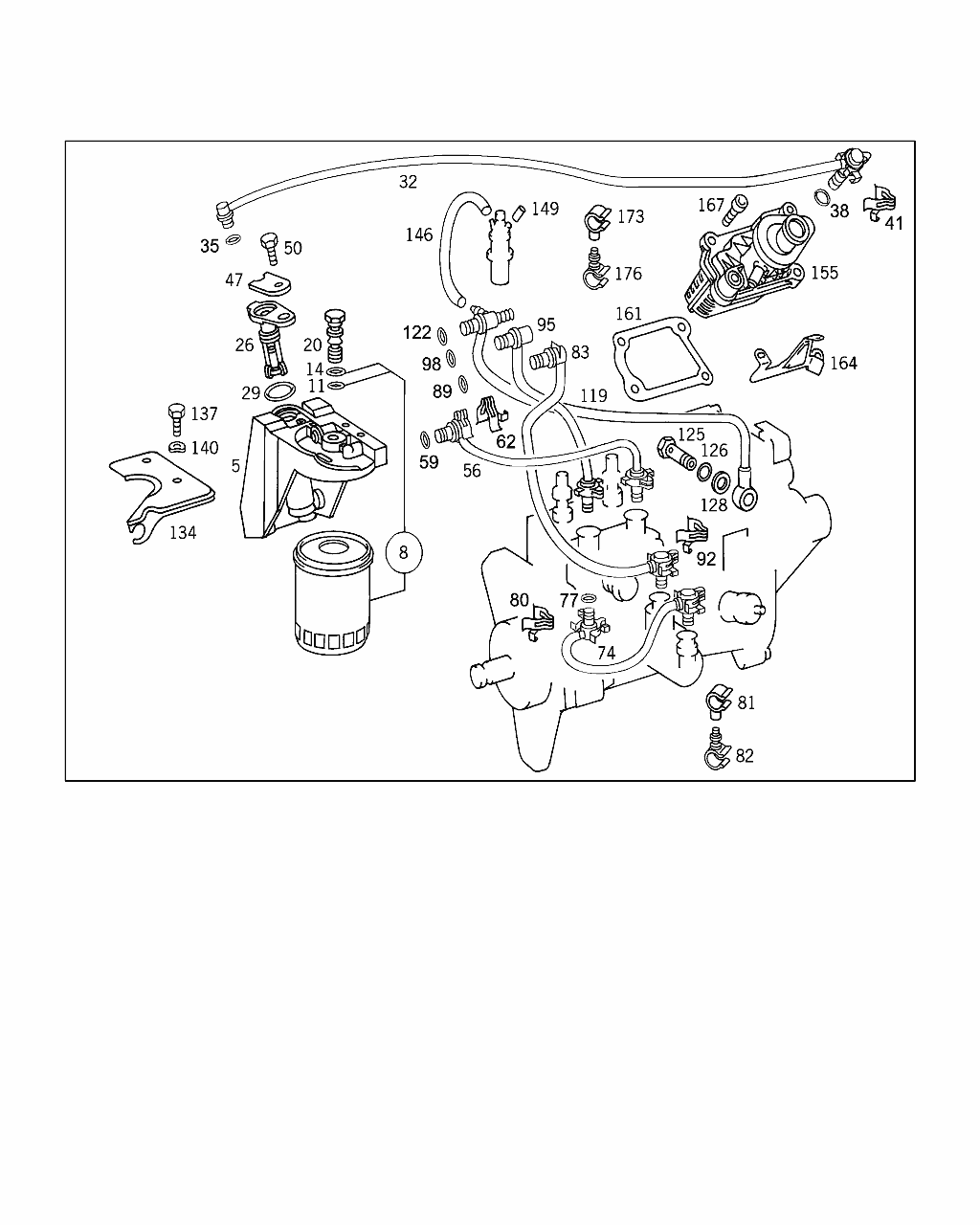

J-T Posted February 18, 2018 Author Posted February 18, 2018 Got another hour or so on at this today. It's still not bloody sorted but it's better. I still haven't done the delivery valve seals on the pump because, like a moron, I've inadvertantly ordered the seal kit from America, so it's still not here! Here's a quick recap of what's been replaced: All 6 clear plastic fuel lines & their O ringsBoth black rubber feed & return lines & their hose clipsNew fuel filterNew pre-filter Today, I managed to remove the stop solenoid on the side of the pump, which also has an O ring. The old one looked fine to me, but I had ordered a new one (12 x 2mm). When I put them side by side, 2mm was too thin but I tried it anyway. When I did this, it started instantly but had fuel pissing out of the stop solenoid. I nipped to Halfords and managed to find a thicker 12mm O ring but this was a bit too thick - I got it fitted but only by drawing it into position via the fixing bolts so it's squished to feck (the correct O ring is included in this kit I've ordered so I'll swap it again when it finally arrives). With all of this done, it is better in that I can actually get it started and running but it's still not right. It tries to start off what's in the filter, then that runs out and it struggles, but keep going with it and it keeps trying and will eventually drag enough fuel through. Once running it's fine. I took some vids to demonstrate (sorry, I'm not clever enough to embed them) https://www.flickr.com/photos/155679804@N05/39442218475/in/album-72157688008271452/ The one above is when I'd just got it running. As you can see, when it's turned off it's letting air back in and the fuel runs back from certain hoses, back into the stop solenoid area. https://www.flickr.com/photos/155679804@N05/39442360145/in/album-72157688008271452/ That one shows it trying to start. You can hear it nearly get going from what's in the filter, then die and have to clear the air out again. https://www.flickr.com/photos/155679804@N05/40339906811/in/album-72157688008271452/ That one shows it running again later, but with a load of air rushing around (which it wasn't doing in the 1st vid) The only things left to do are: Swap the O ring again on the stop solenoid for the correct one out of the kit I've orderedDo all the delivery valve seals on the pump (high liklihood of me distubing things and breaking it)The new pre-filter did not come with a new O ring, so could change that (but it looked fine)Think there is an O ring on the bolt for the main filter, so could change that (looked fine again) I feel like I'm getting somewhere as before I couldn't get it going at all. I'll just have to keep going I guess. Unless there are other suggestions after seeing the vids (I will try and embed them if someone can tell me how).

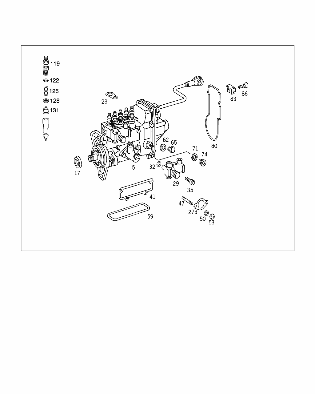

J-T Posted February 22, 2018 Author Posted February 22, 2018 Right, installment 135 of the most drawn out fucking fuel system overhaul evaaaahhhh (even I'm bored now!) Tuesday-ish, the seal kit came and I got on with the delivery valve seals. Each delvery valve on top of the pump has a rubber O ring and a copper washer to replace and you have to be mega careful not to disturb anything below the copper washer or you're up shit creek. There's a compression spring under each delivery valve so you have to again be mega careful when lifting the valve up that you don't knock it and lose it. Well guess what fucking happened!!!! I was indeed mega careful and on the 3rd valve I lifted it straight up so as not to knock the spring, I lifted it clear of the srping, at which point the spring fell over of its own accord into fucking oblivion. Oh, and I'm doing this on a gravel drive. Have a pic of the spring (you can also see the knackered O ring on the valve) I searched for over an hour for the little TWAT and it is gone, it no longer exists. I dropped the undertray, searched all underneath the car & the engine bay but it cannot be found. So I got online and put a search in for bosch delivery valve spring. I managed to find a place called Darwen Diesels who listed them, so I phoned them up and ordered one, thinking they would propbably be the same in each version of pump. That came and it was clearly wrong, it had 9 coils when it should have 12. I got back on their site and found they list two, so I ordered the other one (of which he only had 1 left) which has come today, but it's slightly different, it's wound tighter (see new one below) Before that one came, I contacted Merc diesel specialist to see if he could supply any and he could, but he recommends changing all 5 at a cost of £35+VAT & postage. I know that's not mega money but these I bought were literally pence which makes these seem pretty expensive to me. So what would you do? I'm getting pissed off with it now, it's in the way and I really need it to move next week as we're having loads of work done on the house (this week I've been ripping the kitchen out and all plaster downstairs so I'm not over flowing with free time either). Throw this spring in and hope or shell out 40 odd quid and wait again (or does anyone know any other suppliers, it's a bosch pump?)

J-T Posted February 22, 2018 Author Posted February 22, 2018 Some strong googling has eventually thrown up an MB part number for the spring (didn't even think of this as I just presumed they would only want to sell me a whole injection pump) so I'll ring the stealers tomorrow. Not gonna risk the wrong one. I've also found a Bosch part number with a Bosch centre listing them for £2.49 each (albeit special order only) so my man quoting me £35+VAT can do one.
Guest Posted February 22, 2018 Posted February 22, 2018 Spring.A0000743793 Seal. A0179974148 Washer. A0049974540 A0000743793 Springinjection PumpZoom imageDetailsCustomer-tippart group R20 weight 0.00 kglength 3, width 1, height 1cmyour price 3,33 EURincl. VAT 19 % excl. Shipping costsShipping time: ca. 1-3 Working Days
