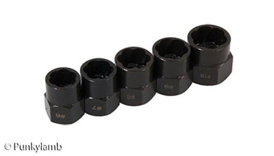

Cheers, I'll have a look at that. Tried hammering a larger socket over it without success, even used a supposed 'special socket' for this but again, no joy.
The "special sockets" with the reverse screw thread in them are fecking shite.  You want one of this type:
Reverse thread removers and an impact. Takes 10-20 secs, then 10-15 mins retrieving the fucker out of the tool.
Wuuvum and fraybentosgave me a great steer. That little kit had the nuts off with no bother.
