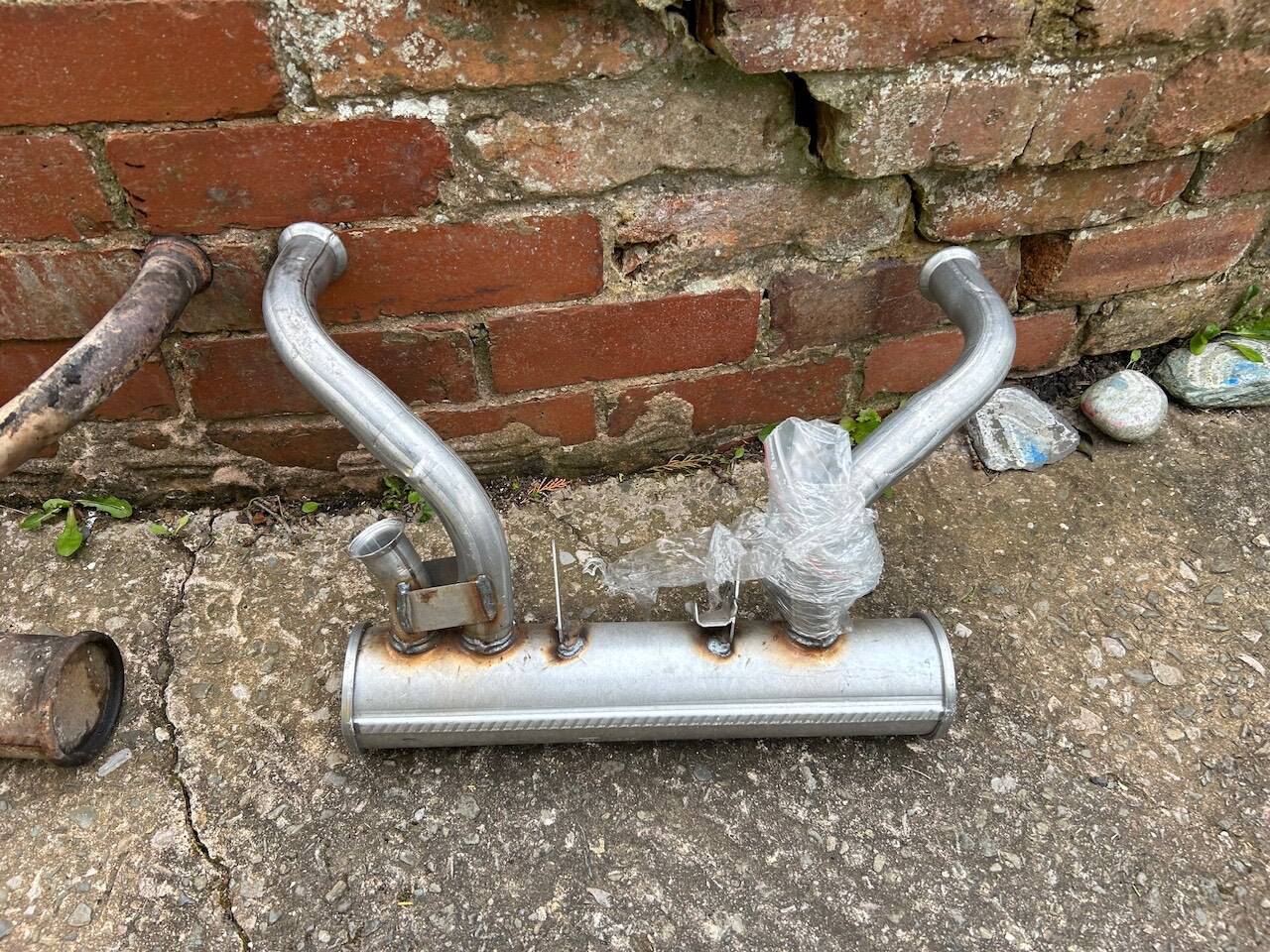

Bank holiday 2CV tinkering:
The raspy sound was coming from the cross box silencer. The hole was nicely masked from sight by the fact that it’s right under the gearbox…
Do love the ease of access on these. Old crossbox removed and yeah… bit of an issue….
IMG_4882.jpeg.162286ab7621c3968925c6b21cc82fd1.jpegIMG_4883.jpeg.a0cfb614f5673331cdf38599be10eb02.jpeg
A sizeable hole, which was where one of the support hooks was supposed to be.
Incredibly, in the big box of spares which came with the two project 2CVs was a brand new one!
Aside from being a bit jiggly to get under the chassis it went on fine, and even better the noisiness and popping was cured. Best of all… it was a free fix!
