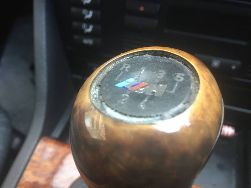

That gearknob is OEM MSport, it's missing the plastic thing obviously.
