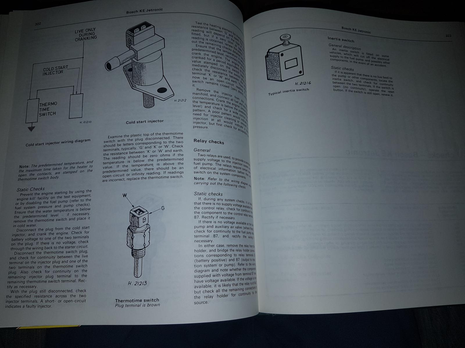

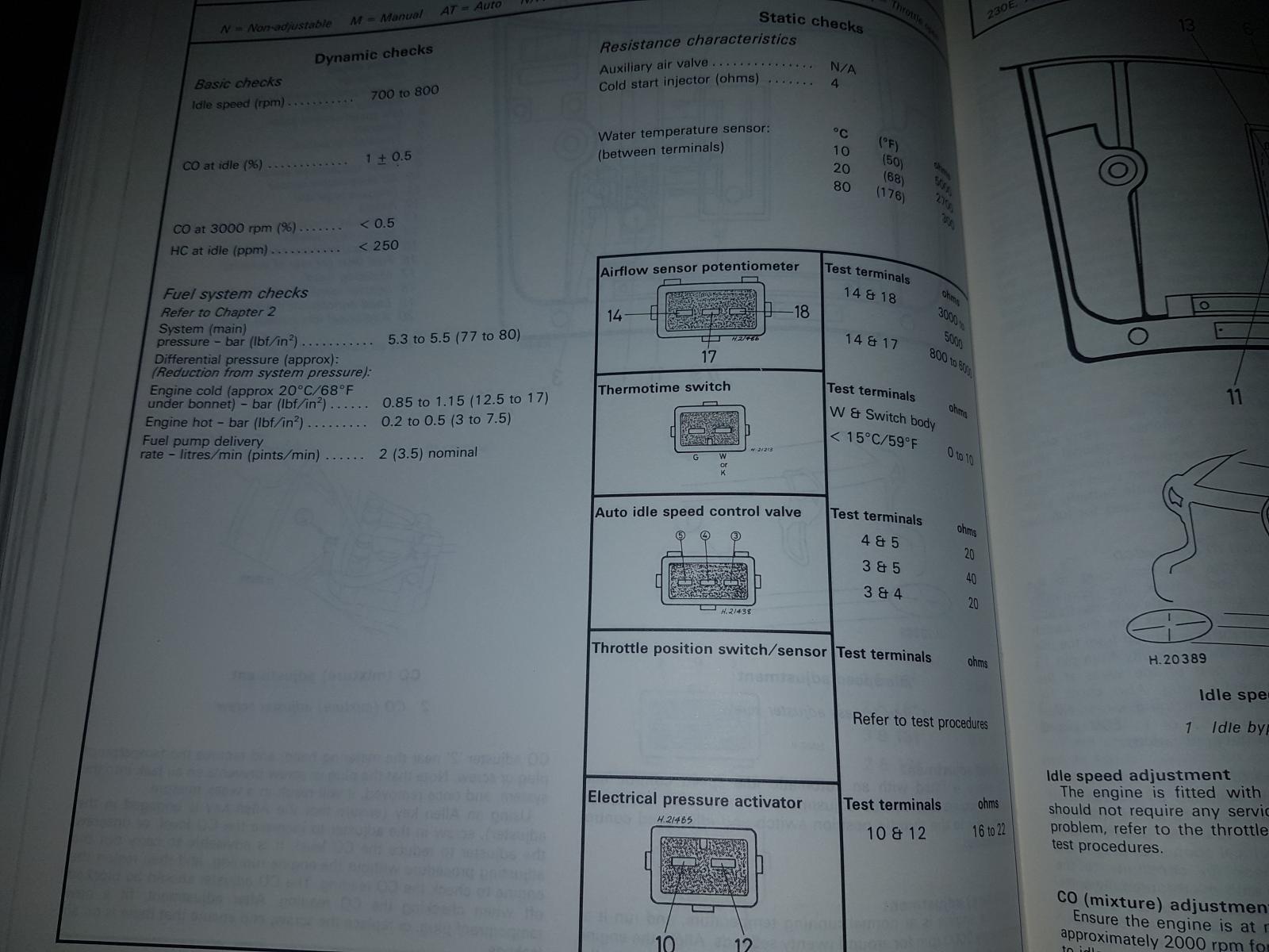

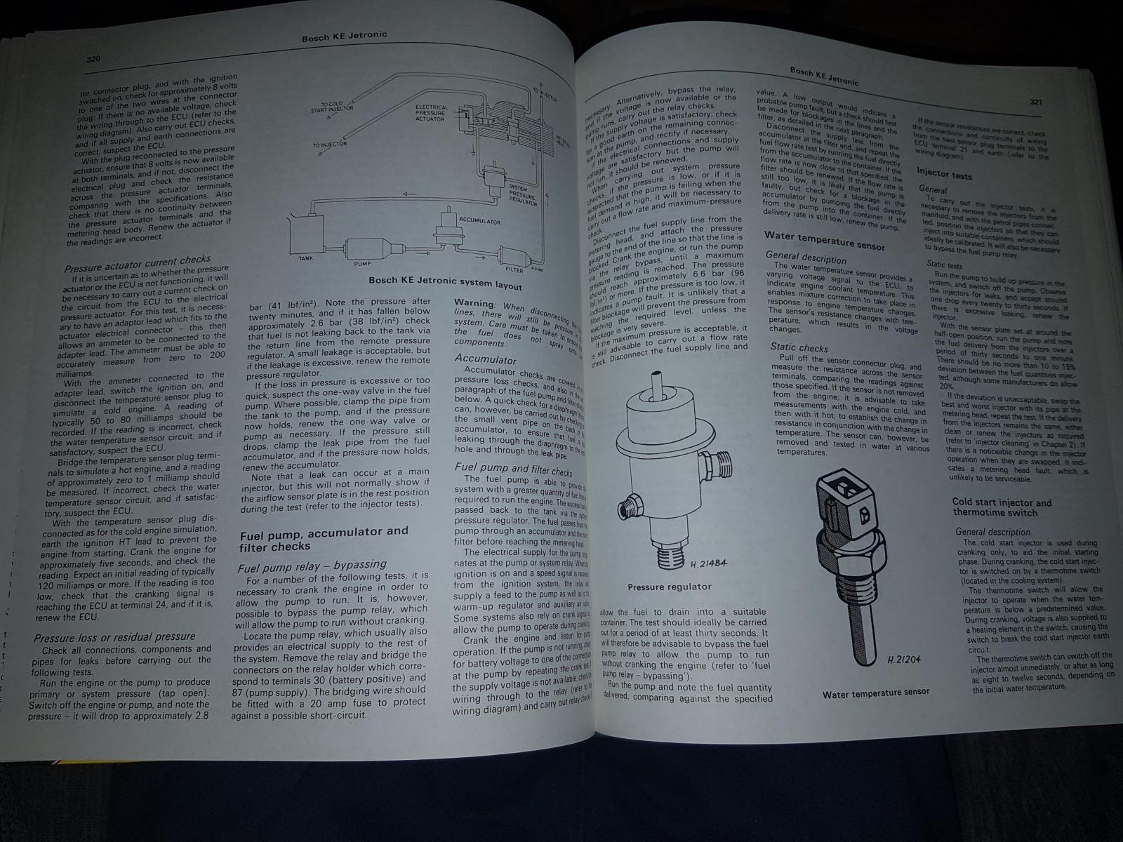

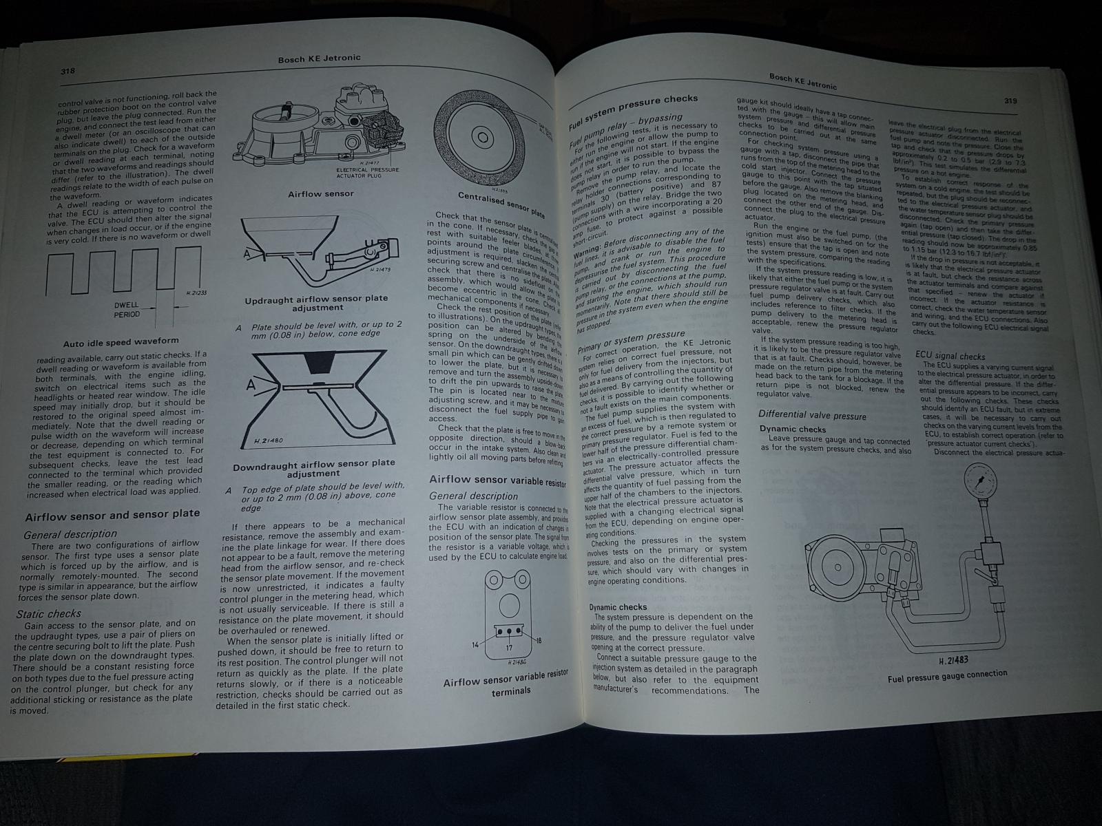

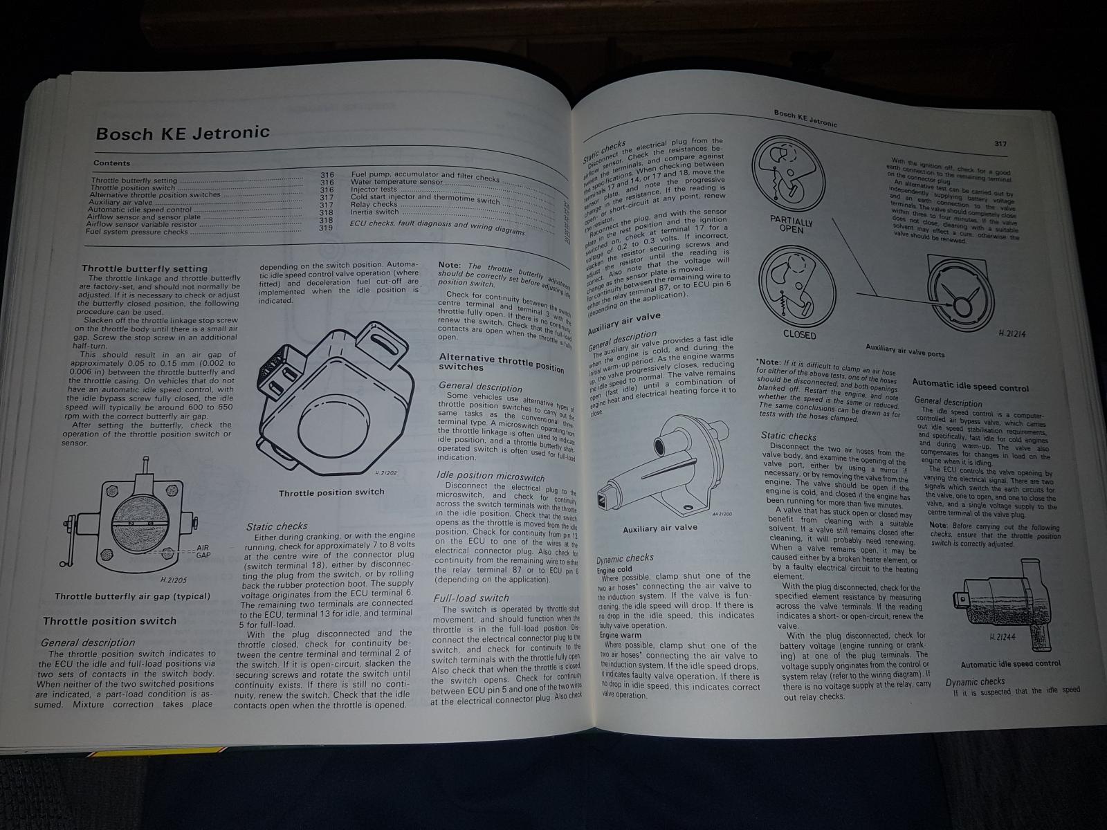

Because im nice ive just dug out a useful book I have for a bit of information on the ke jetronic which may help you with your checks on the vehicles
From here
Hope it helps if anything is unreadable etc id be happy to take a better picture for you
