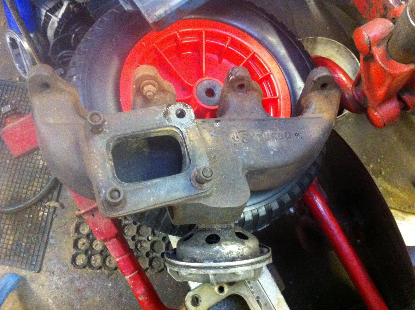

DodgeRover Posted February 15, 2018 Author Posted February 15, 2018 Work has been quiet so the van has largely spent most of it's time in the drive.I managed to get a little bit done in my quest to go faster (or not quite so slowly up hills) got the broken stud in the Janspeed manifold drilled and ran a tap down to clean the threads.Just need a 3/8x24 stud and some locking nuts or possibly normal nuts with spring washers. Any reason not to use stainless? As posted in the news thread the spare engine I got to rebuild looks like new inside so rebuild costs for that are only a gasket set so far!Armed with only a air powered due grinder and the David Vizard book on tuning I'm going to set about porting one of the spare cylinder heads I have.Anybody with any tips for keeping torque I am all ears. Coprolalia, Lacquer Peel and danthecapriman 3

Dave_Q Posted August 10, 2018 Posted August 10, 2018 Replying to quite an old post here, but on stainless for your exhaust manifold I wouldn't. Stainless steel (the 304/316 type that most fasteners are made of) has a much higher co-efficient of thermal expansion than cast iron, you can get leaks at the joint as the clamping of the bolt/stud almost disappears by about 500C. Its a bit hot for normal HTS (8.8 grade etc) at work we use a grade called B16 which is a cromoly steel for hot joints like this. mat_the_cat and DodgeRover 2
