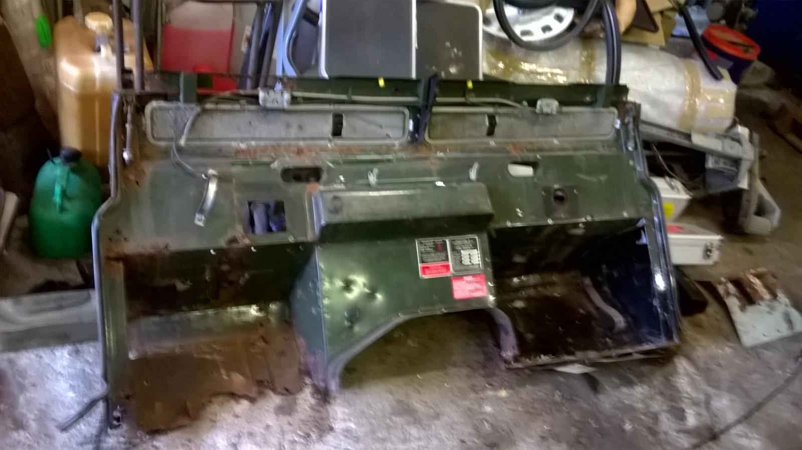

Boss bought  a new series 3 88" Land Rover new in 1974. Put it in the stables in 1986 due to rampant Chassis and Bulkhead rot. Now the caravanning season is beginning to quieten down, I've been tasked with the restoration. New chassis has been bought. Most of the original has been swept in the bin.

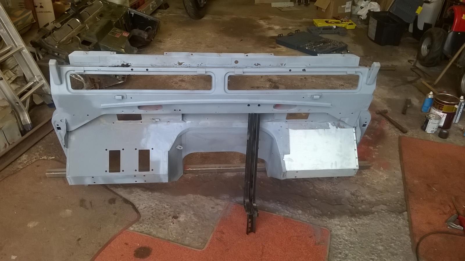

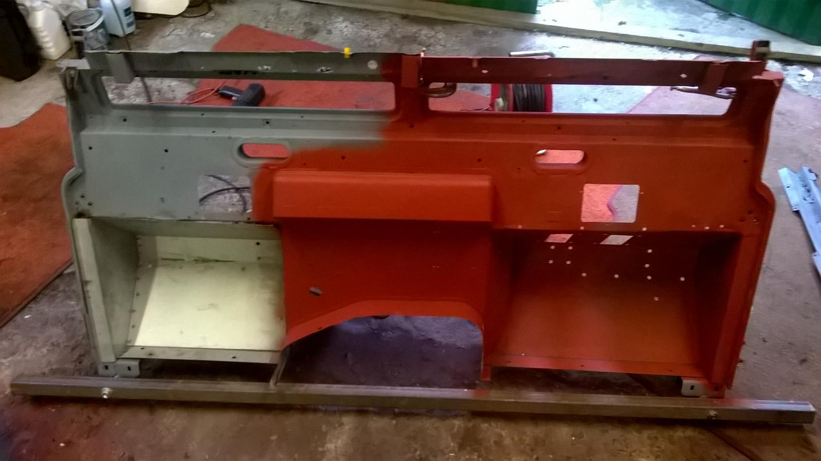

Bulkhead looking good. Tempted to have it galvanised when it's repaired? They seem to be able to do that now without warping the (thin) metal!
Nah- just a good coat of paint and some wax- I doubt it'll get used much when its finished. I've been "informed" I've got a Perkins S1 from 1950 to do next...

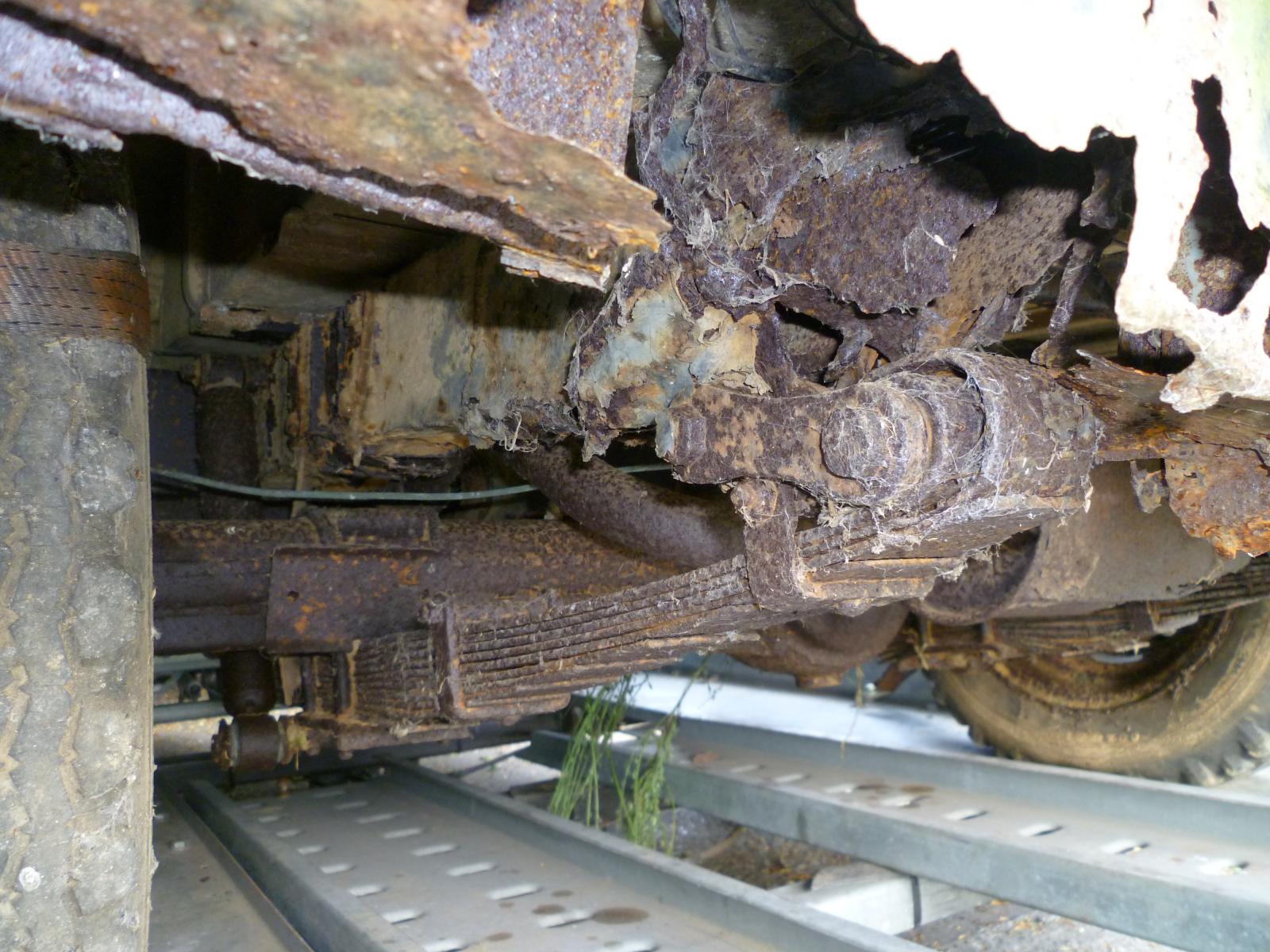

Call that rot!
This is more what a rotten Land Rover looks like...
(But they do get worse)

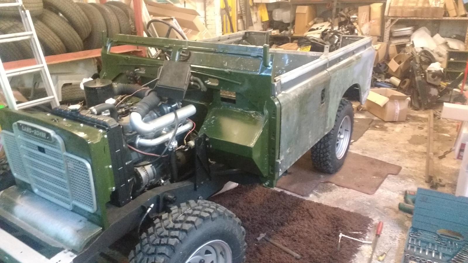

It Moves!! :)
Getting everything lined up was a real hassle- new chassis, bulkhead fabricated out of 2 with 2 new footwells, rear tub from another "88 and bits here and there. Took a few jacks, some big levers and a lot of swearing to get it all lined up.
Got it to nearly stop smoking and mechanically all good. Brake pipes and make a wiring loom next.
