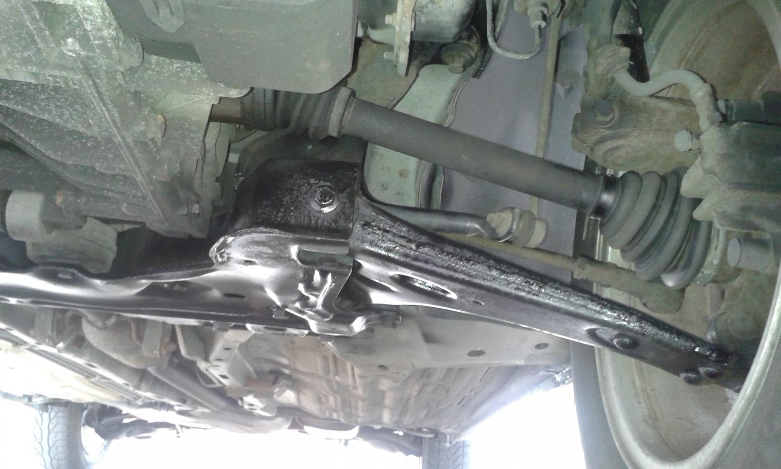

all the underside of my 03 Focus is steel , and its surprisingly clean for its age , a wipe down with a cloth and a coat of fresh paint onto and into every bit of subframe and box section , followed up with a spray tin of oil into box sections and subframe inners ...  which does actually makes you wonder about mixing metals on a modern car as only troublesome bits have been where ally fastenings have been used on the underside .
