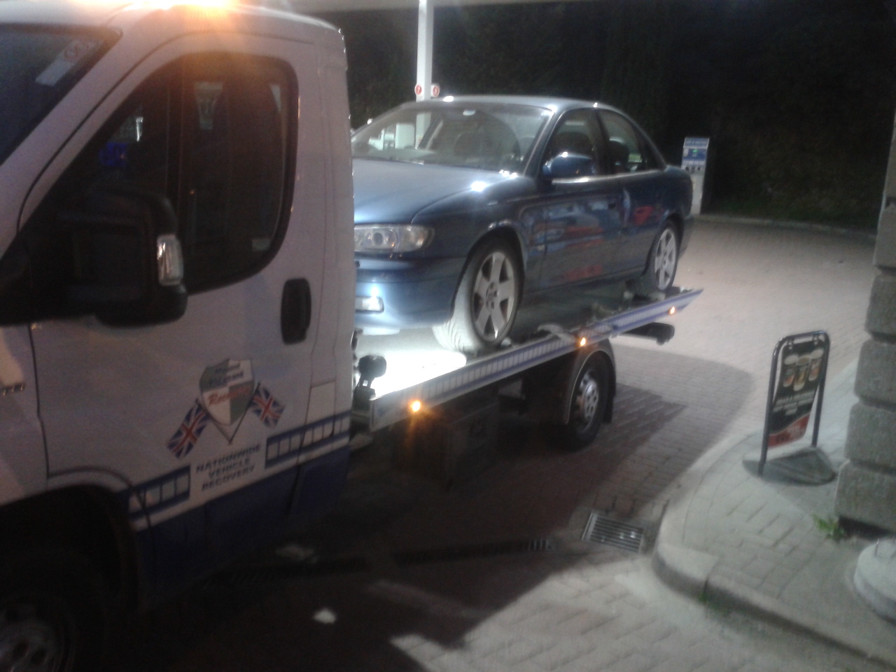

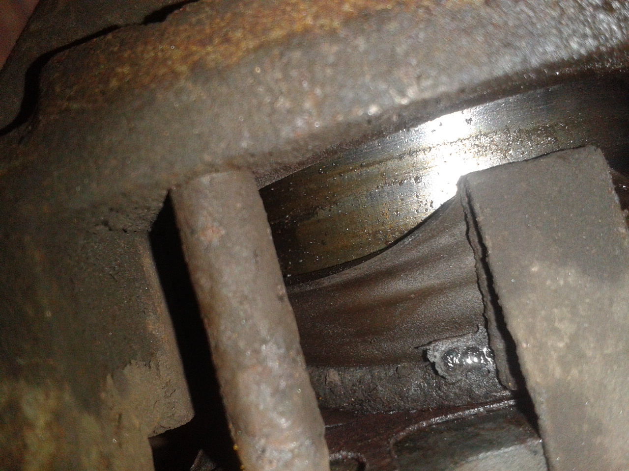

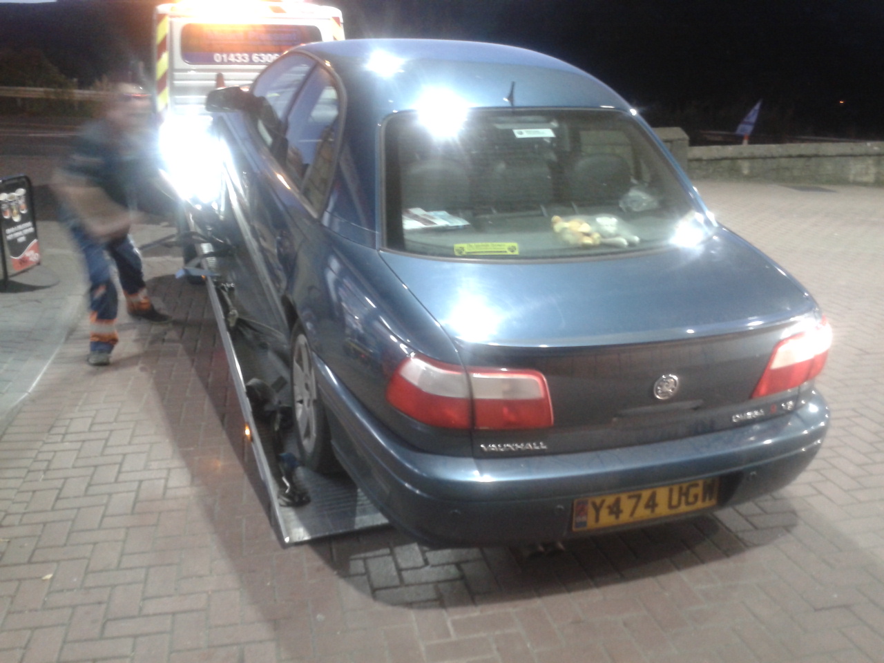

I came across the Derby Dales towards Buxton (as my sat nav was telling me the A50 was closed which was probably wrong. As I bypassed Buxton past Harper Hill, I noticed the brakes were a bit spongy. I decided I needed fuel, so I thought, I'd fill up before I went over the Cat and Fiddle pass. Good job too, because when I stopped at the petrol station there was smoke coming off the drivers side rear brake. And fluid all over the inside of the wheel.
Obviously RAC were as stupid as ever.  I explain the problem. I explain that a man in a van will be no good, as he's not going to fix it, and just send a transporter. An hour later the man in the van arrives to say a transporter is on it's way, (Of course it is mate)
So I phone RAC at 6:30pm,
Man in Van arrives at 7:30 (Yeah)
Transporter arrives at 8:50
Transporter drops me off at 10:40
Now WHY has my MV6 NOT got vented discs at rear. Has it got the wrong calipers or the wrong discs ?

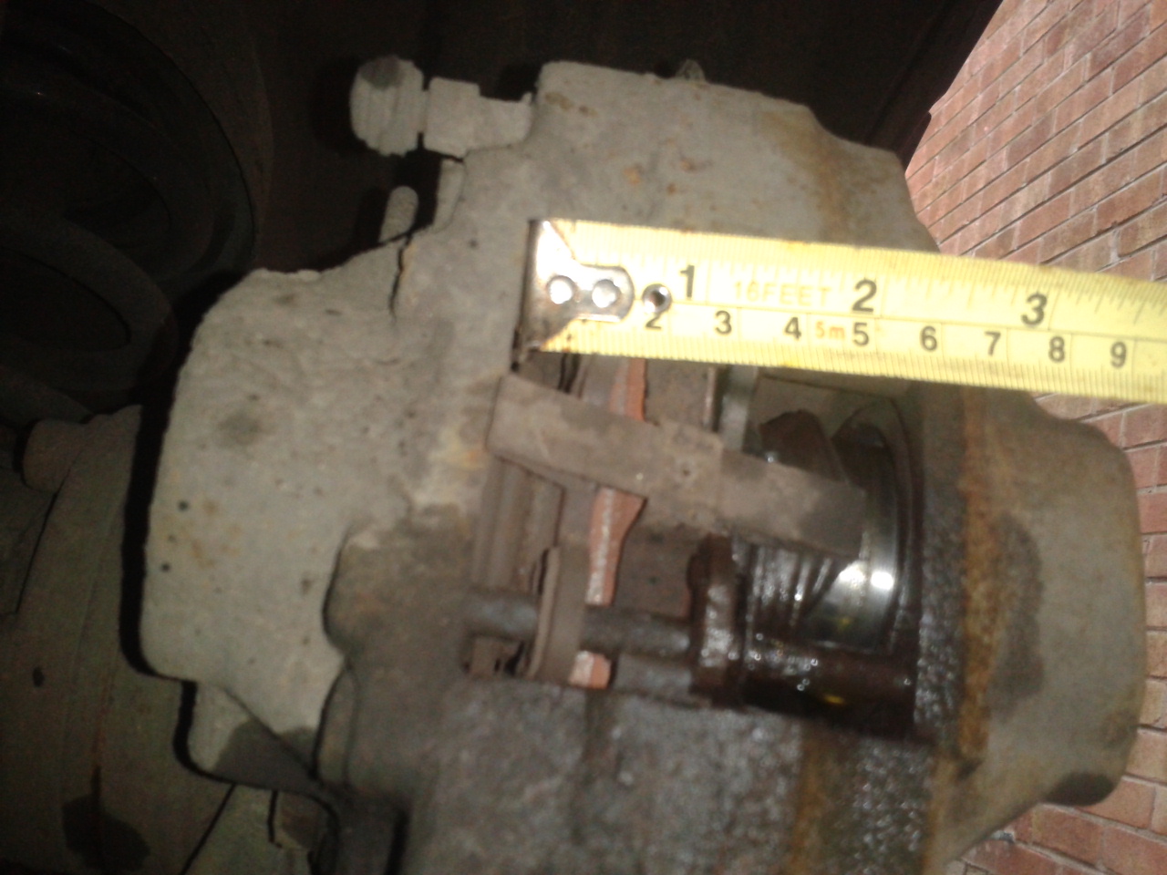

So anyone know how to tell what discs my calipers are designed for ? I reckon if I knew the inside width dimesions it should be I could measure it.
Wait.
Solid discs supposed to be 12 mm thick (HBOL)
Pads are 17 mm when new (HBOL) - I assume same thickness for vented ? Haynes does not have details for later cars GRRR
Vented discs are 20 mm thick (Euro car parts)
Therefore the gap for Vented needs to be at least 54 mm and the Gap for Solid needs to be at least 46 mm but nowhere near 54mm - I will go and measure in a minute.

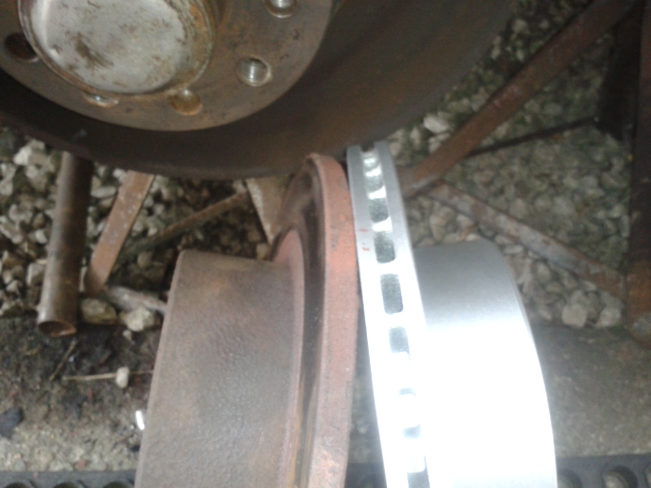

Right ho. I've been out and had a good look. DEFINATELY the Calipers are designed for a vented disc and the pad on one side has got jammed between disc and caliper, causing the heat, and cooking. and the piston has come out past the seals.
The opposing piston is fine as they designed it so that half the caliper is the same as the solid set up.
It might be that I can get away without new seals. There is a 42 on the caliper which I think refers to the piston diameter?

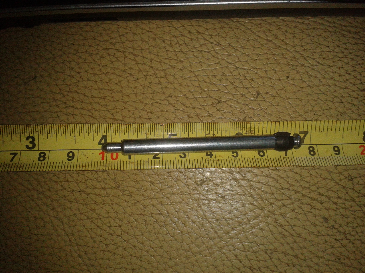

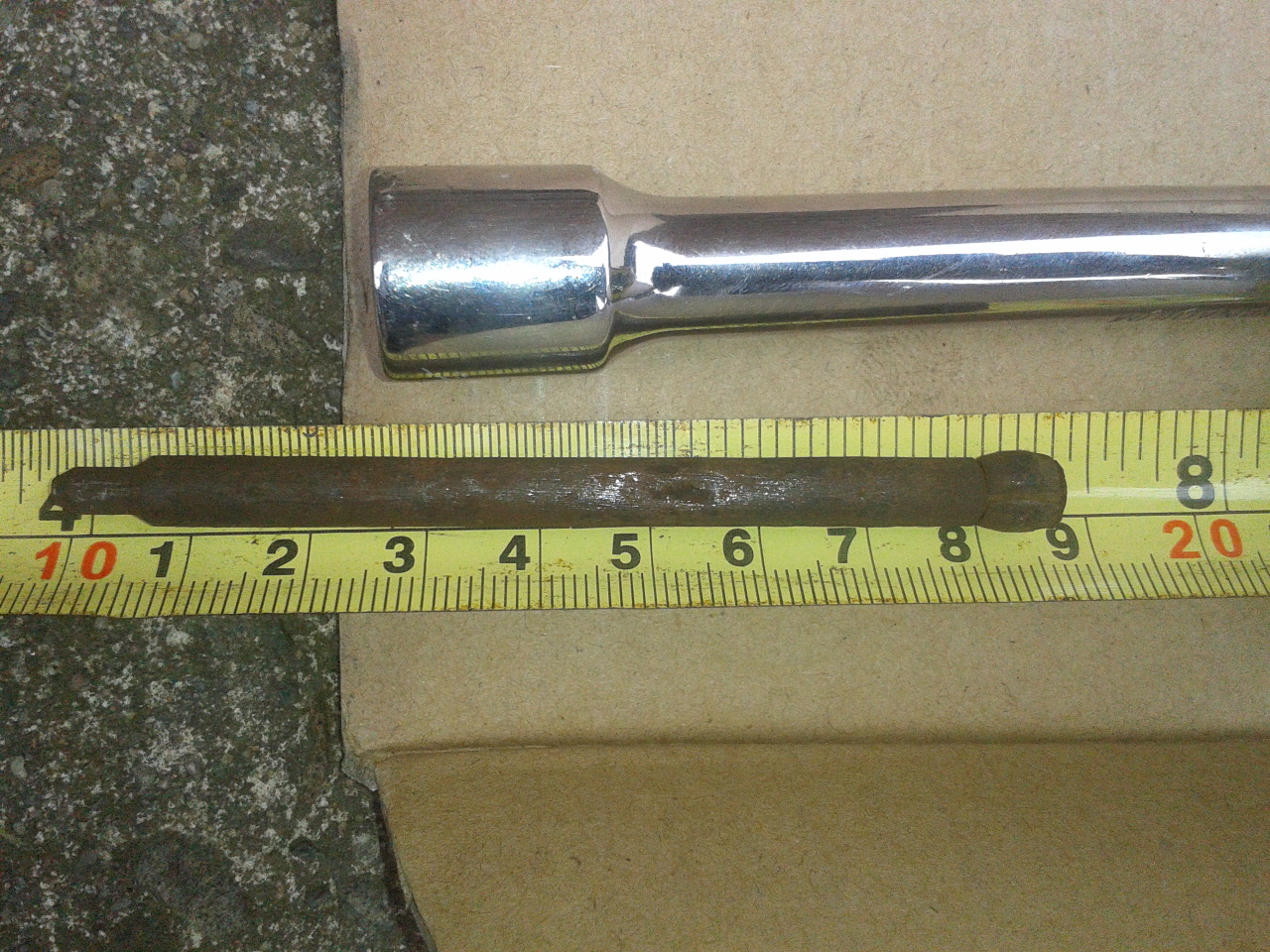

Then The Pins WERE definitely wrong.  post-17612-0-60768000-1503929418_thumb.jpg
As were the spring clips
So I had to use the old parts GRR.

I sent pictures of the correct parts next to a ruler, to various parts suppliers, including US GM parts specialists (It's a Cadillac Catera out there) BUT autovaux say they've had their supplier measure the pins and clips which correspond to the now obsolete GM part number, and they have them right and in stock.
I have therefore ordered them, but am convinced that they will be wrong when they arrive.
Parts arrived direct from 2 different suppliers of Autovaux.
One tip here is that the little split springs which sit at one end of the pins, don't have enough of lead in, and so rather than struggle, a slight squeeze with pliers, shuts them just enough for the lead in to allow then to be fitted with a gentle hammer tap.
