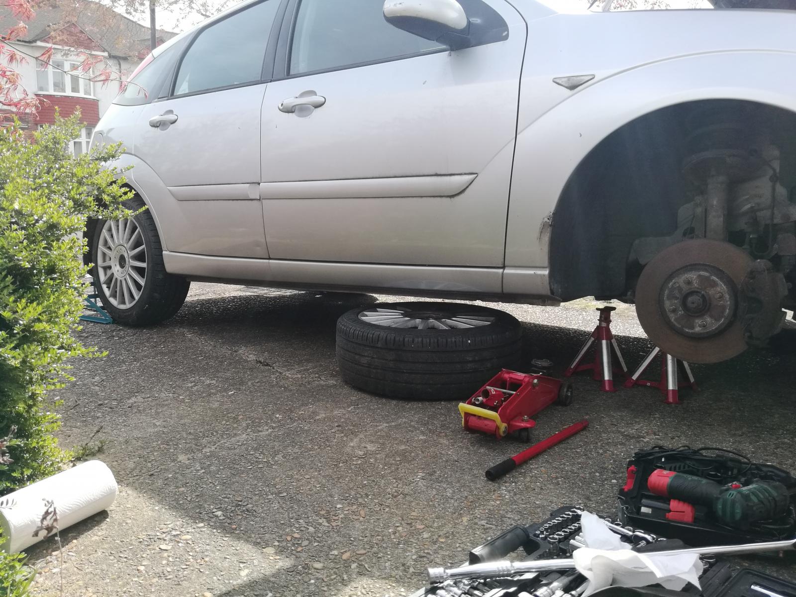

Matey's driveway isn't ideal as it slopes so I used my ramps as chocks and shoved the wheel under the sill to catch it should it fall off the axle stand. I had to remove the mudflap to get the trolley jack onto the subframe, that's easy though, two screws.

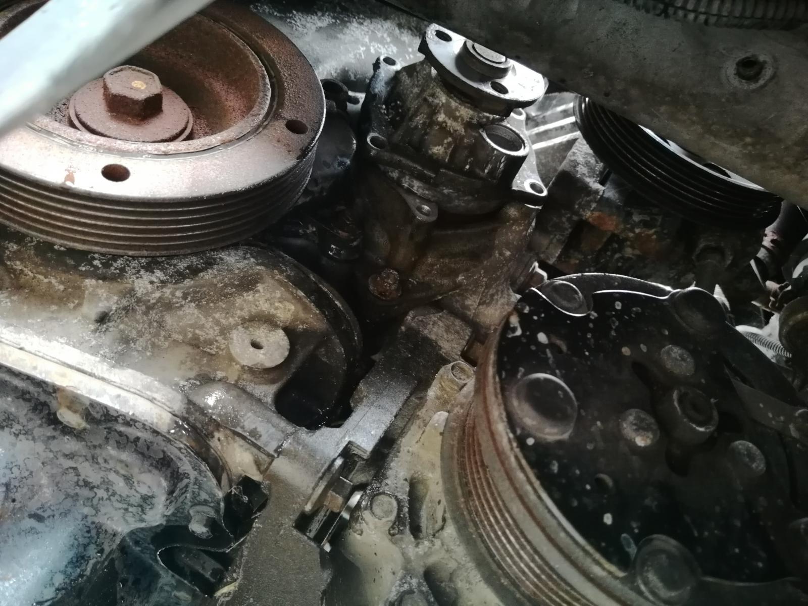

The old pump was properly corroded in, had to twat it loose with a big spanner and a lump hammer, before hammering a screwdriver into the gap. It came off eventually though.
I'd expected a couple of pints of coolant at most to escape, but actually a good half a gallon came out.

Having gone to all that effort I was very relieved to find that the old water pump looked like that. The plastic impeller is just pressed over some knurling on the shaft, by the looks of things, and had come loose. Why on earth they didn't use splines I have no idea. I reckon it's the original judging by how well it was stuck in, so I suppose managing 100,000 miles isn't terrible. I thought I'd taken a pic of the new pump but it hasn't saved for some reason- it's got a solid metal impeller.
