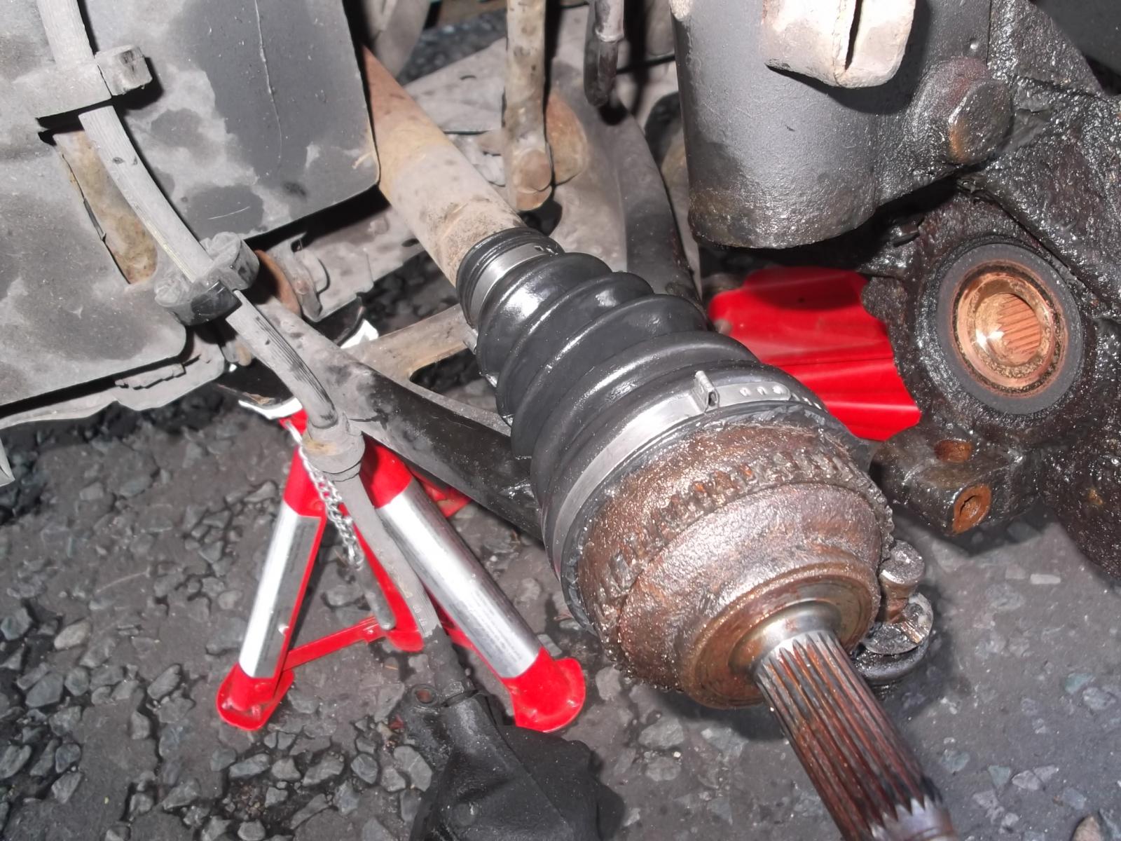

Right, an update. Finally got back on this now it's warmed up above freezing and I've more or less recovered from a bout of man flu. The metal band ground off pretty easily with my Dremel. I did a half arsed job of trying to clean the old grease off the CV joint with kitchen towel (it wasn't full of muck anyway), then got my cone out. The kit came with two sachets of grease, apparently so that you can use one of them to lube the cone when slipping the boot over. I figured that would be incredibly messy and unnecessary when I have a can of silicone spray here, so I turned the boot inside out over the cone and then set about squirting the spray inside it. It took a few goes to get it sliding up and down freely, but I was soon at the point where I felt like it would slide over freely (I'm trying and failing to Finbarr Saunders this, here). Once I'd levered the upright slightly out of the way with my jack handle, over it went.
Unfortunately the thin end hadn't ended up on the fat bit of the driveshaft where it's supposed to sit, so I buggered around trying to pull it over before deciding to use a disposable wooden chopstick to fiddle it over, which worked fine. At the top end, I figured the largest section of boot wouldn't fit over the (fairly small) CV joint outer very well, so I decided to use the second largest section, they're designed to be cut to fit. Meanwhile, I cut one of the grease sachets open and set about trying to squirt it into the innards of the CV joint. I had originally planned to use both sachets just to make doubly sure it had plenty, but even one seemed to be far more than looked necessary, so I emptied it all in there and called the job a good 'un. Time for the fixing bands. I don't have a pair of the proper pliers so just used a pair of pipe grips. The inner one went on no problem and felt secure but the large outer one slipped off the band in the boot where it's supposed to sit, so I had to loosen it again and have another go; I pulled the boot as far up the outer CV joint housing as I could at the same time, before squeezing with all my might to crimp it off again. Then I trimmed off the loose section with a pound shop craft knife. Here's the finished result:
I'm a bit worried that the big end is going to slip off; there doesn't seem to be much if any flare on the CV joint outer to hold it on; it looks as if the original CV boot fitted into an indentation on it. Still, I suppose I will have to hope for the best. Having a coffee and a vape before I begin the buggerance of trying to get all the suspension bolted up again with the various threads I've probably damaged twatting them with hammers etc. to get them loose.

It's not my car, so if I manage to get it roadworthy again I'm not going to be able to monitor the CV joint as often as I'd ideally like- though I will try and remember to have a quick nosey whenever its owner brings it round! I've got to actually get it back together and steering straight first anyway, which at this point is not a definite...

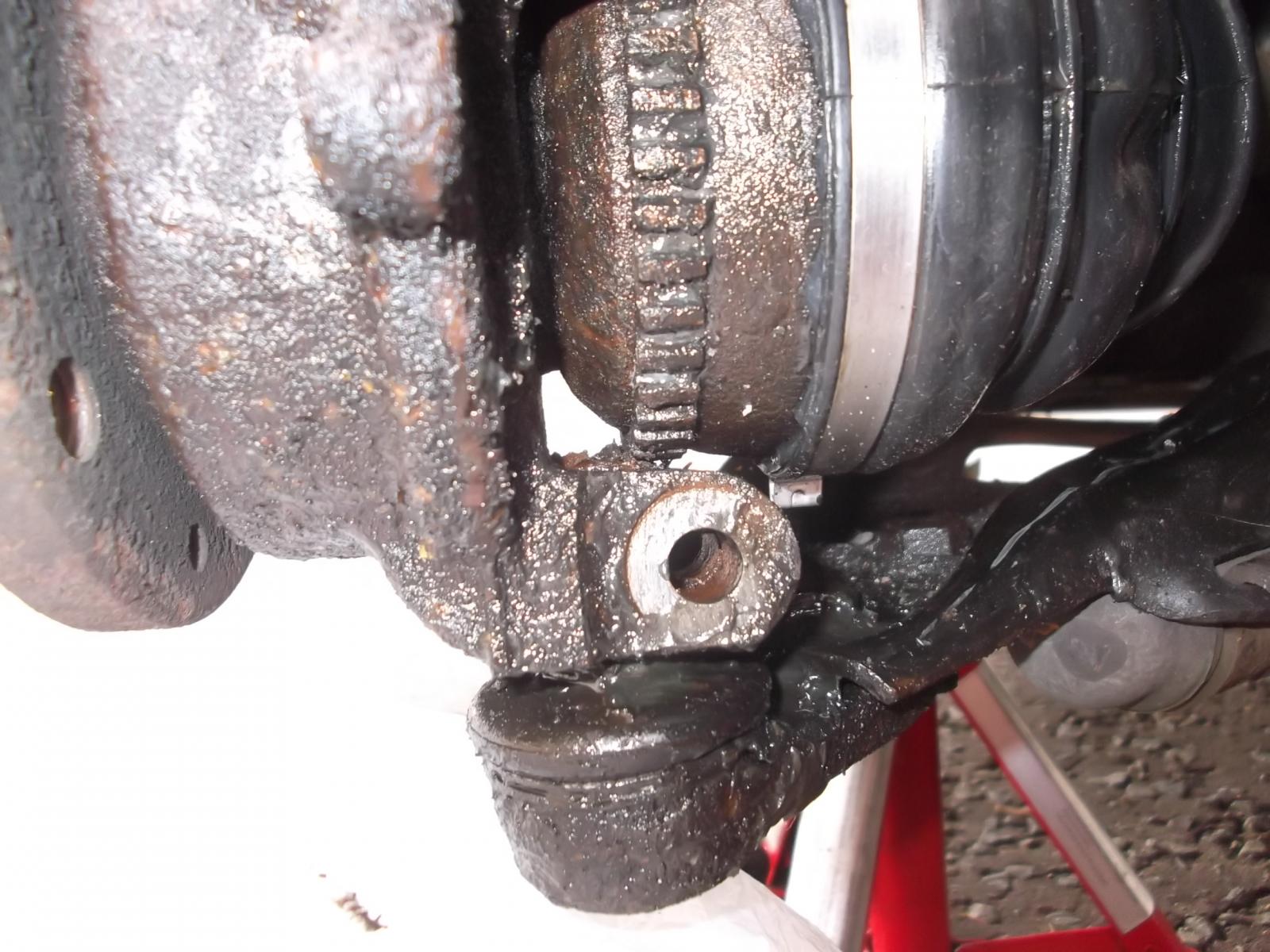

Right time to stop and have a coffee and seek advice I think. I'm finally trying to get it all bolted back together now. First order of business was to get the hub back on the driveshaft and try and insert the stub of the bottom ball joint into it. After a brief initial lever I figured that for the sake of 10 minutes I should get my spring compressors on the strut to try and make my life a lot easier. Then, after an effort that still nearly caused me to faint, I got it underneath, and further gentle levering and adjustment got it in the hole. So far so good.
So then I figured I'd spin the hub just to make sure it was spinning freely and...it's not. The stub of the ball joint is poking right up through the pinch section of the hub and rubbing on the ABS ring. I looked down the hole and sure enough the indentation in the ball joint stub where the pinch bolt goes through is higher than the hole. I had a rootle around in the boot where I'd chucked everything when I dismantled it, and couldn't find a spacer or anything. Is the stub supposed to be held in place by the clamping force of the bolt, then?
The only problem if so is that in my infinite wisdom I thought I'd give the stub a quick smear of copper grease before I put it back together, thinking that would make my life easier if I need to pull it apart again. That doesn't sound like a recipe for secure clamping to me, and I worry that the weight will end up on the bolt, which doesn't sound like a good idea. So what's going on? Do I need to pull it apart again and clean it all up, or what? Am I in fact missing a spacer which I need to look harder for? Quick replies appreciated as I've put myself under a bit of time pressure now! :mad:

I leave ball joint 'shafts', no sniggering at the back, dry. If the shaft is parallel, eg not tapered then it should obviously only go in as far as the indent for the bolt to sit in.

Is the driveshaft engaged properly where it goes into the gearbox?
The balljoint has a thicker bit after the stub to stop it going any further and damaging the boot.
Yes the but holds against the indentation and is also held in by the pinching action of the hub.
I assume the driveshaft is engaged properly but haven't checked. I can't see how that would make any odds to how far the ball joint shaft/stub goes in. There is a small flat piece of plastic with a locating nib between the ball joint boot and the stub, but obviously that hasn't stopped it going right the way in so that the indent in the stub is past the bolt hole. To get the bolt in I will need to gently lever the wishbone down again, which I don't foresee being a problem, I just want to make sure that it's clamped up tight as I assume that the bolt is not supposed to be subject to any non-axial load once it's done up...
Edit: Anyway I guess my question has been answered, better pull it apart again and clean the stub and hole in the hub with brake cleaner! :(
Are you sure you are using the right bolt as the pinch bolt?
It should have a longer than usual un-threaded shoulder which engages with the ballpoint recess...

Andy, the pinch bolt is the right one, I haven't even put it in yet- it was rusty as hell and the nut is hard to get on, but I forced it on with a ratchet and then removed it again, and it's not cross threaded, just stiff. Cleaned the unthreaded bit up with a wire wheel on my dremel and will copper grease it prior to reinstallation.
Thanks BF2, I hadn't really thought it through that most of the weight of the car is on the spring. Still don't like the idea of it being greased if it's suppose to be a clamp fit. What I'm going to do is remove it again and clean it up with just kitchen towel, no brake cleaner, that might hopefully leave a few copper particles behind for a bit of anti-seize. It wasn't hard to get it out when I pulled it apart, the pinch bolt was a fucker though!  :mrgreen:
Once the bolt is torqued up then any failure is going to occur at the actual ball joint itself. That's why the dust cover is now a part of the MOT.
As others have hinted, locate the indent in the correct position, slide the bolt in, copper slip would be good here, then torque up, jobs a good 'un.

Anyway I levered it apart again, cleaned the stub and hole, shoved it back in, copper greased the hell out of the pinch bolt and did it up as tight as I could with a normal ratchet on the nut and a spanner on the bolt. That's tight enough right? (I call pull pretty hard) :P
