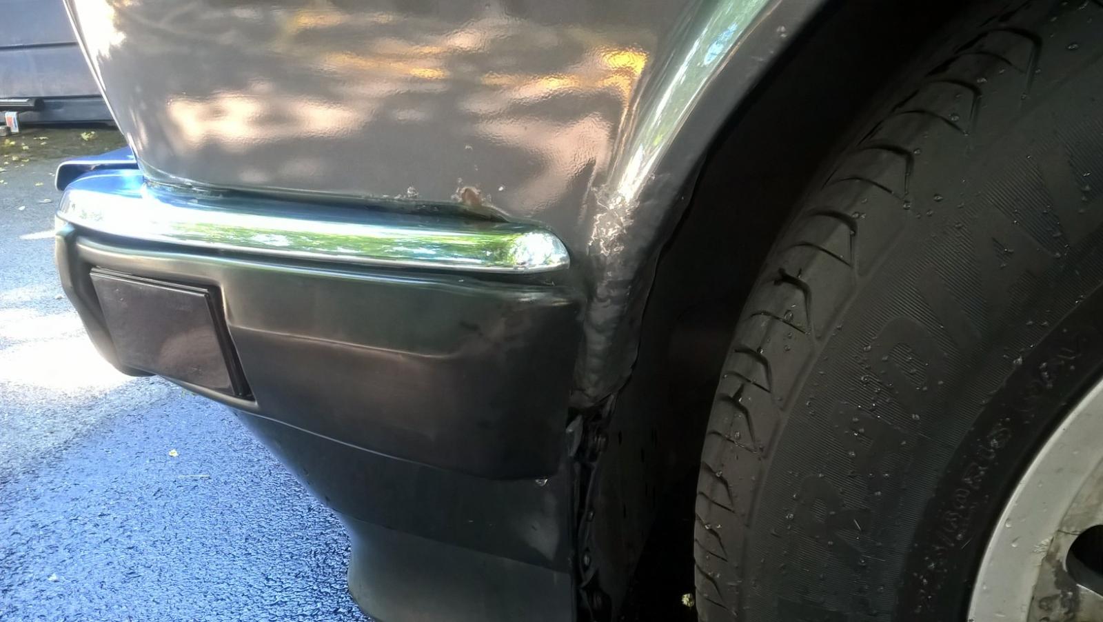

RobT Posted July 10, 2017 Author Posted July 10, 2017 Are the front wings rotten? Most important question. Which engine is it? Yes. The sill is of more concern though. How it passed an MoT I've no idea, as there's also holes just forward of the jacking point in this pic. They look to have been there a while. It's a 3.2, so no sports 'box and not as rapid as the 4.0 litre, but as proved yesterday it's quick enough!
