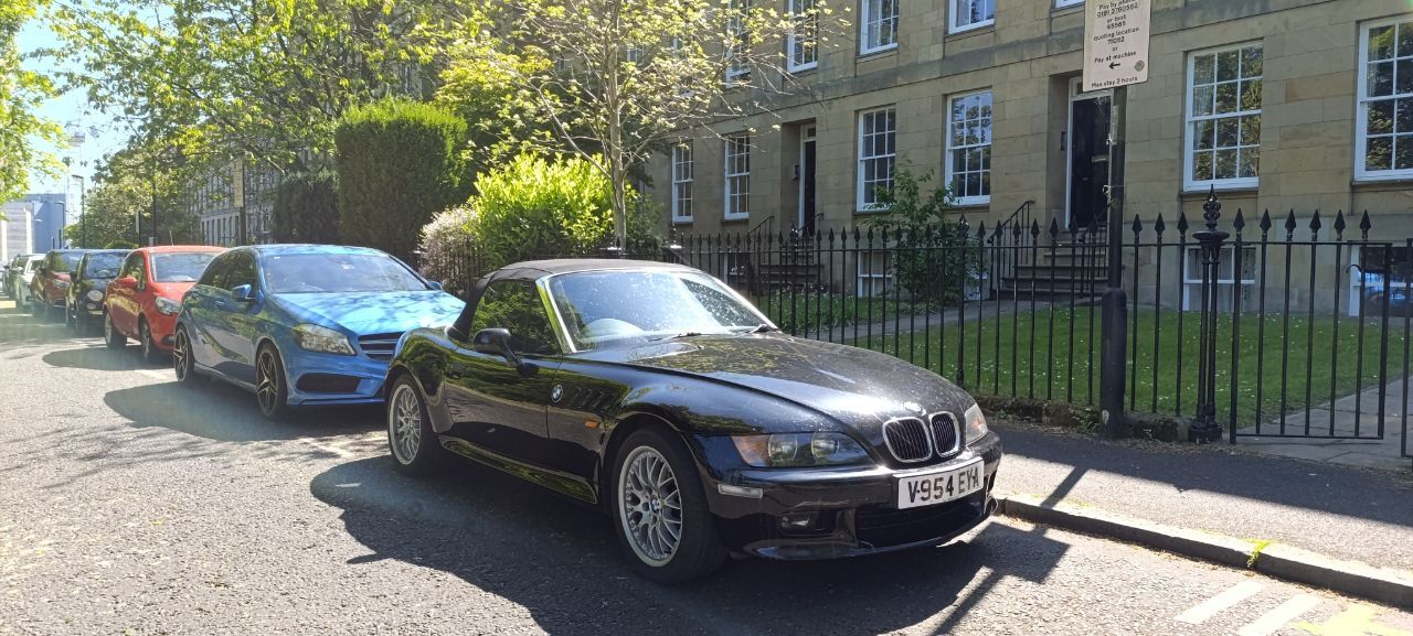

The Z3 Roadster received a little more attention over the last few days/weeks. With the Legend recently incoming and XK8 available as convertible option there was no urge for me to get it ready for its MOT despite hardly needing much. One of the things bugging me were the typical cloudy headlights. As with the C6 and many other cars before, the leftovers from various headlight polishing kits came in handy, it definitely was needed:
And polished:
Spending those 45 minutes per side is probably one of the best visual improvements you can do on a car. As always, never forget to use a high quality sealer to keep the look.
Another MOT relevant issue was the airbag light staying on. I don't think there is a more typical BMW issue out there (to be fair, most warning lights are). This time it was the driver seatbelt tensioner. An issue so common that BMW offered a wiring repair kit. In this case a previous owner/garage opted for the used part route from the breaker. That will definitely trigger it:
I've crimped on another connector and insulated it all a bit better, hopefully that'll keep the light off from now on. The high level brakelight on the bootlid didn't work for the same reason, no previous bodge there, just good old wear and tear along where the wiring loom folds, so another quick and easy free fix:
I've also found an OEM radio that actually turns on (and works!) after the 3rd attempt. In the end it was the cheapest one I bought (15 quid incl. postage) that not only wasn't messed with before but also worked right away, albeit with some pixel issues on the screen. Even non-functional the other two should be worth a bit of money the next text time Im back in Germany, so no money lost there.
Another cosmetic upgrade happened as well. BMW offered a chrome line package for the exterior of the Z3. All parts together look pretty tacky on them but the windshield frame covers work very well on their own in my opinion (similar to what Audi did on the A4 Cabrio), especially on cars in darker shades like mine.
Taking photos in the garage probably doesn't give them the same effect as seeing the car outside but it should help make the Z3 feel a little more upmarket, something especially the pre-facelift cars desperately needed.
Installing the covers was a bit of a pain, if you don't want to take the windshield out you have to remove a tab on them towards the bottom of the A-pillar. Even then trying to get the rubber seals to actually sit on top of the chrome trim is awkward to say the least and requires quite a bit of patience. I've also decided against buying the tine center cover from BMW, the prices for them are pure extorsion and I might as well grab one from a breaker for free when the opportunity arises.
If you are wondering whats actually holding the trim on: doublesided tape, from the factory.
It got new wiper blades as well. Aside from the lack of parking brake warning light it should be all ready to go, fingers crossed it'll behave until Saturday. Immediately getting an error code from a cam position sensor (somehow without triggering a CEL) isn't a great omen!😂

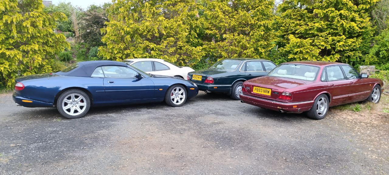

No major updates! The moon-mileage XJR has finally made it over to the new house. I haven't driven it since we sorted the cat/MOT and I fixed the window lifters 6 months ago. With space getting a bit tight I think I might have to pop up an ad for it soon.
Similar story with the XK8. It's a good car (with a rattle I haven't diagnosed properly yet) but with little space aside from a field until much later in the year it's better off with someone else possibly while it's got a fresh test.
If anyone is interested in either of these send me a pm!

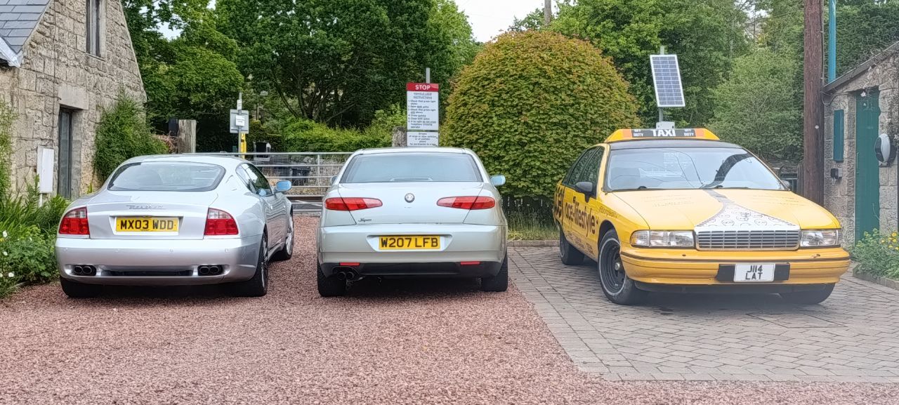

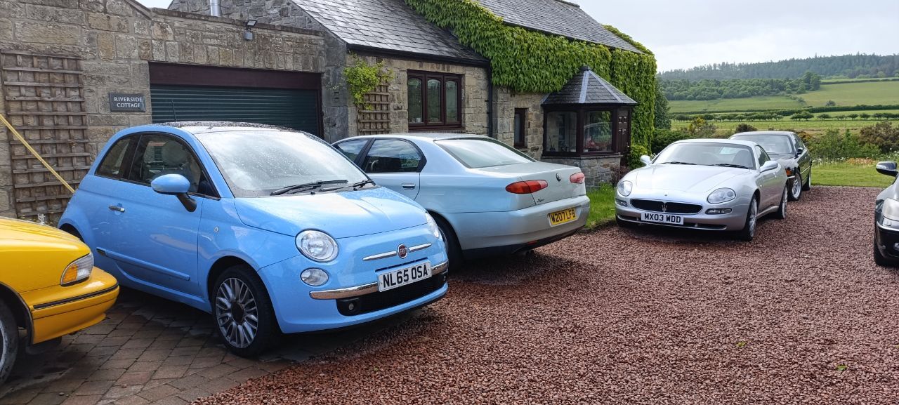

Some car shuffling happened today, there's certainly always an eclectic mix of cars to be seen. Replace the E38 with my 156 and you'd think there are some hardcore Italian car fans living here:
Thinking about it, Lancia Thesis aside I don't think there was any car in between the 3.0 Alfa 166 and Maserati Coupe in Fiat's corporate model hierarchy at the time. The Maserati must have been twice the MSRP of the Alfa?

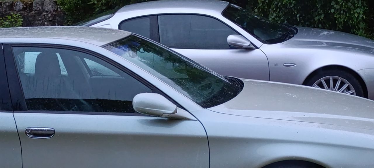

Despite that they do share quite a few parts. I've only noticed tonight that I can probably add the wing mirrors to the list:
There are definitely some common parts. Door mirrors as you’ve spotted. Indicator/cruise control stalk is another.
