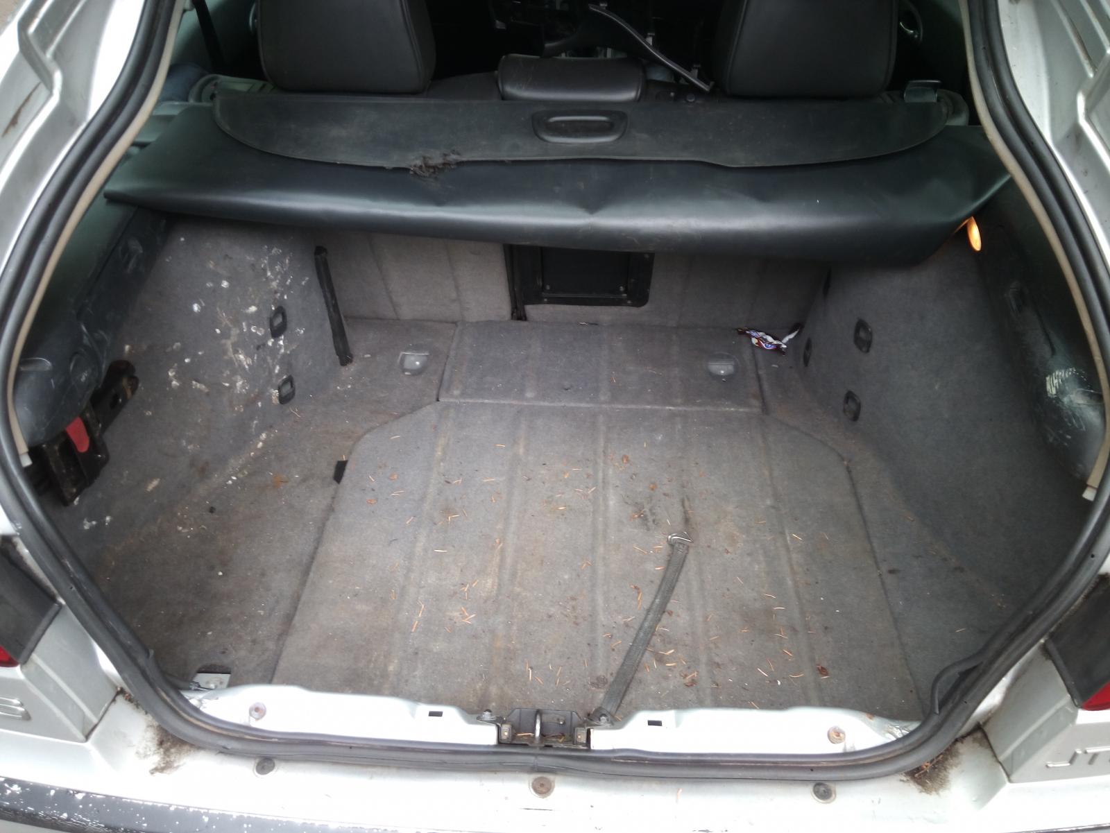

I set about trying to make it less honking in the inside..
First up was to do the boot.
This was almost fetid! Think it'd been used by a painter/decorator as a mixing pallette..
A damn good hoovering and some febrise had it much led honkarino

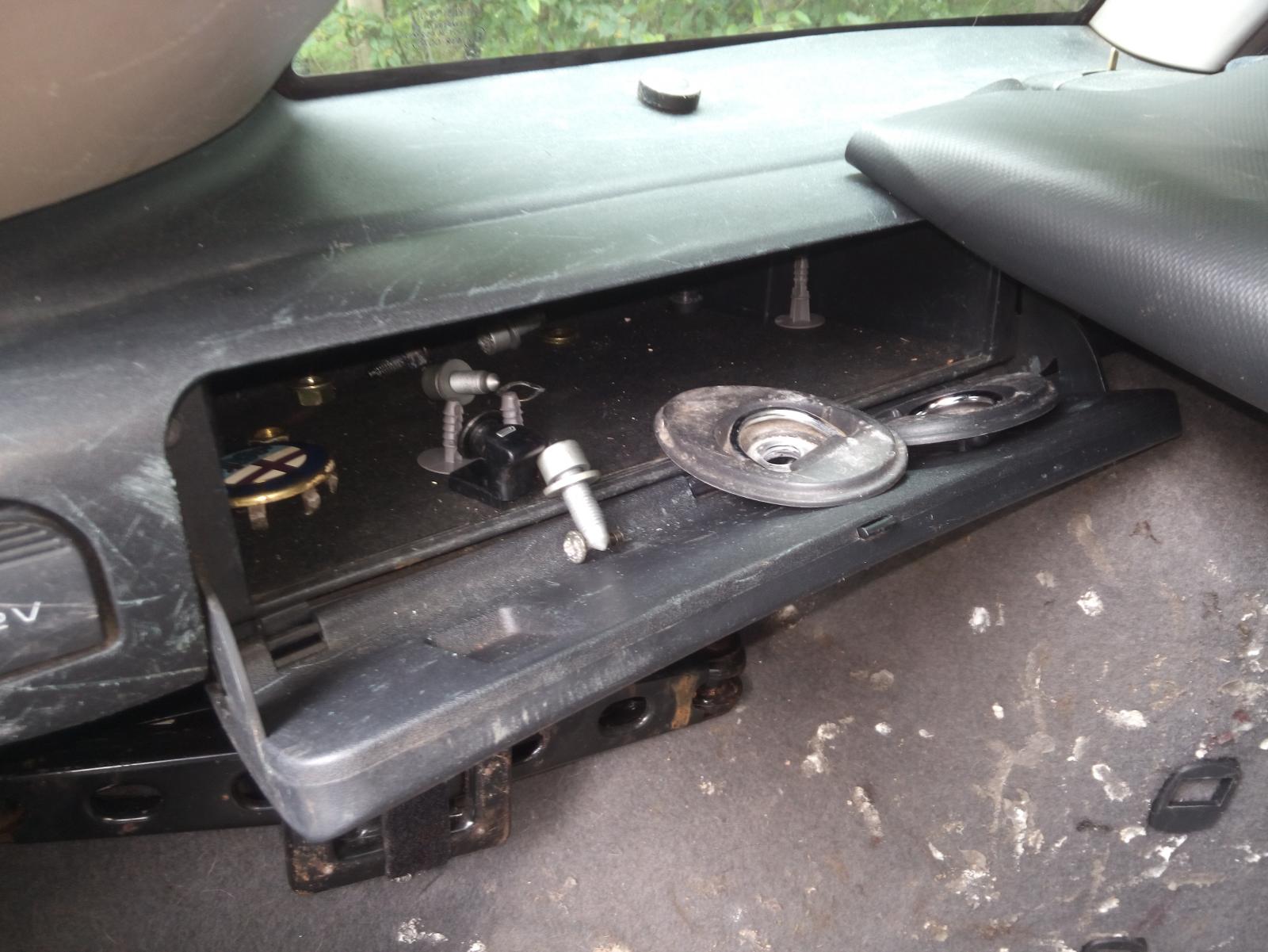

Also found some bonus cubbyholes- ideal for tool storage once the random bolts were removed.

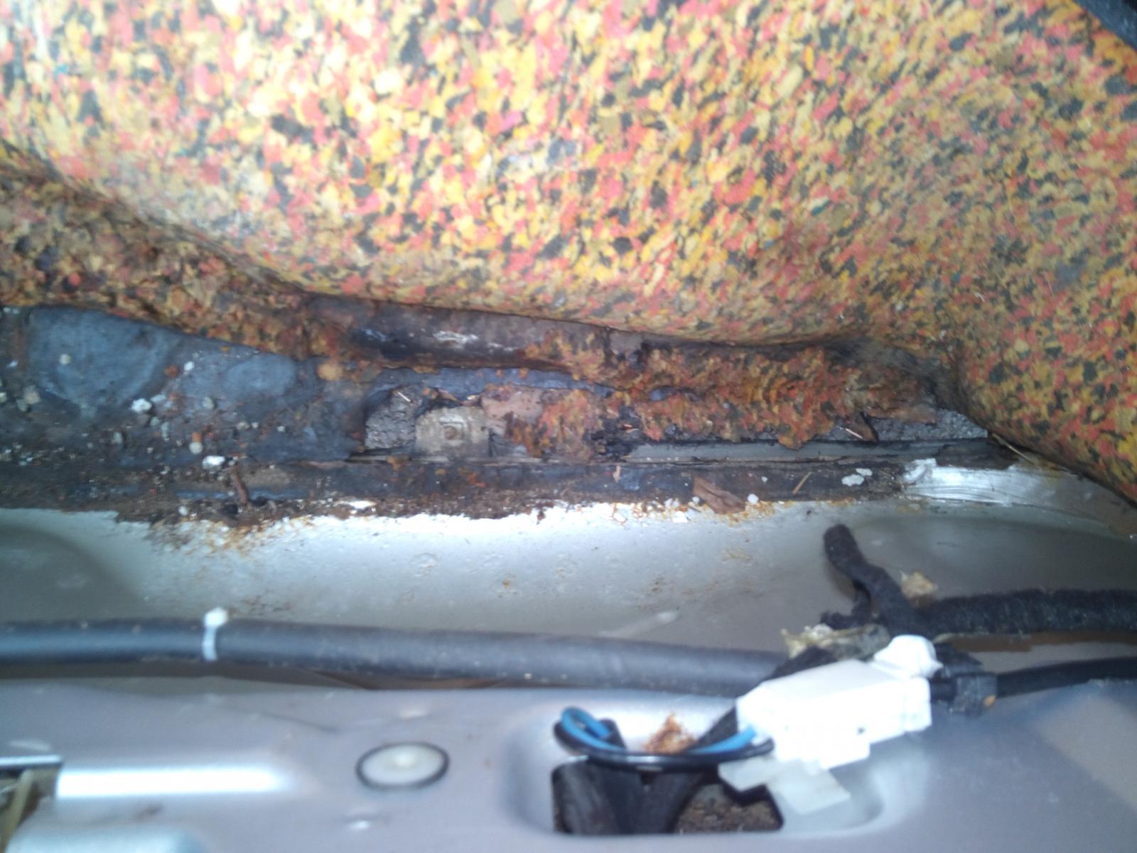

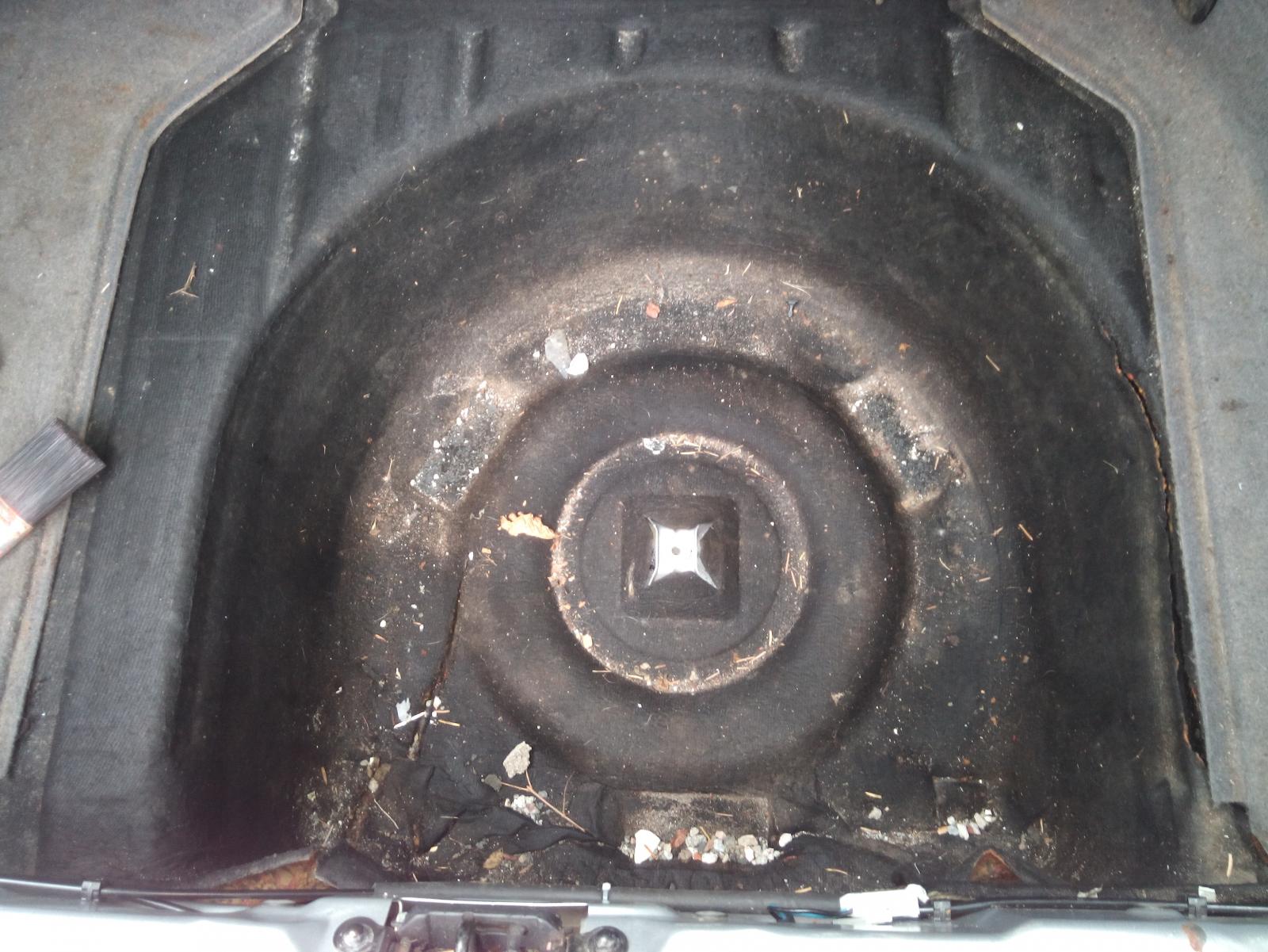

I cleaned out the wheel well and found Alfa spec fresh air ventilation
I put the padding back down.

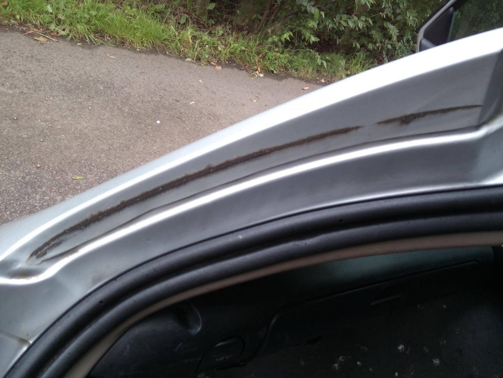

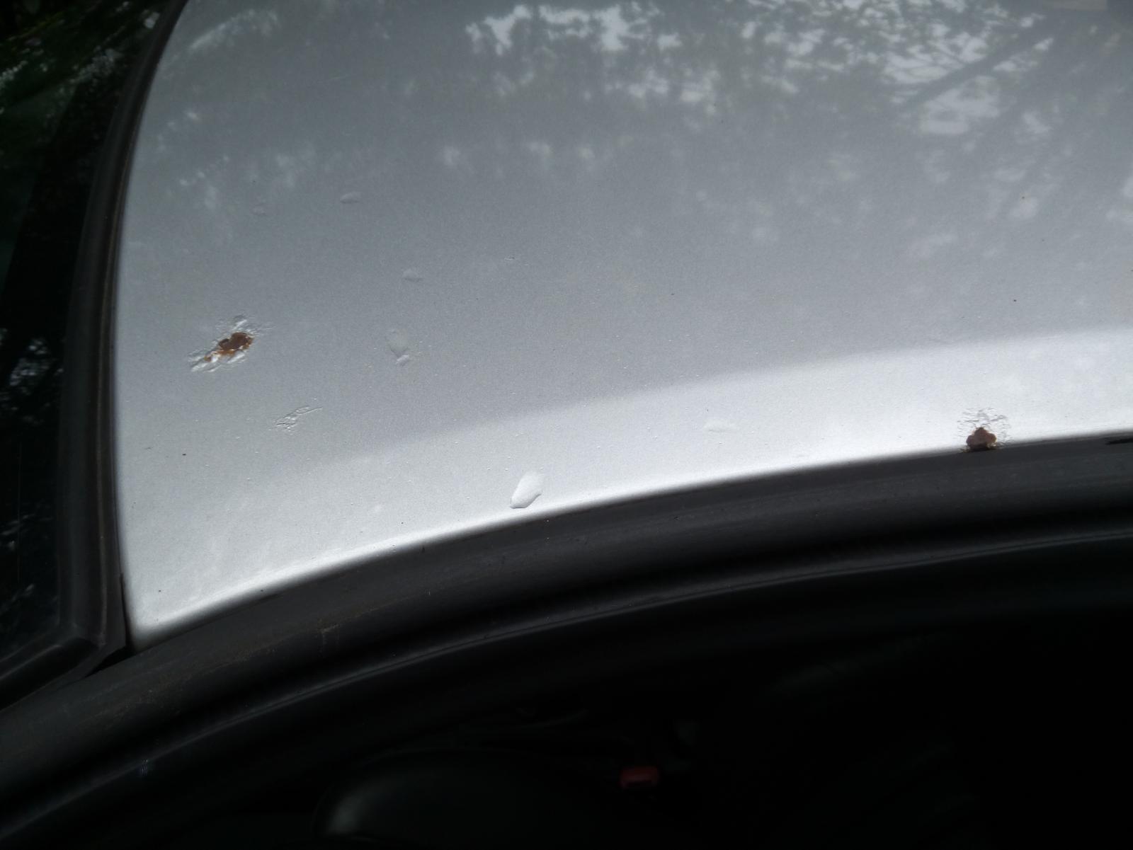

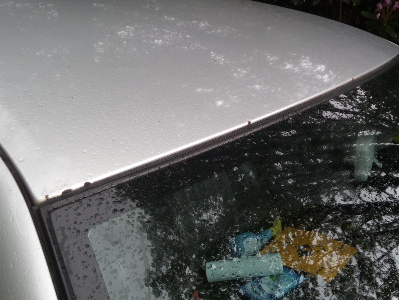

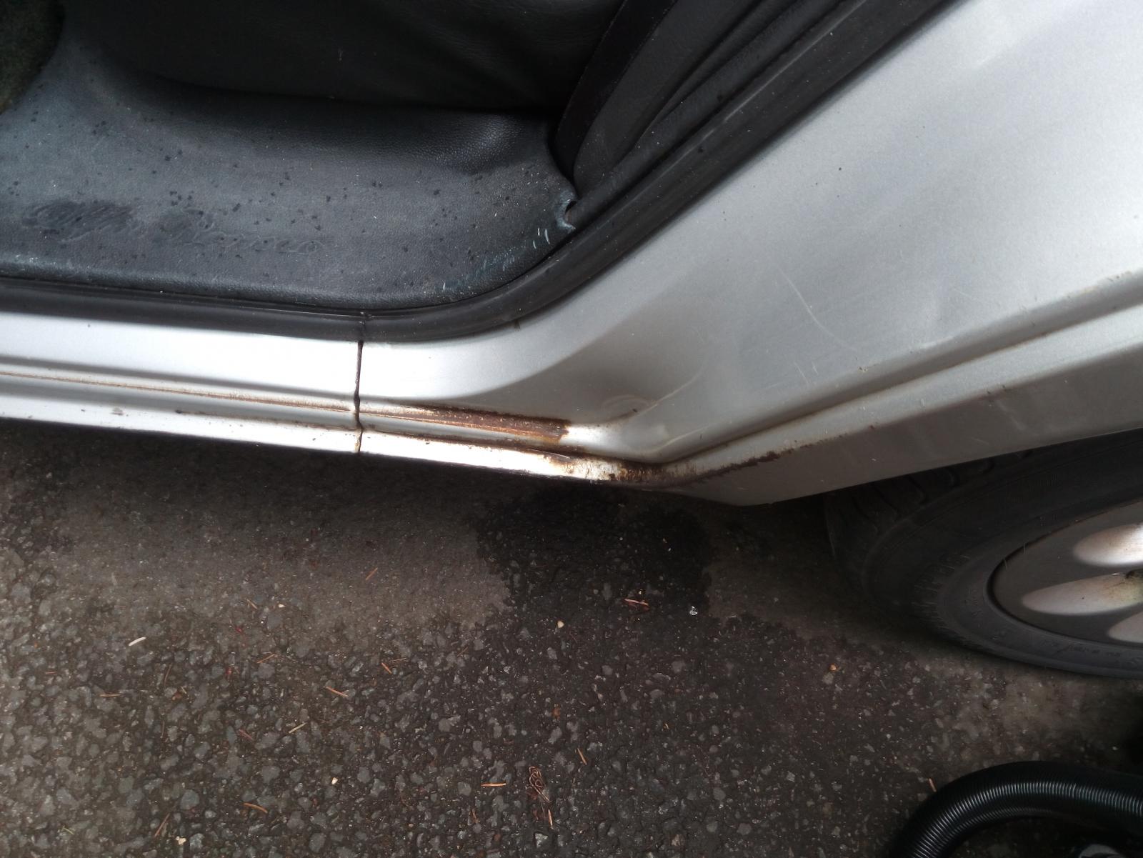

Next up was a clean round the rear hatch, which highlighted an interesting* join in the rear quarter..
Add that to the myriad other rusty spots (roof/sills/bottom of wings) and its not looking like any trophies will be forthcoming.

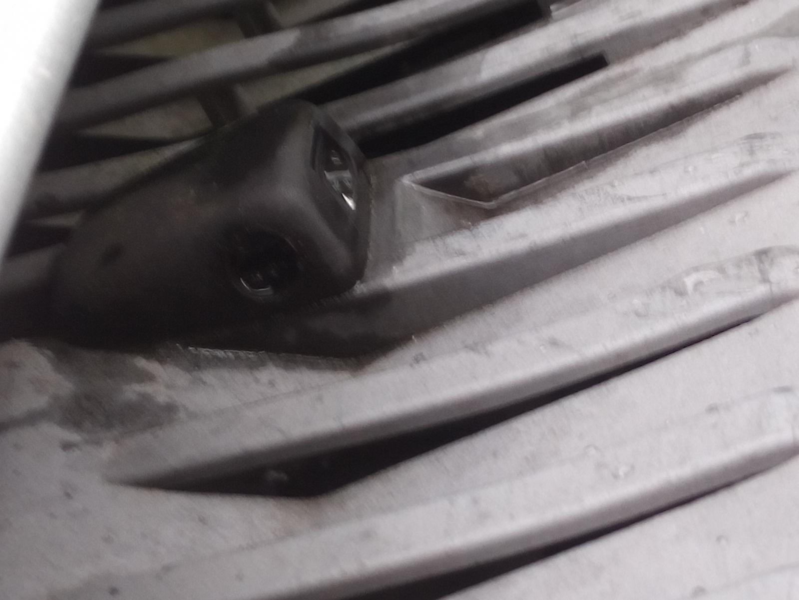

Next up, sorting the drivers side skoosher. It was doing a tremendous job of washing the sky.
For once, Alfa made it simple with a little screw head you turn to move the jets. Doddle!

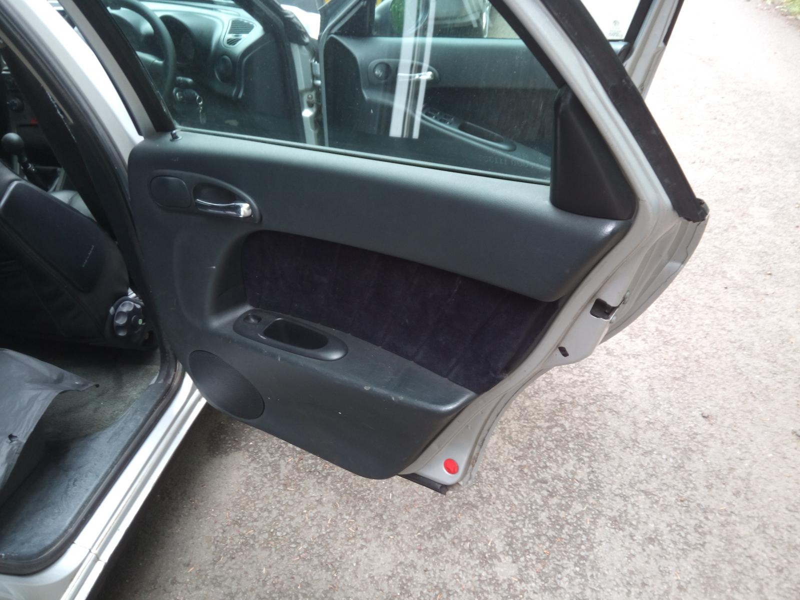

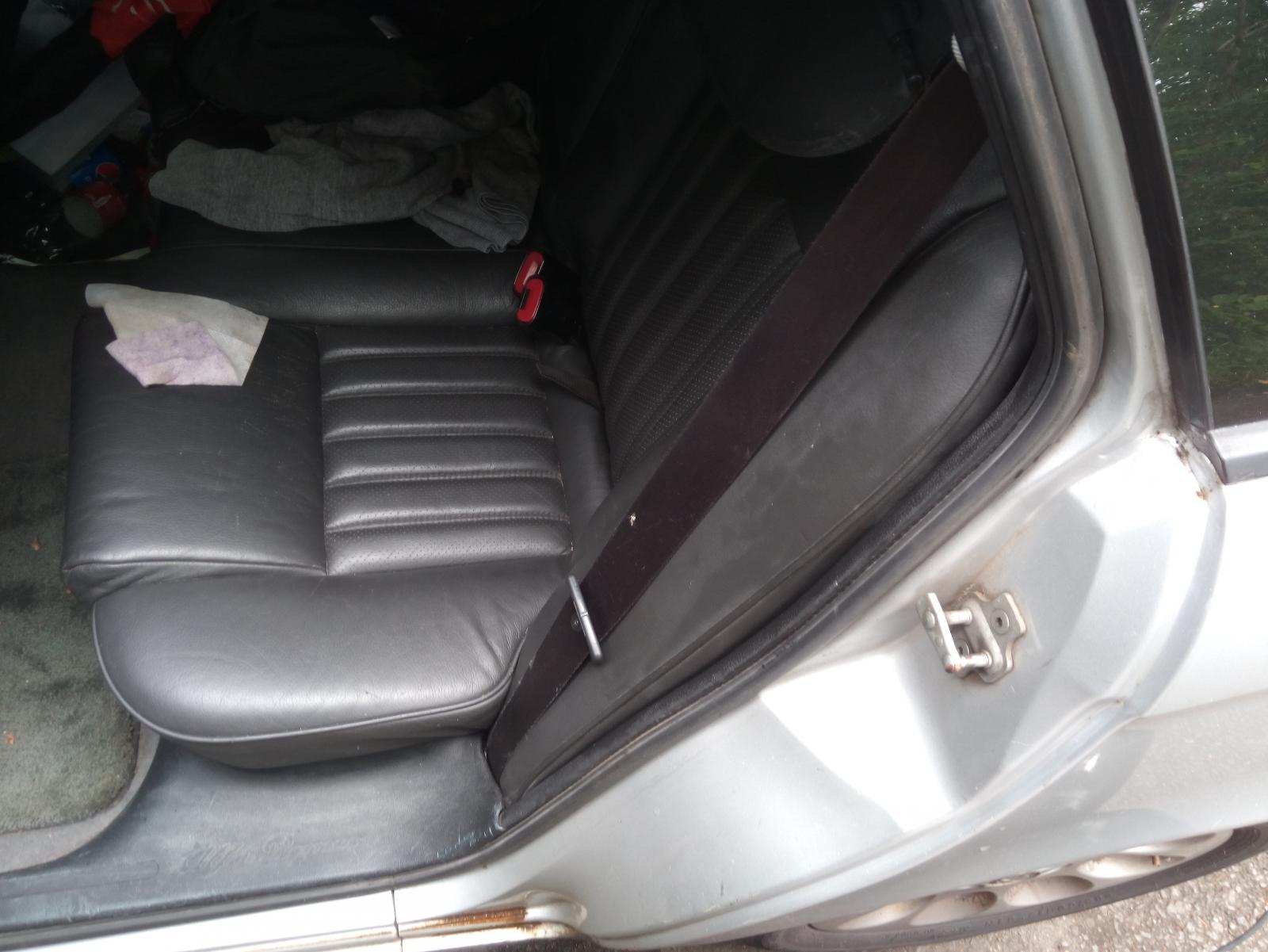

Next I turned my attention to the damaged right rear door card- managing to glue the material back on so I didn't have to swap cards

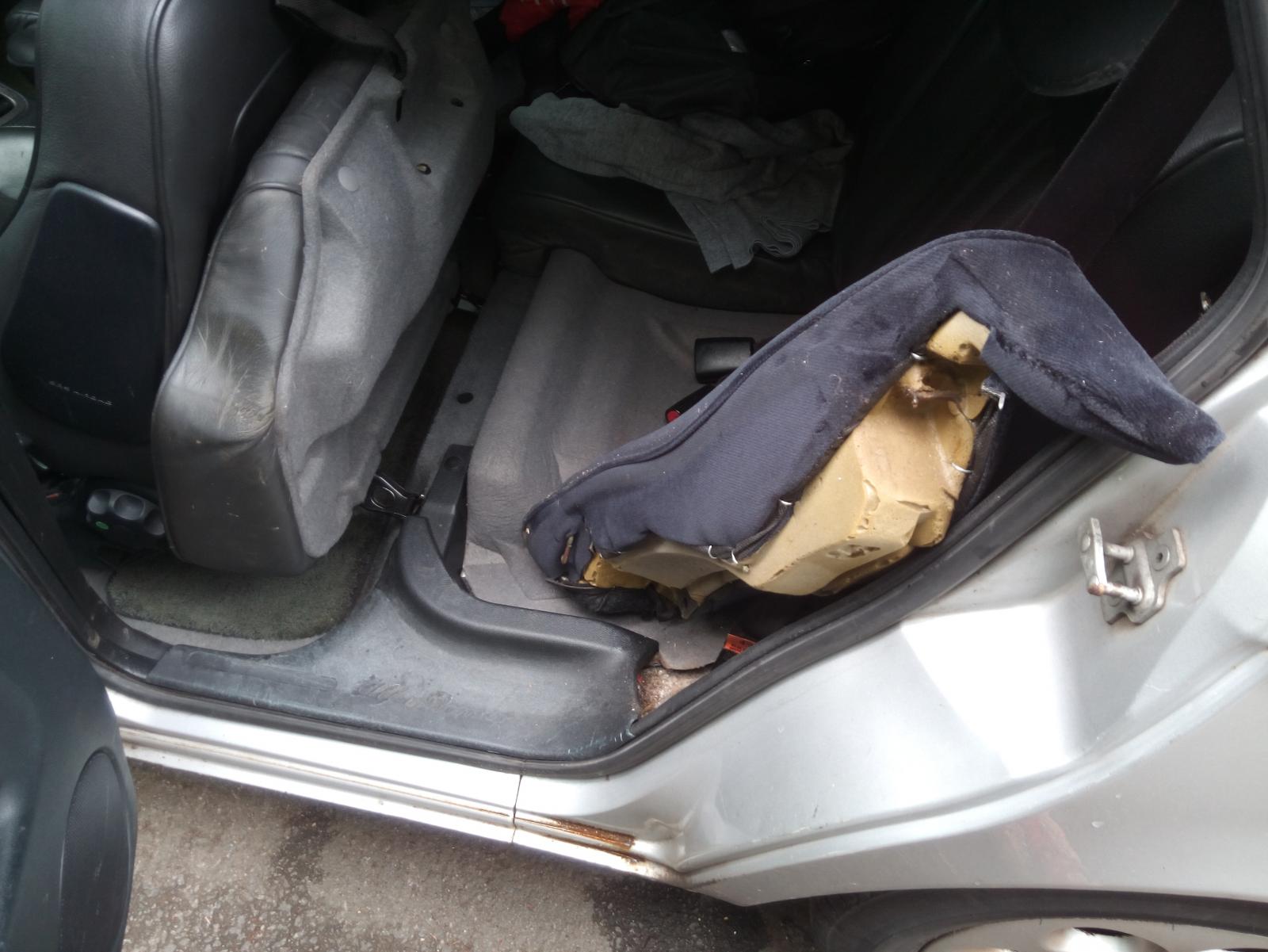

The rear bolsters were swapped from blue cloth to black leather, meaning all the seats were one colour now.

In the pic of the l/h boot cubbyhole is a wheel centre cap, if this is spare, can haz plz?
Looks better, can confirm that mine has crust in many similar places.
Ah, aye I think its spare- Happy to post,just let me ken the addy etc.

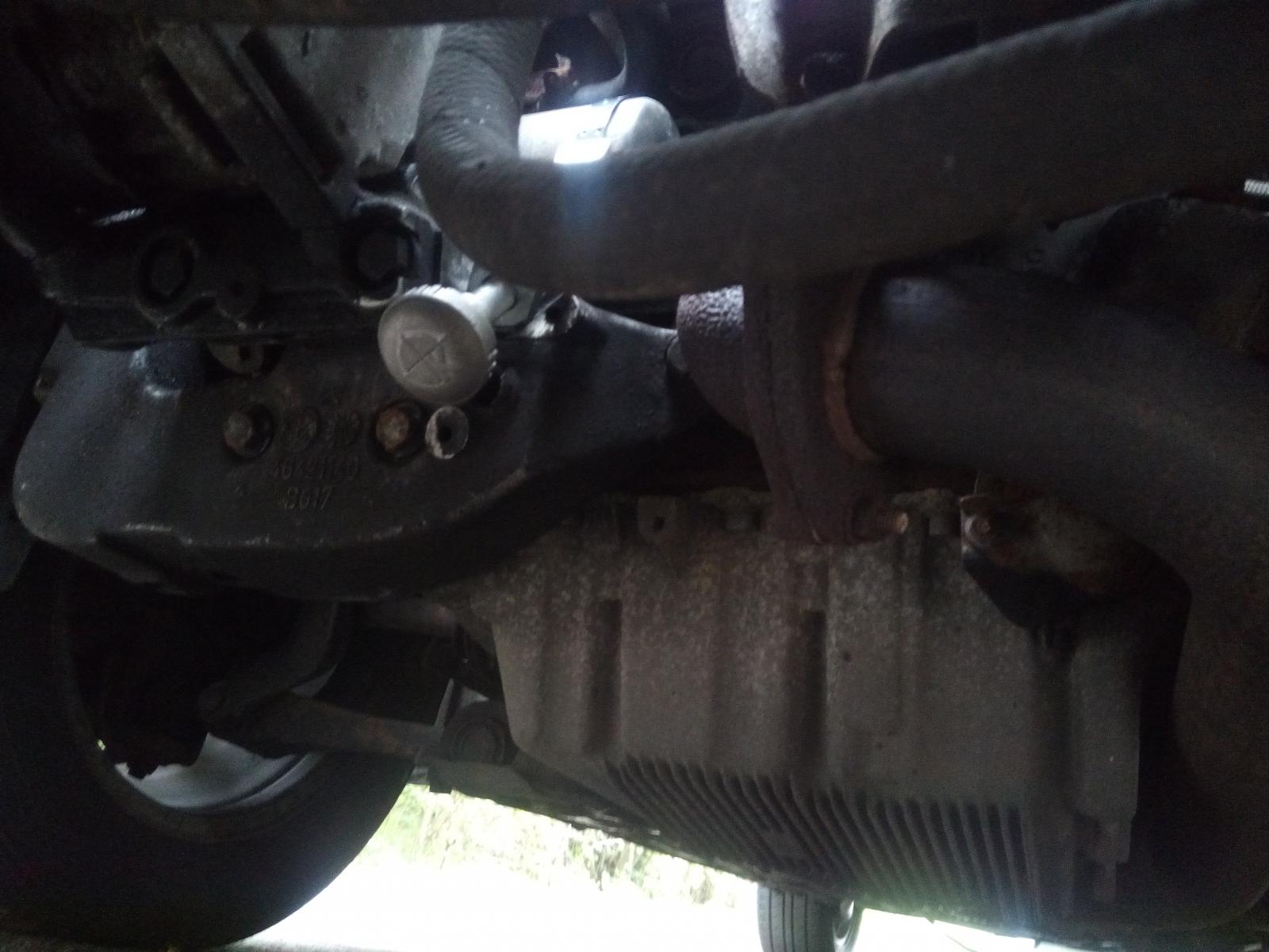

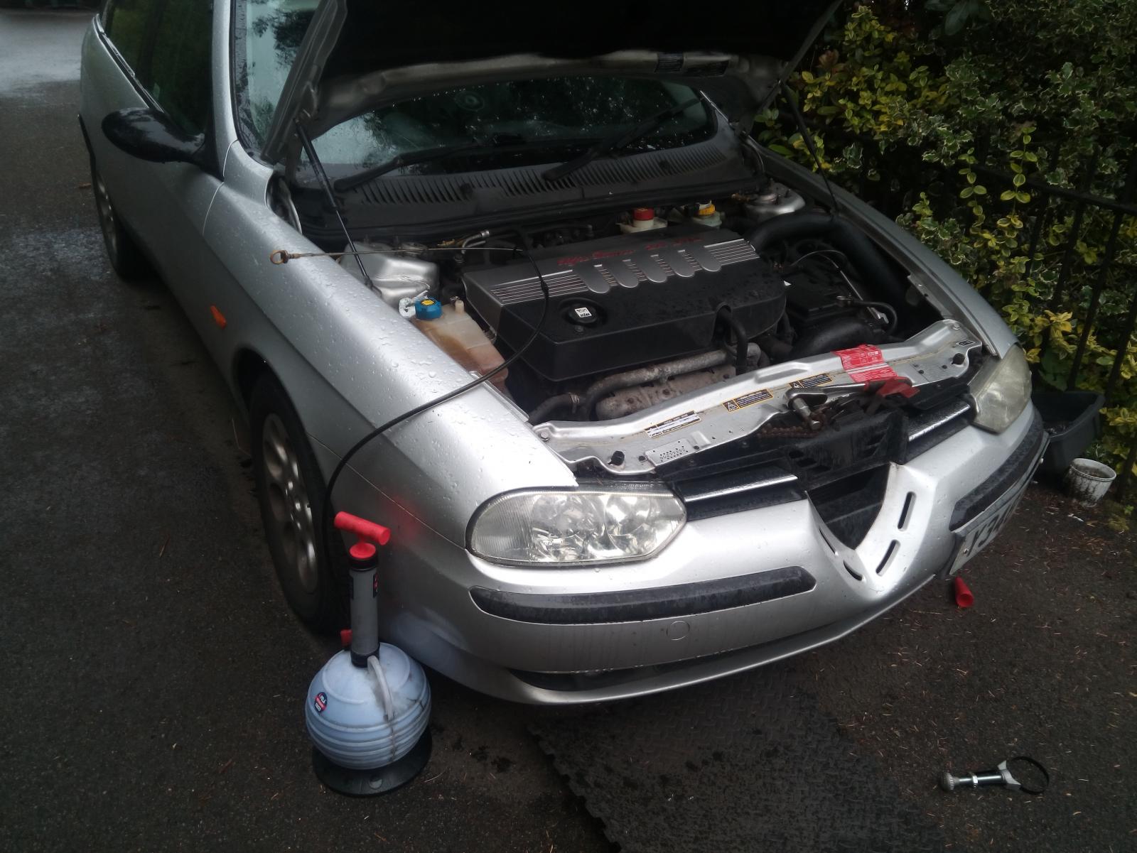

I persevered and marvelled at the access.
The dipstick is handily* placed pretty much at the scuttle- luckily the Pela tube reached.
The filter, not so much. Hot exhaust coupled with the need for double jointed elbows meant slow progress to get it loosened, and a good schlep of oil on the floor.
New filter fitted, I lobbed in some of Asda's finest 5w30 - the same super duper low ash vw507 spec fully synth as used with the ole Fabia.
Started her up and its about 100db quieter.

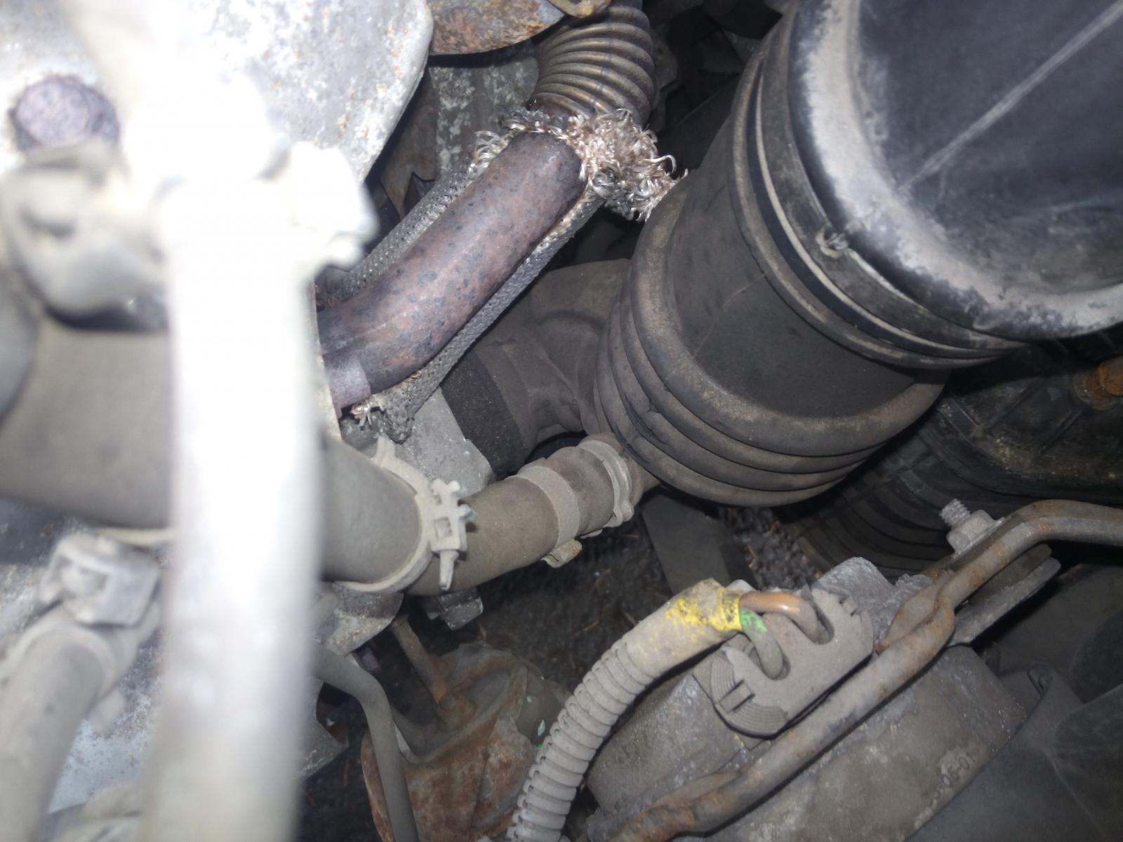

OK. Boost issue times.
Initial inspection of the inlet to the turbo showed a couple of tears in the inlet hose (bellows section on RHS of the pic)

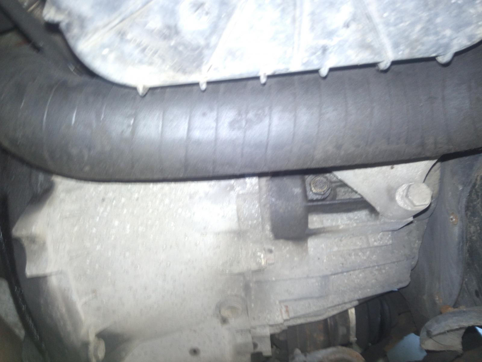

I then crawled underneath and checked the intercooler bottom hose.
I couldn't feel or see any splits/ damage and both ends were securely clipped.
With the engine running, you can hear a definite blow from the LHS of the car. This is altered in tone by squeezing the bottom intercooler pipe, but not by squeezing the top one.
I think there must be a hole/damage somewhere near or on the intercooler.
