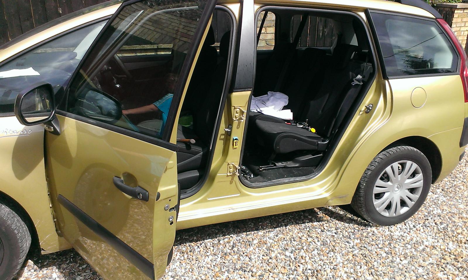

when I done the Shitroen it was pins all the way. they have a circlip on them which when removed allows the pin to be knocked up and out.
5 mins max* to swap a door. and no swearing at all
*having #1 son thestag to lift the door off and steady the replacement was essentialz
