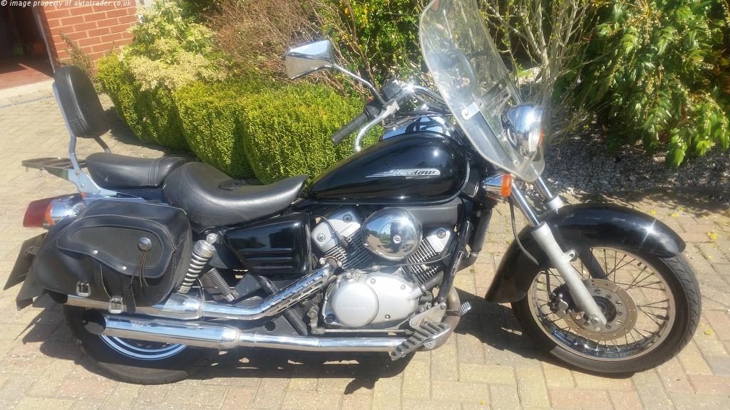

A stylish ride.  (Also an old Honda)
18238653_1418868461469537_80696136449462
18320593_1418868184802898_62109157914726
^^ they need to be uncovered !
All that shimmering bodywork covered up etc etc
you is sooo in trubel
Guest Breadvan72
Re: fancy rides.  I mistakenly thought that I'd found a (slightly) younger and better (European) model, but that one, although fast and stylish, was also quite unreliable and dangerous, and turned out not to be an upgrade after all. I fell off rather spectacularly, and was quite badly hurt for a while, and my older model was cruelly damaged also. I have now been to the hospital and the repair shop, and returned to the slightly older but more reliable, actually faster, better handling, less expensive and ultimately safer classic model. My friends all tell me that I dodged a bullet.
