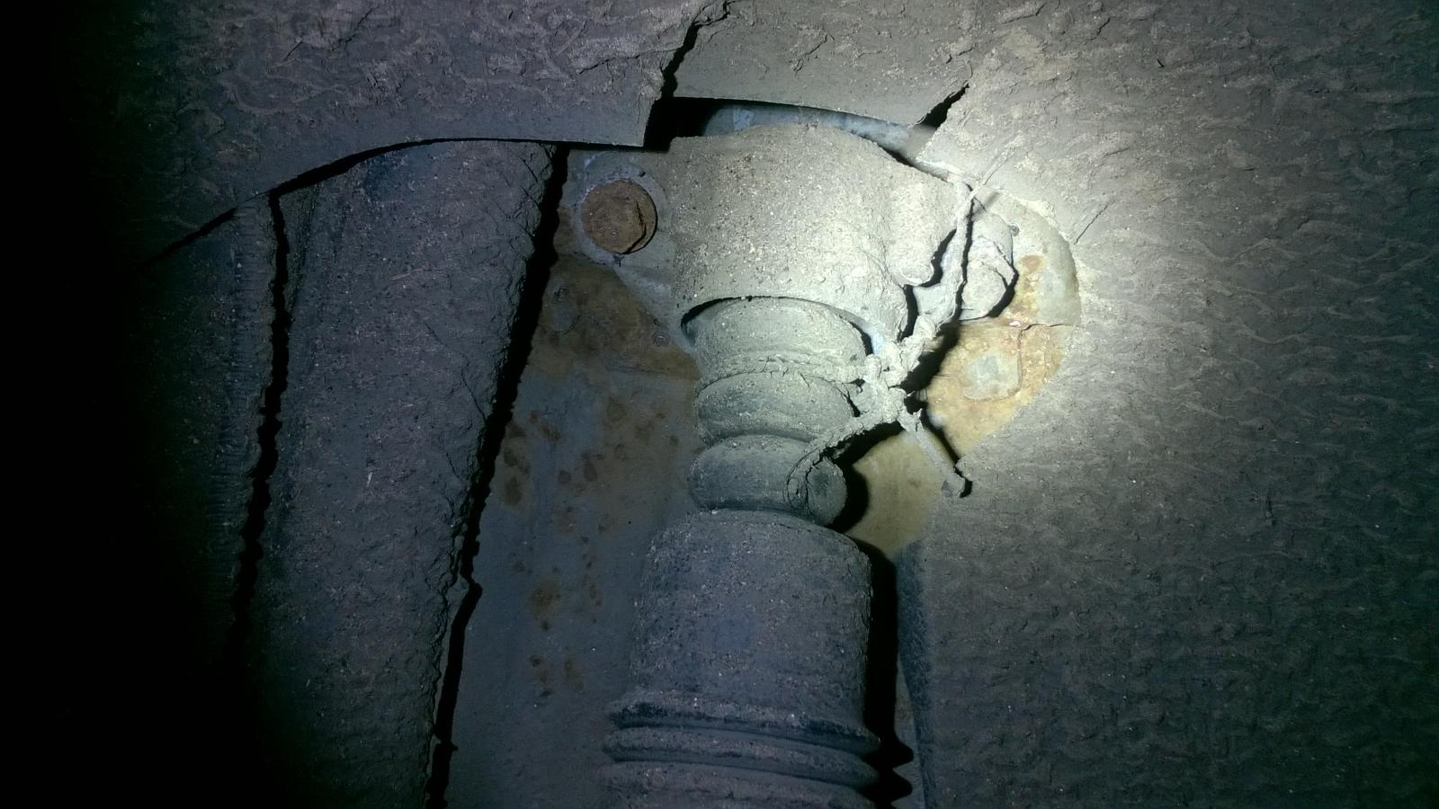

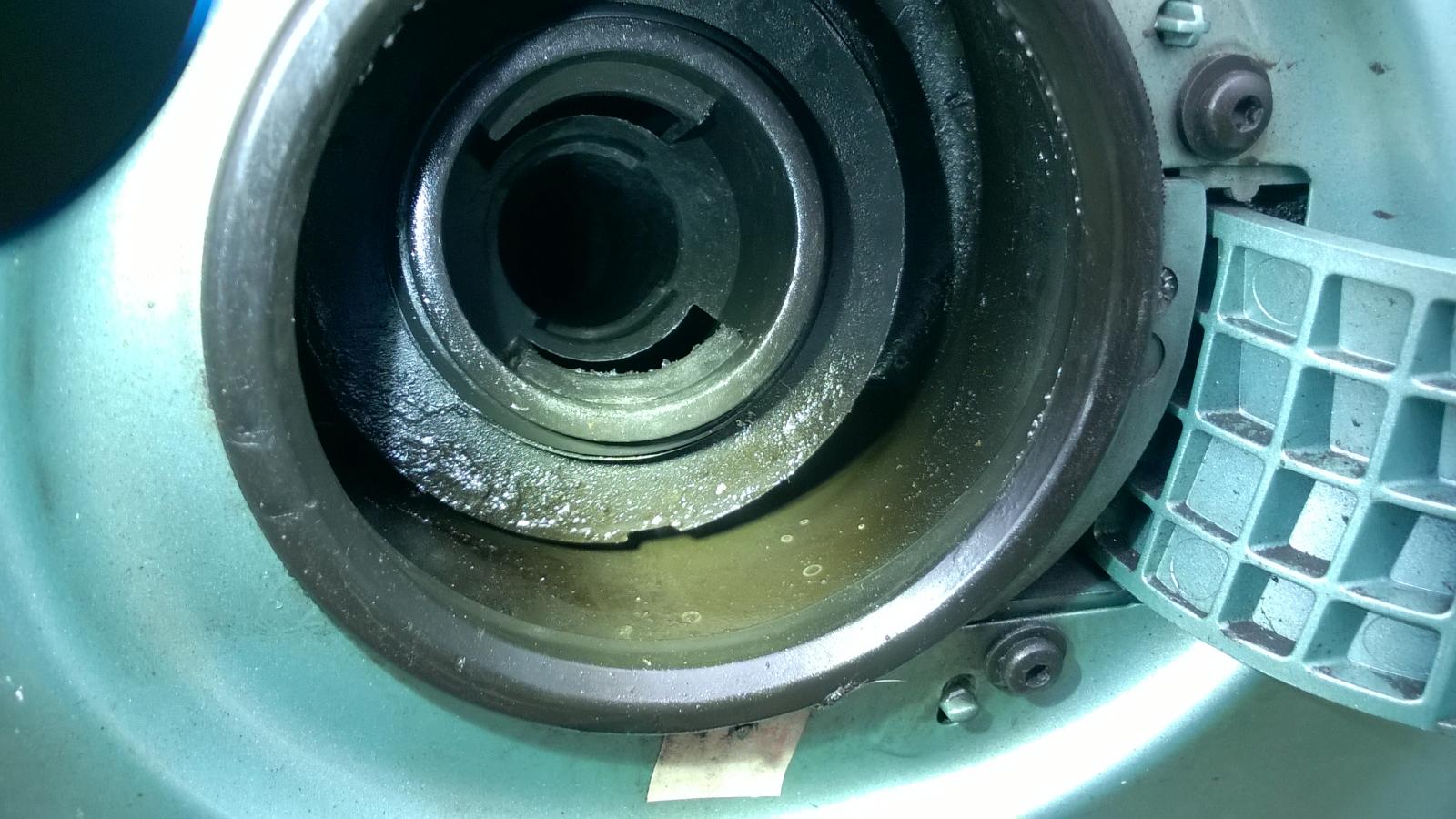

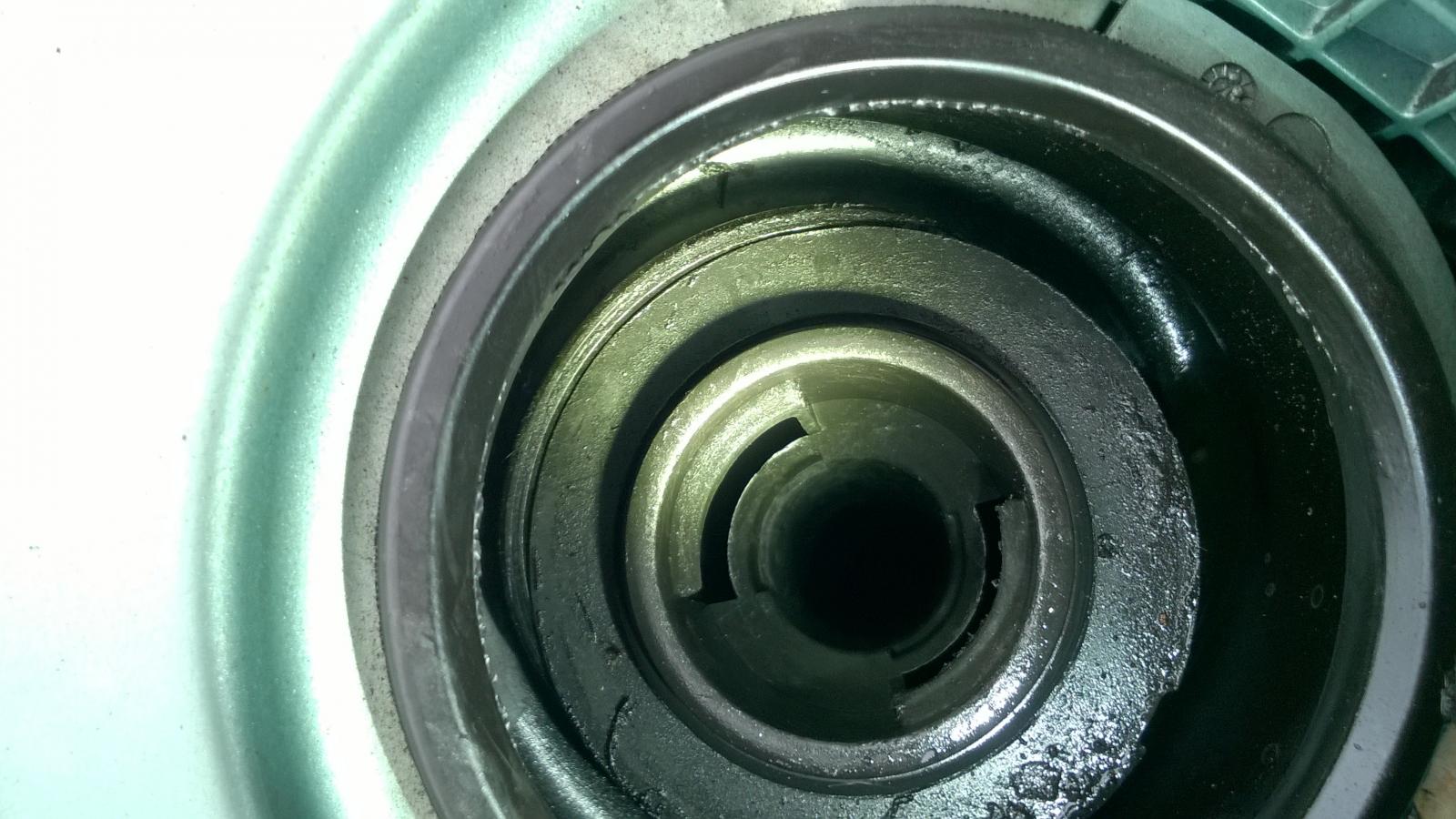

When I got there, there was diesel all down the side of the car. The tank looks damp as well. There's a big jubilee on the filler pipe where it enters the tank. The fuel has come out the filler neck, it looks like part of the neck isn't lined up right. There's also a piece of string attached to the shocker tower which I suspect is something to do with it.
Anyone seen a filler neck like this, it looks like a pipe inside a larger pipe.
Someone might have had to take the tank out and had to 'improvise' to replace the fuel tank. I'd take the pipe off and reseat it all. Where's the actual tank cap?
I've got the cap, however it looks like the fuel is leaking past the two sort of open rectangular holes into the outer pipe and then spilling out as the black ring doesn't seal onto this pipe
If it's got less than say 3/4 of a tank fuel shouldn't be getting that far up unless you were at such an angle that it would piss out. Have you checked the breather system?
It's got a quarter at the moment, although I was driving in an 'enthusiastic' manner on some of the corners. How would I check the breather system?
Usually a pipe that vents out through the back of the bumpers into an actual vent. Once had a really strong smell of fuel on a car years ago, turned out the flaps that are on the vents had stuck shut.
I would wire brush the area back round the filler pipe where it runs from the tank then reseat it all, possibly using some RTV sealant where a leak looks possible.

That giffer repair with the twisted wire is the top shock mount isn't it ? Holding the bump stop up I believe
Maybe, I thought it looked like it a bit of wire went up to the filler pipe. I'll find out when I get the arch liner out.
