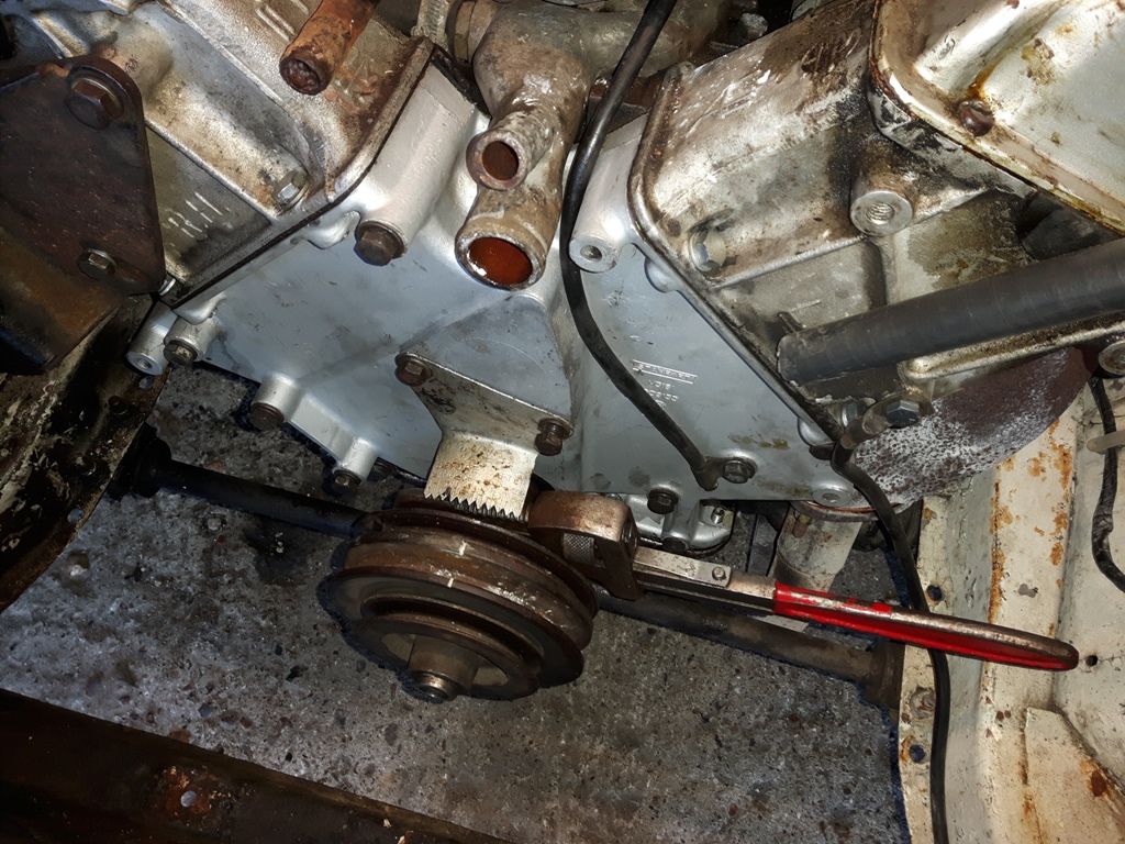

Removed that RH chain and found that the tensioning guide was right at its limit, the valve timing was still spot on and the tensioner was ok.
comparing the guide removed from my engine on the lhs, an aged 25k veteran in the middle and a new unit on the rhs, there are differences in the long slot, the veteran is nearly 1mm longer at the full tension end if you get my drift
this is the slot I am talking about
the chain runs along a fibre type pad, on the left is the 25k veteran in the middle with the same wear is the item that went on in the 2013 engine rebuild !! it has barely done 4k miles ...qualitay
I rebuilt the chain using the brand new tensioner guide and got it ok, but am concerned that the pad will wear at the same frigging rate as the 2013 item. although the new one did come from a hyper reputable supplier so fingers crossed

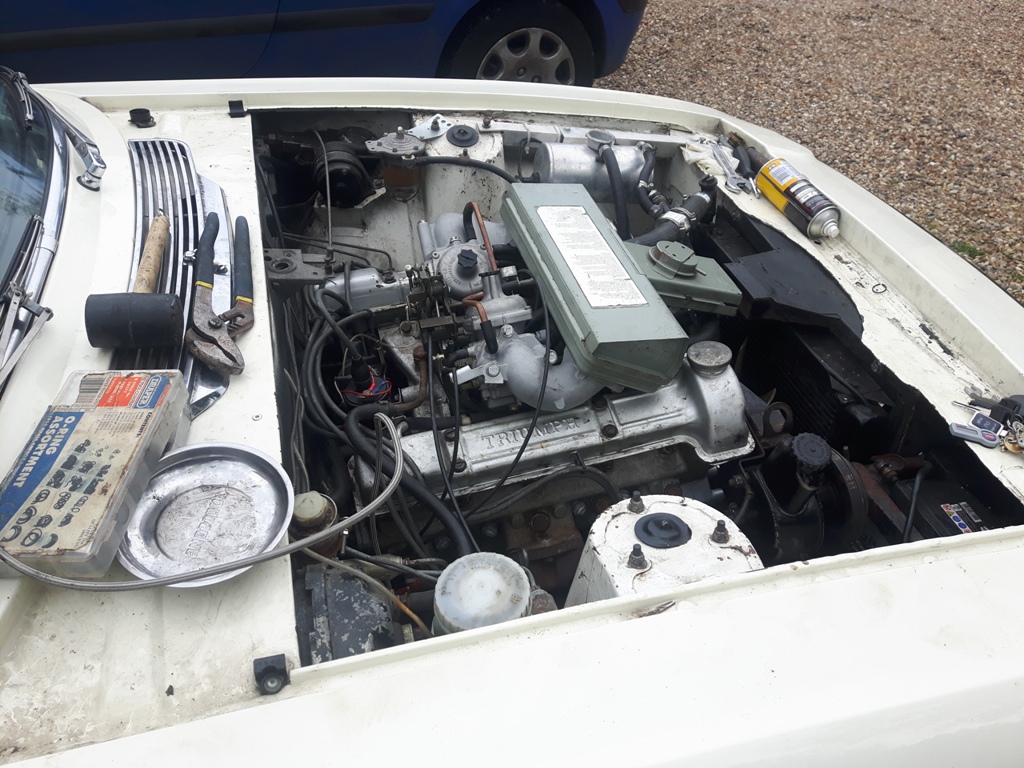

before it all goes together again I wanted to start tidying the engine bay up. why not start with the timing cover :D
give it a quick gunk off

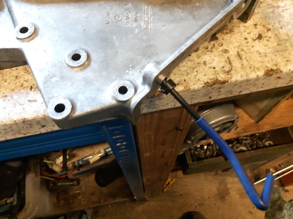

Then to fix all 9 threaded holes, All were borked, 1970s casting and fine threads dont last. Check out my thread repair kit. all UNC thread repairs in here and ideal for old alloy
Choose the thread size, in my case 5/16th 18tpi was the closest in diameter to the original. Use the drill to take the hole out
use the supplied tap to thread the hole, goes through like a knife and hot butter
install thread on insert tool
wind it into the newly threaded hole
just like that! because the holes are not bottomless and there is a risk that I might wind the threaded repair right through with the new bolt I only threaded the first 2/3 of the hole
knock off the flange (snigger) that allows the thread repair to be wound into the new hole. the break off easily
all done, just 8 more
finished up with a lick of VHT alloy paint, tbh hammerite would probably do it but I had this can on the shelf

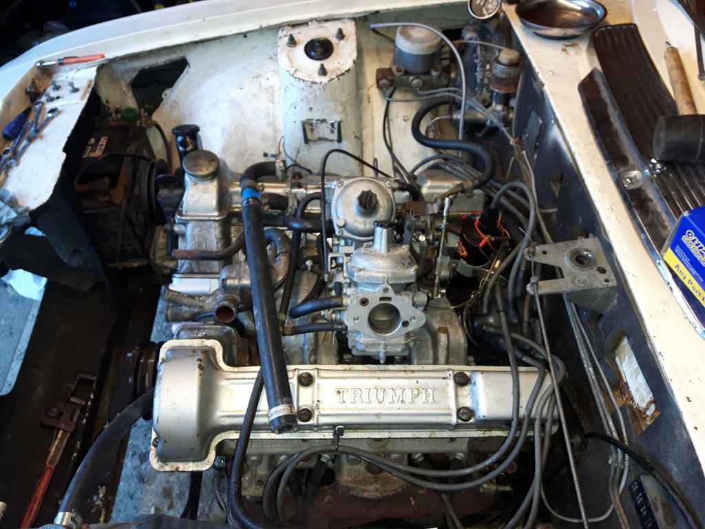

yesterday I concentrated my efforts on getting it all back together sure that the oil pressure issues were as a result of the gauge. after all spinning it up on a drill with a different gauge showed a healthy 45psi.

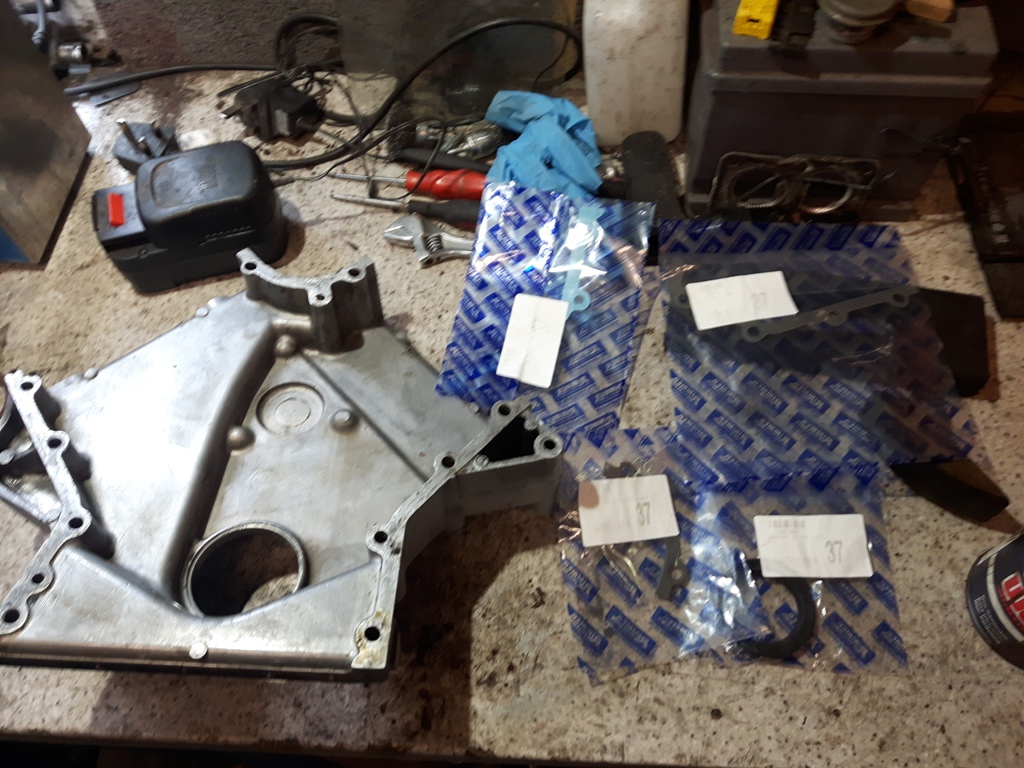

new gaskets came off the man cave shelf, thank goodness I am OCD about car part storage
already planning to give the engine and bay a deep pressure wash clean
dash apart to fit spare gauge in place of clock
also fitted a T so that I can for first time ever wire both gauge and oil pressure lights up
test fire up showed 20 psi of oil pressure. bastard!!!
rh chain is rattling but goes away after about 30 seconds. I didnt rev it but did remove LH cam cover to check oil flow, which it was, very messy business.

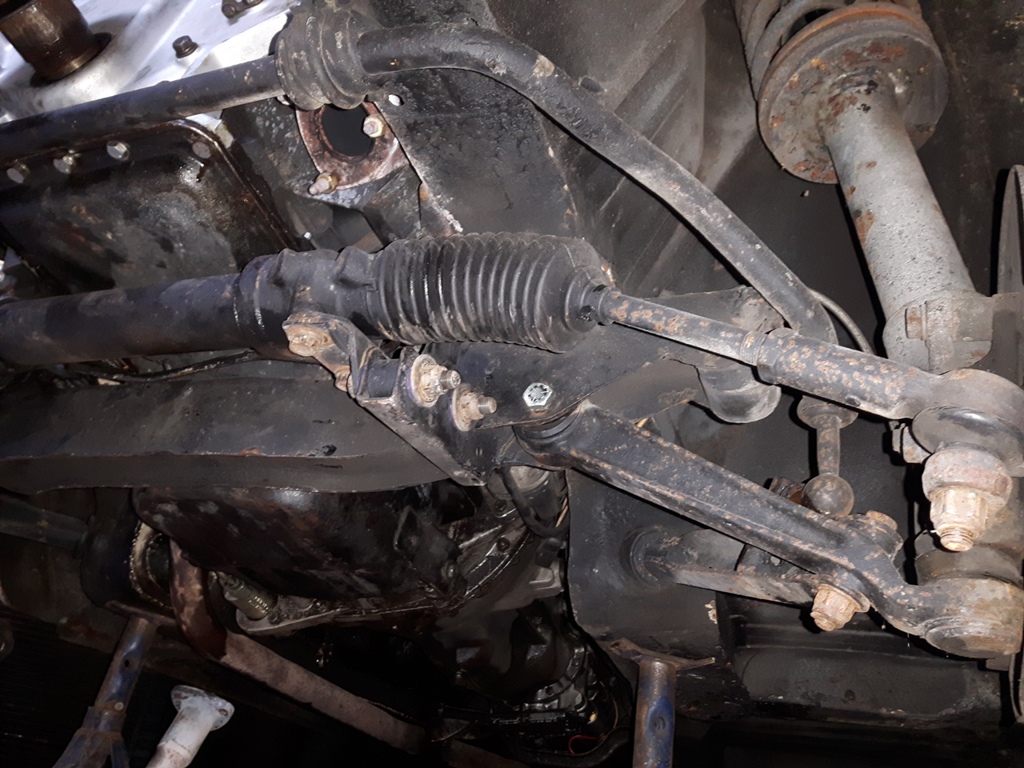

this morning I woke up and curiosity got the better of me! sumps gonna have to come off.
that means the cross member needs to come out BUT before that
Anti rollbar links need to come off
steering rack mounts and NS exhaust down pipe
wishbone
on both sides
then just 8 bolts hold the cross member to the body
access for sump removal now good
bolts down both side. while doing this I drained the oil which came out of gloops. I already know what the issue is!!
I am pretty fucked off with myself. I am normally OCD when it comes to nuts, bolts, tools and blue cloth but it would appear that 4, yes 4 frigging sheets of the stuff got into the sump
you stuff the rag in as follows to stop you dropping tools, bolts, false teeth into the sump
still the engine looks nice and clean still
I also found this rogue bolt that used to secure the cam sprocket to the cam, I recall loosing this nearly 4 years ago so happy it has been recovered
I iz a twat
Good news Gaskets on order to rebuild it again, should only take a couple of hours

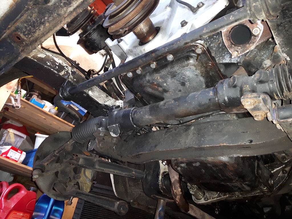

Last night I replaced the sump
it is a bugger to fit because
a. you are working upside down
b. the sodding brake pipe dangling across the engine bay keeps getting in the way
c. the rear lip of the sump slots into a gap on the gearbox adapter plate
d. wriggling the sump past the oil pickup and into the slot while keeping a wellsealled gaskit in place is a bit of a nightmare
fitted all bolts before nipping them all up, there that only took 2 hours
Tonight I reinstalled the crossmember - 8 bolts. supported it on the jack and nipped a couple of bolts in then it was easy to do the others.
Refitted the steering rack and all the n/s front suspension. Had to run some errands so called it a day 1h 30m.
Tomorrow ?!? I will reinstall the exhaust and o/s suspension, nip up the steering shaft, fit the wheels and drop it to the deck before torquing the wishbone bolts up. recon on 1 to 2 hours depending on breaks other stuff i need to do etc
Then it is fill with oil, prime the pump and start it. if 45psi happy days and refit rad etc if not sulk until I can find enthusiasm :D

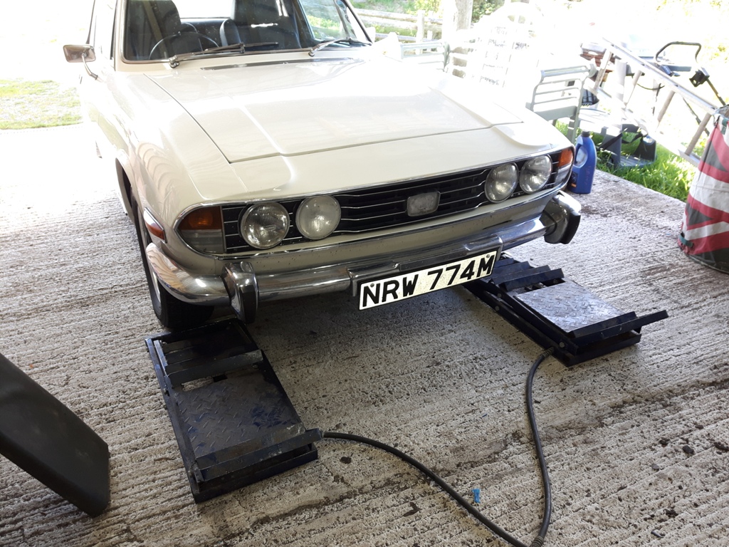

its all back together and runs great
test start to check oil pressure, happy with that.
out for a test ride with Matt #1 son who doesnt really fit in the car
only issues I have are;
cooling system will not pressurise, i.e. it is running at atmospheric pressure which is not going to help it on hot days. was ok today but even then it got to 90 degrees after some spirited driving.
Pressurised cooling system raises the boiling point, with a 20lb cap the boiling point is iro 130 degrees.
With an unpressurised system the boiling point is iro 100 degrees depending on how far above sea level you are.
I loaned my pressure tester to a mate and wont get it back till tomorrow
It is not losing water so the leak has to be above the water line or very very small indeed but below the water line. if it were the latter I would expect the system to pressurise but then hiss all the pressure out as well as loosing some water.
I suspect the bloody aftermarket header tank is leaking somehwhere

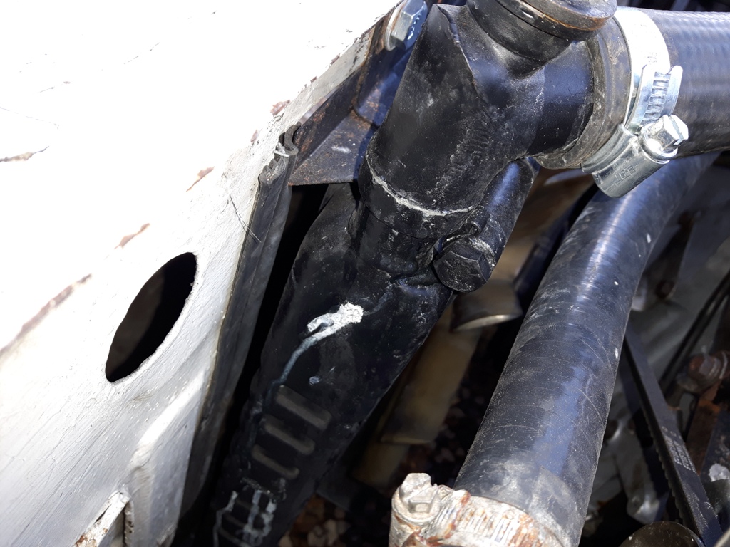

tis fixed
I couldnt easily find the leak because it was obviously above the water level and my ears are shit at hearing hisses etc.
The plan was to brim the bastard and spot the water leak
easy peasy nip off that rad plug and . oh. bloody top of the rad has broken orf. better deal with that on the morrow
dragged stag out of garage this morning and wondered, some cunt has stolen my unobtainium stag badge........
oh there it is.
rad out is 2 hose clamps, two screws for the grill, two bolts and two nuts. easy compared to just about any other job in this car
here are the two bits that needs to be one. started cleaning back ready for soldering
soldered
painted
Car works, cooling system pressurises, Sir Winston appoves

Stag is now on the ramps
why?
Mr Probey found a hole, he is also good at opening paint tins and general prodding
This is the joint between the inner sill and the passenger footwell. The sill is solid, needs a bit of angle to be tidily welded in.All the brown stuff is old carpet glue.
Ramps help give me the clearance to do the job
position ramps in front of car
Drive on
Attach pump and 25 seconds of light pumpage. if the ground is not level you can start pumping one ramp before the second joins the party.
ramps are locked into raised position by lever that braces against the hydraulic ram. once locked the pump could be removed to give better access
Front bumper is 3 foot off the ground
